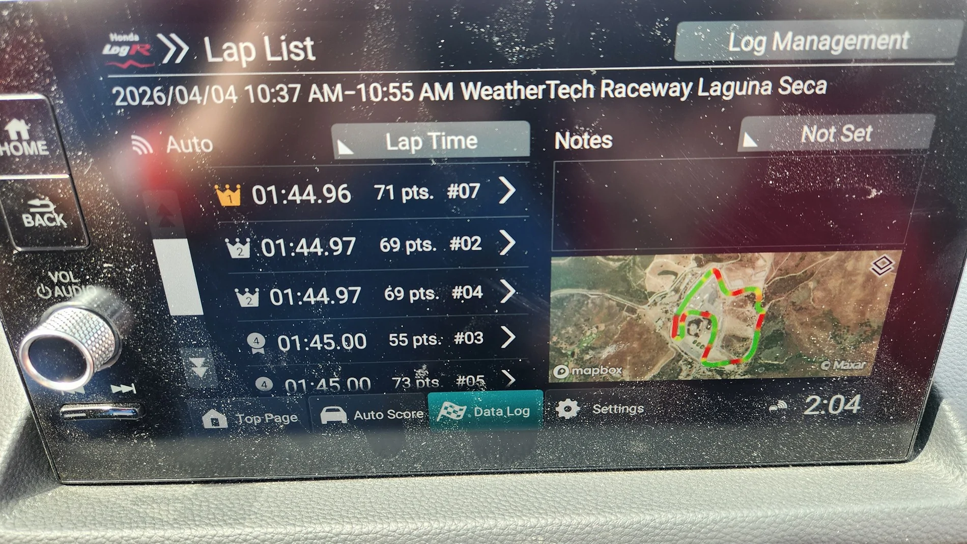

I really enjoyed meeting Jason Lewis (WOT), and he kindly spent a lot of time helping me understand the car and its behavior on track. Among the great advice that he gave me, he suggested dropping my air pressures way down and that seemed to help the car feel more balanced and easier to rotate on corner entry.​
I had put brand new tires (Nankang CRS) on the front, but was a little bit disappointed in my lap times. They were one second slower than the previous event, but at least they were consistent.​
What are your hot/cold tire pressures looking like with the Nankang?

Redragn, For the last session, I ended up at 25 front and 31 rear cooled off for an hour and a half after the previous session, but not stone cold. I forgot to check them hot after I dropped them down to those pressures, but I started the first session at 28 stone cold front and 32 rear, and they went up to 41 left front hot, 39 right front (which is odd because it's a counterclockwise track so you would expect more heat on the right side), and 39 rear.
