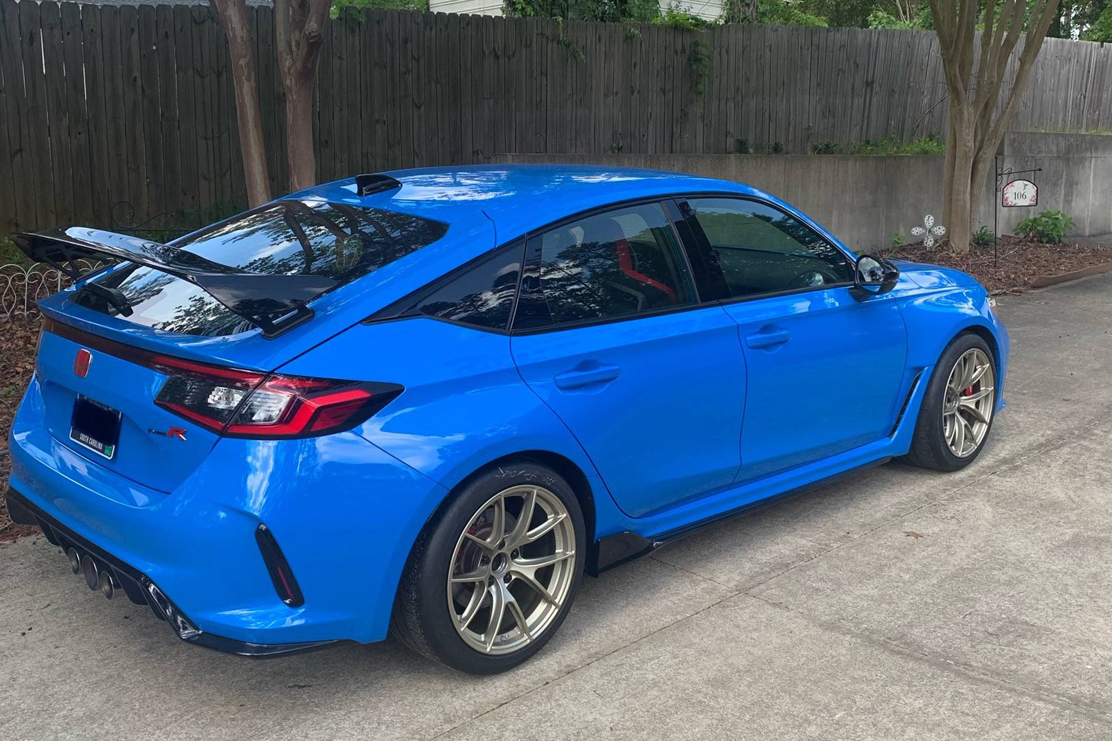

New track shoes mounted, saving 11 pounds per corner. Stock wheels are heavy! Engine oil, transmission fluid and brake fluid changed. Working on setting up a proper TPMS. Now I need another track day.
Is this on stock suspension? It looks damn good!

Looks stock. Looks awesome, I got the same wheels (if they are the 18x10.5 +47), can't wait to put em on

same, I have the same wheels same size on a 275 35 18 re71 rs tire. Im lowered on eibach sportline springs with -3 camber. I'm worried about rubbing still but I need to test and see. We have some test and tune days coming up so im eager to see

I am stock right now but H&R springs going in this friday. Of course they are the mildest springs but if this is any comfort the guy I bought the wheels from was running 285/30 and he was on coilovers and had no rubbing what so ever

Stock except track alignment. 10.5” wheels with 275 fills the wheel well nicely.
I have a 275 35 18 on the same wheel 18 x 10.5 47 offset but I'm on eibach Sportline springs and I'm worried about rubbing when I track it so I may be going back to stock springs

I’m wondering if dropping back to 265 might work better on track. I recently noticed that the RE71 (both RS and RZ) in 265 actually has a higher load rating than the 275.
