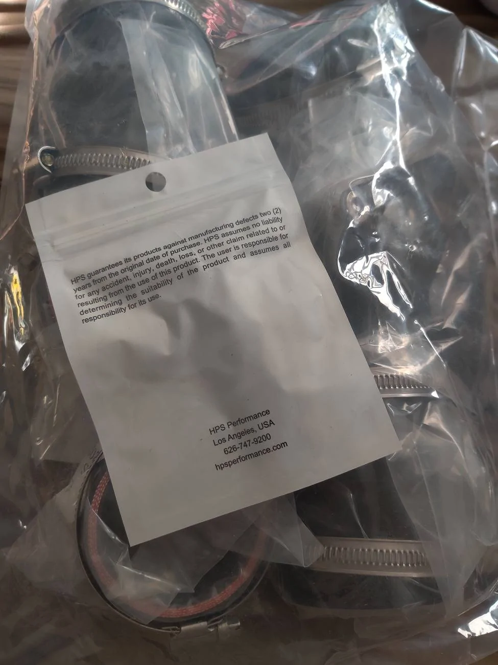

HPS also claims some big gains from just changing the pipes and that one I am like ?

with ya on that, and obviously some things are lost in translation, but it does seem to be after a number of runs.
Yeah I was going to mention hps. Also MDR claims big gains with their intercooler and pipes.
