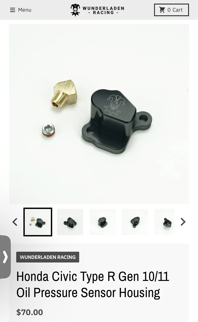

If you decide to also monitor oil pressure, the Wunderladen oil pressure sensor housing is the best bet.

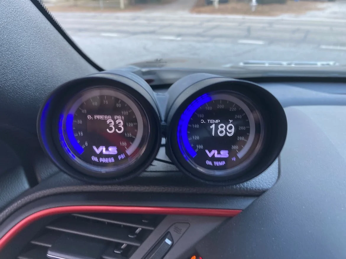

I have had the 10th gen gauge pod mounts and will be interested to see what your guy comes up with for the 11th gen. Hopefully something like this...
11th Gen Honda Civic Another oil temperature question! IMG_1625
The guy I talk to does similar ones. I took pictures of the pitch and yaw angles and sent him a vent so he can develop it. From our conversation, I gathered that he can do multiple ones on the same spot using the same base. At the moment, I am mainly interested in the temperature because Hondata shows the pressure. I’ll see if anything else comes up.

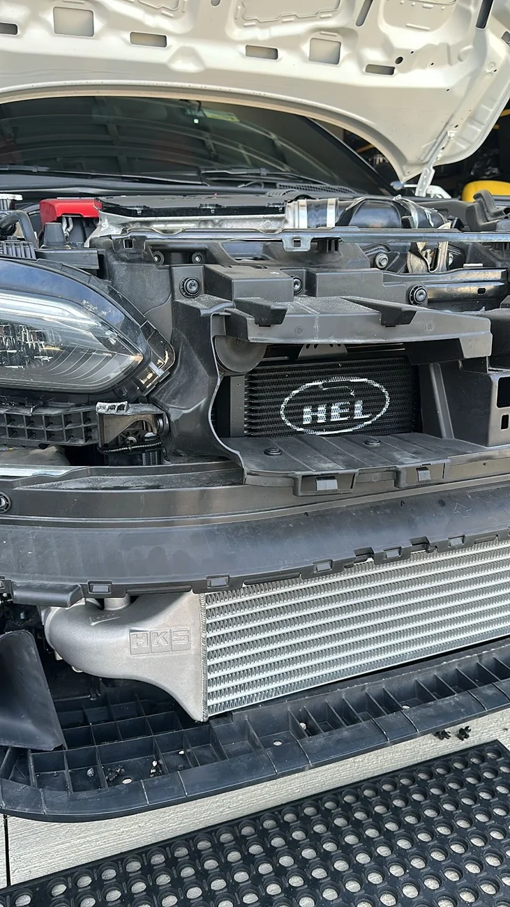

11th Gen Honda Civic Another oil temperature question! EC0BCFFE-2B54-4855-AD37-07EFA67EBCBC
I daily drive my car 100 miles a day, (2,000 miles a month). No, issues! Track day this Thursday at Sebring too!

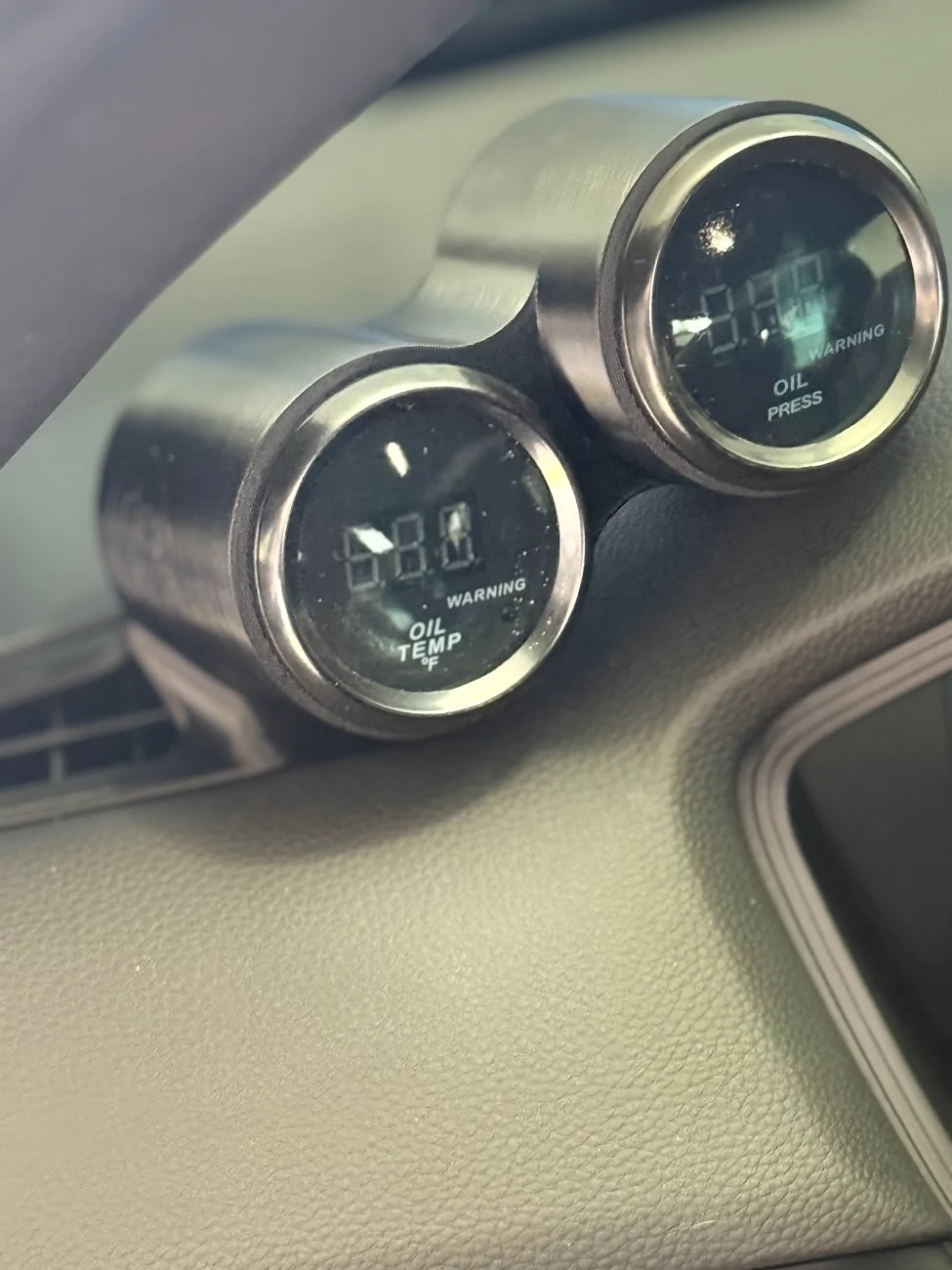

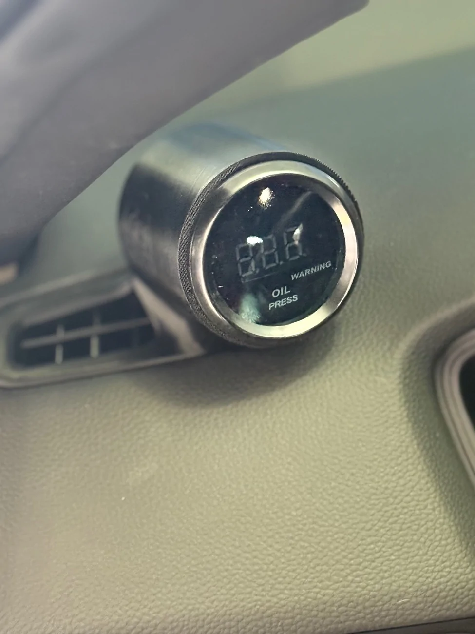

I’m updating this post because I think I’ve found a better solution than the one I previously shared. I reached out to a company called carzdeluxe.com, and they make 3D-printed gauge pods. The owner has been amazing, and the communication has been superb!
For the setup, I’ll be using the Wunderland Racing oil pressure sensor on the cylinder head to monitor both pressure and temperature from that location. My car is down right now, but it should be running by the end of the week. I plan to have the pressure sensor installed by summer, while still relying on the unreliable Hondata to monitor everything else. If I hadn’t already paid for it, I’d definitely go a different route—but for now, I guess it’s time to embrace the situation and move on.
11th Gen Honda Civic Another oil temperature question! IMG_5415
11th Gen Honda Civic Another oil temperature question! IMG_5417
11th Gen Honda Civic Another oil temperature question! IMG_5371
