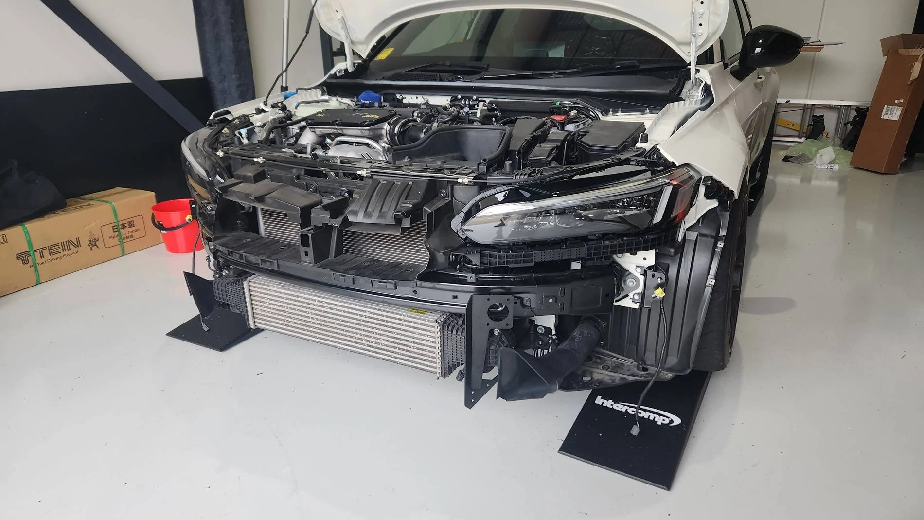

Any results from this?
I'm from Australia and it turns out that we have the steel bar which I've found out in the process of trying to mount up the battle aero splitter brackets, however it won't work with the steel bar without some considerable effing about cause the mounting surface angles don't meet.
So here I was thinking of importing a USDM alloy one assuming that it's going to be lighter but seeing this thread seems it might not be the case?
