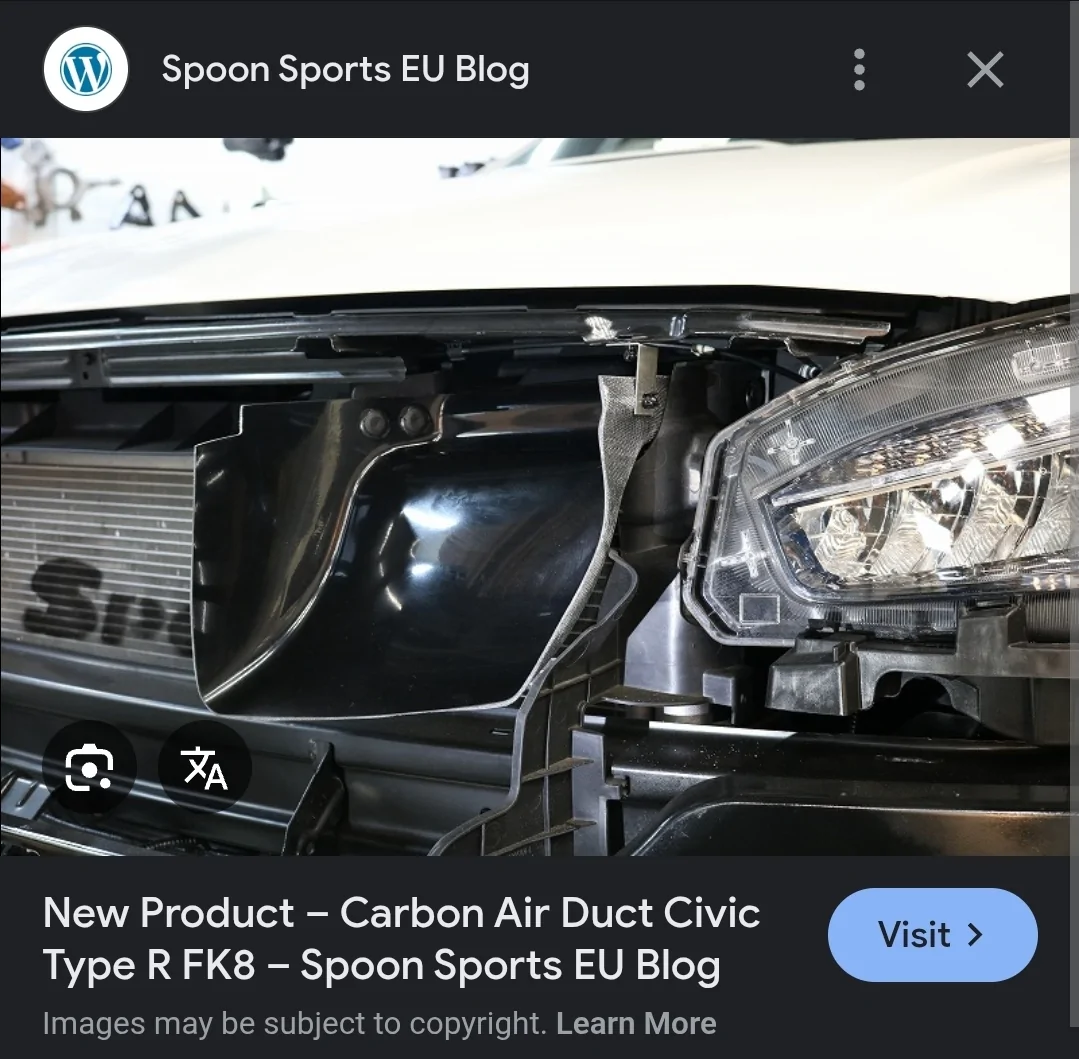

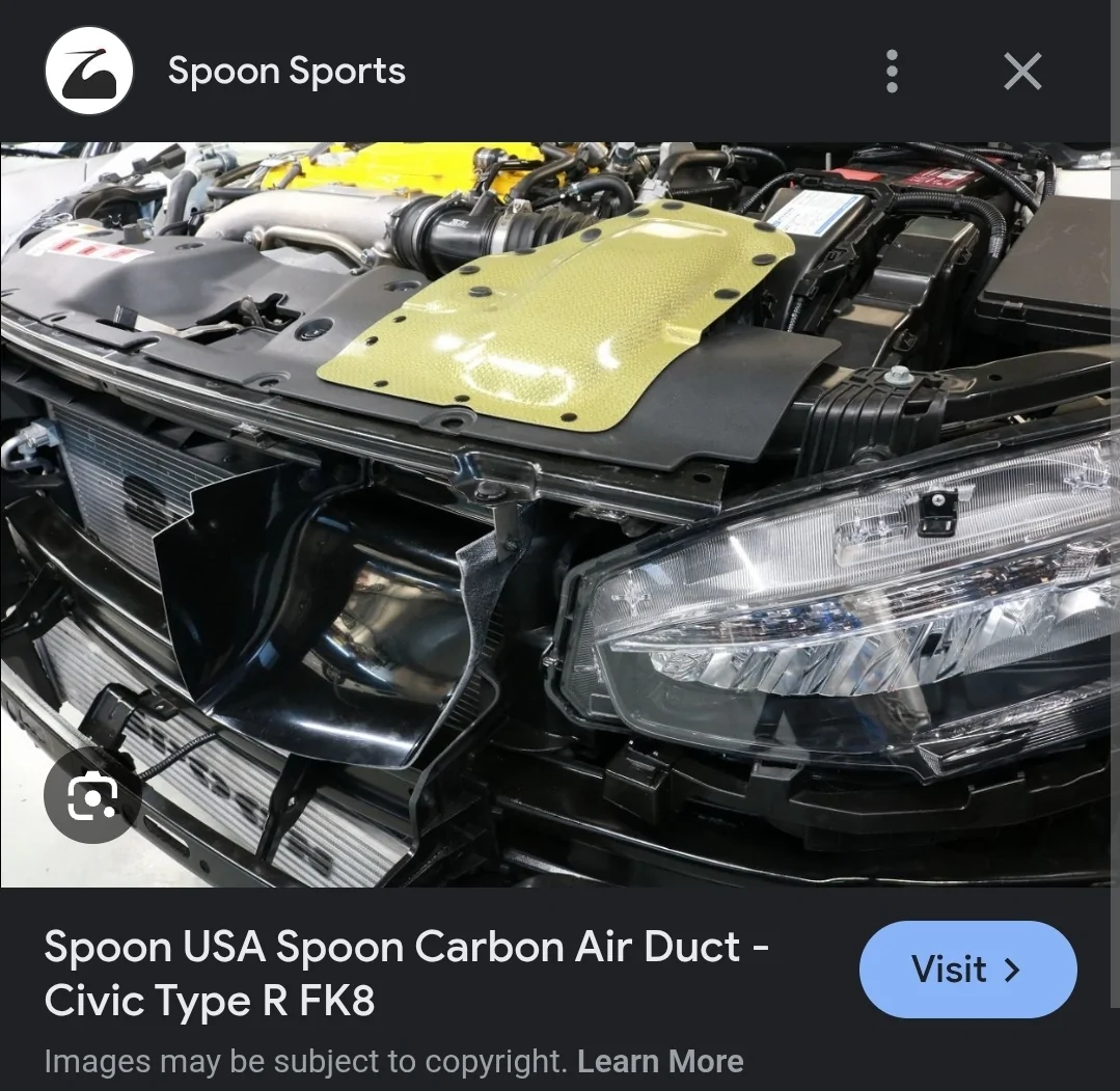

Pointbypatrol showed in a torture test that the snorkel does impact radiator airflow. I think its fine for daily driving or highway runs. As far as I know, SpoonUSA doesn’t even offer a snorkel, correct me if im wrong. I still run mine at the track, but i also have an aftermarket vented hood. the snorkel only blocks a small portion of the radiator, which isn’t a big deal if you’ve got multiple supporting mods. But if you’re chasing every bit of airflow and really pushing the car at the track, then it definitely matters. i dont even think we have any technical proof that the snorkel does add more HP.

The intake airflow pinch point is under the front of the hood at the airbox entrance. I wouldn't recommend ducting through there, as it could further reduce the flow area. It's not clear where this duct is routed.
Similar snorkels were offered for my FR-S and S2000. I tried both but wasn't convinced they were better than stock. I kept the FR-S snorkel on because the inlet worked well with a rodent screen attached and we were surrounded by woods.
