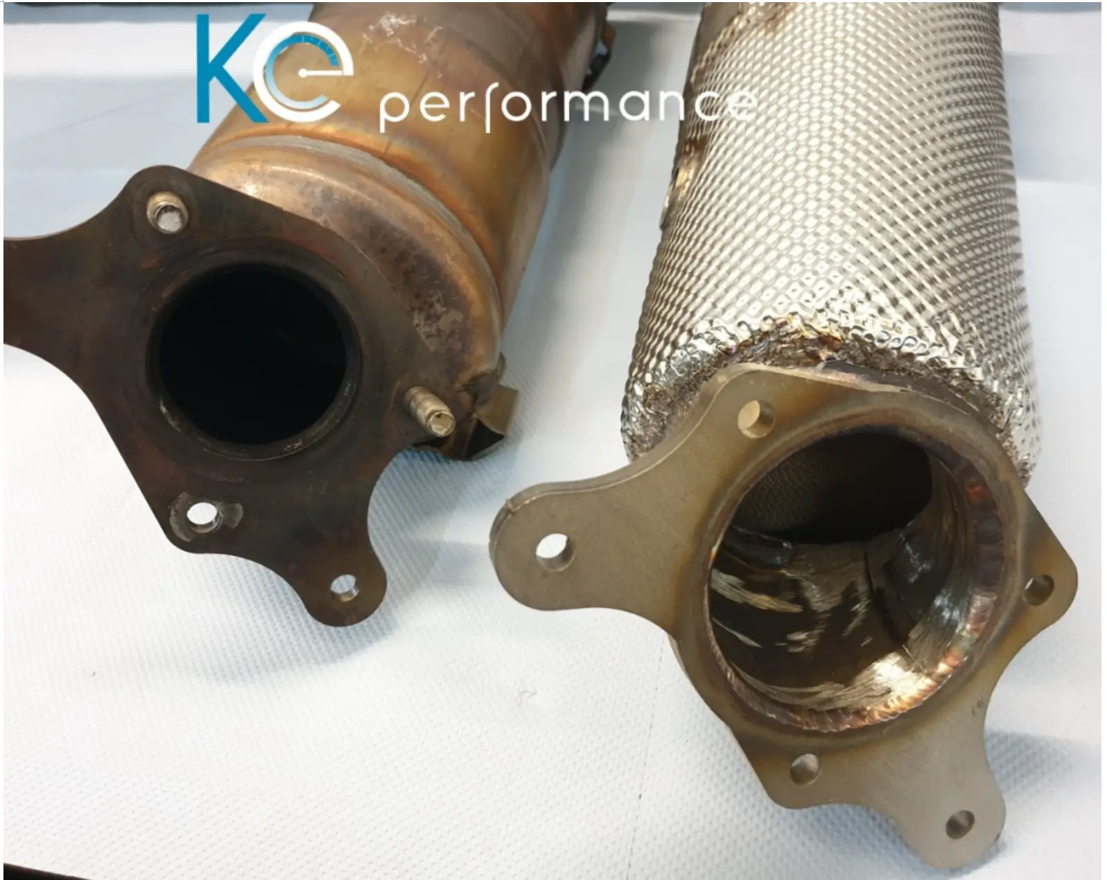

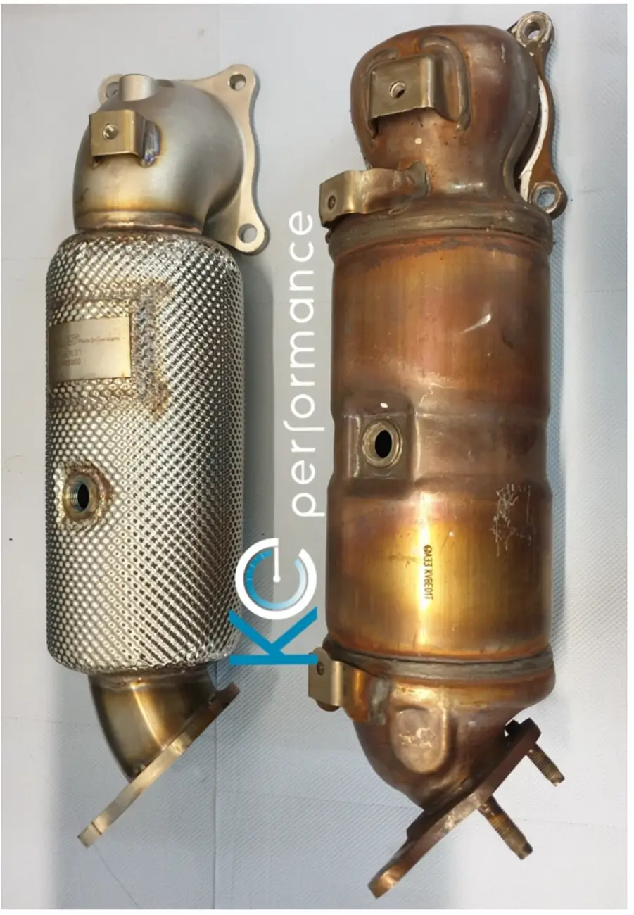

HJS downpipe vs OEM downpipe (photo from kep-shop.de shop):

Ideally you’d want to remain 3” from the dp back
but comparing to stock, anything’s better than stock
you are going to create a louder sounding idle tho. It won’t actually be louder in terms of decibel gain. It’s just the tone changing some. You’re also going to lose some texture in your sound when driving.

Ideally, yes, the best situation would be a full 3" path from your turbo to the exhaust.
Will using a 2.75" front pipe instead of a 3" significantly impact your performance? No. Unless you're chasing 400+ #'s I doubt you'd even notice via the butt dyno on the street.

People make 500hp on the stock exhaust. It's not a huge restriction in the cars.

From a purely performance standpoint yes it would be better for a larger diameter. The JDM brands have noise regulations they have to meet so they tend to not go with the largest possible diameter to help keep the noise in check.
Like TypeRVA said the stock exhaust is good for over 500whp, the difference in power between a 2.75 inch front pipe and a 3 inch is relatively insignificant unless you absolutely have to make all available power.
