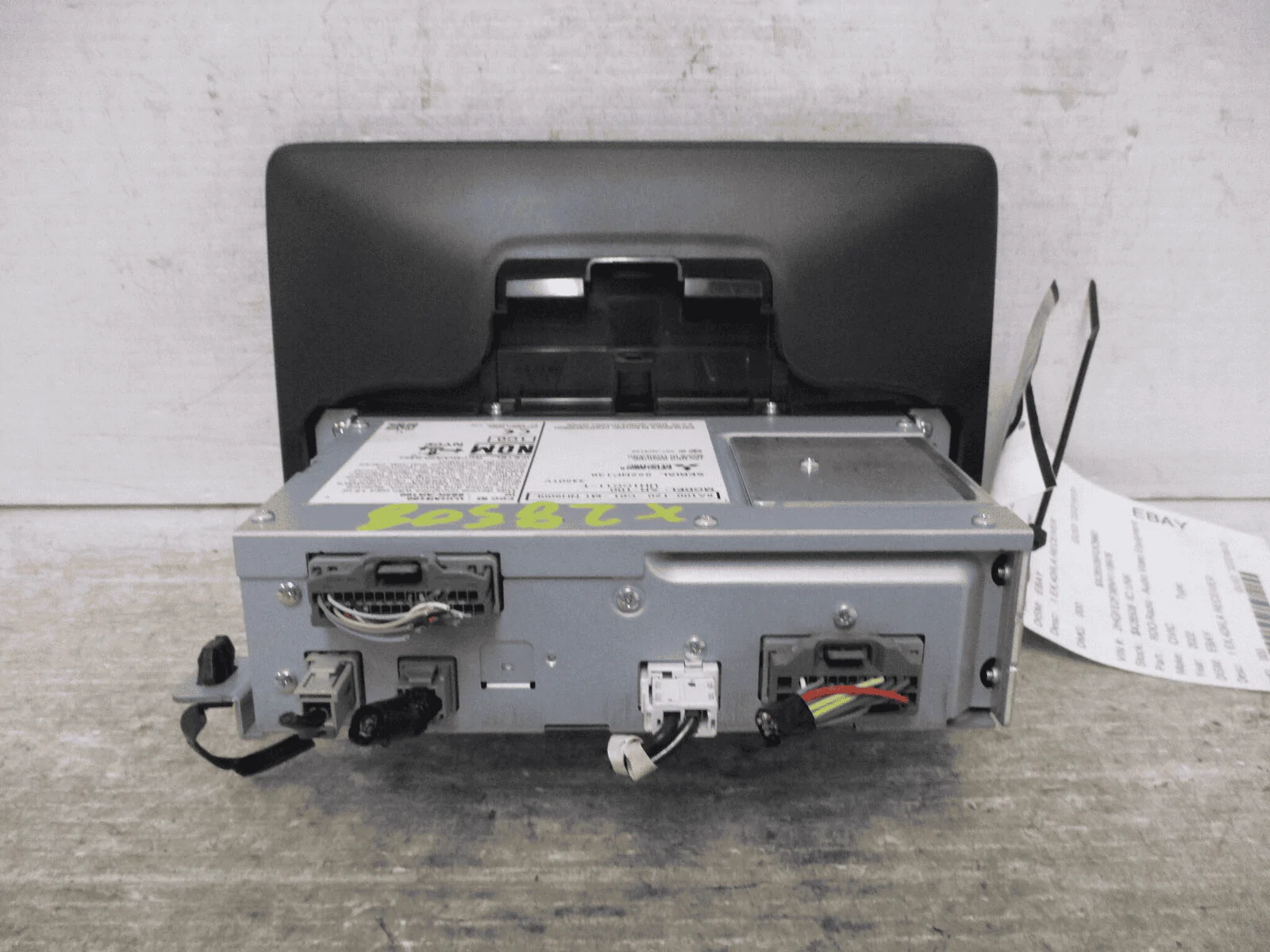

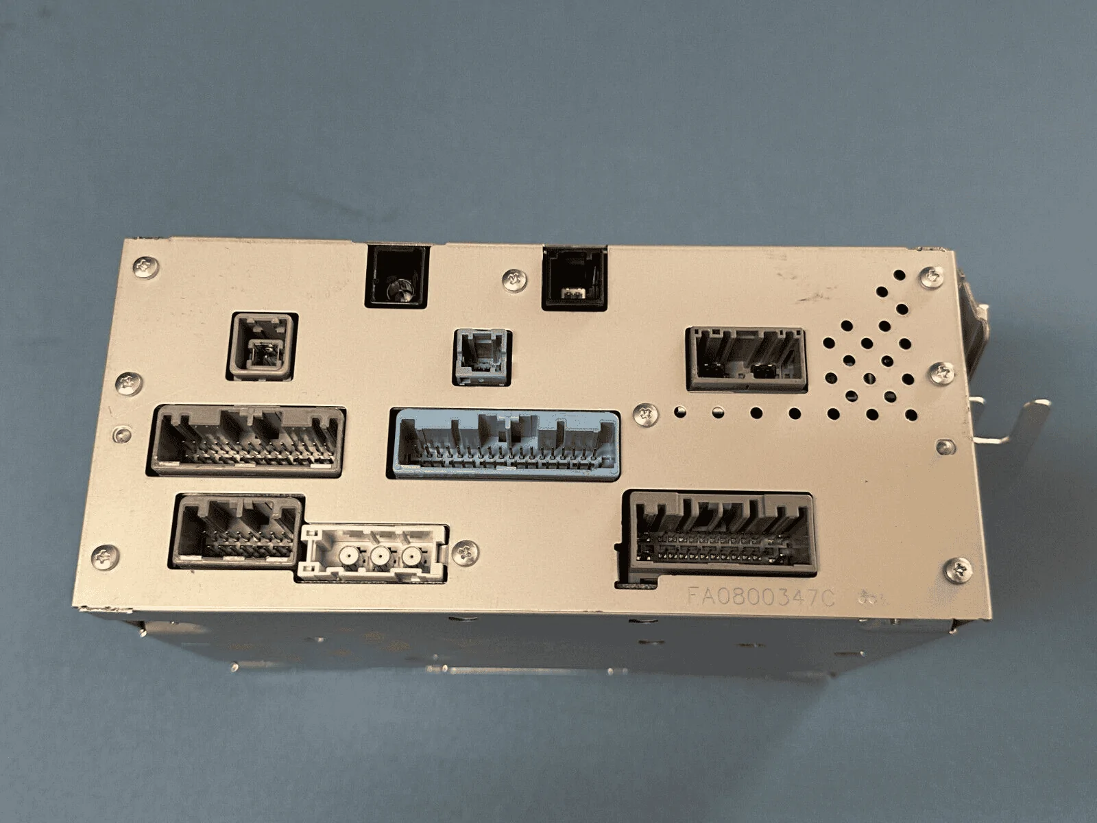

so the left picture is the Si infotainment and the right picture is the base infotainment? Your ( ) explanation confused me
