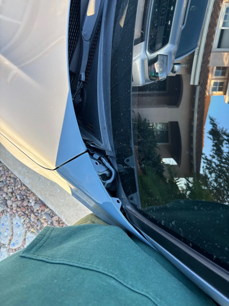

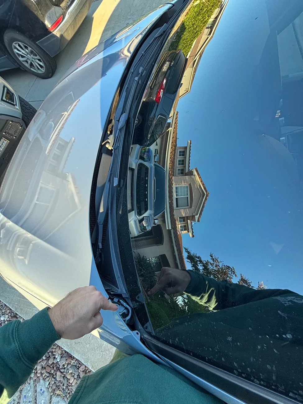

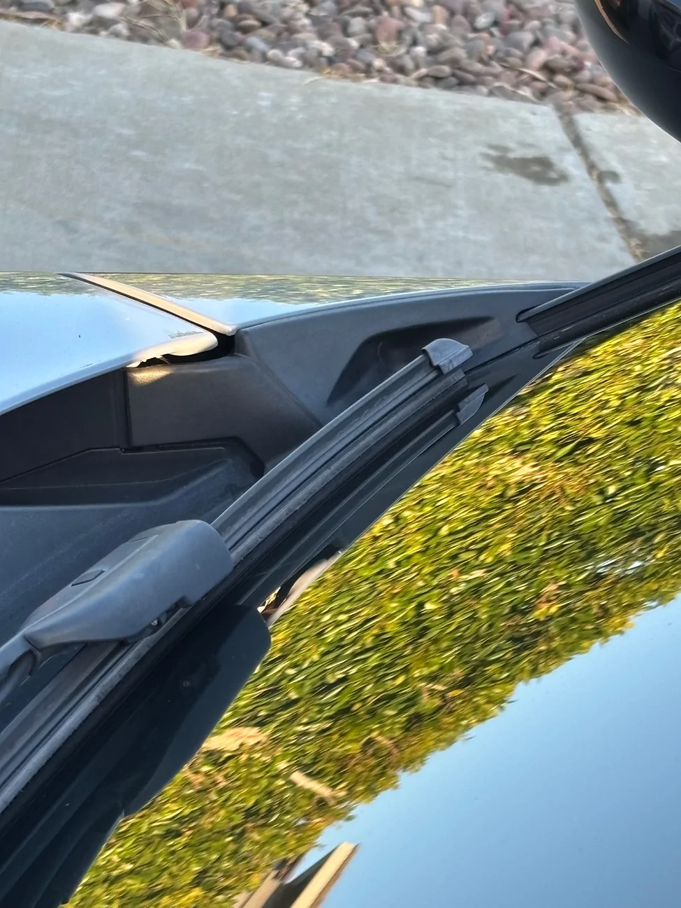

Good evening yall brand new to the forum and just bought a 2023 civic si. Slightly used 23k miles on it. It’s missing this part in the windshield pretty sure it’s used just so water don’t go in the engine bay. I have no idea how to search this part up and would like to get it replaced. If any of yall could assist me I would be very appreciated.

Cowl cover?

I think this is your part number: 73165-T20-A01
