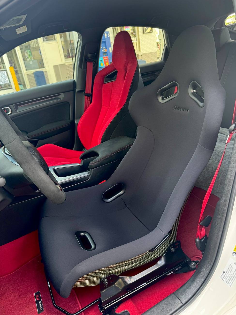

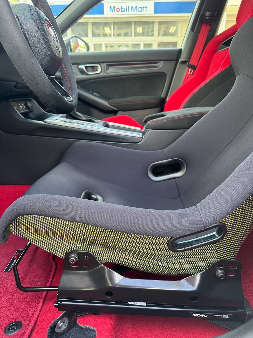

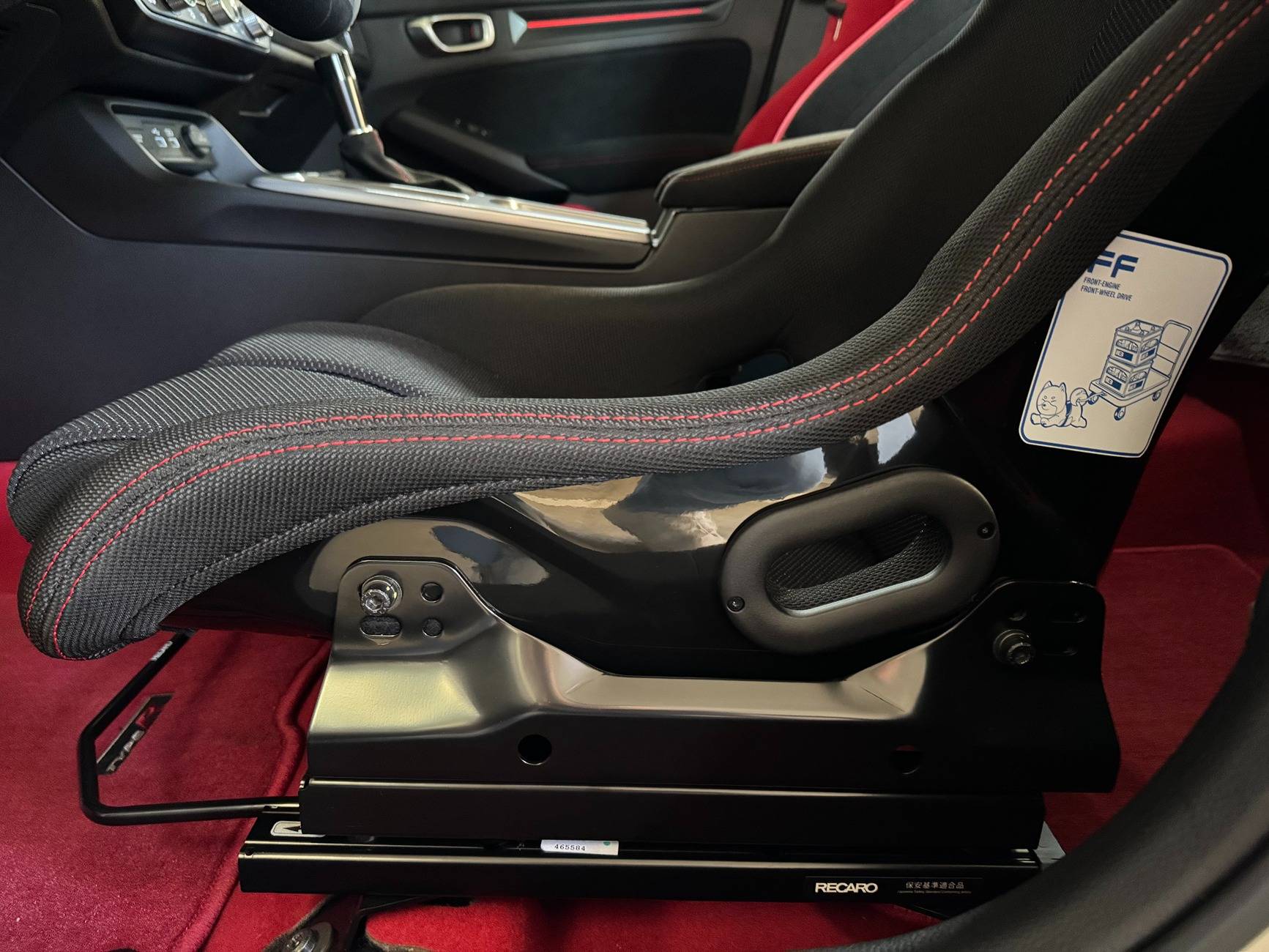

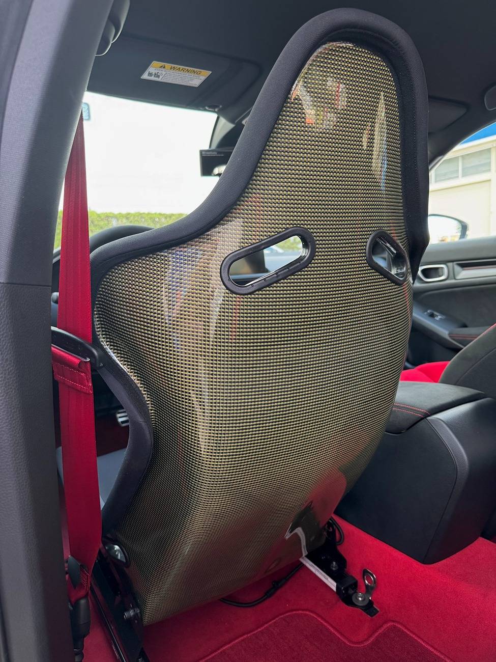

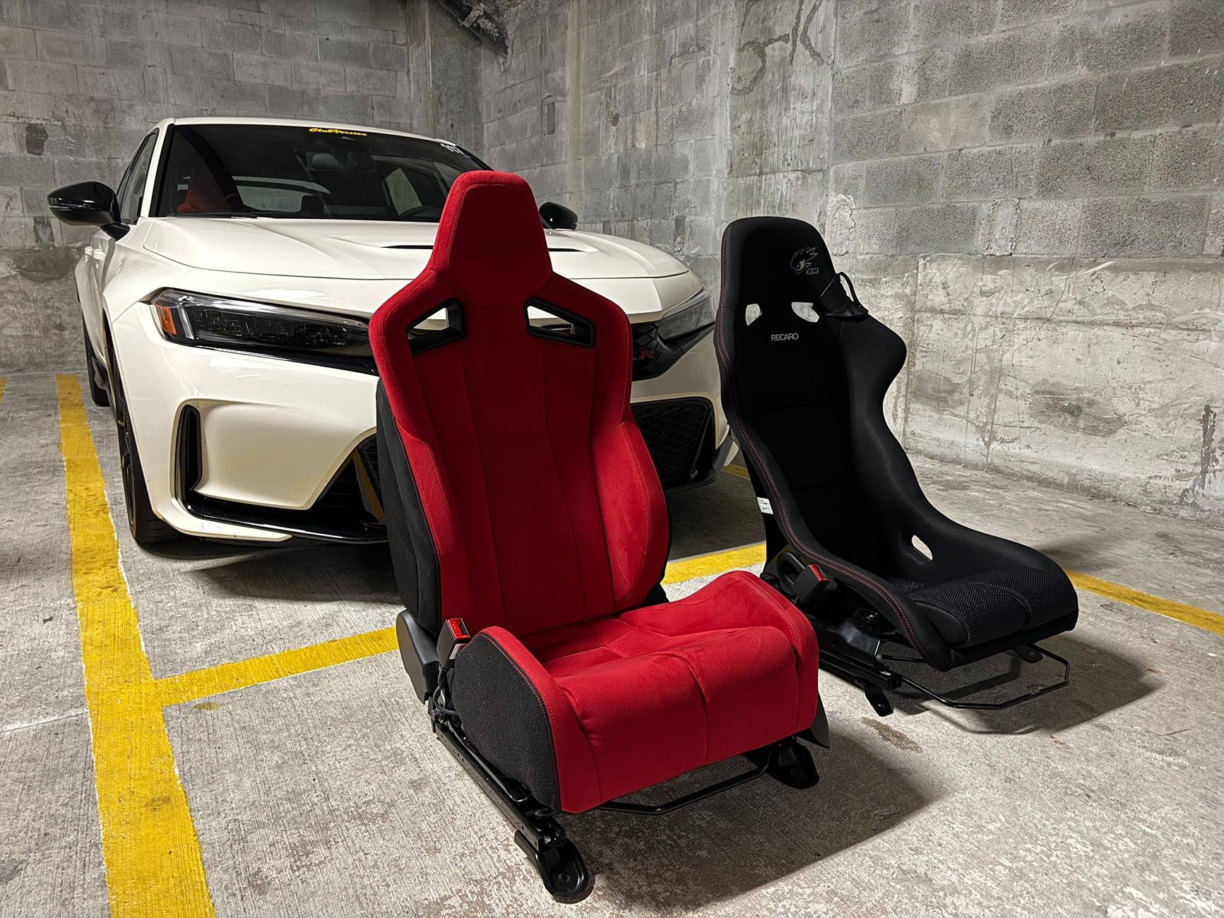

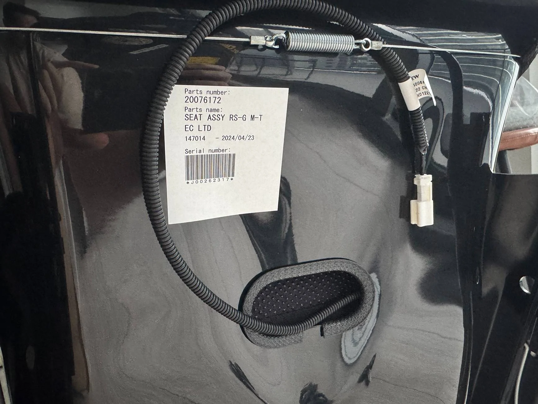

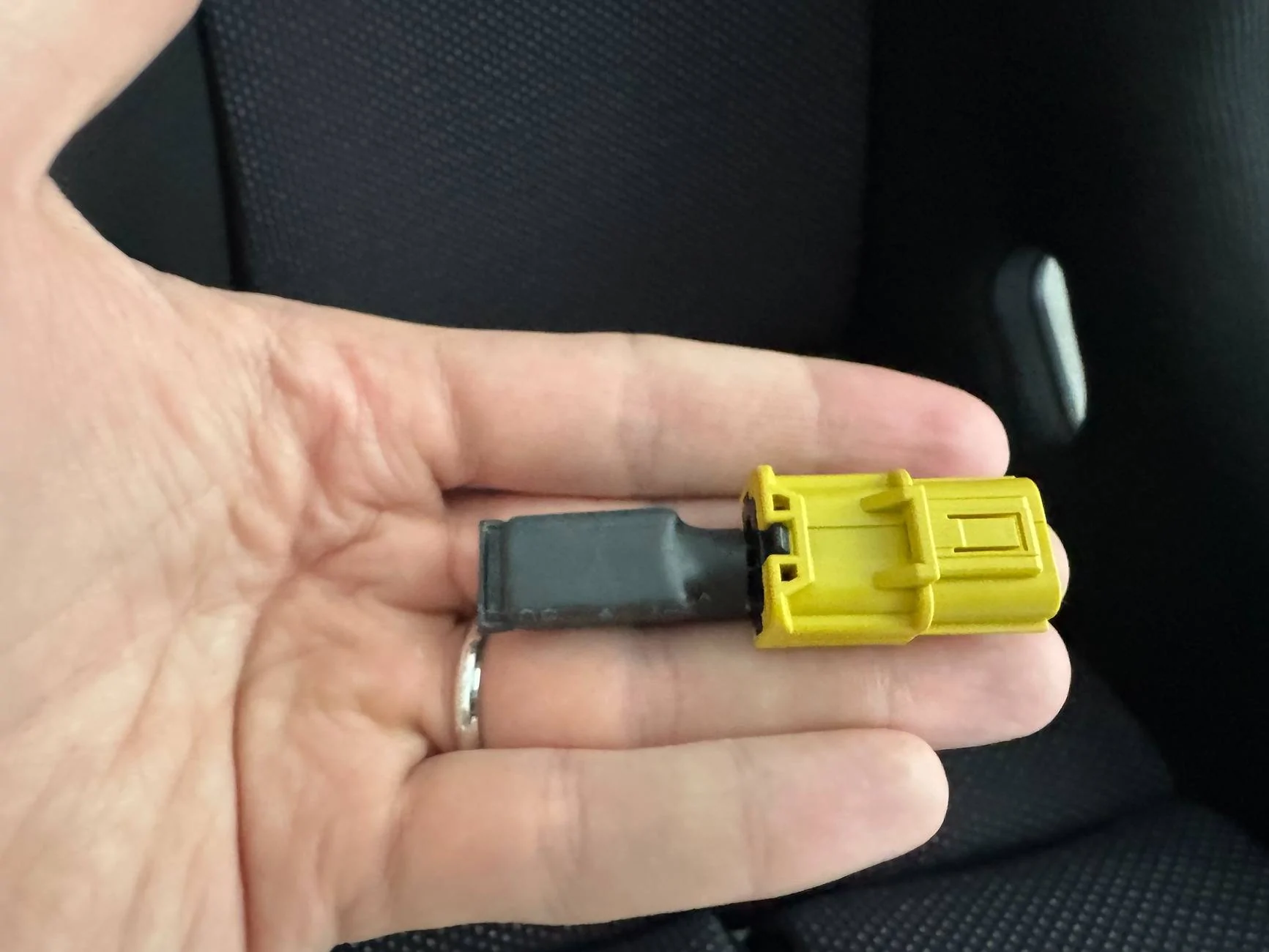

JDM Seat Goodness (Mugen MS-C Full Bucket Seat)

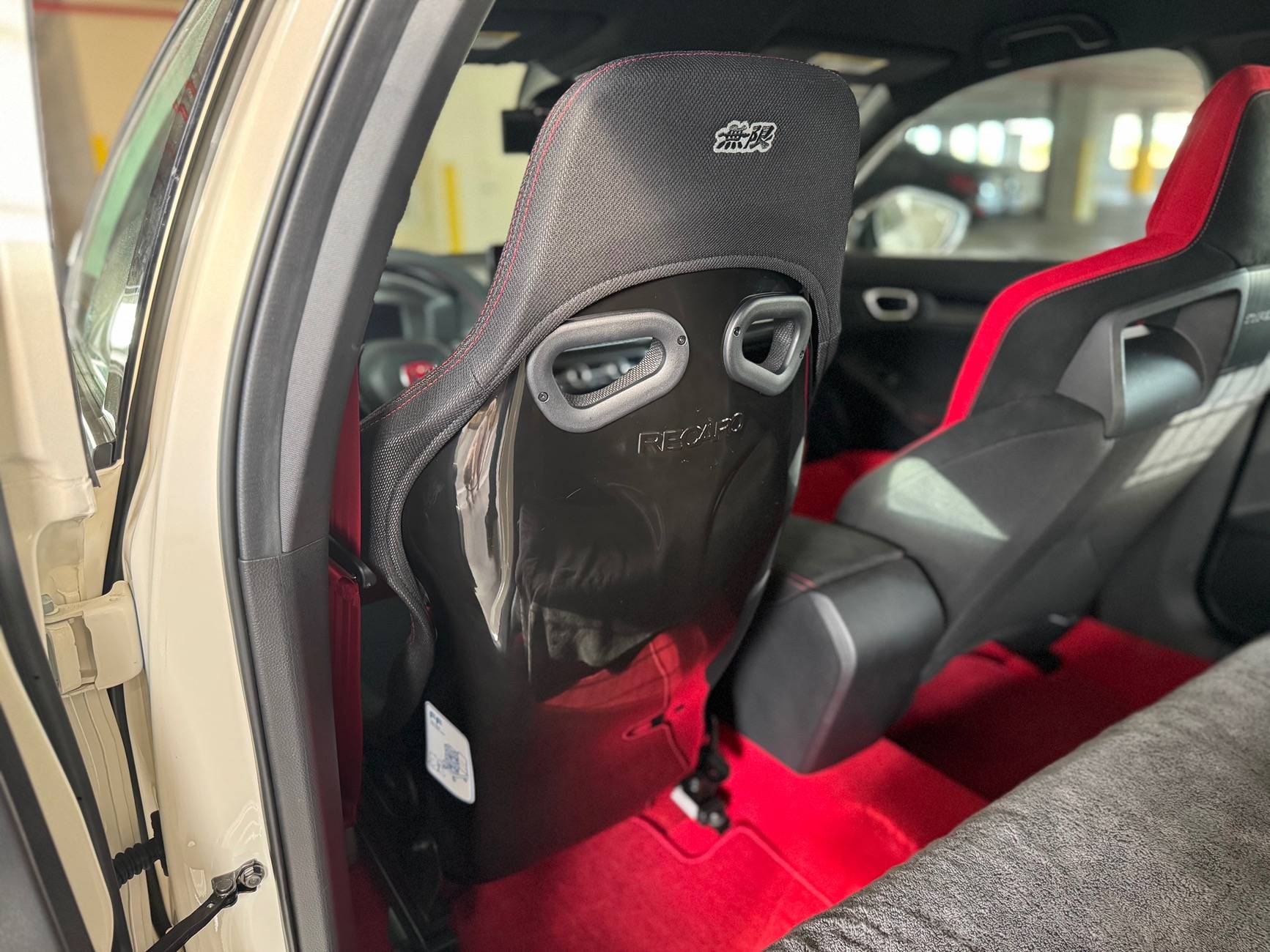

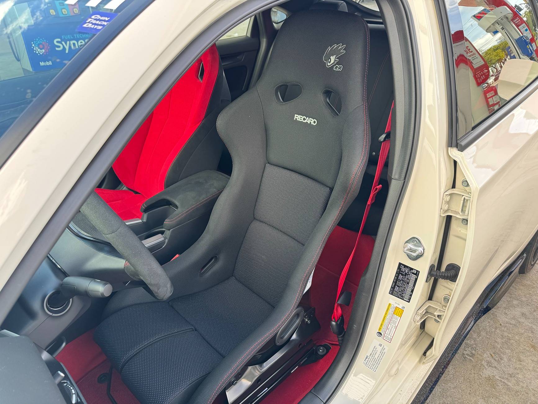

Following my recent back to back track days I noted that I really need to get a better seat to hold me in. Although the OEM seat is amazing, it does not hold you in very well once you really start to gain momentum. I was getting bruising on my knees, bottom of my left foot, and my arms kept on cramping from holding myself in the seat with the steering wheel.
After some research and accepting I'm a JDM fanboy I decided to go with the latest offering from Mugen. The MS-C seat comes with the seat rails, clearly illustrated instructions, and all necessary hardware to install in the car including a plug-in airbag seat canceler, plus you get a fancy FIA sticker. However, you still have to transfer over a couple of items over from the factory seat (ie. seat buckle and seat position sensor). The bucket does come with a seat position sensor but it is not compatible with USDM vehicles.
I do have to mention the seat fits pretty snug, as the seat mold is a JDM Recaro RSG. I'm 5'6" with waist size of 33-34 and I'm at the limit of what is bearable for this seat. Nonetheless, after driving with it for about a week I'm extremely satisfied with the fit and finish of the seat plus I shaved off about 20lbs from the car.
Upon my first impressions you can really feel how stiff the chassis of the FL5 is and when I pushed the car aggressively in the corners I actually got a bit of vertigo. I feel as if my eyes and body are not used to the new sensation of the seat, however after a day or two of driving that feeling went away. I also noticed the steering rack feels slower and I'm able to better predict the car's weight transfer, hopefully this translates to more confidence on track and some new PB's.

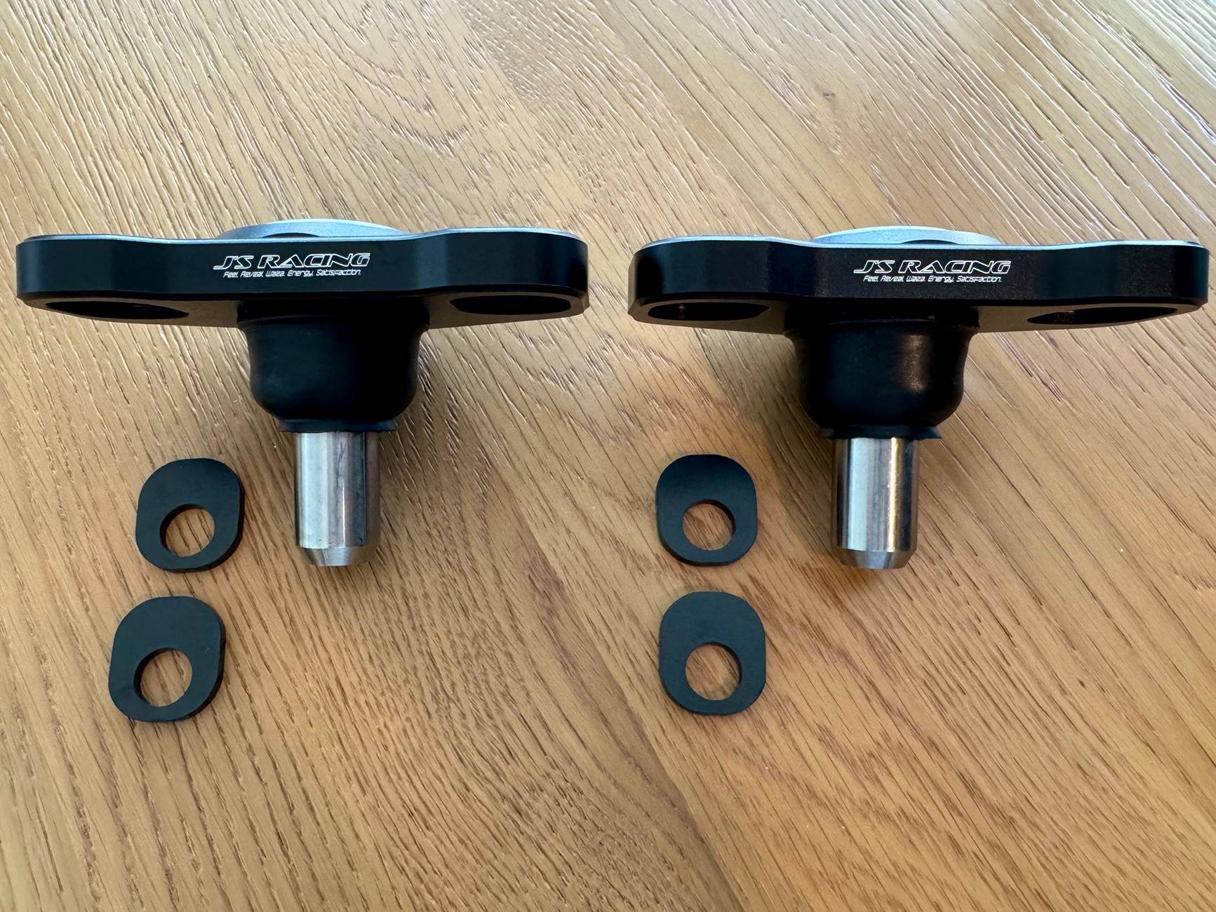

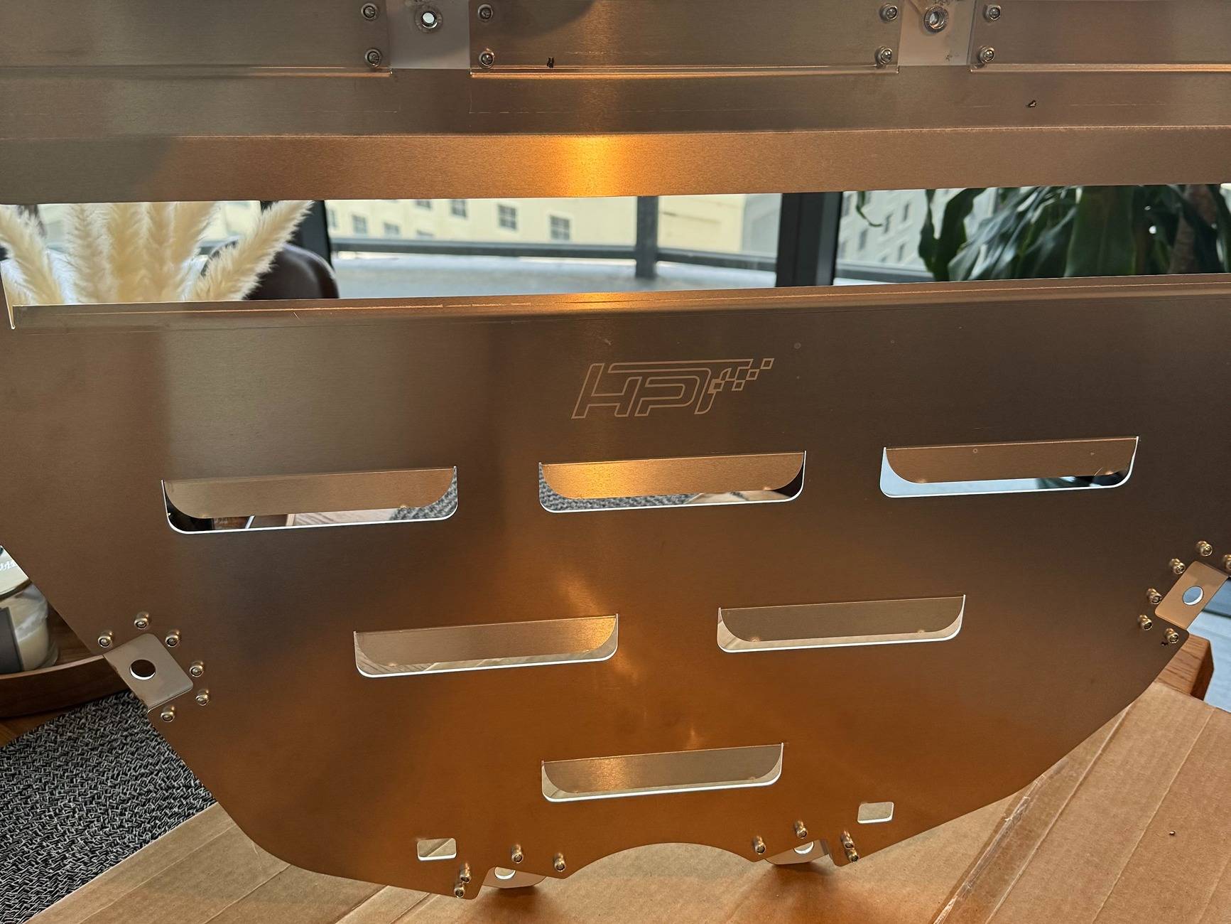

As most of you have seen online @siwelnosaj HPT cooling plate has really helped a lot of other FL5/DE5 owners perform cooler on track so I decided to get one. I have also purchased a set of J's Racing camber joints so I can finally dial in some more front camber and effectively use the entire contact patch. In addition, to help the car rotate more effectively I have purchased Accord rear end-links. Finally, I installed some Seeker SSC set to slightly improve shift feel. I'm still pending on installing the camber joints and end links but I'm shooting to have the car re-aligned and ready to go before for my next track day.
Enjoy the following pics, and check out the updated Mod List on the first page of the thread. I finally got around to organizing all the parts I've installed and what's coming in the mail ;).

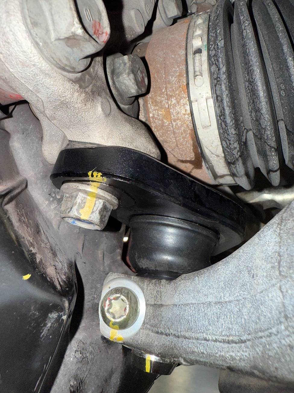

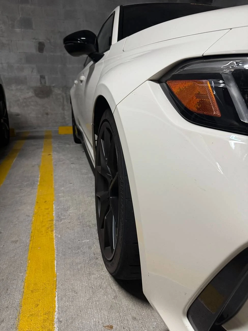

Max Camber FTW
The J's Racing front camber joint may be my favorite mod yet! Just got back from my local dealer who did the install and aligned the car. With the OE shocks and springs the final numbers came out to -4.00 degrees of camber on each side.
After some quick on- and off-ramp runs I can confidently say there is a night and day difference!! I had previously felt the car was suffering from some mid-corner understeer once the car's weight had transferred over to the outside edge of the tires, but now that feeling has completely been eliminated. The initial turn-in phase has also been vastly improved. Overall, I'm very excited to test out the new alignment at the track, but in the meantime enjoy the following install pics.
