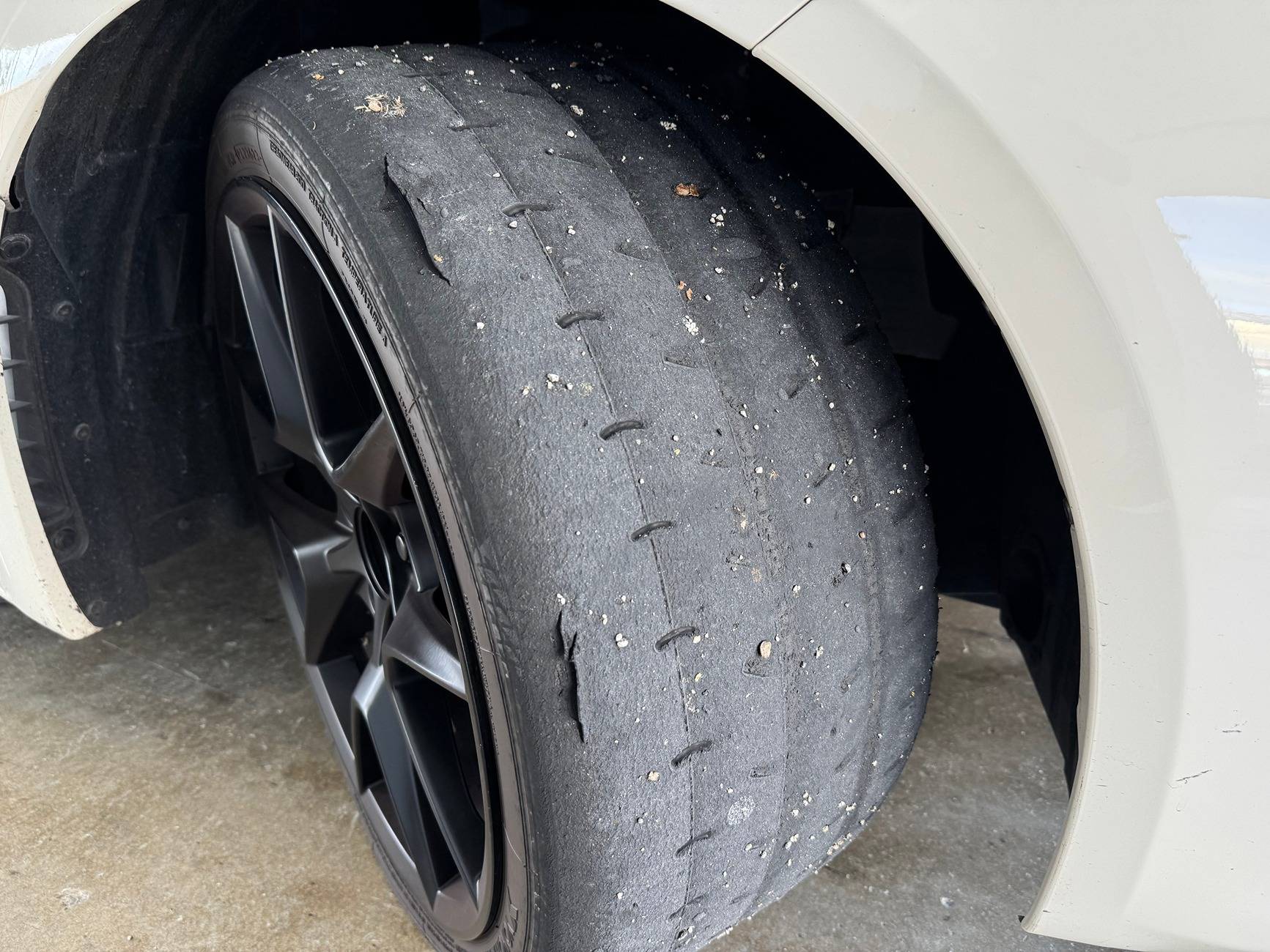

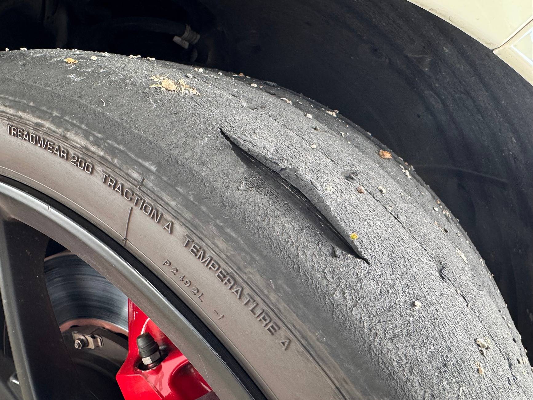

My A052's have finally given their last push laps. In retrospective I have nothing to complain about, the tires lasted 6 track days and about 8k daily driven miles. I think that's a win!
The following pics were taken from this past Sunday at the track after my first session, I knew something felt off on left hand turns.
11th Gen Honda Civic Club-Version FL5 Civic Type R Build Thread IMG_0736.JPG
11th Gen Honda Civic Club-Version FL5 Civic Type R Build Thread IMG_0734.JPG
Before you sound the alarm, yes, I know I need more front camber, yes, I have a solution coming, and yes, I already ordered new tires. My next set will be the Bridgestone RE71rs in a 255 35 R19.

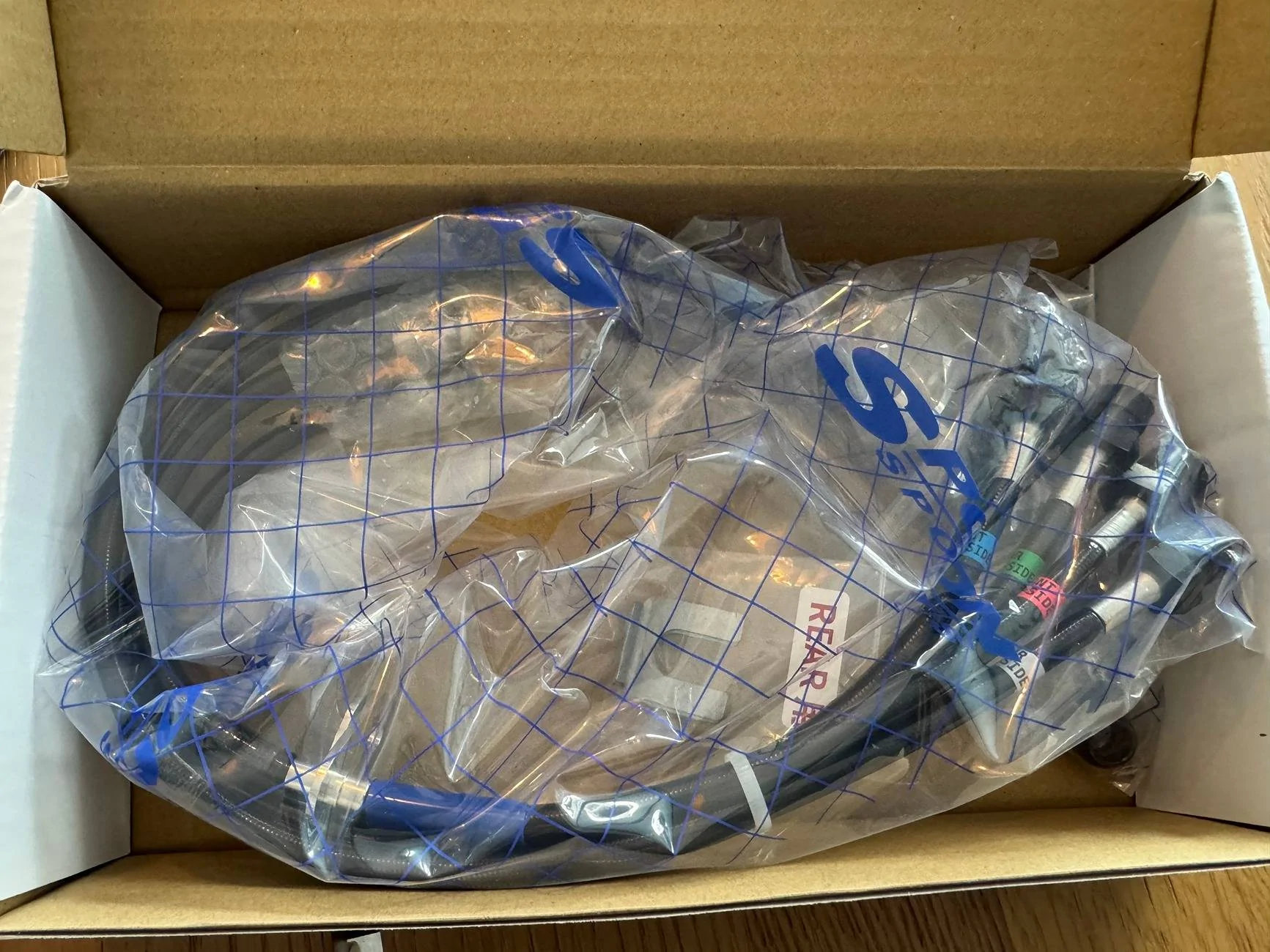

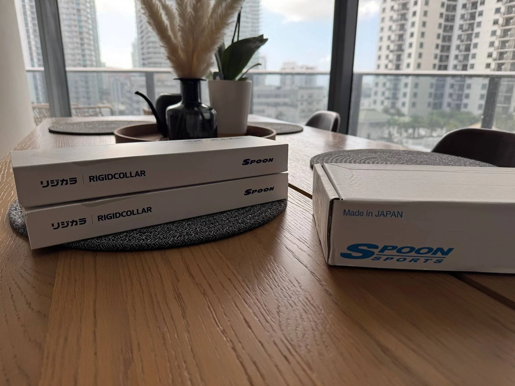

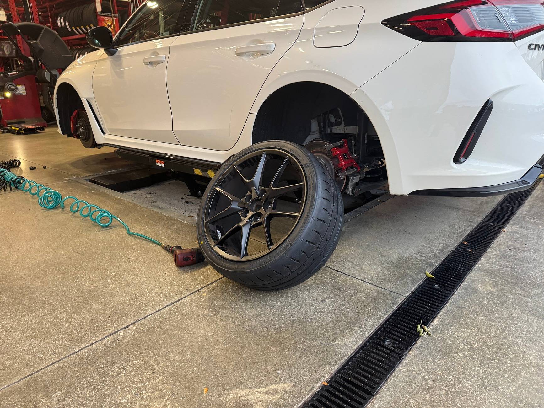

Quick Mod Update
Went out of my way and got myself some fancy Spoon Sports brake lines and Rigid Collars. Shooting to have them installed before my next track day.
11th Gen Honda Civic Club-Version FL5 Civic Type R Build Thread IMG_0890
11th Gen Honda Civic Club-Version FL5 Civic Type R Build Thread IMG_E0891
Also, I have already replaced my delaminated A052's with the king of cheater tires the RE71RS's.

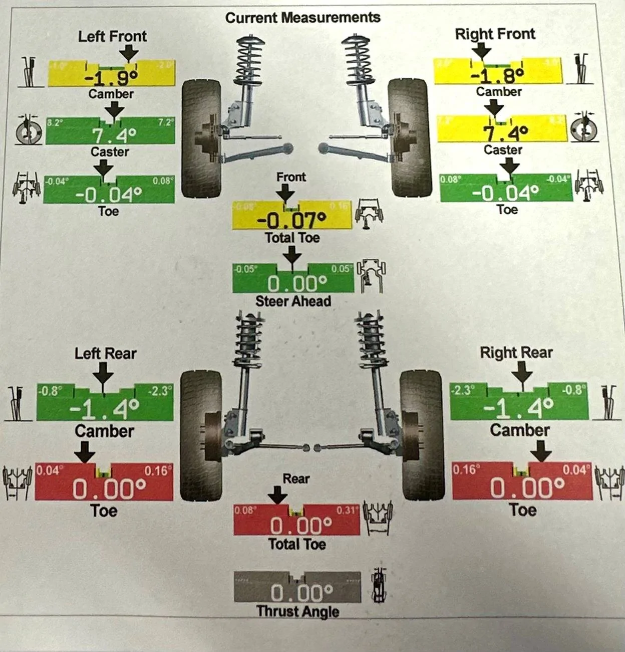

The Rigid Collar Effect is Real!!
Happy to report I got the Spoon Rigid Collars installed on the car. A local dealership was happy to install them for me and provide warranty for the install, it did not come cheap though.
It only took a day for the install and instantly upon driving the car off the lot, I noticed a smoother clutch engagement and less overall NVH. In addition, small imperfections on the road have been smoothed out, and overall power delivery has improved with less wheel hop. If you have the time or funds to get these installed I would recommend. A huge bonus too, is my alignment is much more even on all four corners; before, my caster and front camber were off by .2 to .3 degrees on each side, now they are practically even as shown below:

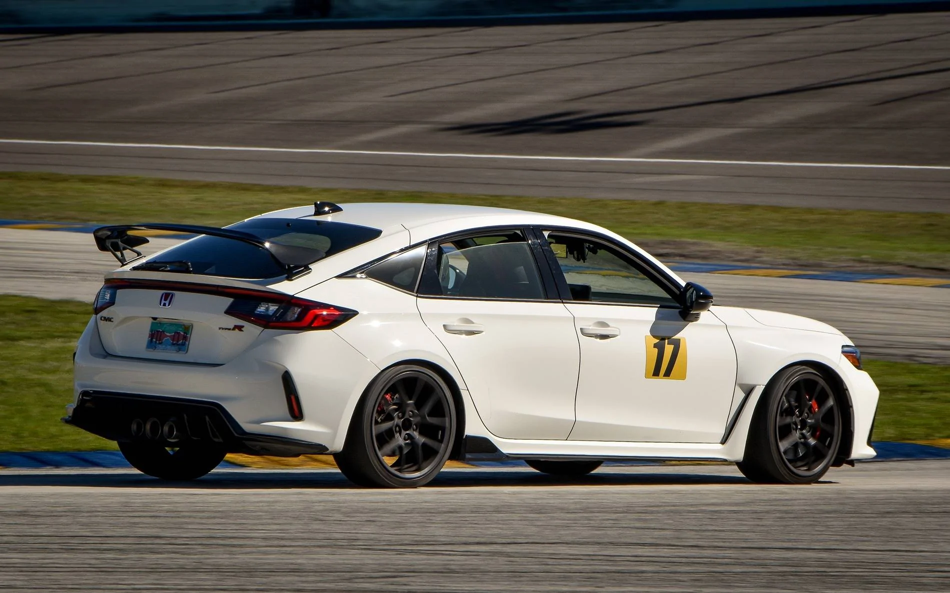

Sebring
I started off my weekend early on Friday at Sebring International Raceway to participate in the Level 2 MSF training organized by Chin Track Days. First off I have to thank all of the staff from my mentors, to the flag workers, and to the vendors on site. They all worked together to provide the best experience possible!! If anyone is interested in getting MSF certified and have the track experience you should do it, don't wait, just do it!!
From the scenarios you are put through and the insightful sit down class, promise me it will elevate you to another level as an instructor and as an overall better driver. In my opinion if they charged double or triple the price it is still worth it. On that note unfortunately I did not record my sessions with my mentors as that would ruin the integrity of the program, but I did record some POV track sessions that I will be editing and posting later next week on my channel. In the meantime enjoy the following pictures I grabbed.

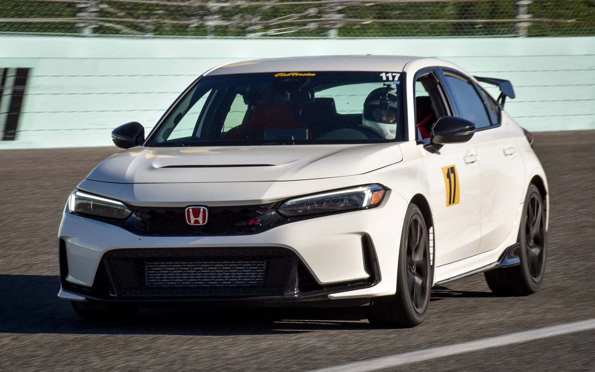

HMS
The next day I got up bright and early to attend a Track Day at Homestead Miami Speedway (AKA my home track) organized by Performance Driving Group. The weather could not have been any better to set some PB's. The morning started with 55+ degree weather and clear skies. I was able to grab my new PB (1:39.85) on the second session out around 10AM. I spent the first session dialing in the tire pressures of the new RE71RS. This time around I ended up with 31PSI in the front and 35.5PSI in the rear when hot. In addition, with the new rear sway bar I've eliminated the understeer I was experiencing on the hairpin of T8. All in all it was an amazing Track Day and I had a lot of fun instructing a fellow FL5 owner and his venture into the Track Junkie life style. Almost forgot to mention I met @Icehawk in person as well he was out there pushing the limit of the car on the OEM tires and brakes.
Enjoy the following pics and video of my PB!!
