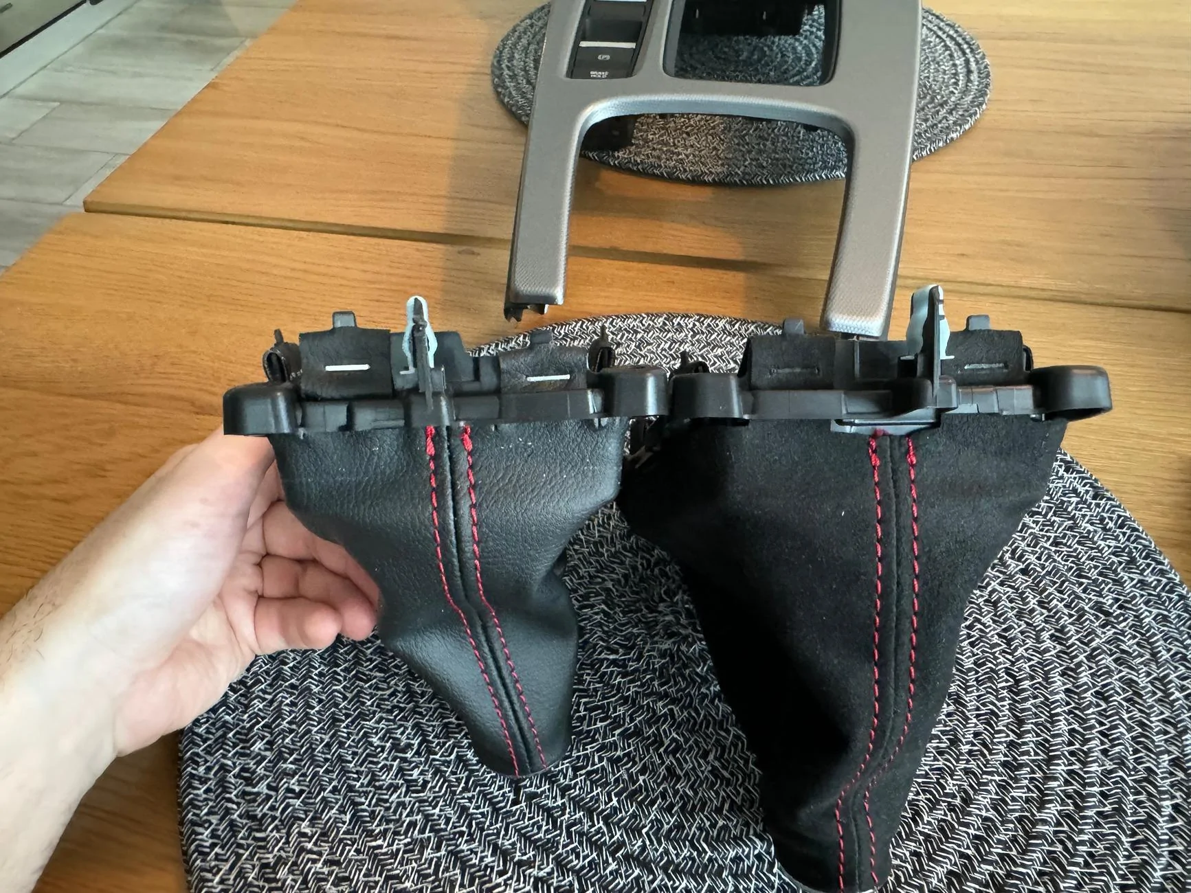

Here's the video that discusses the JDM Shift Boot. It's not a step-by-step tutorial; however, if you are handy/resourceful, it's not too difficult. A skilled technician at a reputable shop could also knock this out relatively quickly if you don't want to deal with it. At around the 5:05 mark, he discusses but does not show what needed to be done to get it to work. The comment about "creative engineering" refers to the attachment points of the JDM Shift Boot on the USDM frame. They don't all line up and you will need to perform some trimming. I also suggest using new staples. Anyhow, once you have both parts in your hand and you get to disassembling you'll immediately see the RHD vs. LHD "issue". I posted about it with a few photos in Post #298 of the CTR Initial Mods thread.

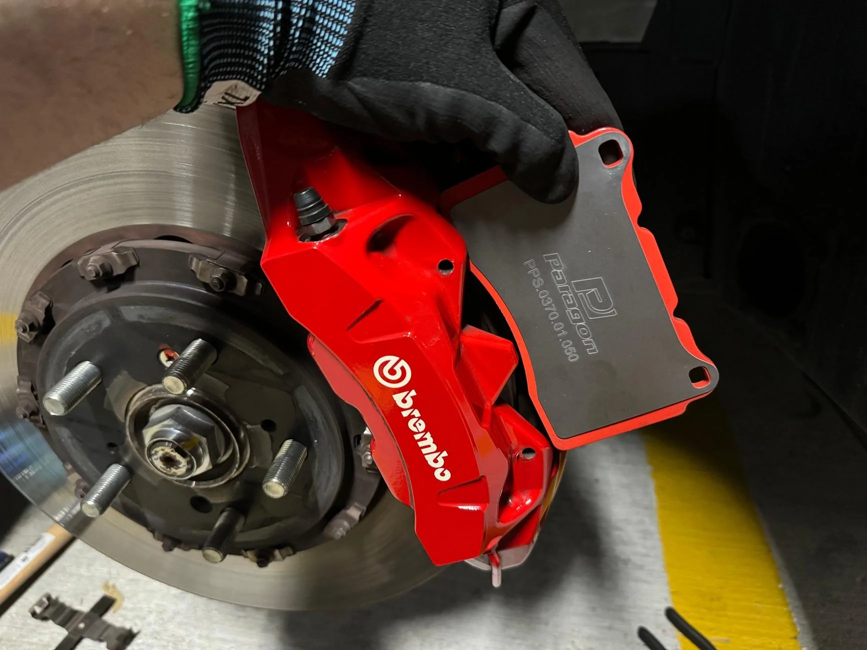

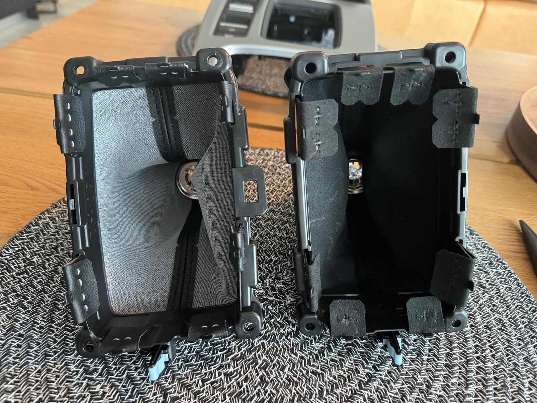

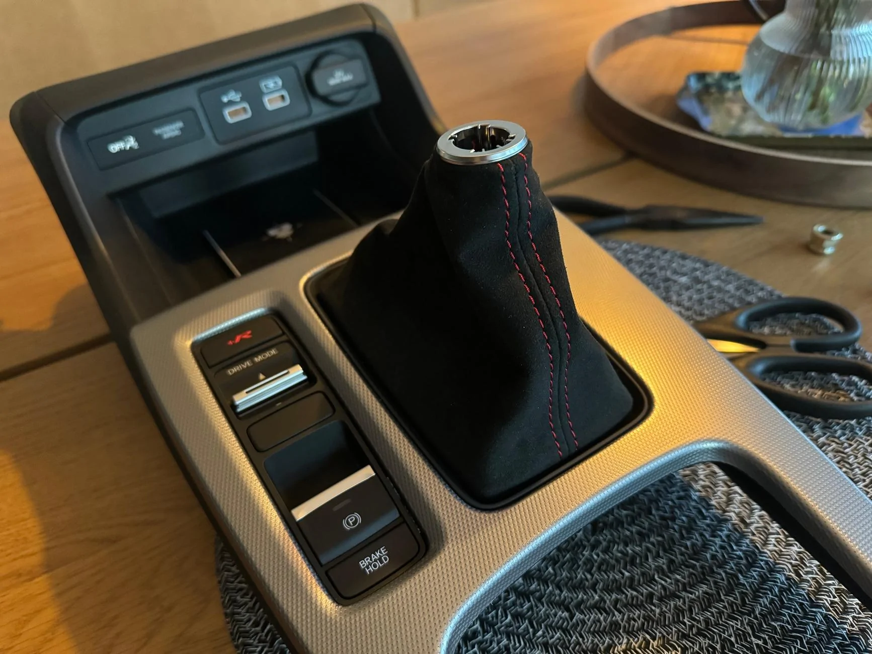

Got off my lazy ass and did the JDM shift boot swap. As mentioned by others yes, the boot frame is very different from the USDM cars. I snapped a couple of photos of the process and the differences between them. Overall, not that hard of an install just need to be patient on removing the staples of each shift boot.

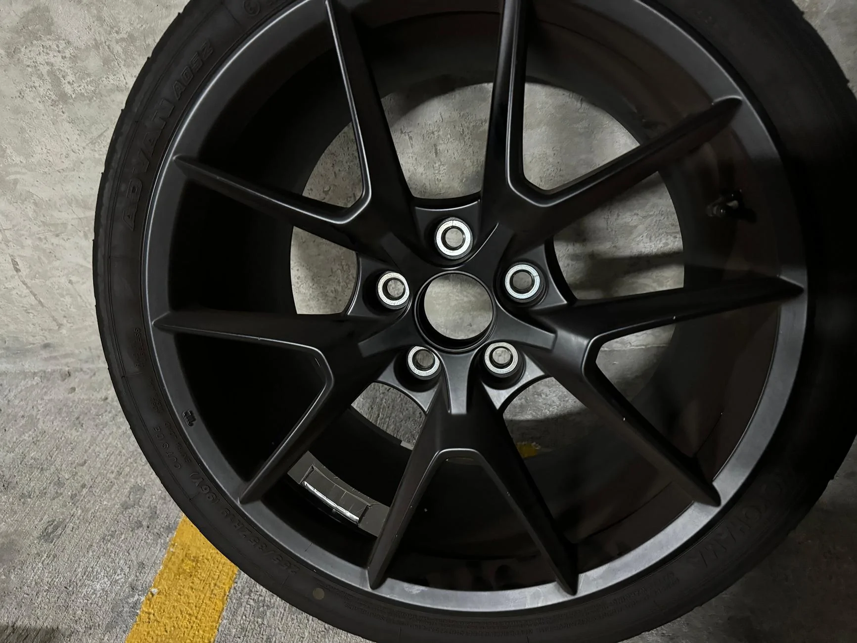

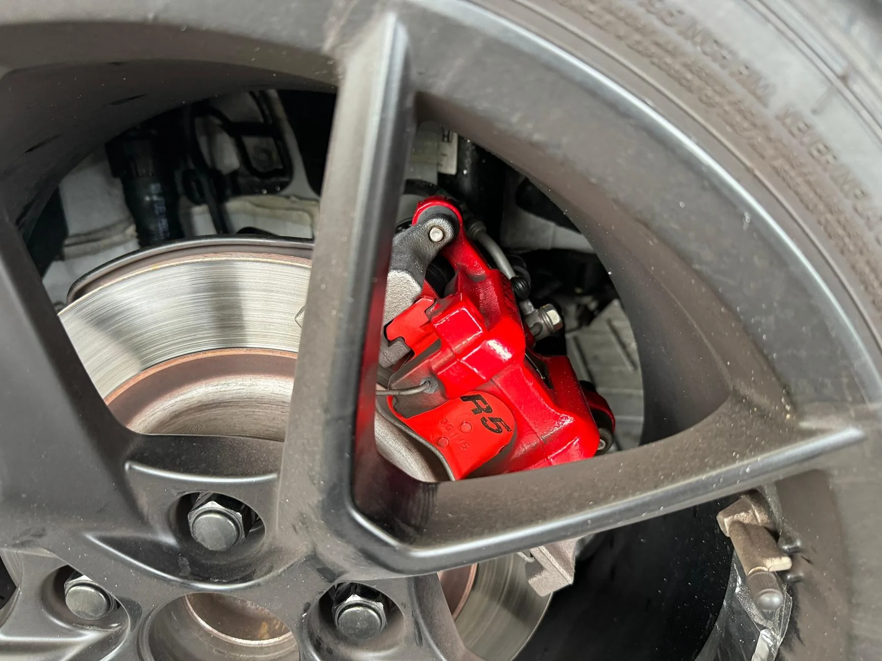

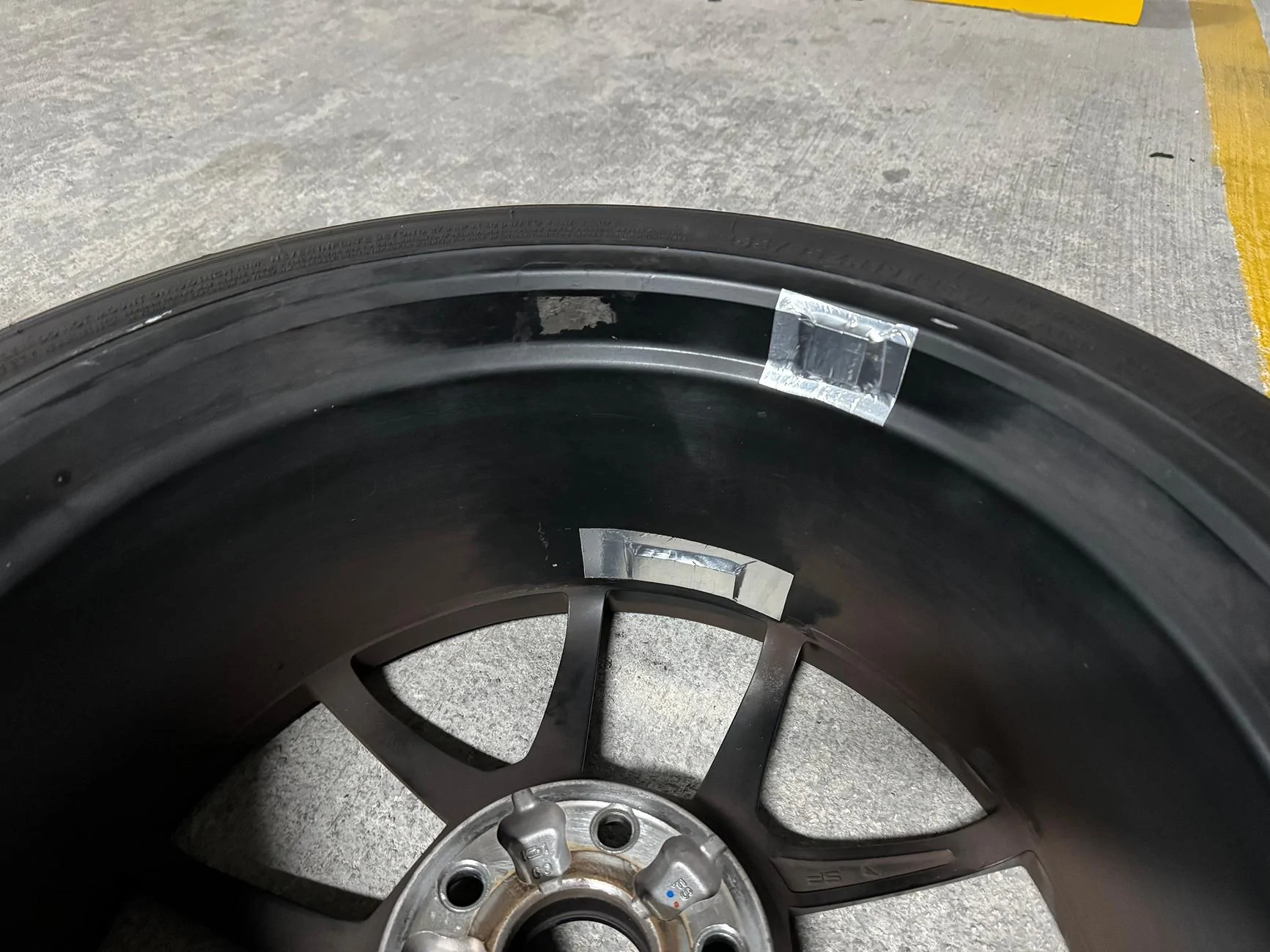

In addition to the shift boot install, I got my car prepared for the next couple of track days coming up for me. Given my Project Mu's had about 4 track days on them and they had about 15% life left, I decided to scoop up the Paragon R5 (Aka Winmax W5) pads along with the titanium shims. I also bled the brake fluid with some fresh Castrol SRF and re-taped my wheel weights with some AC insulation tape. I highly recommend to tape your weights with some type of heat insulation if you're planning on taking your car to track. It's very common to see them flying off during a track day due to increase temps. Enjoy the following install pics I snapped.

I really like the Paragon R5 Pads!!
As promised went to the track this past weekend. I pulled dual duty, instructed and drove. I had a blast out there, only let down were the tires. They have seen quite a few track days and daily driving miles so they were not up to par. Nonetheless, I made the best of it and enjoyed trying to stay with the fast guys in the Advance group. They are no Point by's in this group and I can pass anywhere.

Does the R5 squeak at every stop light?
ttccnn49
Steve
Sep 1, 2022
91
85
florida
Street triple 765RS
Thanks. That’s a no go for me then.
The first couple days it squeak loud, but after a day at track, it become quieter. but couple days after, there is faint squeak coming back...
