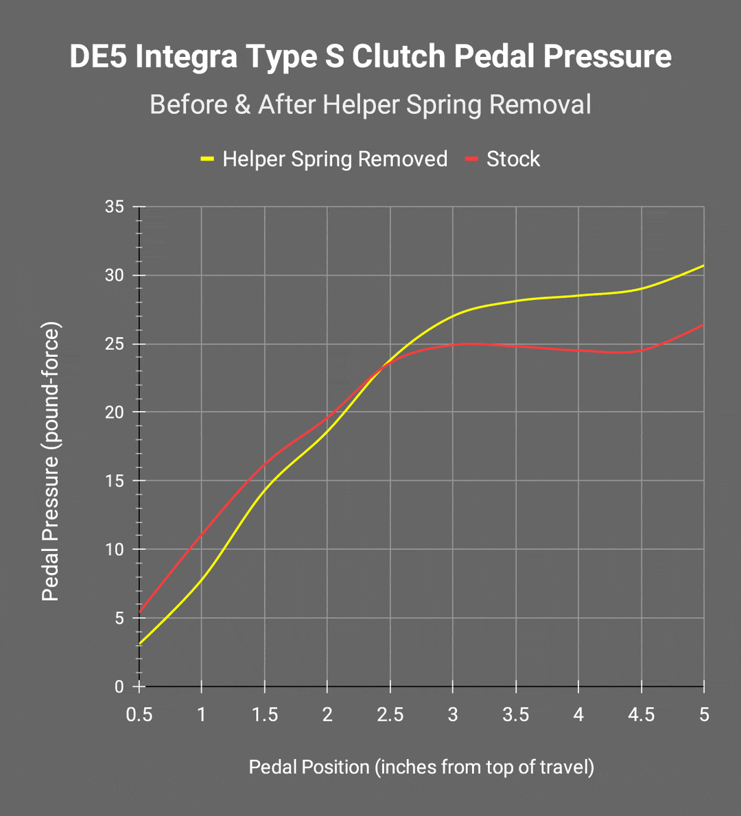

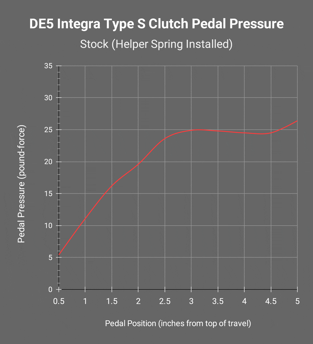

Wild to me that people will talk about a subjective difference when I went wayyyyy out of the way to provide objective measurements utilizing a load cell and then published the data for free.
Purely math here, Pearson's correlation coefficient or "r".
For the stock setup, r = 0.89
For the modified setup, r = 0.94
0 is completely non-linear, and 1 is completely linear.
So mathematically and factually speaking, the clutch pedal pressure curve is more linear with the helper spring removed than it is stock.
Speaking subjectively, is it your subjective opinion that a clutch pedal feels better the less linear it is? Is that the argument you're going with? In that case, can you argue why installing a heavier helper spring wouldn't make the clutch pedal feel better?

I'm asking you to argue a conditional hypothetical in support of your subjective opinion that clutch pedals feel better when they're less linear. I didn't insinuate that you ever said that a heavier helper spring would be better, what I'm saying is that if less linear clutch pedals feel subjectively better to you than more linear ones, then it follows that a heavier helper spring than stock would make the clutch pedal feel subjectively better than stock by decreasing the linearity.... unless you have some argument to the contrary that somehow doesn't contradict your previous statements?

You used the example of one of your other manual vehicles, which is a manual Tacoma. It does not have this clutch pedal helper spring, and it feels natural to you.
After seeing your chart and watching your video (great job, by the way), it does make sense that the DE5/FL5 feel perhaps unnaturally smooth in clutch pedal travel.
[snip]
Out of all of these vehicles that I have owned, the ONLY TWO that I ever felt had "heavy" clutch pedals were the '94 Caravan and the 2005 Forester XT. The "T" stands for "Turbo", and for some reason, that XT had a really heavy clutch.
So I want to be as clear as possible on this point: the pedal feel and the pedal weight are only tangentially related. This purpose of this exercise was not to make the clutch pedal heavier, that was a side effect. The clutch pedal is still among the lightest of the higher-performance cars I've ever driven. It was already light and a 16% increase isn't going to make a light pedal feel heavy. A 16% increase certainly isn't going to make my wallet feel heavy. ?
The clutch helper spring pushes in two different directions on the pedal depending on how far you push it down. This causes the clutch pedal to behave differently at different points along the full range of motion. This is not intuitive behavior, and when you're trying to *rapidly* find the perfect bite point on the clutch for a given situation, it's just a disaster.
I have a feeling that a LOT of you have not done track driving before. Don't take it as a slight, it isn't meant to be. The majority of people who own track capable cars never take them to a track. Track driving requires a combination of precision and speed that most people have never consistently put together in their lives. They might be able to do one or the other, but not both. It takes a lot of practice and screwing up. It also will just destroy your ego around your driving abilities, and most men aren't mature enough to give up on the idea that they are god's gift to driving.
If you are braking from 140mph-40 in order to enter a turn, you might be heel-toe downshifting two or three times in rapid succession (say 5th to 2nd in this example) while also pressing the brakes as firmly as you can without getting too far into the ABS or locking them up if your car doesn't have ABS.
In that situation, anything weird going on with the clutch modulation, the brake modulation, or the throttle modulation is going to cause you problems.
In particular with heel-toe while braking hard, if you fumble that you are going to cause the drive wheels to lock up momentarily. A little too much engine braking from a not-quite-right downshift can be a disaster.
This translates to street driving as well (and I'm sure someone will be along to tell me yOu dOnT nEeD tO hEeL tOe oN yOuR dAiLy cOmMuTE) because those skills you use on track are quite perishable and need to be tuned for specific cars. I have a turn at an intersection I make every day where I'm slowing down from 60mph to 15mph or so, and I make sure to downshift from 5th to 2nd every time. I usually just rev match the 5th-4th shift, and heel-toe the 4th-3rd and 3rd-2nd. Why? Because it's excellent practice even if I'm not braking hard. It all translates.
And for the record: any kind of auto-rev matching stays off in my vehicles. I've only ever owned two that have that feature. Auto rev-match will mask the poor clutch feel because it does something that a heel-toe blip cannot: it can blip the throttle and then perfectly hold RPM, which will hide your errors with timing and clutch engagement. I don't buy manuals in order to have the car do part of the manual experience for me. If I was into that, I would just get a DCT and push buttons and ride around on D all day.
