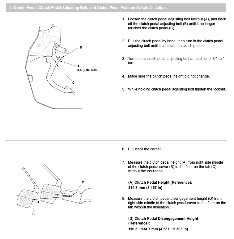

Is this how you adjust your clutch pedal? A and B shown in step 1?
Yes and no...
Same bolt, but adjusted by feel, to minimize free play.
I never measured the height...
I just measured the height from floor to middle of clutch pedal, about 160mm 212mm from "tab C"
The clutch pedal as is, after I increased free play a bit, is fairly high, and I hit the top of my knee on the steering wheel. I would not want it any higher
note that in my car there is no insulation to pull or remove. nor could I feel any "tab"
the insulation is about 10mm

update, I measured wrong.
originally I measured where the ruler and clutch pedal made a 90 degree angle down to the carpet.
I now found more images, and located "tab C"
When measuring to "tab C" the ruler is nearly horizontal, and the measurement is 212mm
