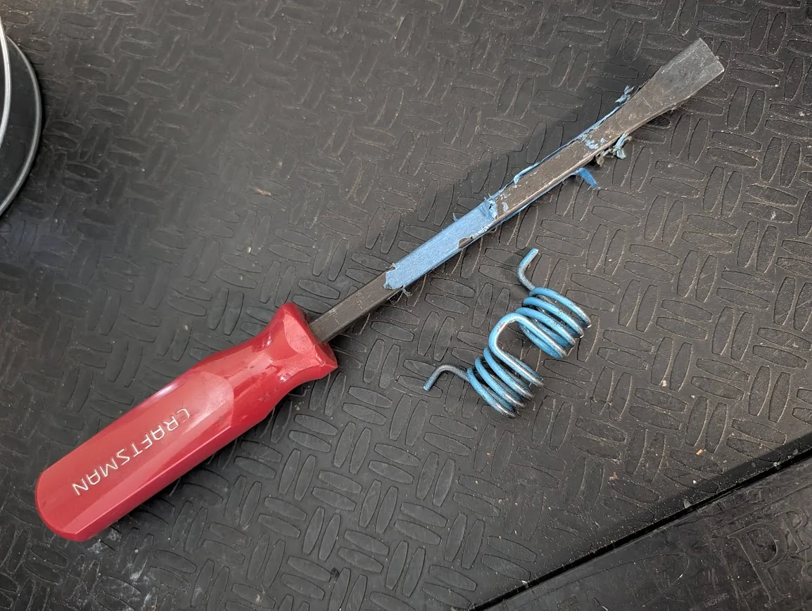

I removed the clutch helper spring. Took 30 seconds using a pry bar. Once I dislodged one side of the spring, the entire spring fell out. Afterwards I took a 12 mile test drive on streets during rush hour traffic (lots of stop-and-go). Here are my observations:
  • Clutch pedal resistance is linear (or progressive?), like the gas pedal. WIth the spring I felt a drop in resistance past the halfway point. Feel the difference in pressure between your clutch and gas pedals (while car is off). Clutch has a peak pressure point halfway, then the pressure drops towards the bottom. Gas pedal has consistent pressure all the way.
  • Without the spring, there is less resistance at the top (starting to press the pedal) and more resistance at the bottom (pedal fully pressed). Holding the clutch pedal down at a red light for a minute feels more fatiguing. Not a deal breaker for me.
  • Without the spring, the clutch engagement point feels further down (60% pedal pressed). With the spring, the engagement point felt higher (30% pedal pressed).
  • Without the spring, less pressure is needed to press the pedal past the dead spot at the top of the clutch. The spring must be applying pressure to keep the pedal up. Without the spring, simply resting my foot on the pedal (not pressing/applying pressure) is enough to move the pedal through the dead/play spot to the point where I have to start applying pressure. Without the spring, the pedal still fully returns to the top position (video below). This is probably why the engagement point feels further down.
My K20C2 Civic is purely a commuter. My goal is to increase tactile feedback. I don't know how to heel-toe or rev match. 🙈😆

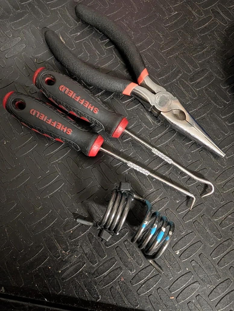

Based on my experience installing/removing (sometimes blindly) nuts, bolts, and clips in very tight spaces, I think it's possible to reinstall the helper spring without removing the clutch pedal assembly. With the right tools and zip typing the coils (pic below), it looks possible. It may take a hour of cursing and sweating, resulting in sore fingers the next day. 😅
To be clear, I am not reinstalling the helper spring. Taking out the spring exposed how much slack/play there is at the top of the clutch pedal. I'm going to lower the adjuster bolt (righty tighty) to remove the slack/play.

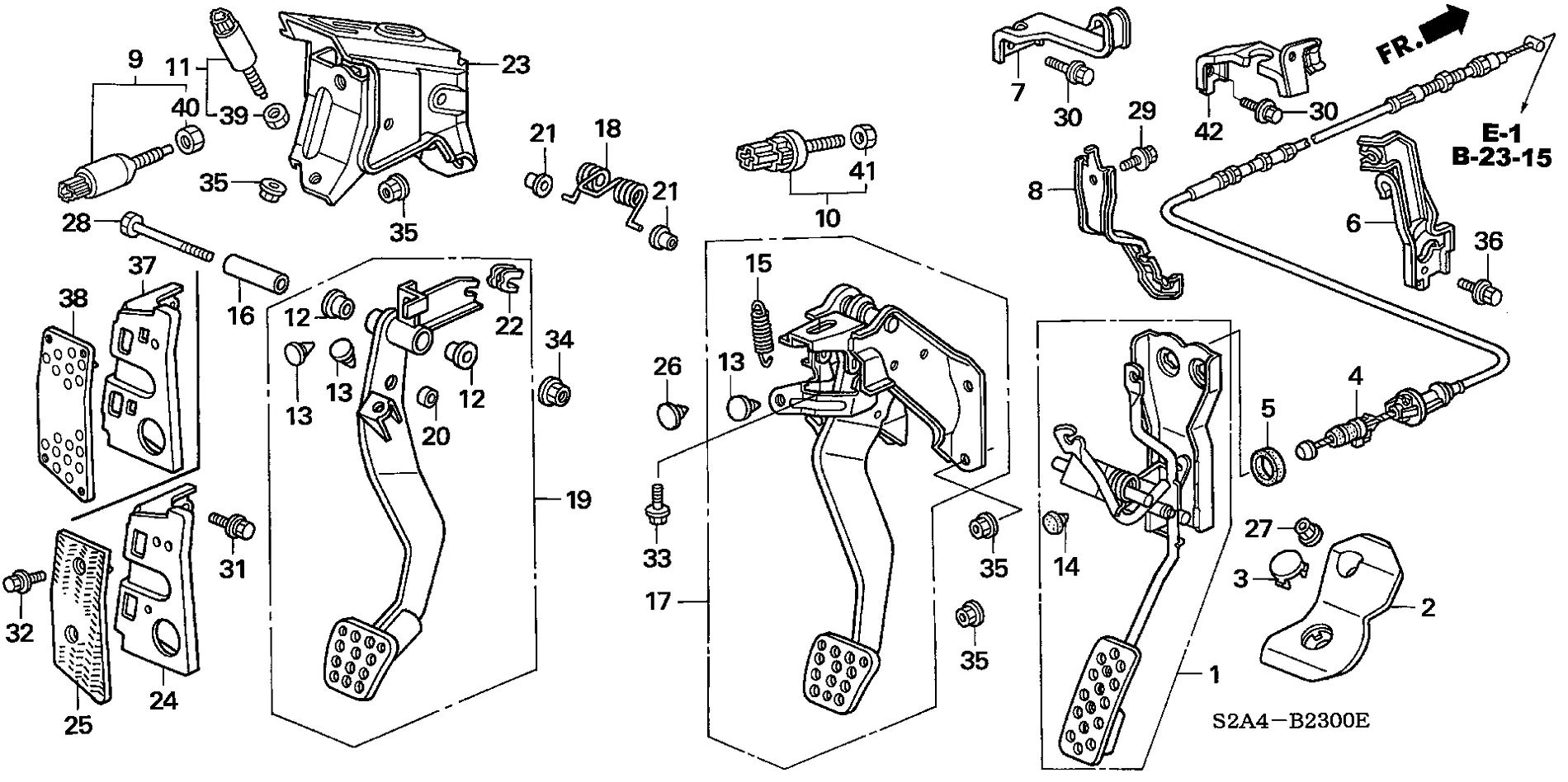

This is the exploded parts diagram for S2000 pedals, clutch on the left obviously.
Looks awfully familiar, doesn't it?
11th Gen Honda Civic Clutch helper spring delete 1788634462918-37
What's a little hard to tell just from that parts diagram is whether or not the spring is being used as a break-over-center design. I think it might be.

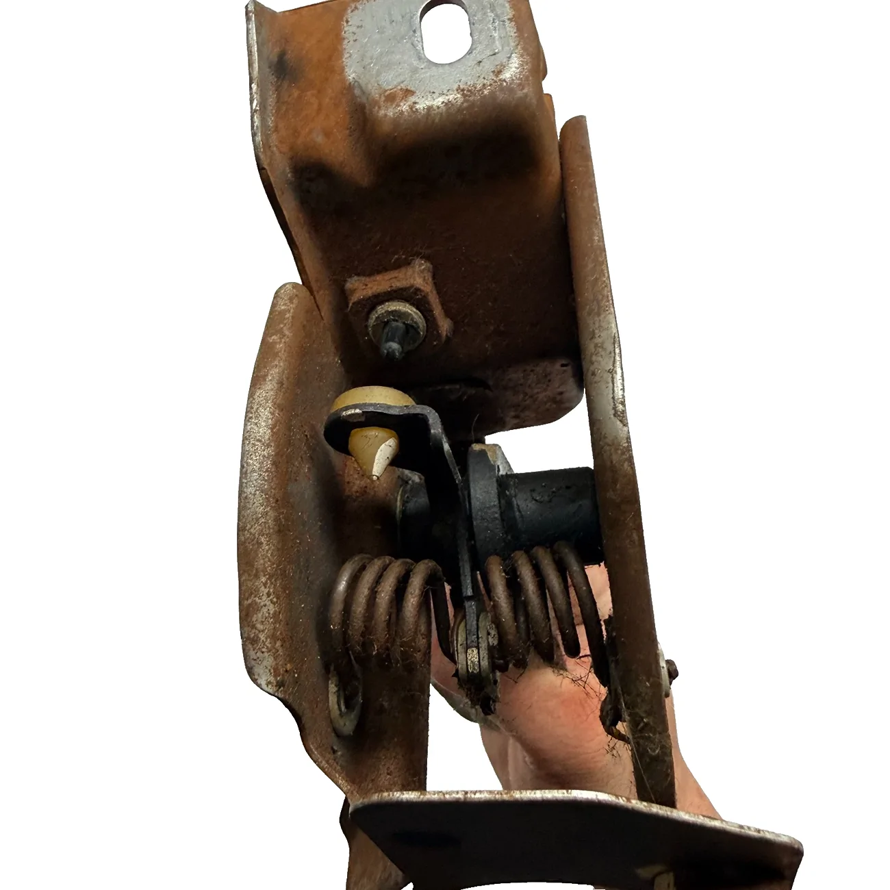

Here's a picture of a used S2000 pedal I found on eBay:
11th Gen Honda Civic Clutch helper spring delete 1788639127905-ch
This is looking at the top-side of the assembly, and you can see that the pedal is fully up because the clutch start safety switch isn't engaged. For it to be a break over center design, the spring must be able to rotate such that it can start to unwind in the bottom half of pedal travel. I think I see that there.

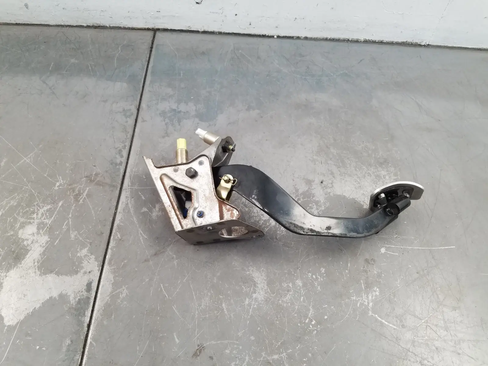

Another tell is that the pedal will snap to either the fully up position *or* the fully floored position, since when the spring breaks over center it can push in either direction. Here's a picture of an S2000 pedal in the fully floored position and the spring appears to be in place:
11th Gen Honda Civic Clutch helper spring delete 1788639306616-qu
My educated guess would be that as long as the S2000 has a master cylinder with an internal return spring, that you could do this same thing on the S2000 without getting pedal sag.
