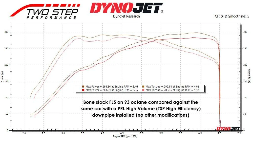

Back to downpipe data - I was able to pull this from our laptop, recorded in January of 2023. It was a much simpler (and boring!) time... No Hondata support, no FL5 specific parts, just the downpipe that carried over from the FK8. :D
11th Gen Honda Civic Downpipe differences Bone stock FL5 on 93 octane compared against the same car with a PRL HVDP (TSP HEDP) downpi

So I'm confused, is the design of the TSP downpipe only at the size it is because it's trying to achieve a similar level of performance to the other pipes and still not give a CEL? Why don't competitors follow a similar philosophy if that's the case? I can't imagine a single person who thinks having a CEL all the time is okay.
Was wondering the same thing.
A smaller 3” downpipe with a 200 cell cat might make similar numbers as TSPs 5” 400 cell downpipe in theory.
That’s where I’m at… do I spend the extra money on a $950 TSP downpipe or go with the $595 Maperformance downpipe or $750 on the RV6 downpipe and use that extra $200-$350 saved on a tune that will stop the check engine light
