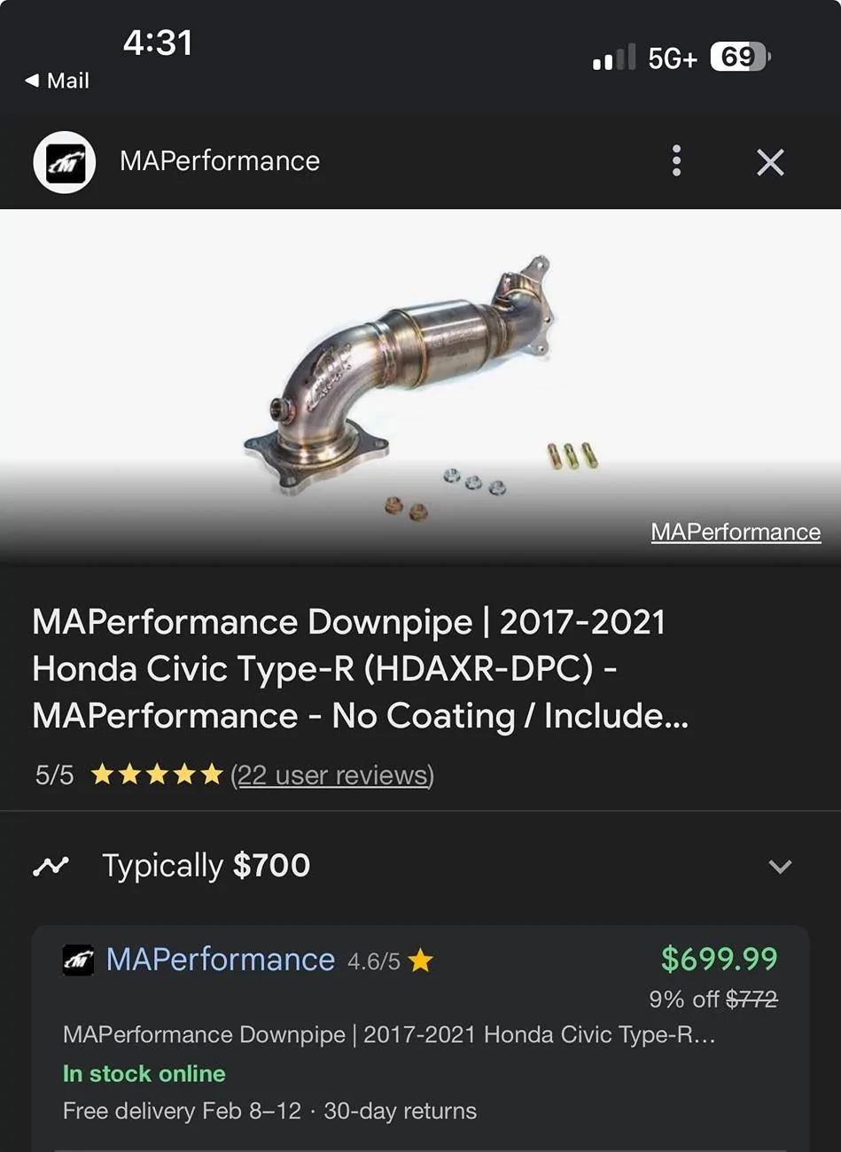

TSP downpipe is $1000, RV6/MAP downpipes seem to be around $699
$1000 is a lot for 10 whp, I agree.
$699 for 10WHP and the better exhaust sound seems a bit more worth it.

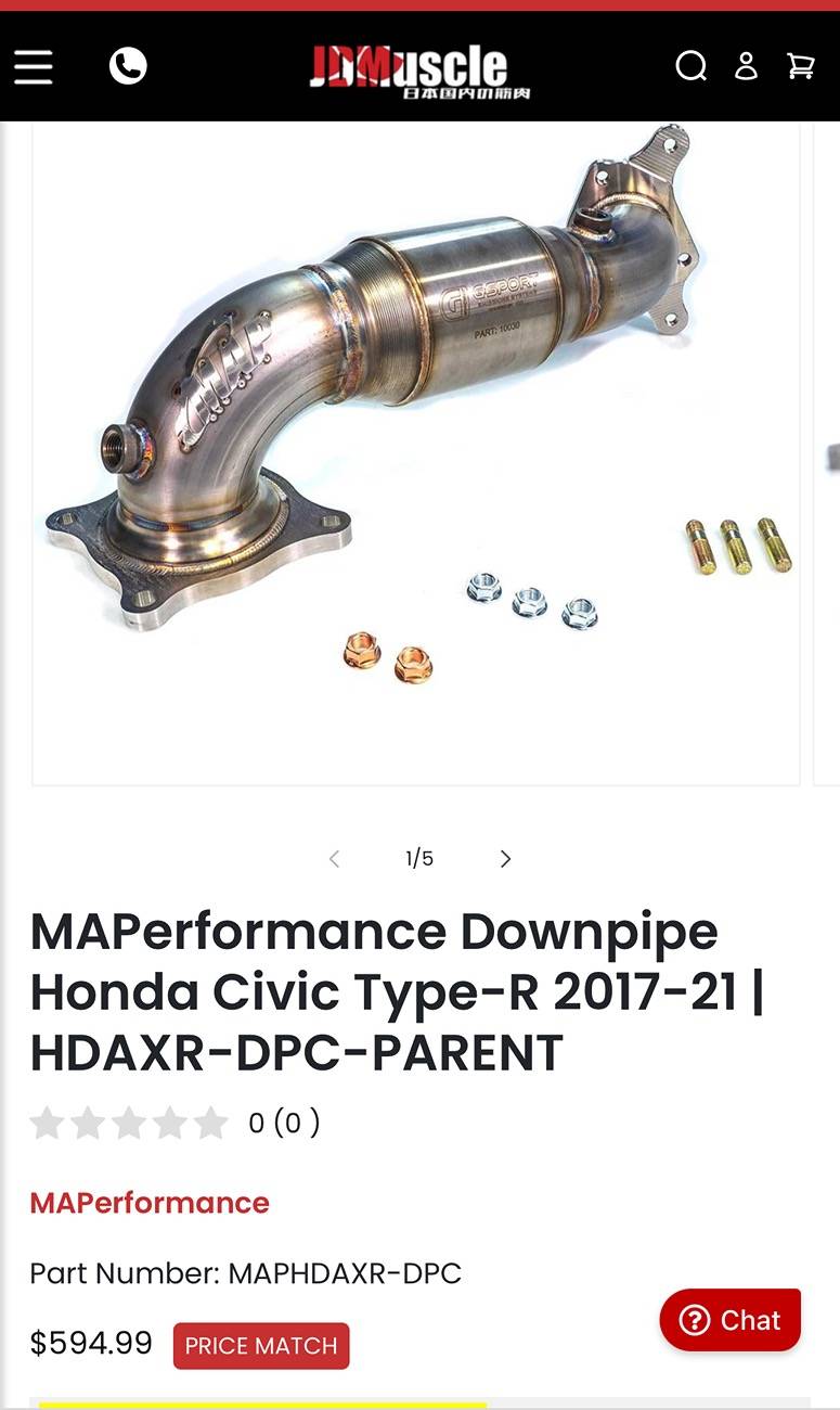

Even better. $594.99 for a new one
