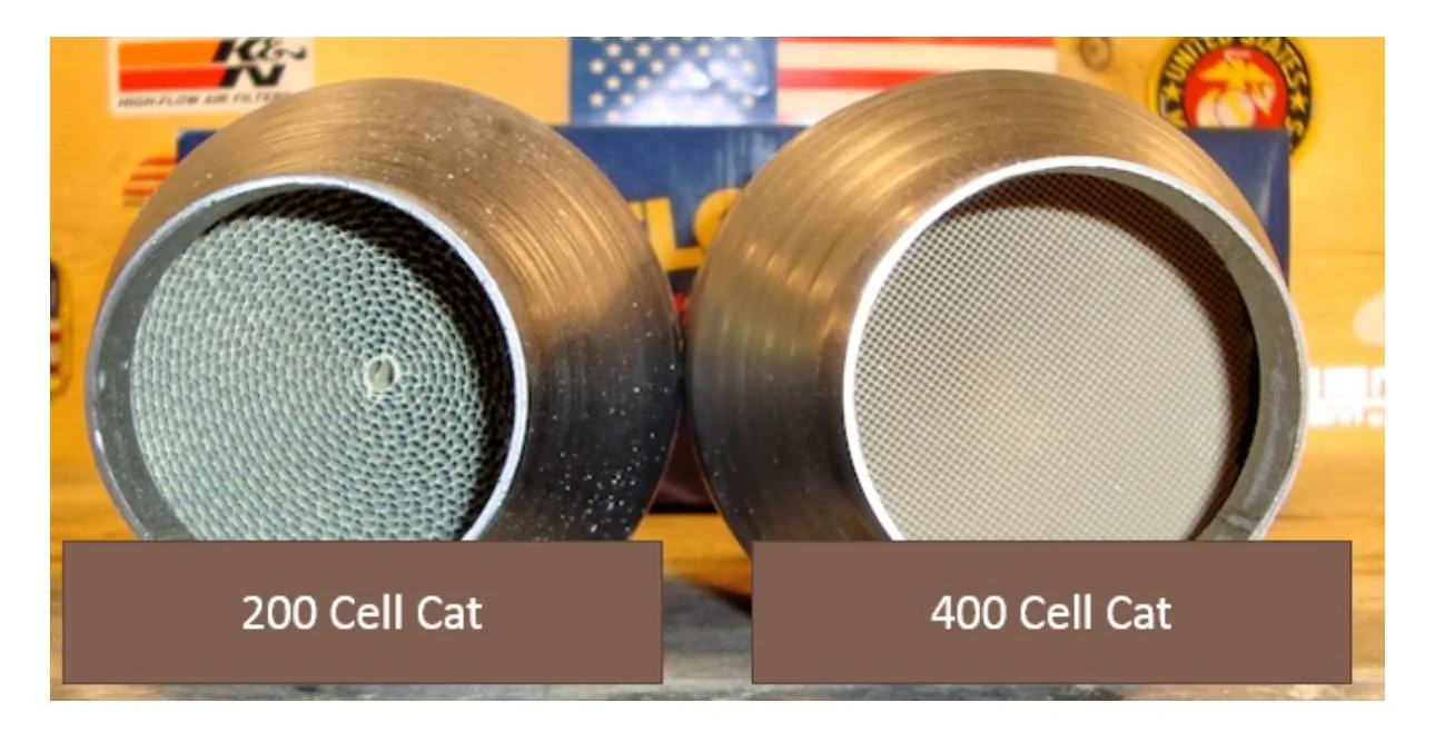

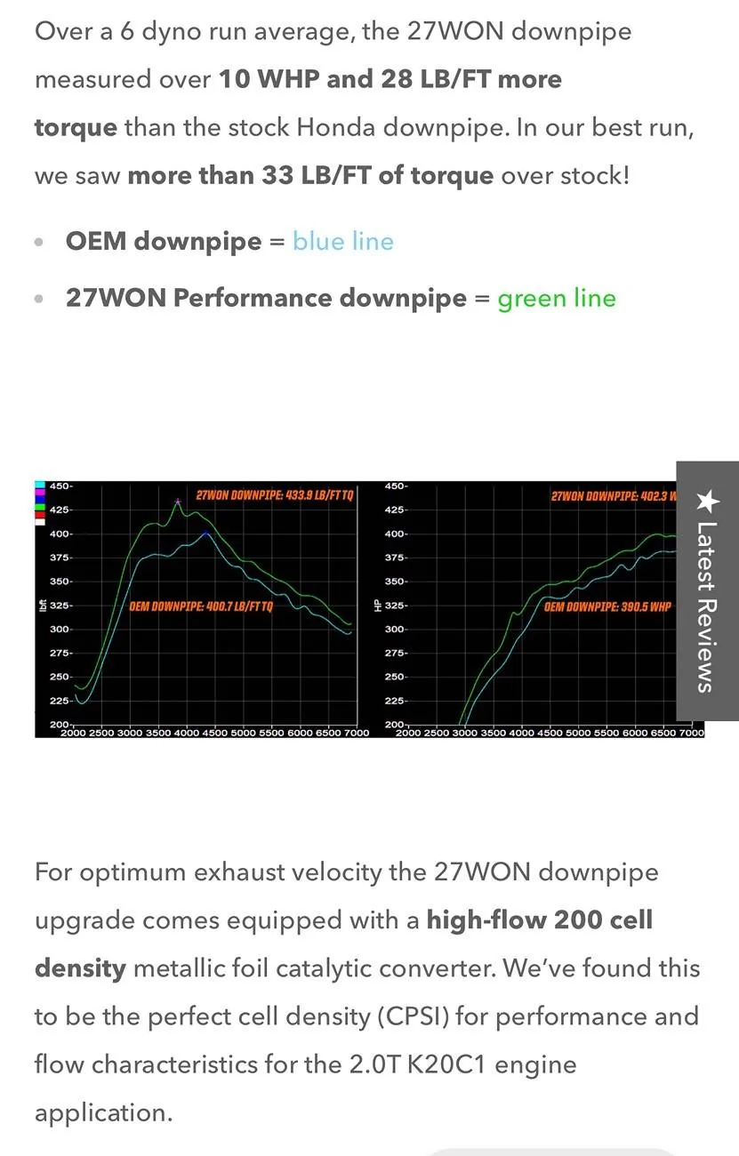

After more research. The 27WON maintains factory heat shield and has the cat is only 200 cell.
In theory, would the 27won 200 cell downpipe flow a lot more efficiently then the 300 and 400 cell downpipes?
27WON is the only company to post actual dyno/hp numbers. All other downpipe companies just say “more” power and faster spooling… which is kinda suspect.

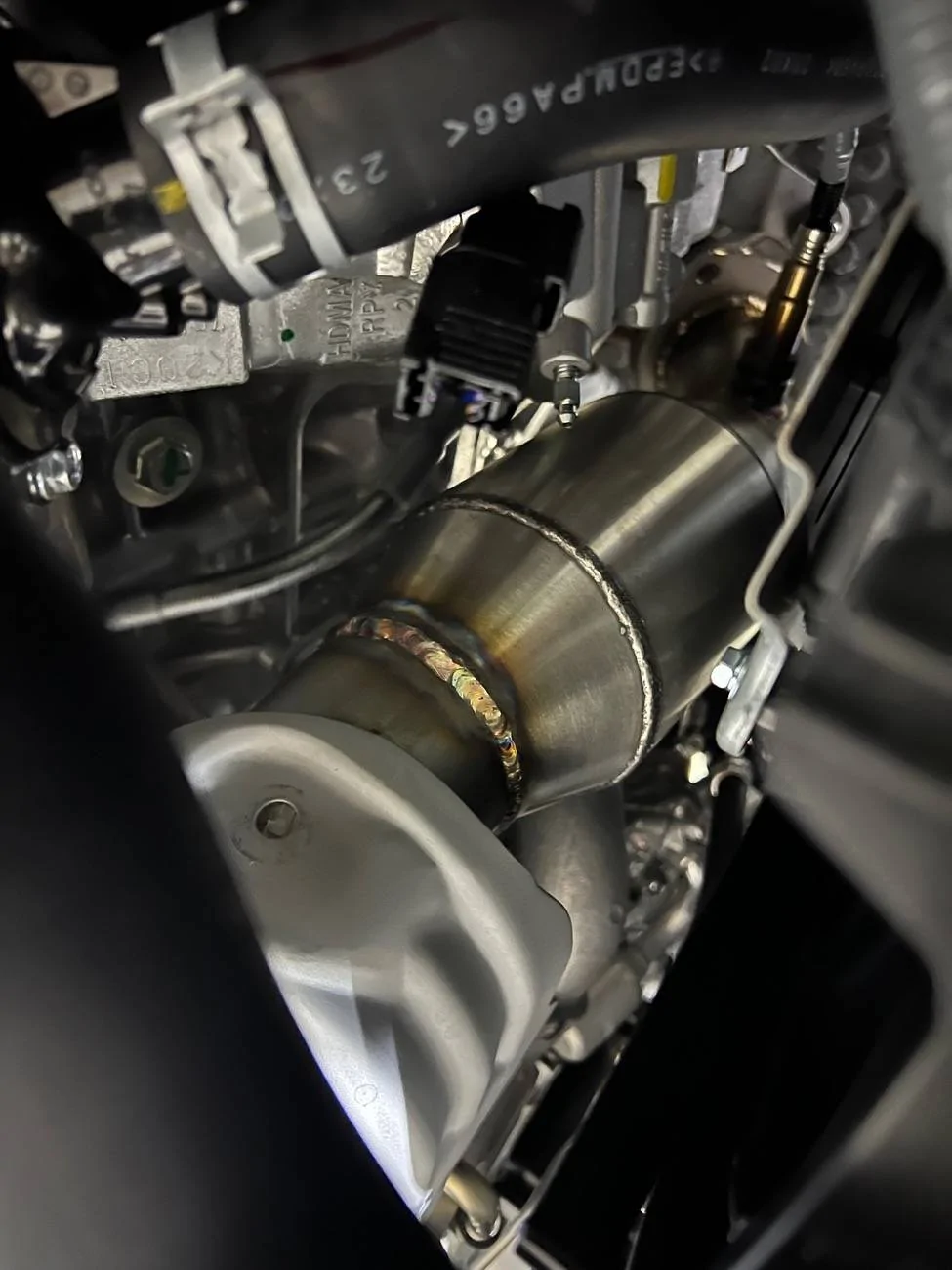

Ok this is going to piss some people off but,
MAP advertises a GESI cat. They come with a cheap 200 cell cat and you WILL get a CEL.
I lost my shit on them and was told to f myself basically. You can pay them hundreds more and they will custom make you a GESI catted downpipe.
just by a TSP if you want a catted DP
if you want a straight pipe it will be louder and more power but you will get a CEL, unless you tune it out.
My .02. From a MAP DP owner
