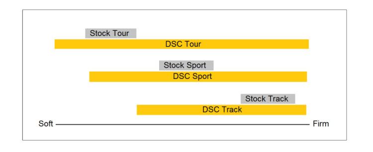

I keep the DSC in comfort mode, since it will automagically firm up as needed all the way up to +R firmness.
based on my research (not my own testing/gut feeling)
ModeOEM FL5OEM DE5DSC (FL5 calibration)
Comfort0–35 %0–30 %0–100 %
Sport25–70 %20–60 %20–100 %
+R75–100 %65–95 %50–100 %
below diagram seems to be for DE5 (terminology track vs +R and highest damping at about 95%)
Our Dynamic Suspension Controller replaces your factory suspension control module to gain full control of your factory shocks. The DSC uses an advanced active control strategy that responds to conditions to command stiffness of the shocks in real time. Additionally, the DSC uses the full operating range of the shocks where the factory controller uses only a fraction.

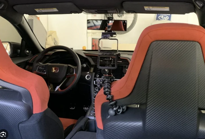

Awesome feedback. Can you share what adjustments you made exactly?
Also, what camera and mount/assembly are you using? - Great video quality and angle.

The camera is a GoPro Hero 10 Black and I've just got a gorilla pod wrapped around the passenger seat. It's a little bouncier than I would like but until I can get a 3D printed solution it works well enough.
Not my photo but it's basically this:

Nice setup. Thank you for sharing!
