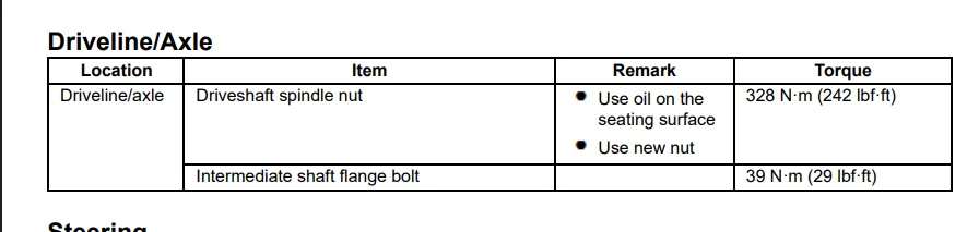

Take it out of the hub so you don't risk popping out the spider roller. It's only 1 nut so zap it with an impact. I think the spline didn't have to completely come out but gives the hub more room without extending the axle too much. When you are done torque it to spec and then stake it.
Thanks for sending the torque specs here! Do you have torque specs for the other bolts that need to be removed to take out the suspension? I'm assuming they will be in the Spoon instructions, but I'm not certain they will be.
Also did you use a new nut (per the remark)? Or did you just reuse the original nut?
