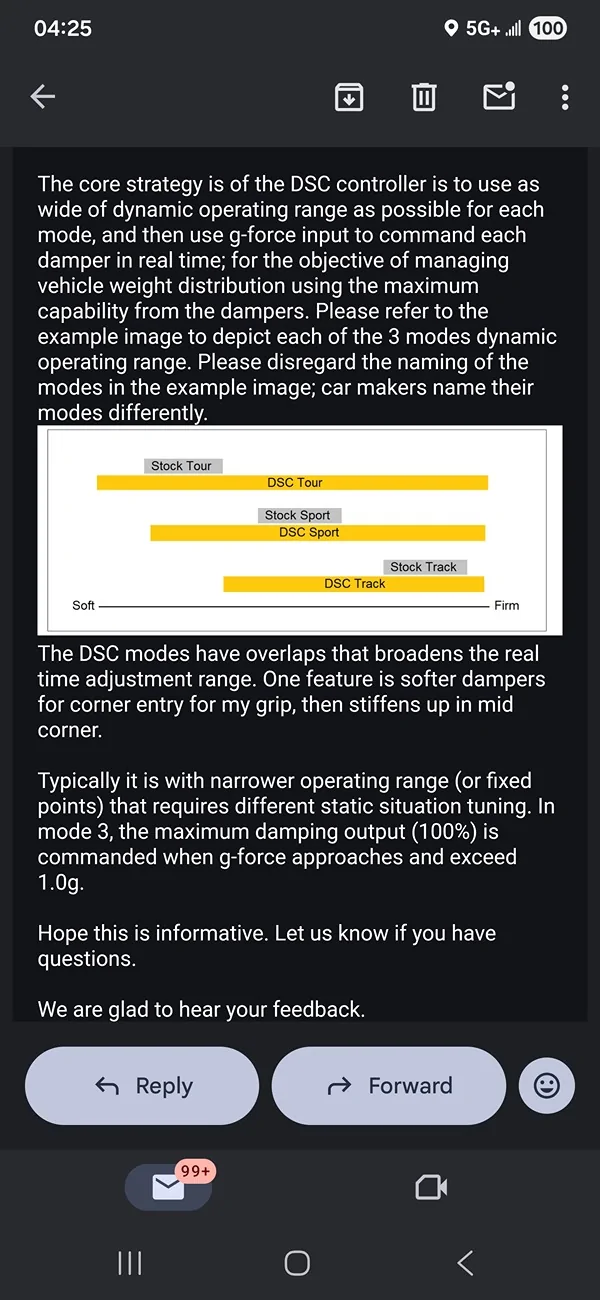

I share your priorities and purpose for adding the DSC, nor will I track my car, so the likelihood that I will routinely fully use the true capabilities of the car are remote. I do enjoy having the expanded capabilities, but limited to aggressive street/mtn driving. The key handling points for me are corner entry, mid=corner grip , and corner exit stability for navigating twisty backroads, but sufficient compliance to maintain grip and eliminate unsettling the car over bumpy/imperfect roads....and yes improved ride quality without the harshness.
I have my DSC sitting in the box and plan to install in a few weeks once the weather settles down and I can complete the 600 mi break-in.
Appreciate the feedback and DSC presentation info, so pass soon as I can put a few hundred miles on it I'll drop my thoughts too.
