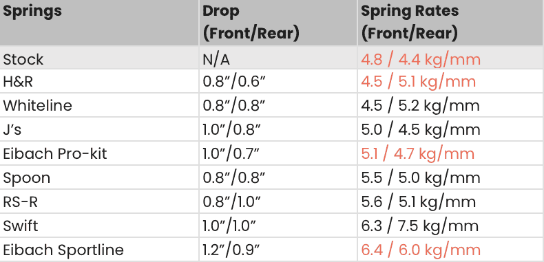

What’s the Eibach spring rates compared to Spoon?

I understand where you're going with this, but the way I understand it is that you look at the map the unit arrives with as a profile. It's an off-the-shelf tune better optimized for a lowered car, not to a specific spring rate. The differences will be tangible but not necessarily "night-and-day" type differences. They're subtle tuning tweaks. If you want that level of precision specific to your car, your setup, and your driving habits you can get it, but not from an OTS tune.
Also short answer I don't know and can't be bothered to look, last time I checked info on spring rates for aftermarket springs isn't necessarily easy to find and/or verify.

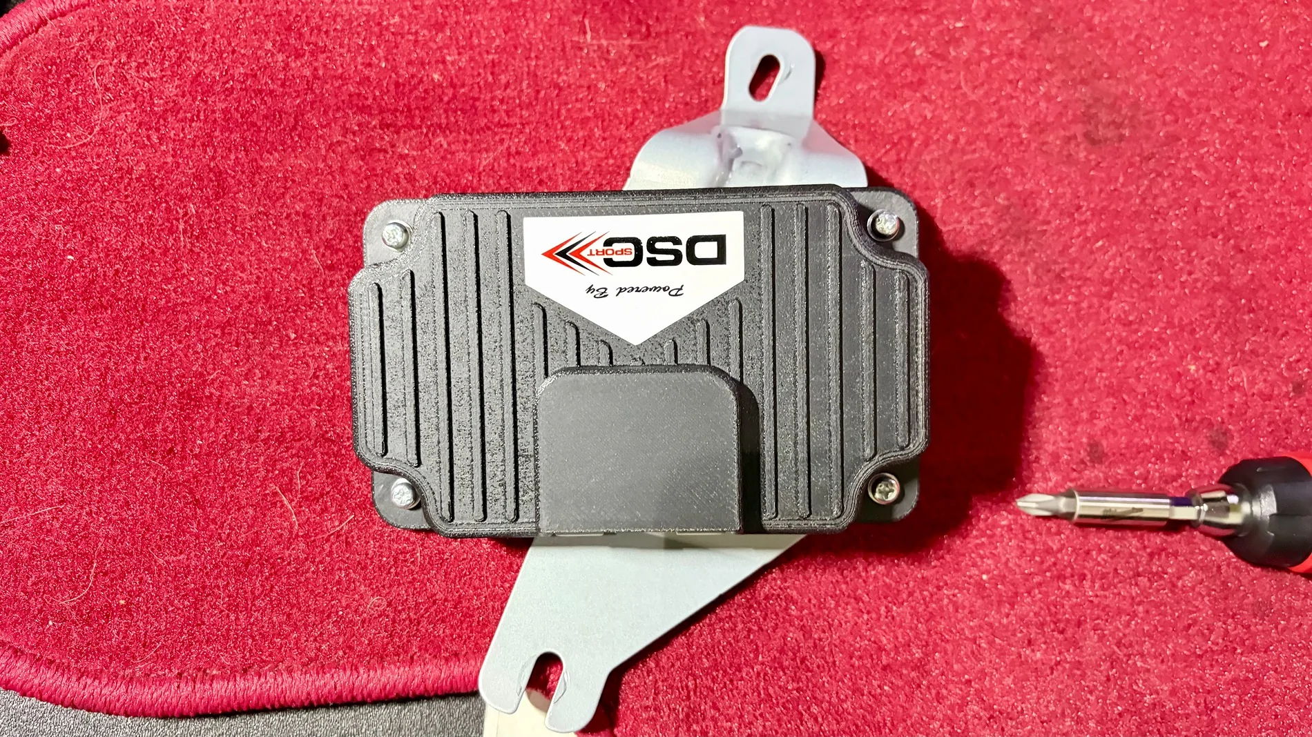

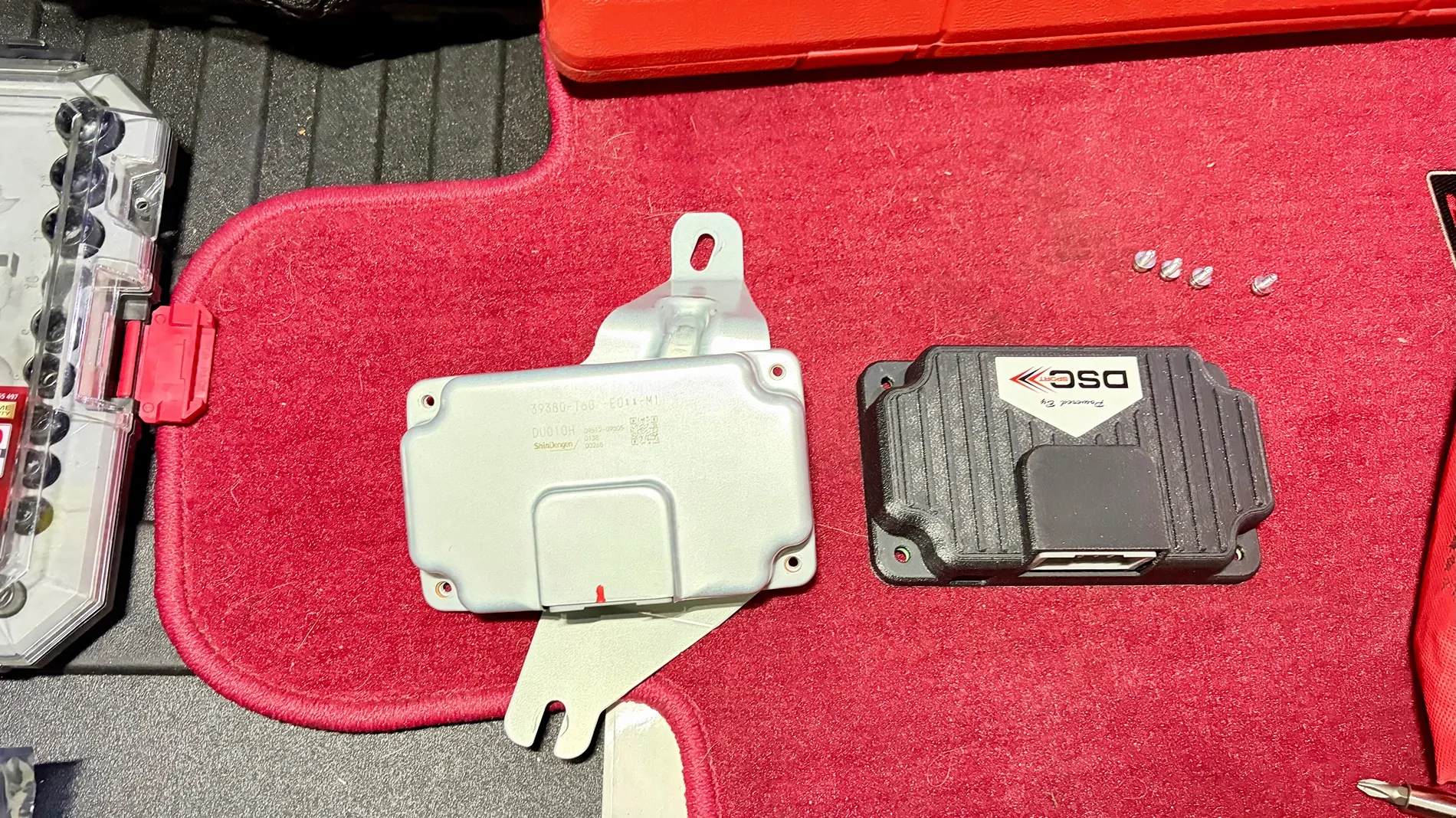

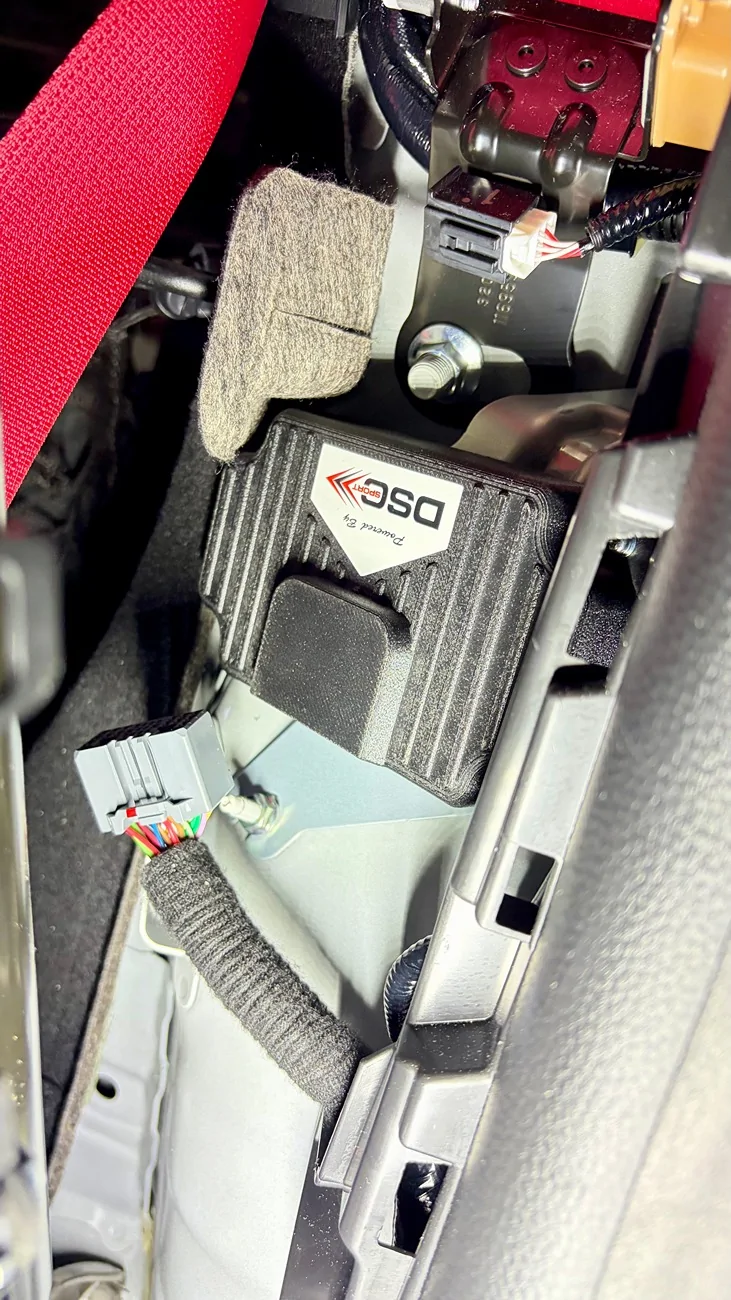

Sharing some pictures for the ones that have yet to have time to install and was wondering about the open back.
11th Gen Honda Civic DSC Sport Controller Suspension Module IMG_0267
11th Gen Honda Civic DSC Sport Controller Suspension Module IMG_0268
11th Gen Honda Civic DSC Sport Controller Suspension Module IMG_0269
Also sharing a quick tutorial for ones that haven’t done the ADS module swap. It just take 2 10mm bolts, 2 10mm nuts and 4 screws.

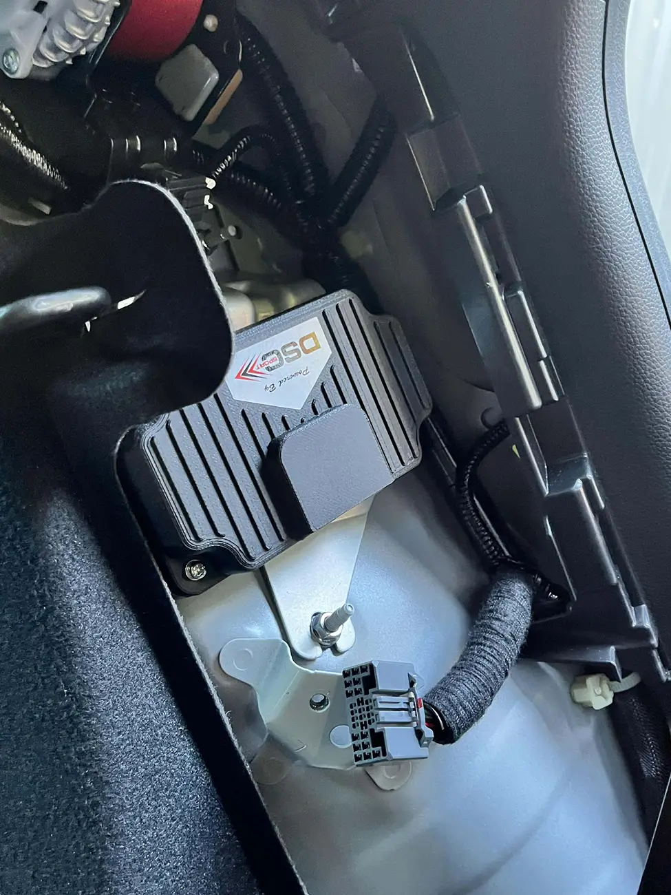

Installed last night and had a short drive in all modes. Immediately noticeable difference!
Comfort absorbs hard impacts better. Sport feels more pliant without losing the edge on handling. +R is now usable on the road. Driving to work this morning, I will go via country backroads and report back. But...I am very happy on first impressions! Install was easy peasy. Buy one! The tweakers can keep tweaking. I am not sure I will bother!
