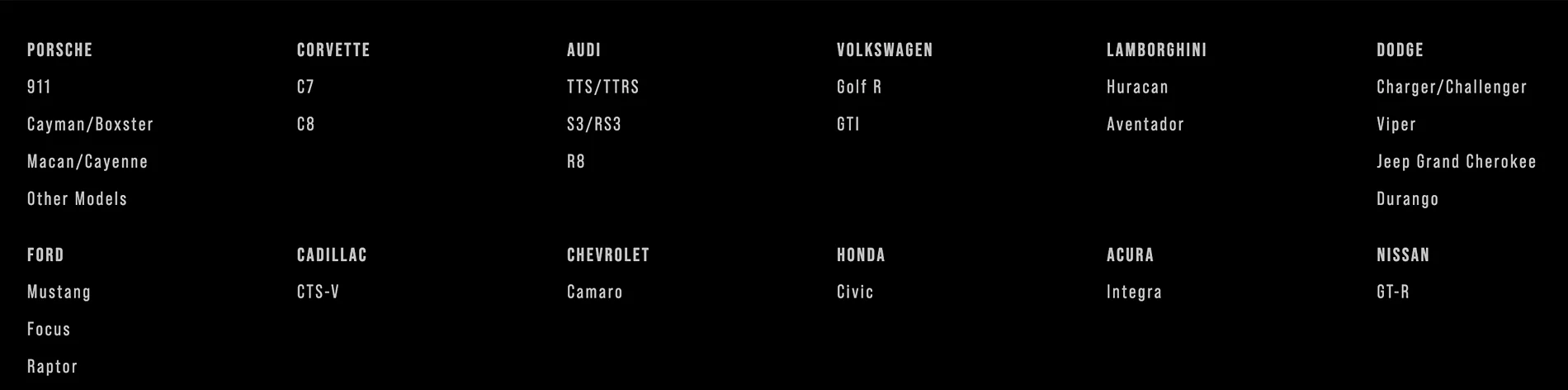

Our Dynamic Suspension Controller replaces your factory suspension control module to gain full control of your factory shocks. The DSC uses an advanced active control strategy that responds to conditions to command stiffness of the shocks in real time. Additionally, the DSC uses the full operating range of the shocks where the factory controller uses only a fraction.
11th Gen Honda Civic DSC Sport Controller Suspension Module 0
