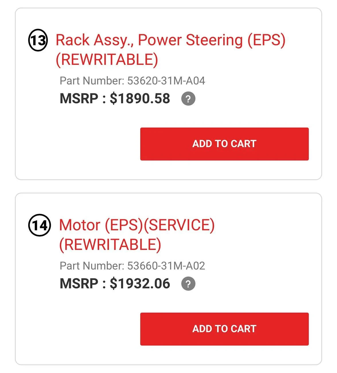

ITS EPS parts are:
11th Gen Honda Civic Acura Integra Damper Module IMG_4322

The rate of the steering can't be programmed, the level of the assist can be. These car don't have actual variable rate rack, they might have different rack gearing between where the center is vs further into travel, but their actual physical rate don't change.
