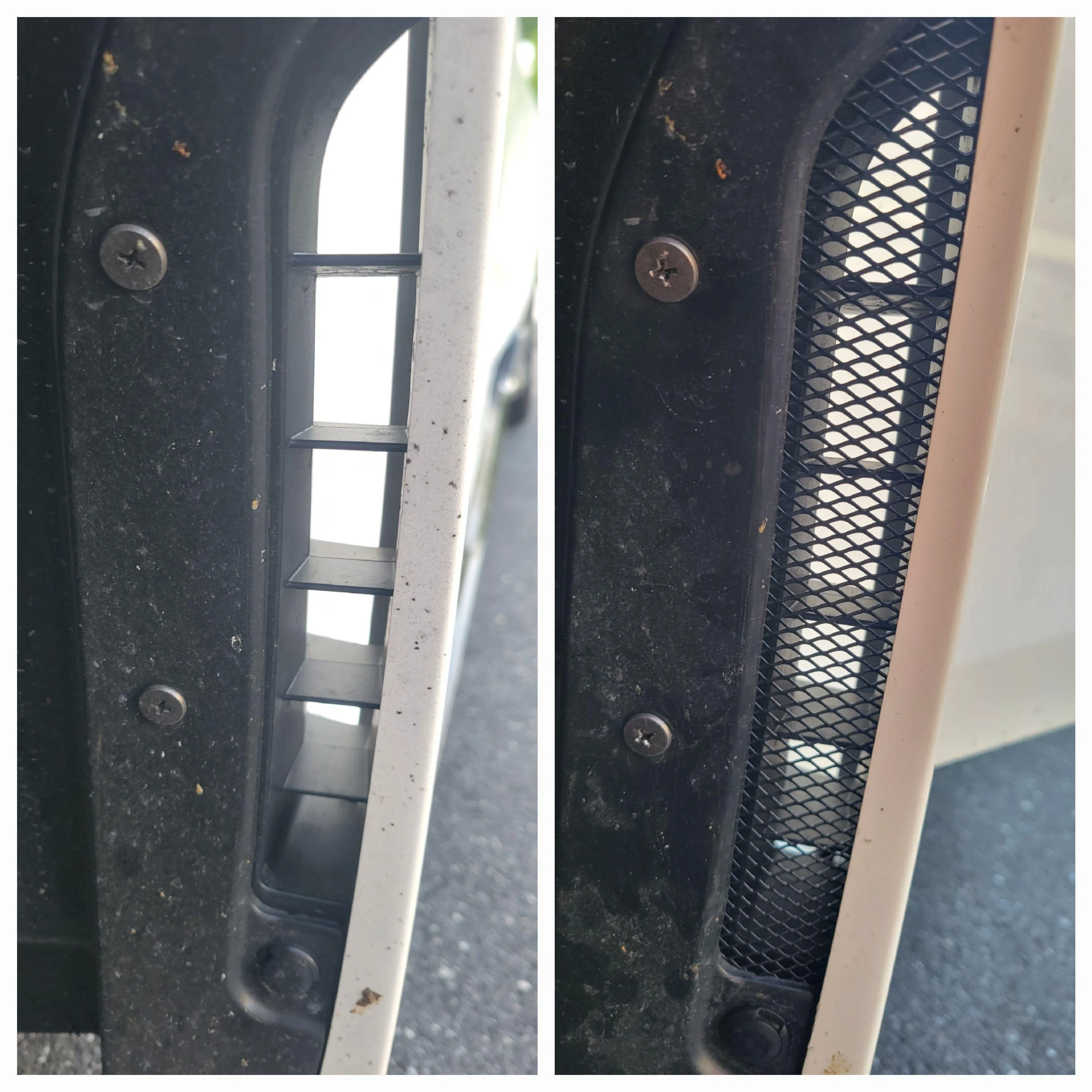

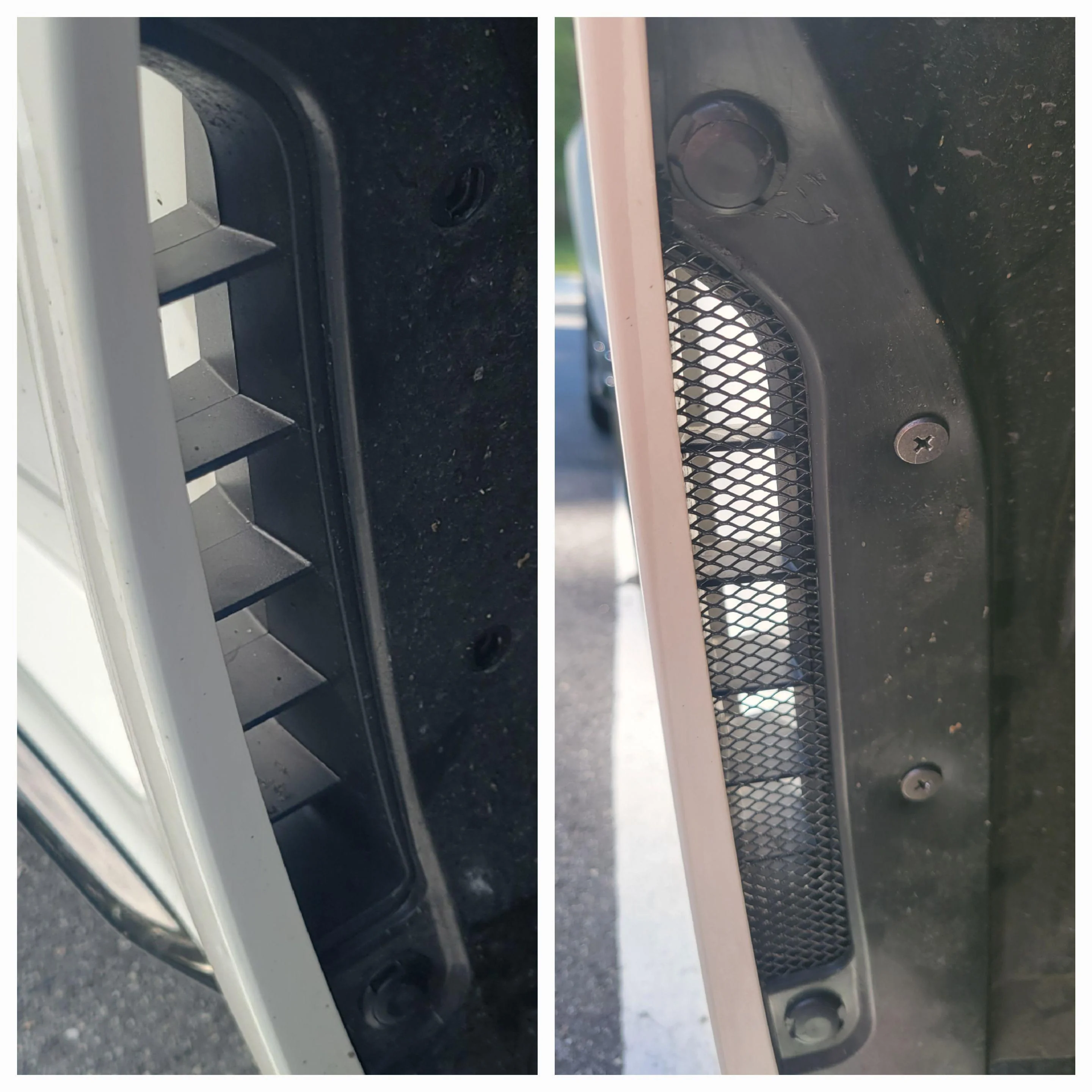

Thanks for sharing all of this!!! Just got it done as of now. That should help a little with rock chips when spacers push the wheels out.
11th Gen Honda Civic Fender vent mesh? 20230422_105216
11th Gen Honda Civic Fender vent mesh? 20230422_105411

Awesome mod. I just did this and took about an hour for both sides. You really want to remove the bottom clip instead of trying to finagle the mesh in there. Some of the fender is hidden under the lining. The mesh has sharp edges and you wouldn't want to scratch the fender trying to get this thing in there.

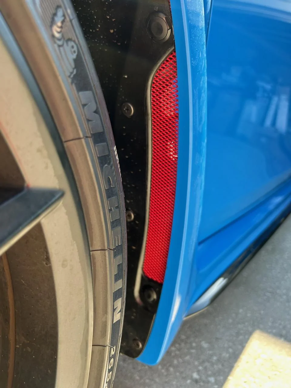

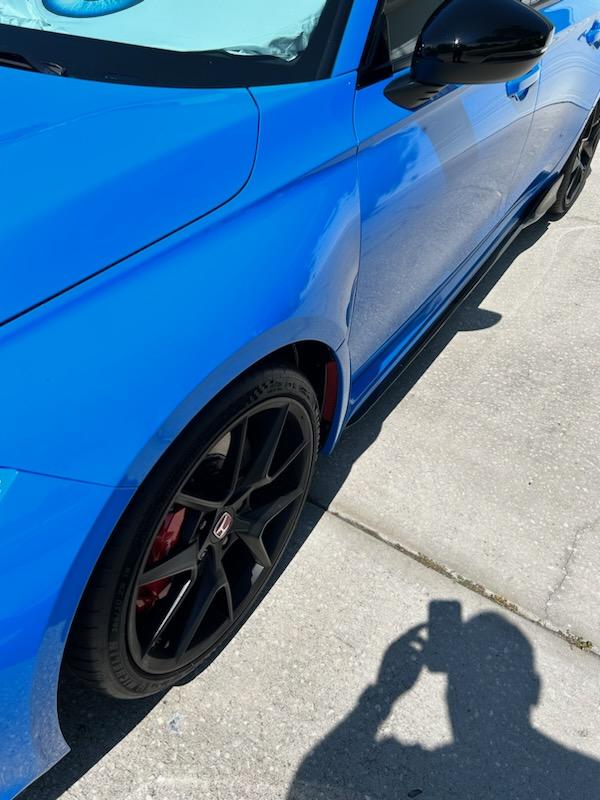

Let's see some shots from farther away & the other side.

They should be 8mm, I have been doing pretty poorly at ordering the right things recently so I ended up running to an Autozone a few houses down from me and bought "Dorman 961-37D Honda Splash Shield Push Rivets". The wrong ones I ordered were 10mm.
