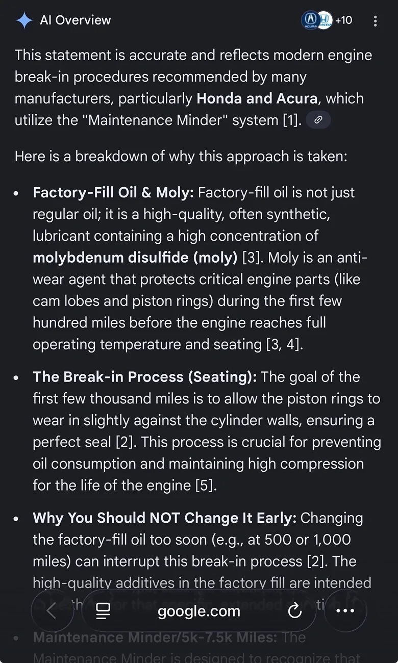

Actually...it's not so much unique oil as it's: "they rely on assembly lubricants (like molybdenum) that remain in the engine and the factory-fill synthetic oil to handle the initial break-in, recommending you follow the Maintenance Minder for the first change, typically around 5,000-7,500 miles, to let these components properly seat."
Where is this quote from?

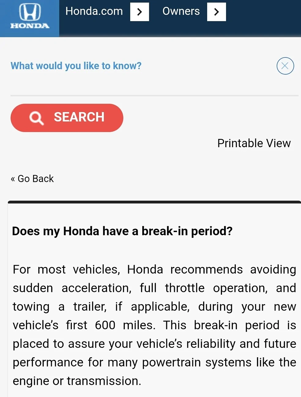

There’s no advantage to swapping the oil after your first 500 or 1000 or whatever miles. There’s also no disadvantages too
if you’re planning on running anything other than the 0w20, then yeah. U can argue there’s an advantage to swapping the oil early. Only because you’re getting 0/30 or 5/30 or whatever in it.
I think it’s more important to not drive like an asshole the first couple hundred miles then it is to swap the oil
I swapped my oil out at 1k miles. And I tore apart the stock filter and cut it open. All was well so I felt I had the green light to dyno. Mod. And dyno again.
swap the oil whenever U want. U won’t hurt anything. Be mindful of your abuse, if you’re tracking every month ffs don’t go off and think 10k intervals are fine.
