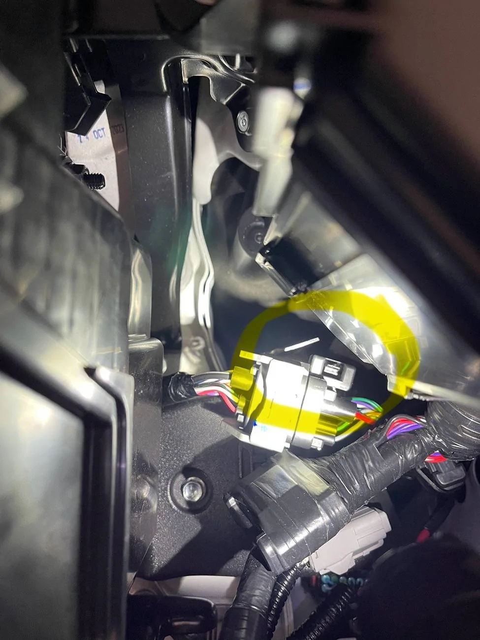

Did anyone else have a problem with the small metal bracket that attaches to the snorkel not set at the correct angle so you can reattach the existing connector plug? See the circled part in my photo. They’re about 45 degrees apart and the wiring harness doesn’t have enough flexibility to pivot to the brackets angle unless I cut the stock zip ties to give it more slack.

Did anyone else have a problem with the small metal bracket that attaches to the snorkel not set at the right angle so you can reattach the existing connector plug? See the circled part in my photo. They’re about 45 degrees apart and the wiring harness doesn’t have enough flexibility to pivot to the brackets angle unless I cut the stock zip ties to give it more slack.
I think I just unclipped a couple of the wire tie mounts around it to allow the harness some movement.
