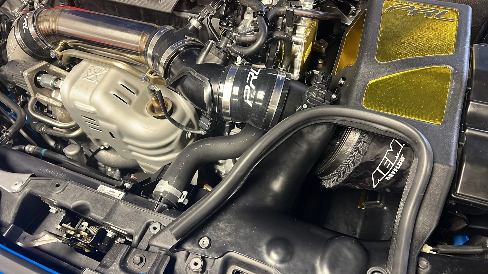

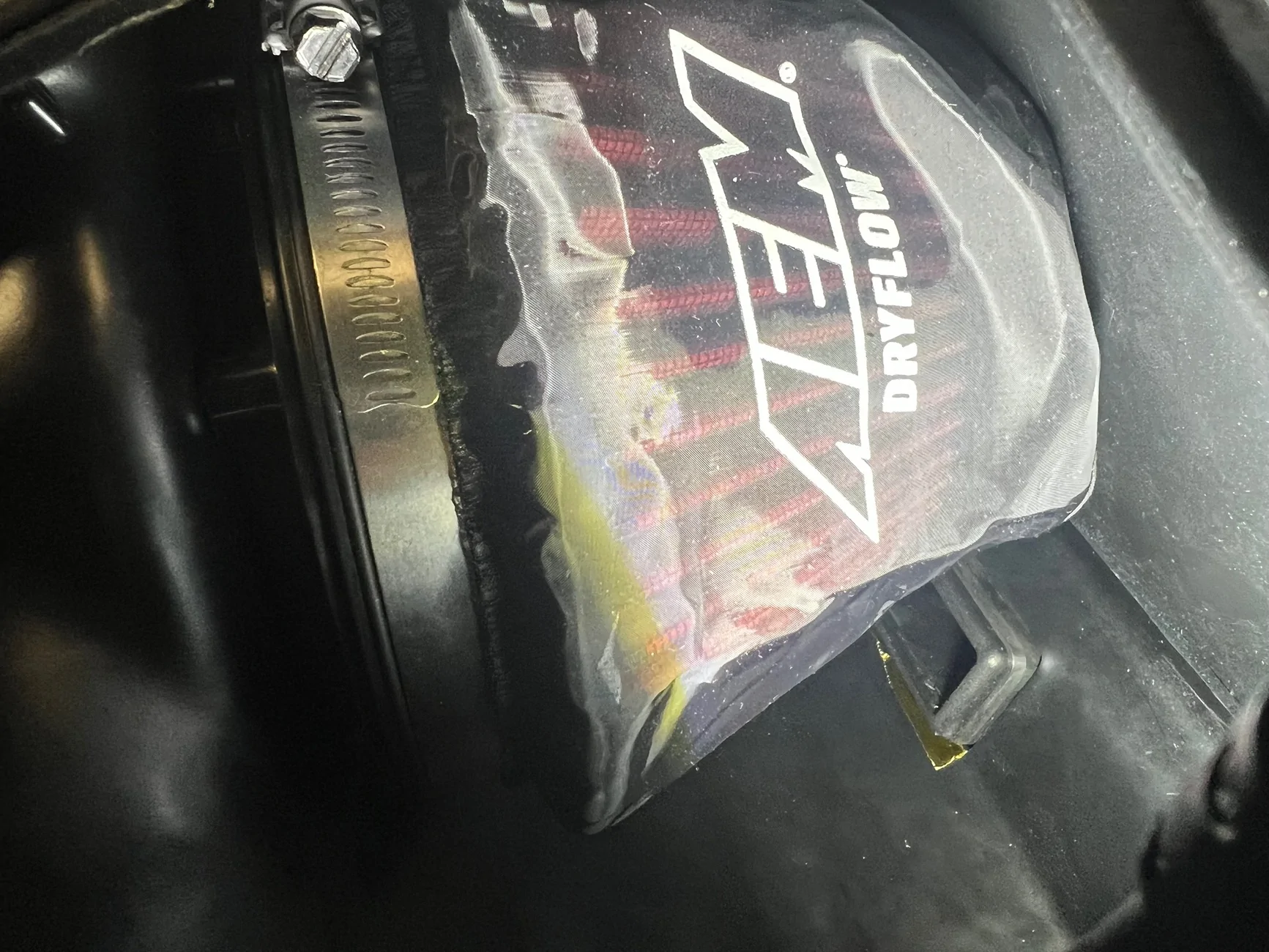

Happy to report I didn't see a layer of fine dust inside the HVI and Inlet tubings when I took apart the tubings to inspect and install the TSP coupler today. This is after running the AEM Dryflow for a year. I swapped it to the AEM Dryflow because I did find a layer of fine dust inside when I installed my Inlet pipe. So far so good, I like it 👍.

Awesome, thanks for updating! Sounds like the AEM is sealing well.

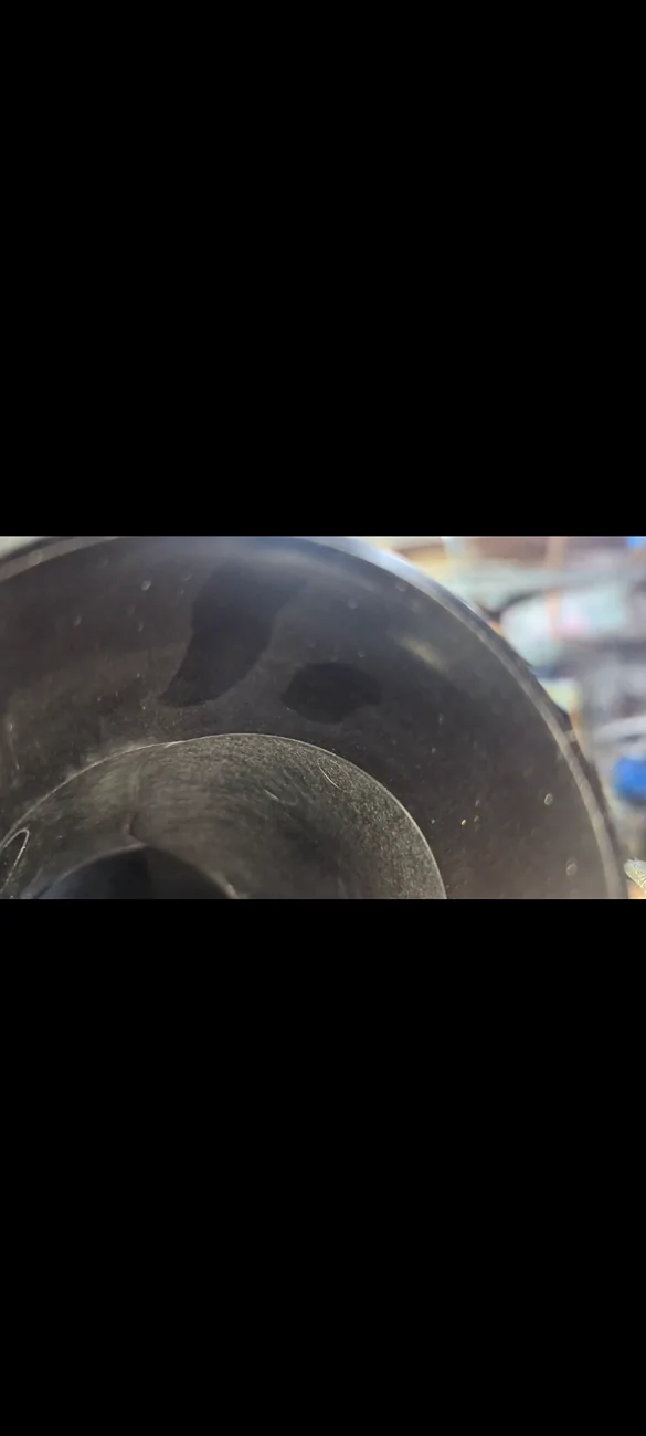

Here's the inside of the plastic EVAP elbow after using the PRL HVI/filter for the past few thousand miles. Might switch to the AEM to see if it's able to keep the intake tube cleaner.

The AEM has been fine, on for 5,000 miles now. It is a little quieter and a little less power then the PRL cone they call a “filter.” Lol

The AEM Dryflow does a good job IMO. I took the inlet and intake tubes apart again to inspect for maybe a crack or boost leak (still getting this random P0101 CEL) and it's still clean inside. Highly recommend upgrading from the PRL filter.
