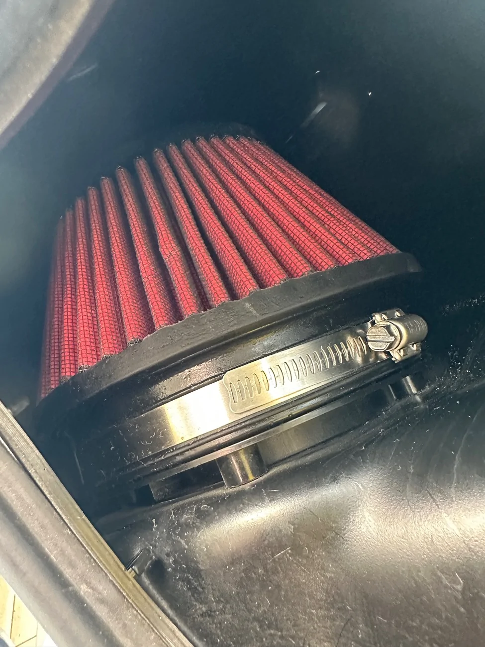

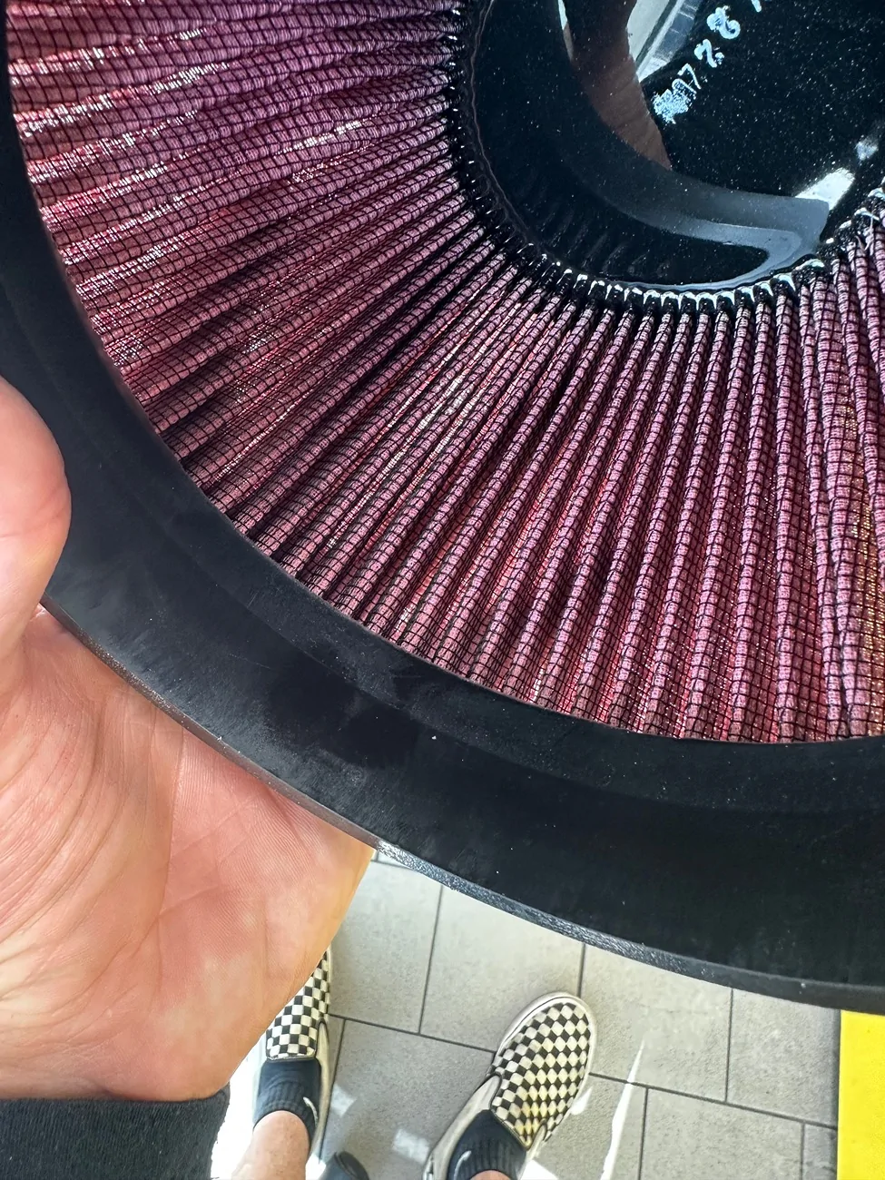

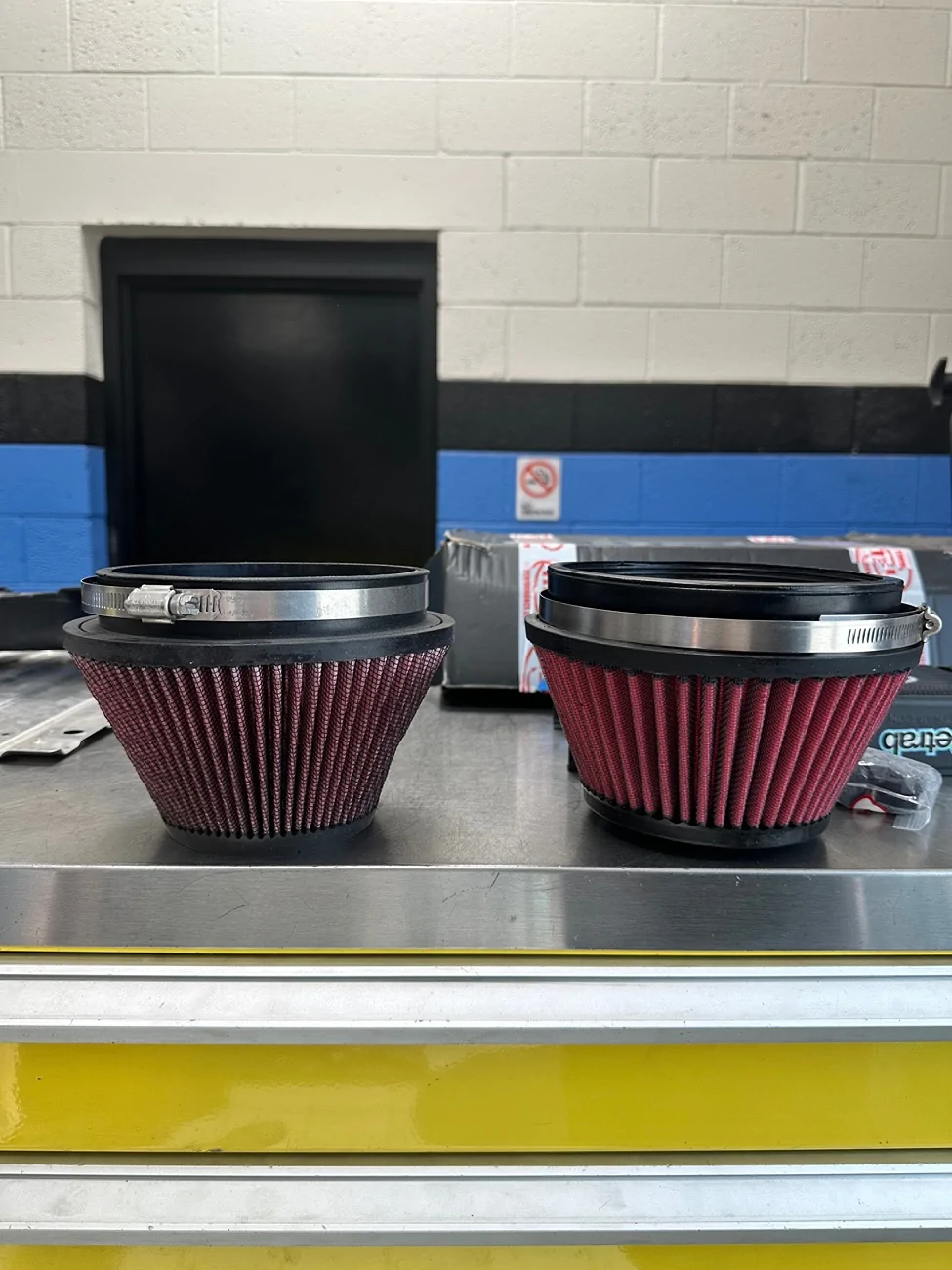

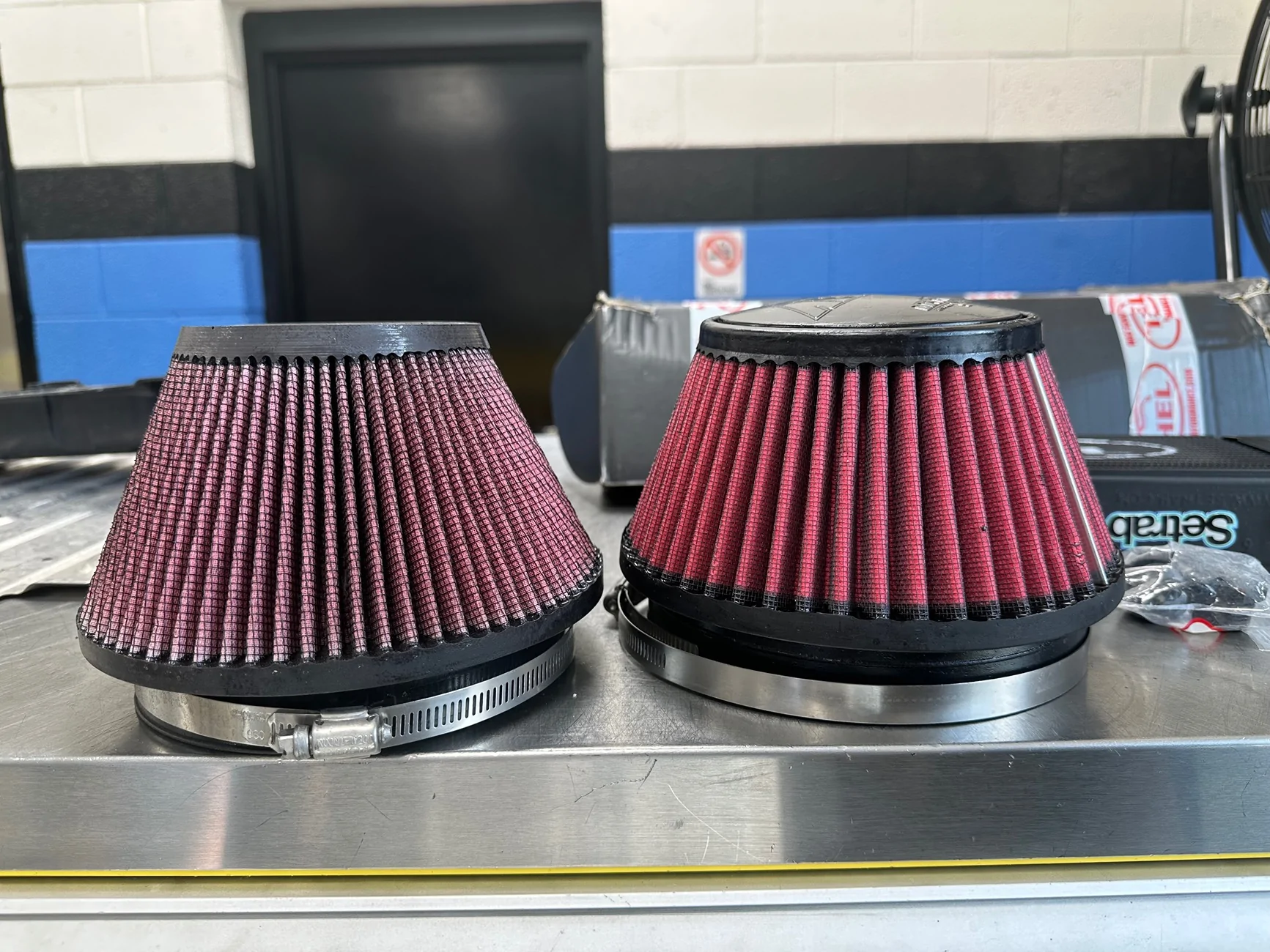

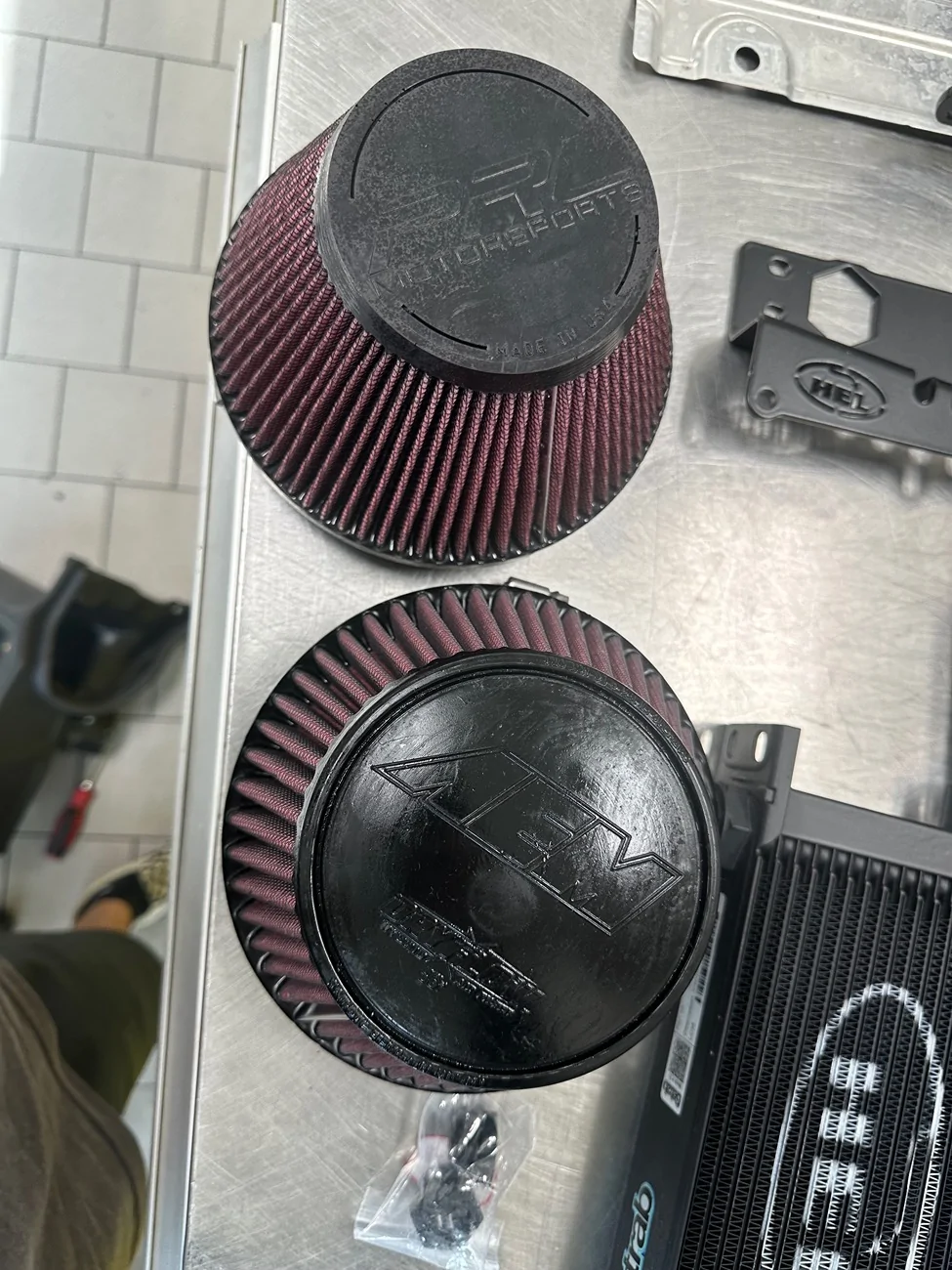

11th Gen Honda Civic Opinions on PRL HVI filter IMG_9584
11th Gen Honda Civic Opinions on PRL HVI filter IMG_9580
11th Gen Honda Civic Opinions on PRL HVI filter IMG_9578
11th Gen Honda Civic Opinions on PRL HVI filter IMG_9579
11th Gen Honda Civic Opinions on PRL HVI filter IMG_9582
PRL filter is one thin piece of see through cloth. The AEM is a lot thicker material.

Exactly what I did in the garage, can practically see the light through the mesh.

Exactly, 100% agree! I think the PRL HVI flows so well because the filter is so thin.
When I cleaned the PRL filter there didn't seem to be much dirt and inlet was dusty.
Now when I clean the AEM filter there is a lot of dirt and the inlet has no dust.
I did notice a very slight sound/power reduction when I switched to the AEM filter because it is so much thicker/filtrates better.
