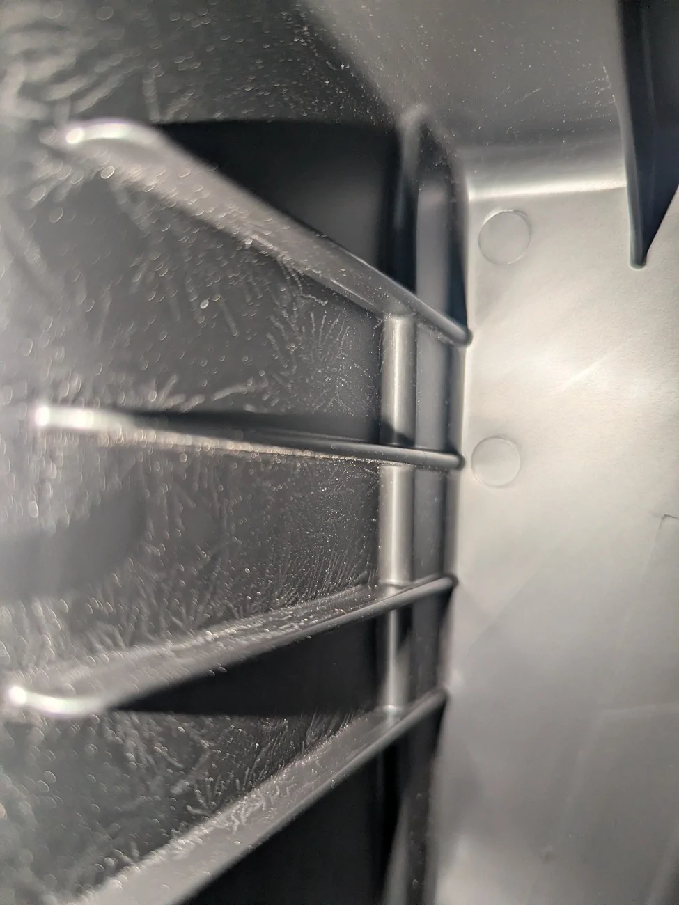

I had a PRL HVI V2 on my 2.0 Accord for a while. That thing didn't filter worth a crap, just like other oiled K&N style filters. After 10k miles there was a layer of dirt/dust inside my inlet tube when I went to service the filter. Got rid of the thing and got a dry flow filter. This is the trade off for more flow, doesn't matter what the brand is. If it flows more air for the same given surface area, that means it doesn't filter as well, plain and simple. Whether the difference in filtration makes a difference for you depends on your environment and your personal standards of what is acceptable filtering/performance. Living in a desert like I do, I would not run an oiled filter. This is why my intake is stock on the Type R and will stay that way until I sell my house and get out of this hell hole. Even then, I would only run a dry filter as I much prefer the added filtration over the 2hp I would be giving up to run a higher flowing oiled filter. Just my .02.

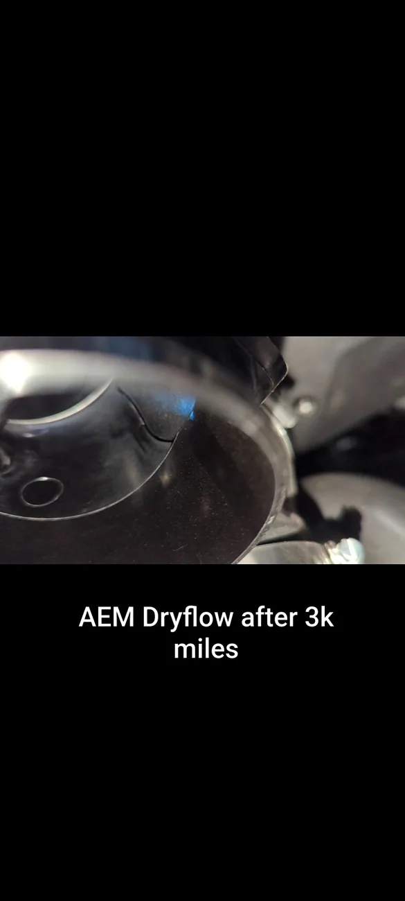

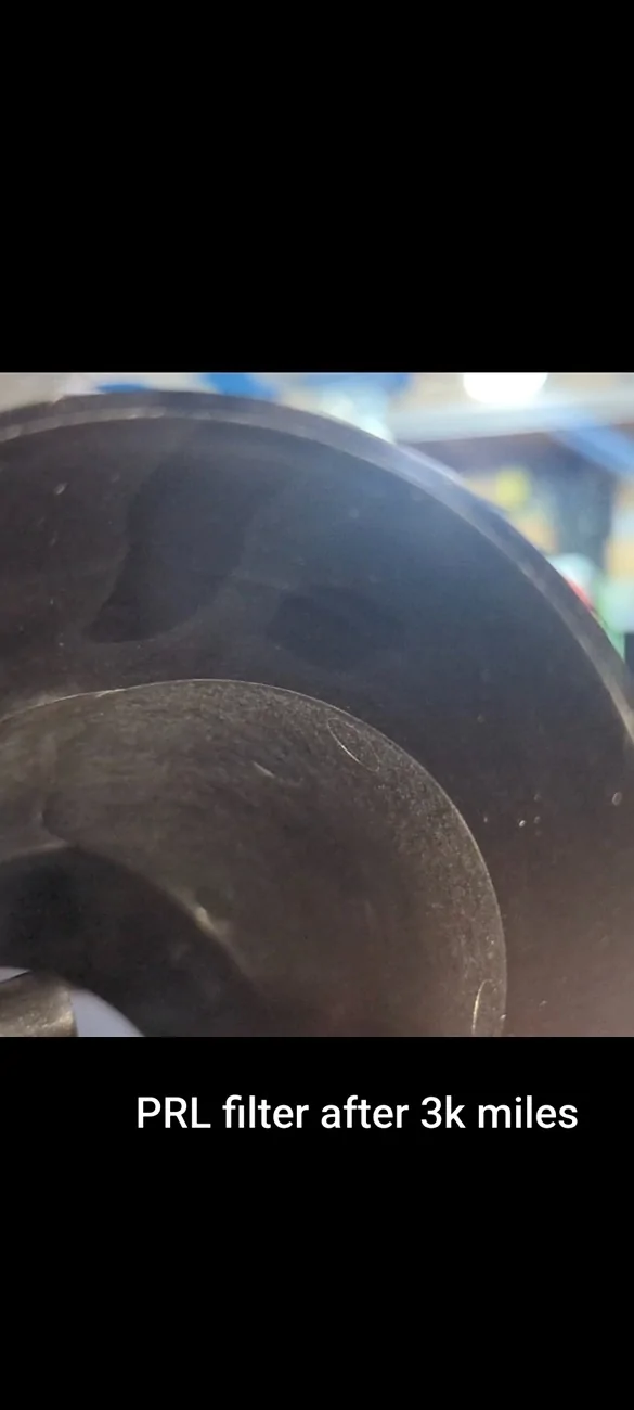

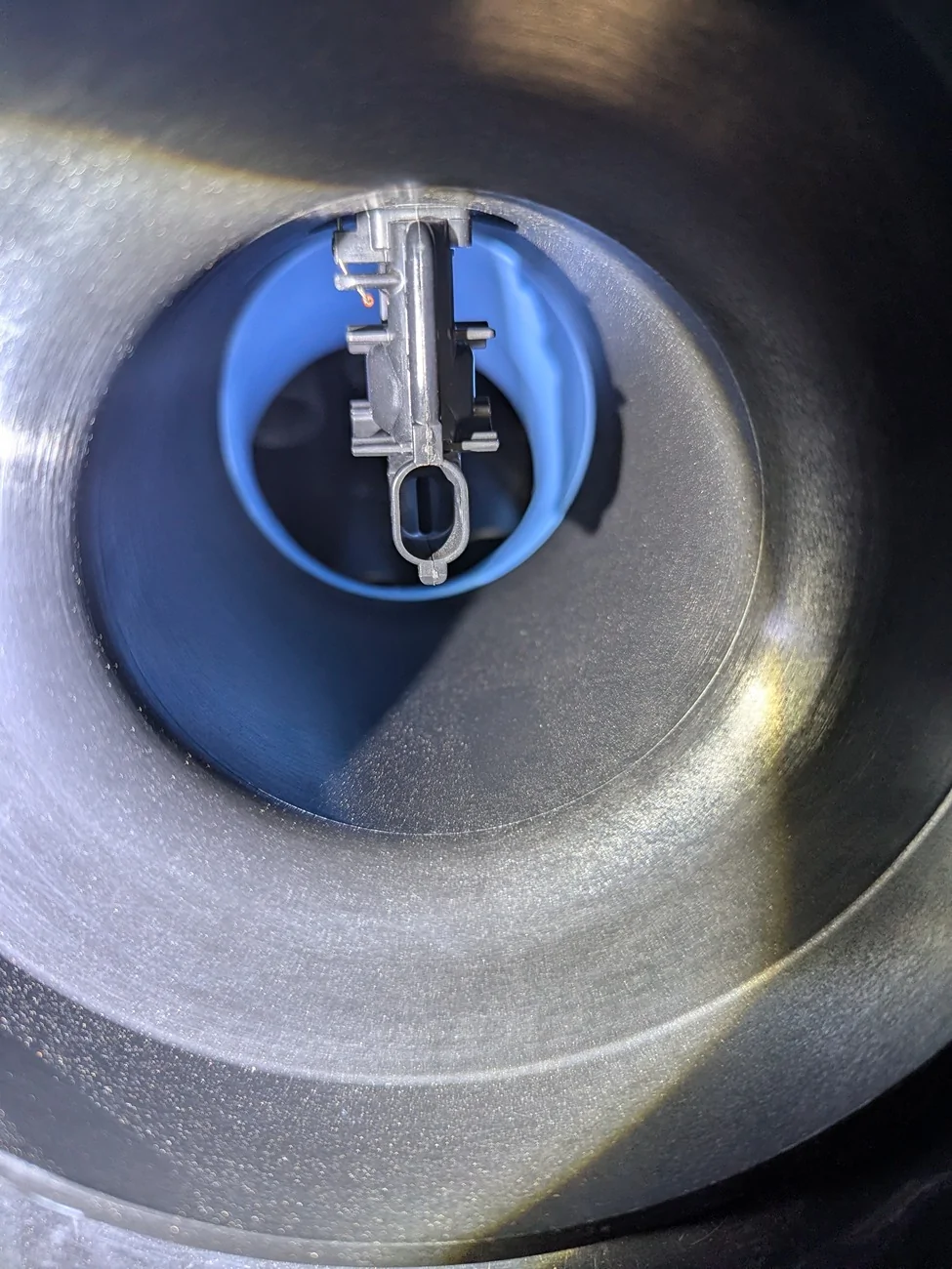

Just want to add that the AEM Dryflow is a great option for the HVI. I was concerned about sealing as well, but the intake tract is always very clean after running the Dryflow. Even the rubber flange was spotless so you can tell it's sealing.
The same can't be said for the PRL filter. I would always find a layer of powdery dry dust inside the intake after using the PRL filter.
Like other said the AEM filter does quiet down the HVI a bit, but it's way louder than stock and 100% worth it!
