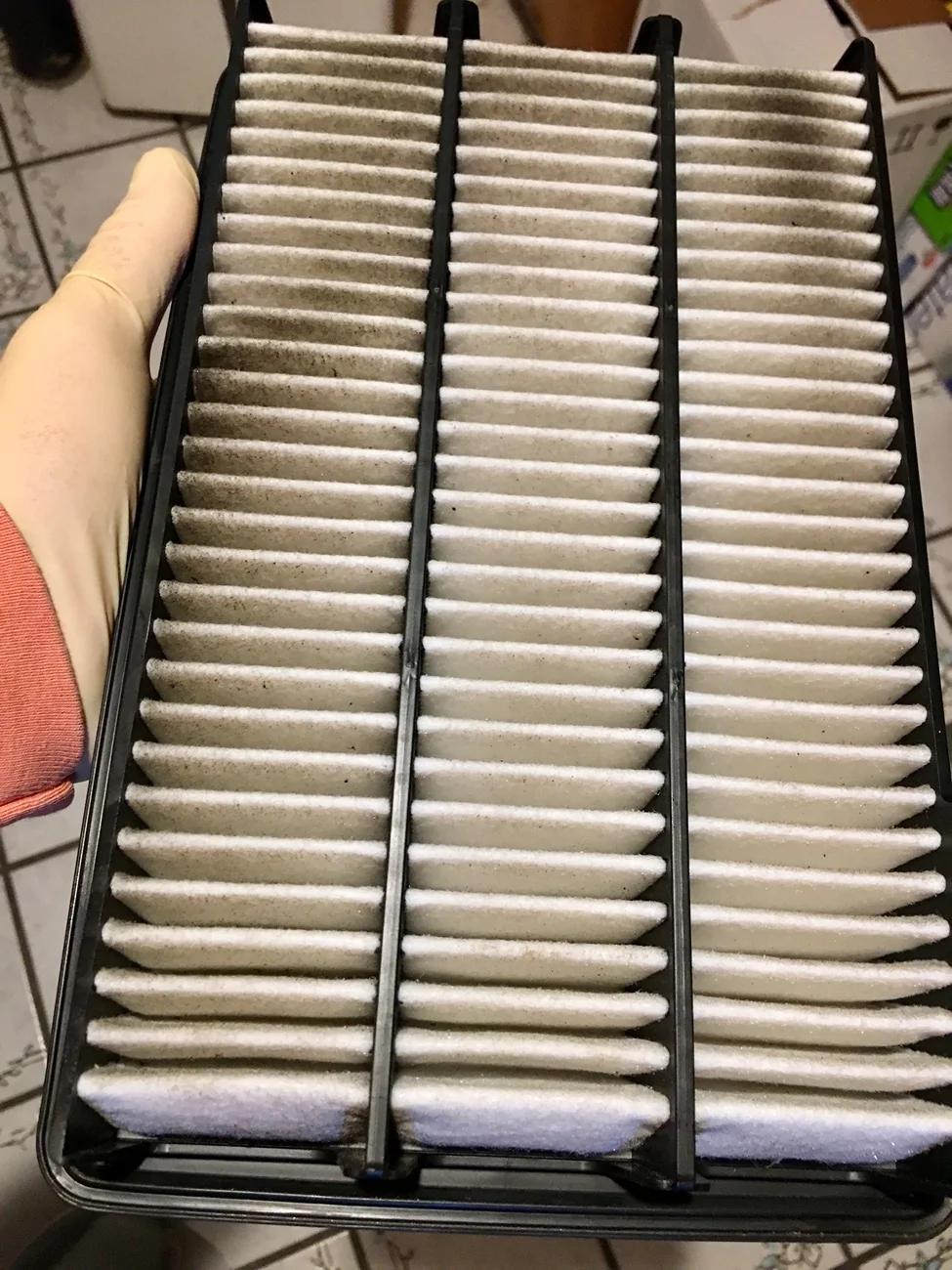

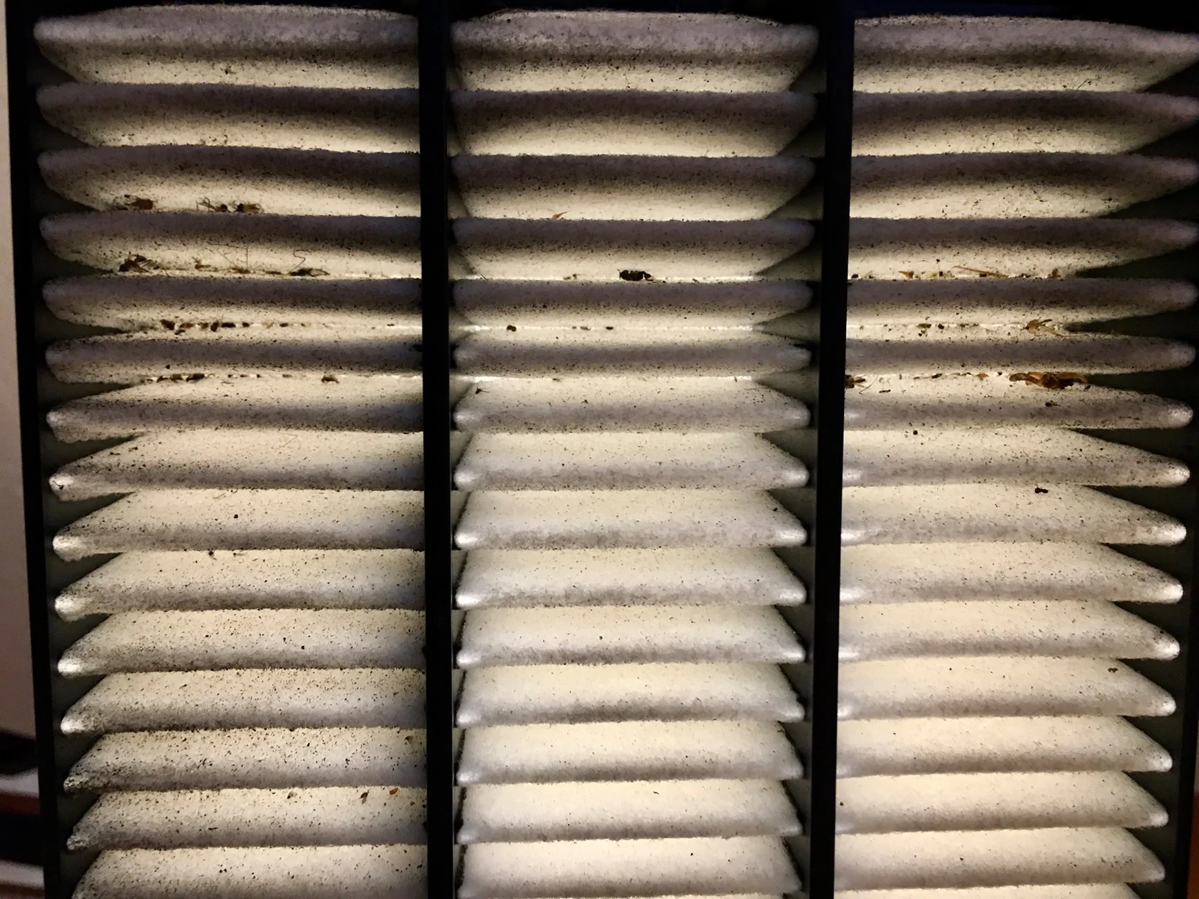

I also noticed a slight reduction in intake noise when switching to the AEM filter, but I didn’t notice any power difference, personally. I did a few data logs with the stock, PRL, and AEM filters and looked at the g/s airflow readings at peak RPM at WOT. they all landed at 280 g/s, give or take 1 g/s. I have no idea if that tells the whole story as I do think there is a small increase on the old butt dyno with the aftermarket intake vs stock. Ultimately, I reinstalled my stock setup for now because the PRL didn’t seem to have caught any dirt that I could see over 8k or so miles, whereas the stock filter had trapped lots of crap in half that mileage. Also, I actually prefer not to listen to the constant sneezing of the blow off valve.
The factory filter pictured has 4-5k miles on it. I guess there’s lots of crap in the air around here!

Also, my OEM filter looked essentially brand new when I removed it at around 5k miles, in contrast to what jtlctr posted above. So your local air quality should be a factor when deciding on a filter, though it probably wouldn't make a huge difference either way as long as you clean it regularly. I could probably run the PRL filter tbh.

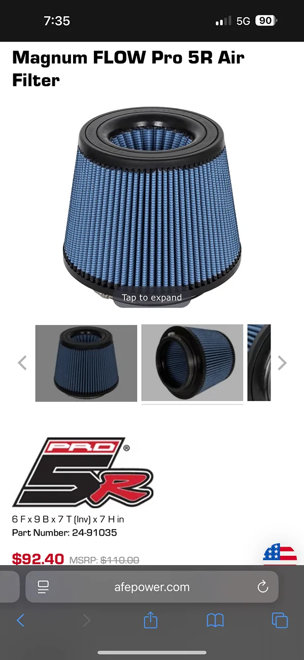

Interesting! Another alternative I used with my PRL carbon fiber intake was aFe’s Takeda PRO Dry S air filter. I know when it comes to dry synthetic filters, AEM and aFe Power are one of the best options out there, with K&N following closely behind.
OEM filters are obviously still the best since they’re usually around 99.98% in effective filtration.

Do you have the part number for the AFE filter you used?
