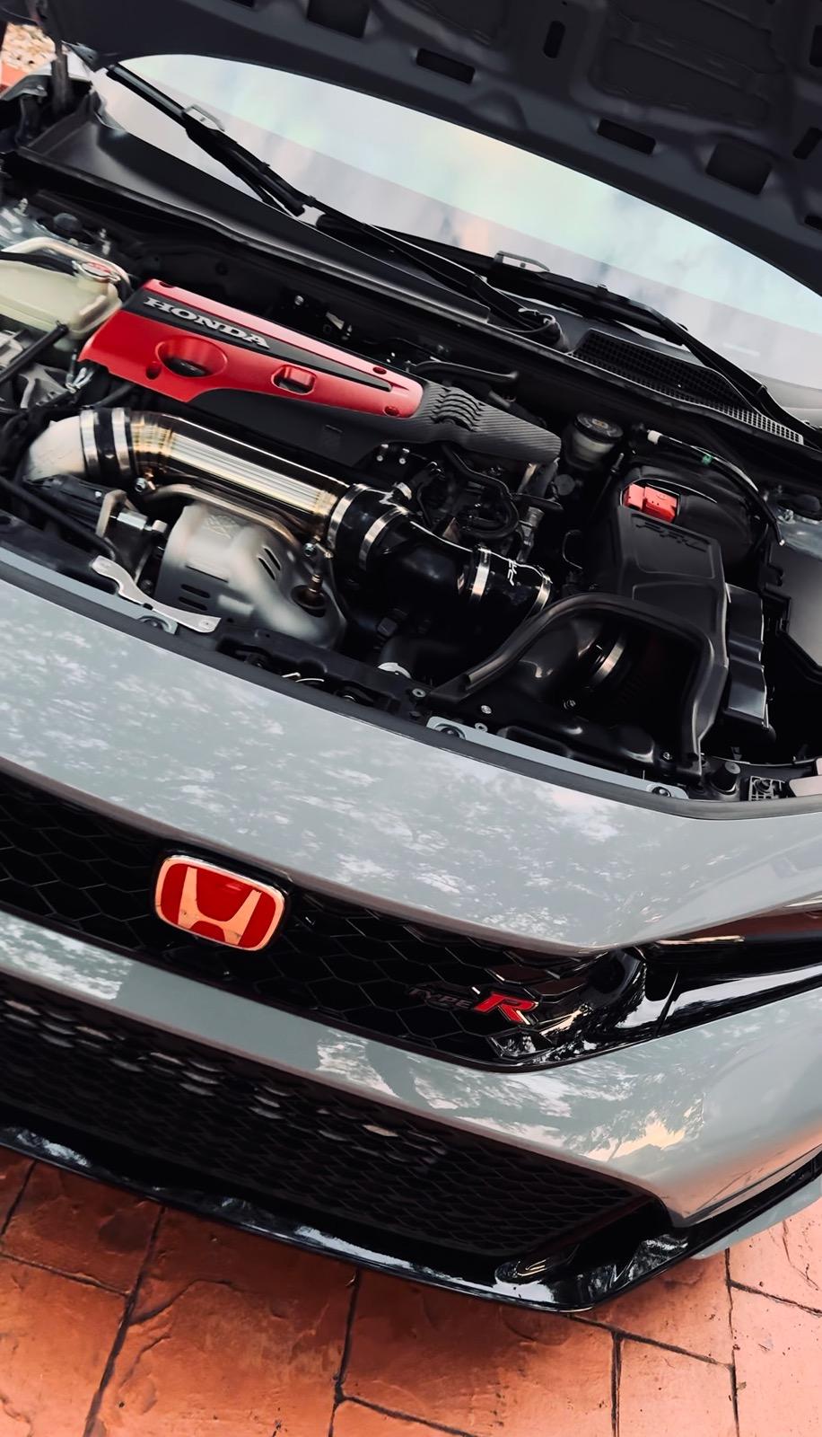

I can confirm that you don’t need to buy the $50 coupler guys. PRL customer service told me I needed to buy it in order to use the HVI with their titanium inlet pipe, but that’s not the case. Perfect fit.
11th Gen Honda Civic FL5 PRL HVI Intake Installed IMG_2320
I would love to see this in person before I leave Miami.

Wait, what?? You serious? I see the picture lol but why would they say you need it otherwise? Maybe the silicone tubing is slightly larger and fits better with the addon coupler? Something has to be different right?

so do you really not need the coupler as stated above if we have titanium inlet? Anyone else confirm?
This is an example of making something work vs doing it right. PRL didn't design extra couplers as a cash grab, it wouldn't be worth the trouble for them. We have had customers report using the "standard hoses" and connecting to the HVI, and then having them come disconnected after driving the car.

I figured as much. I bought the larger ones prl made for it so I’m fine. Was curious how they initially made stock work though if prl had stated otherwise.
