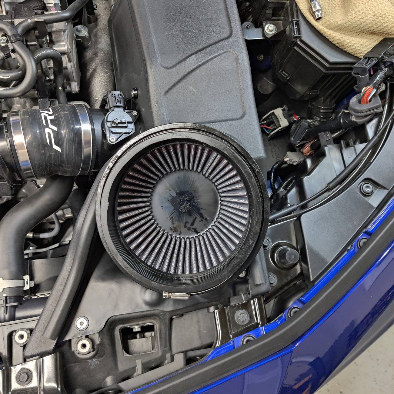

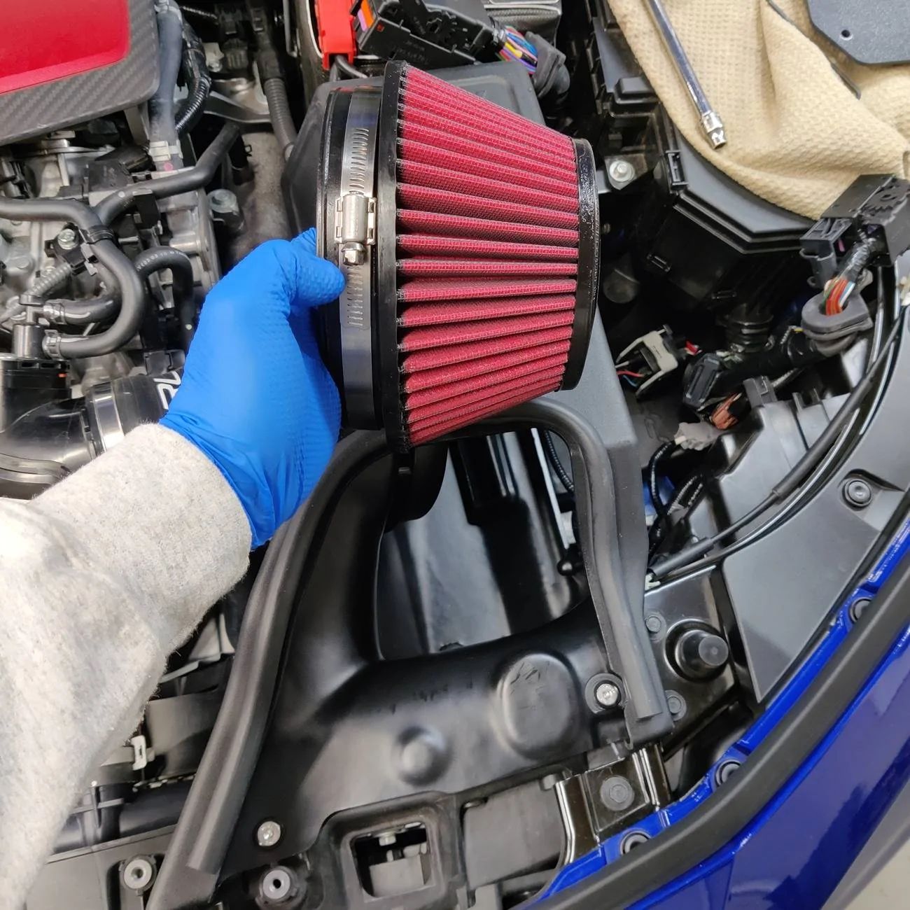

Figured I'd update the gang since my AEM dry filters came in. In short, it ain't happenin'. The filter base is way too big to fit into the front opening no matter which way I tried to orient it, the only way to service the filter is through the access panel (and removing the ECU in the process).
Not a total loss though, I prefer dry filters anyway and I've gotten pretty good at removing the ECU because of reasons. So when it comes time to service the filter in about 50k miles (per AEM's website) I can probably bang out the job in about 20 minutes (not accounting for time cleaning the filter and letting it dry).

Honestly, no change in sound that I could detect. Have you had a chance to drive yours yet?
ok so it sounds like you're taking the ECU off to get access to the filter right?
That was my plan when it comes time for a cleaning (at which point I'll switch it out for a dry filter) but wasn't sure if there was a better way.
Not to get technical but you don't necessarily *have to* remove the ECU, that's just the easiest and quickest way to access the filter for service. The alternative is to remove the entire filter box from the hose side but that's a lot more trouble, in my opinion.
To answer your question directly; yes, I'm removing the ECU to get to the filter.
I actually never removed my ECU when I first installed my PRL HVI. Even when I swapped recently out the filter, I’ve always removed the whole box. Im sure it’s easier going through the side.. but It’s just something about the ECU that I don’t like touching and/or unplugging lol.
