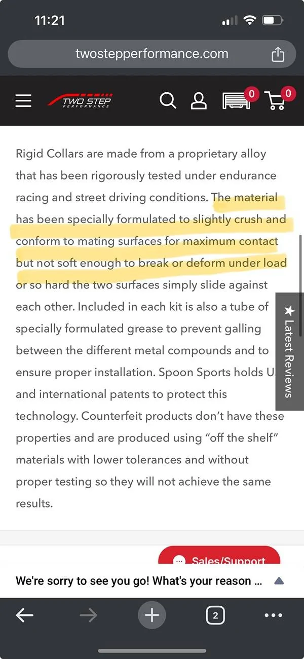

What about the cars with ridged collars and race alignments. How is that handled at your shop ?
Haven’t had one yet but id assume if theyre one time use your kinda SOL. And depending on what kind of machine your dealer has the alignment should be no issue. We deal with cambered cars all the time. Only should need to adjust toe after the recall

They are not one time use. they usually sit inside of the space of the subframe, so it could fall out when the subframe is moved

Depending on how much torque was applied, they “crush” to fill the gap. If they come out when subframe is removed, you likely won’t get them back in if they were crushed/deformed. So technically they are one time use.
interesting. wonder if the spoon ones are the same? The ones I used on my VW were not like this, so they could have been reused.

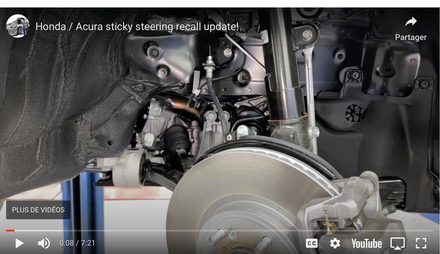

I spoke with the Parts Department at my local dealer. They said they are hearing the recall will be updated so the subframe does not need to be dropped. There will be a part available to allow the recall to be completed without having to do such.

Nice. They will gonna have to remove the fender line and will probably fuck up my carbon screen/mudflaps which was kinda a pain to install. Might have to remove before I go get it done but this is much much better

It is a good news , thank to share
Chance they have do it MooMoo:
