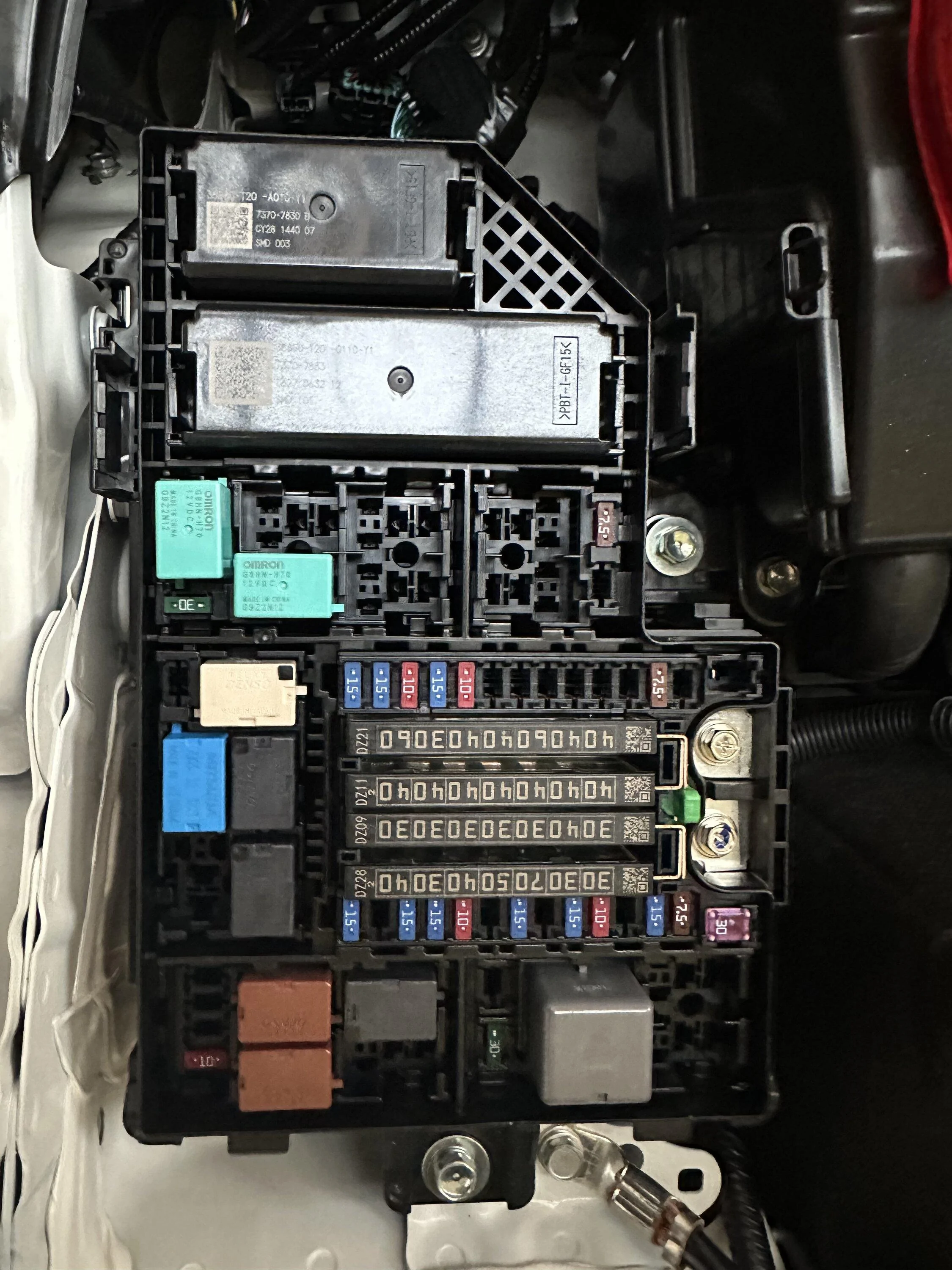

Hi,
can someone help me out. My fuse layout (European 2023 FL5) is different than the one in the pictures. No fuse for the valve.
plus, no scheme for the fuses. Does anyone know which fuse is the one for the valve with my layout?
11th Gen Honda Civic FL5 stock exhaust valve: Fuse pulled/always open - exterior sound clips IMG_2383

Theoretically that makes sense; however, the initial opening of the valve wasn't as simple as just pulling the fuse. There was a sequence of steps in order to keep the valve open.
@TheTopher , or anyone else, have you gone back to stock exhaust valve operation? If so, can you confirm the order of operations? Thanks.
Just be sure to put it back in place. I kept putting the fuse back in the wrong spot and it didn’t close. Finally I put it in the right spot and it closed. I kept it open though.
