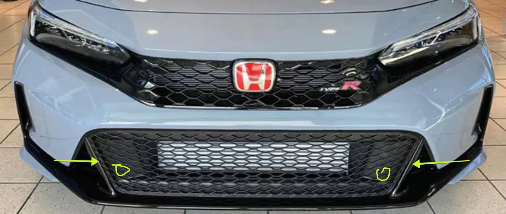

I went out to take another look, what about installing in this area?
seems a piece of flat plastic that I might be able to cut into.
though I have no idea what's behind it, and I rather not cut, but I might not have a better choice...
Not much room to play with behind those areas because of the intercooler end tanks. This post has some PICs that you can reference with the bumper removed.

So I looked yet again...
That empty area on the sides of the intercooler indeed is in front of the end tanks, but the end tanks are flush with the intercooler (if anything they radius backwards), while the empty area I highlighted, is four inches forward of the intercooler.
Put it another way, the empty area is right behind the plastic diamond grill, while the intercooler (and its end tanks) are inset four inches back (between the two arrowhead tips)

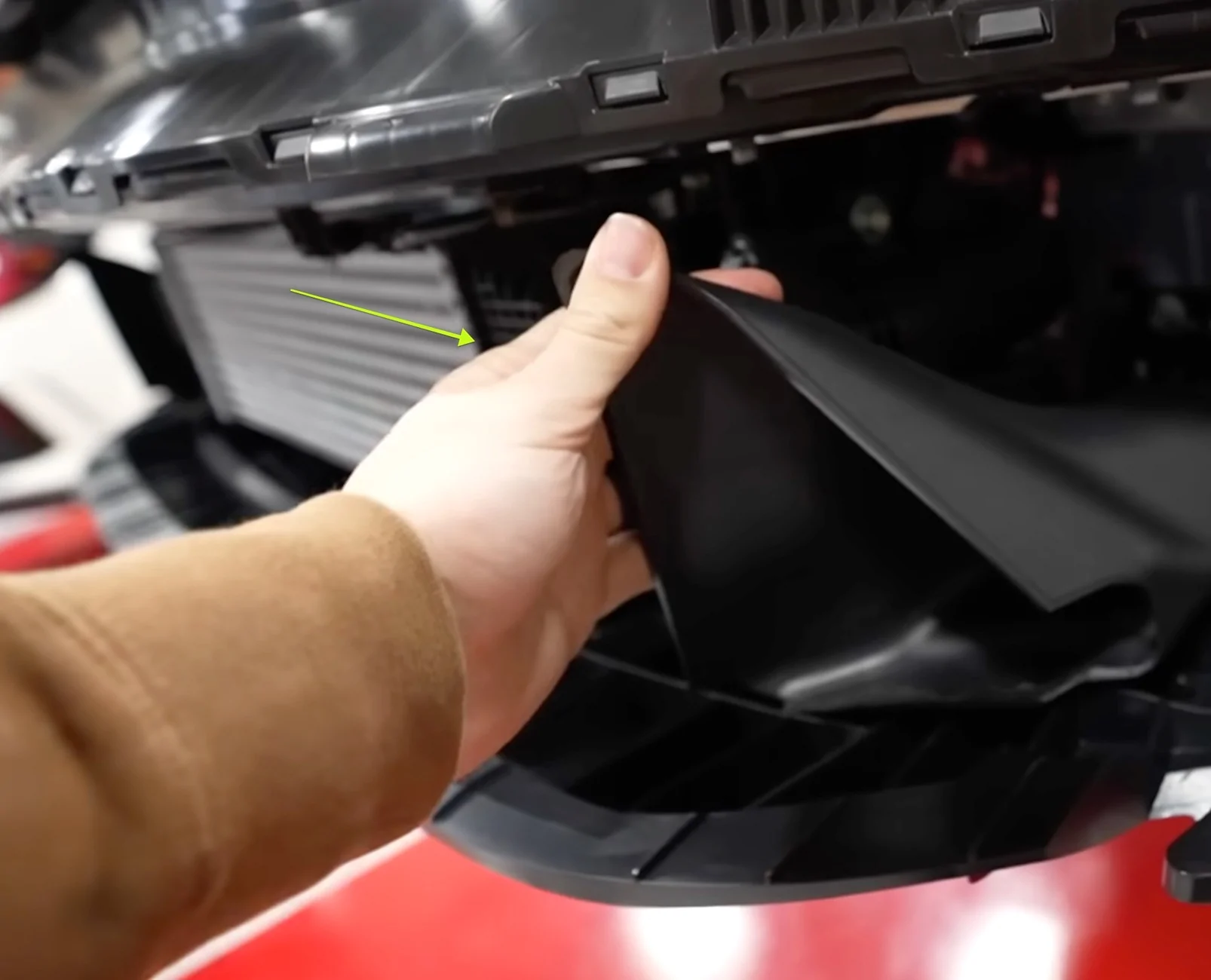

Watching the video below, I noticed that the brake ducts, on the outside of the intercooler and its end tanks are in front of the intercooler, and there is an empty space to the inside of the air ducts, where the guy in the video has his hand (i.e. behind his knuckles)

Are you considering fog lights where the lens would be recessed behind the plastic diamond grill or cutting the grill to have the lens in the front?
I would place the fog lights behind the diamond grill, and cut the flat plastic piece to fit the light.
Note, that I have never taken the bumper off, and this is all just theory, and me thinking out loud.
