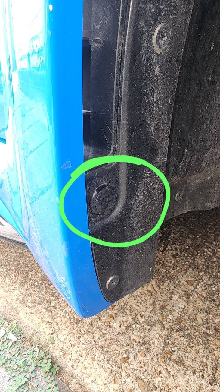

Hi all
Newb question here. But how do you remove these tabs without breaking them?
I'm trying to install fender guards on the FL5. Figured i ask before I break two more tabs. I used flat head. I've used 2 flat heads. Broke both tabs on the driver side already.
Thanks in advance

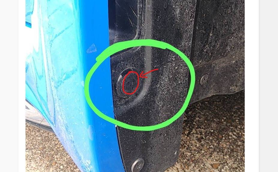

Just pop out the middle (in red below) and the entire tab should pop out easily. You can use a thin flathead or use trim removal tools like these.

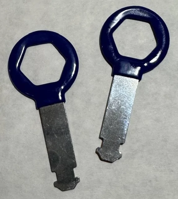

after breaking two of them using the pin remover tool I had at home (the one the looks like a forked snake tongue), I filed a screw driver tip to make it thinner, and used it very gently, moving it from one side of the clip to the other side till it popped out.

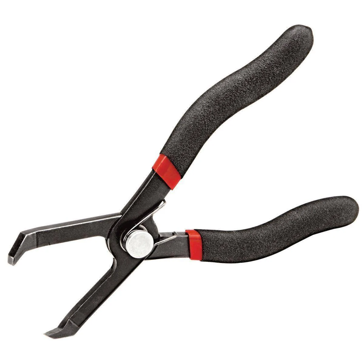

but I am going to get the Harbor Freight Tools pin plier today...
