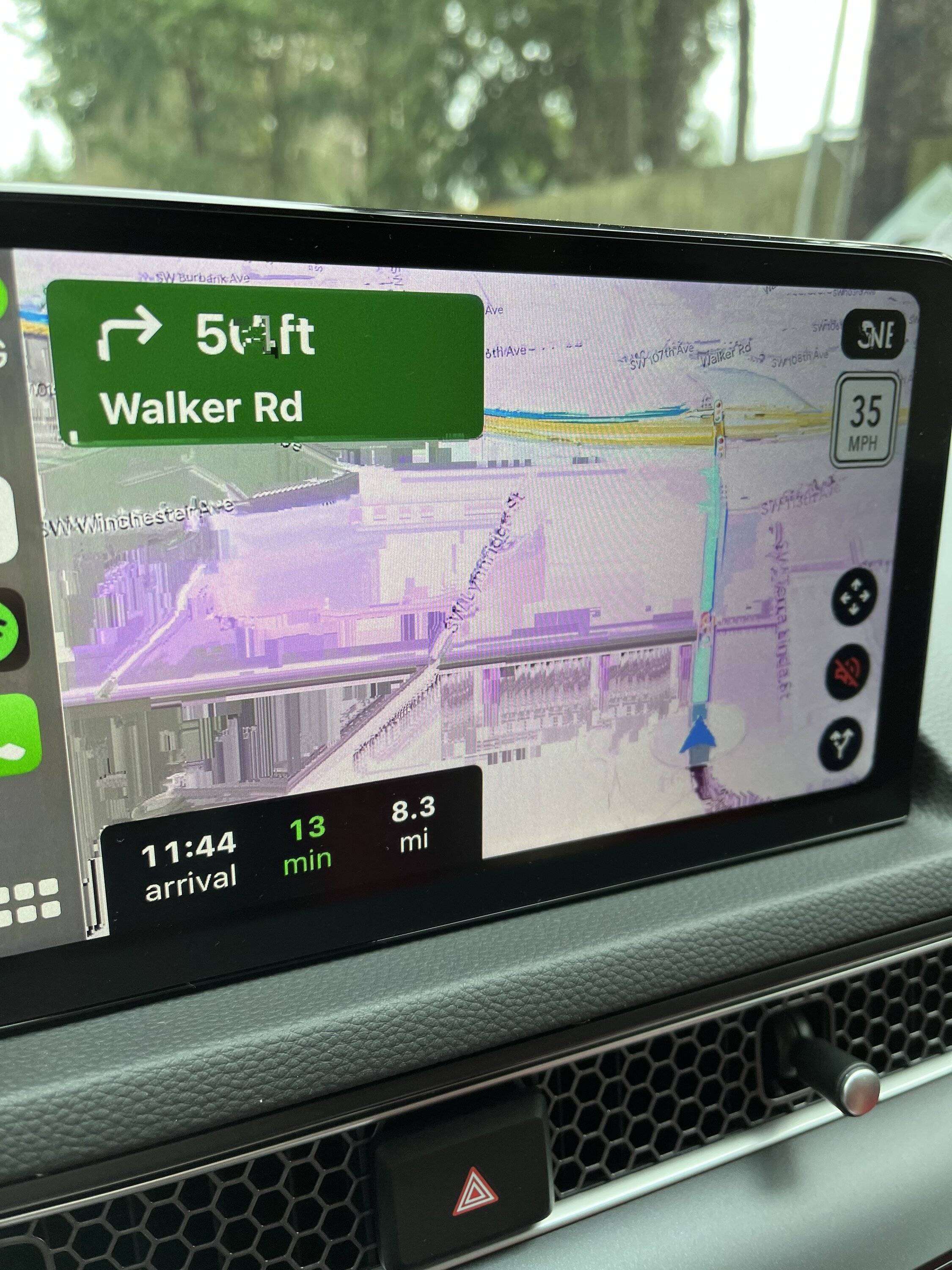

Has anyone seen this happen to their fl5 infotainment system when in CarPlay while also on the phone? I’ve seen comments saying infotainment spazzing out but idk if this is what they’re referring to
11th Gen Honda Civic Infotainment issues while on phone? 82A2B3A8-589D-4887-925C-1DBB1FEFCA00
Update: I read some other forums and videos for the Honda infotainment system in general (for pilots, accords, etc)- seems like a factory reset fixed the issue for now and decreased the lag. For the other Hondas there was a trick to doing factory reset of putting the car in reverse while turning the car on and off or something, I'm guessing there wasnt a setting to reset in the infotainment system itself. I just tried in settings to do the factory reset and for now the Honda GPS and carplay google maps works fine, no freak outs and no lag. For now.

Yup, same here. It's a crapshoot as to how long it'll take before the screen tearing happens, but it always happens.
Curious to see if this is exclusively a CarPlay issue - wonder if Android Auto has the same problem.

Does it without being on the phone. I always have to close out and go back in. Once it starts I know I'm screwed for the rest of the trip.
Damn haha first time happened to me and I’m like wtf…
By closing it out what do you mean? Like turning off the car?

my old ass iphone 11/12 mini did this. After changing to S23, Android Auto has been doing great without breaking screen :)

Any resolution? This is happening constantly.
No fixes as far as I know, but it hasn’t done it for some time now for me. Also noticing it doesn’t really do it when I go into the miniature gps mode with music showing
