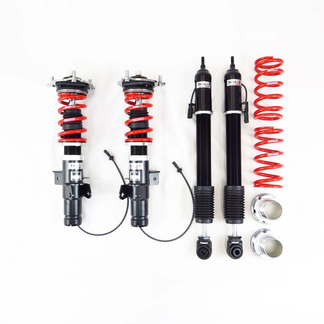

If you change to coilovers, the RS-R coilovers use the FL5's active dampening system.

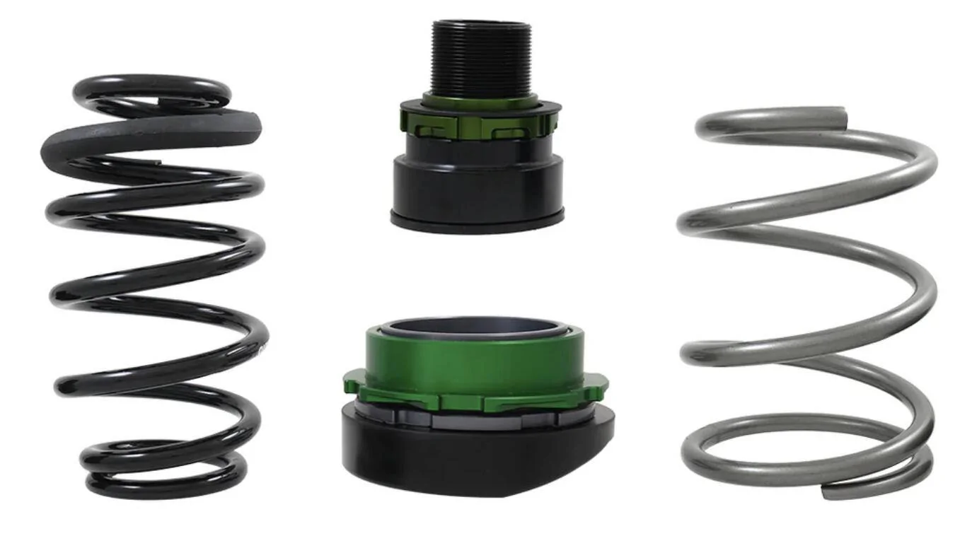

Not really a coilover IMO, more an adjustable spring. It's definitely an option for those who just want more control over the aesthetics of a drop, but if you're after performance I'd stay away. Springs might actually be a better option but I don't have any data to back that up.
I originally had the thought that I'd stick with springs to maintain the factory adjustable dampers. I think that's a mistake and will very likely switch to a coilover setup in the future (waiting to see what's up with the HRC parts...). The dampers are engineered to work with the OEM spring rate and travel, I just don't think changing the physics arbitrarily with aftermarket springs will yield a net positive result. Just a hunch.

🤔 I mean, I guess that can make sense for the rear since its still a divorced setup.
https://www.rs-r.com/product/honda-civic-type-r-2023-best-i-active-coilover
