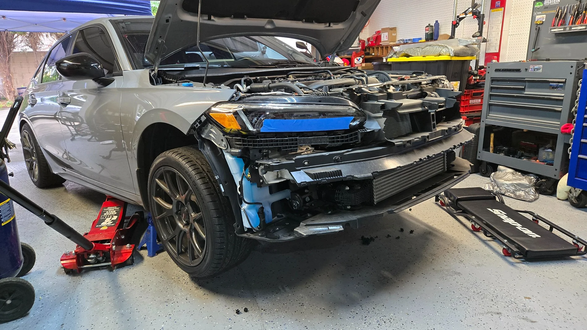

I use a small jack (2 ton) to slightly jack up one side from front pinch weld. Then use my 3 ton jack to raise from the front center jack point (deep under the front end).
Then I use two jack stands under the front pinch welds.
I also put a jack or two behind the jack stands, that is just barely touching the actual pinch weld which is covered by the rocker molding.
