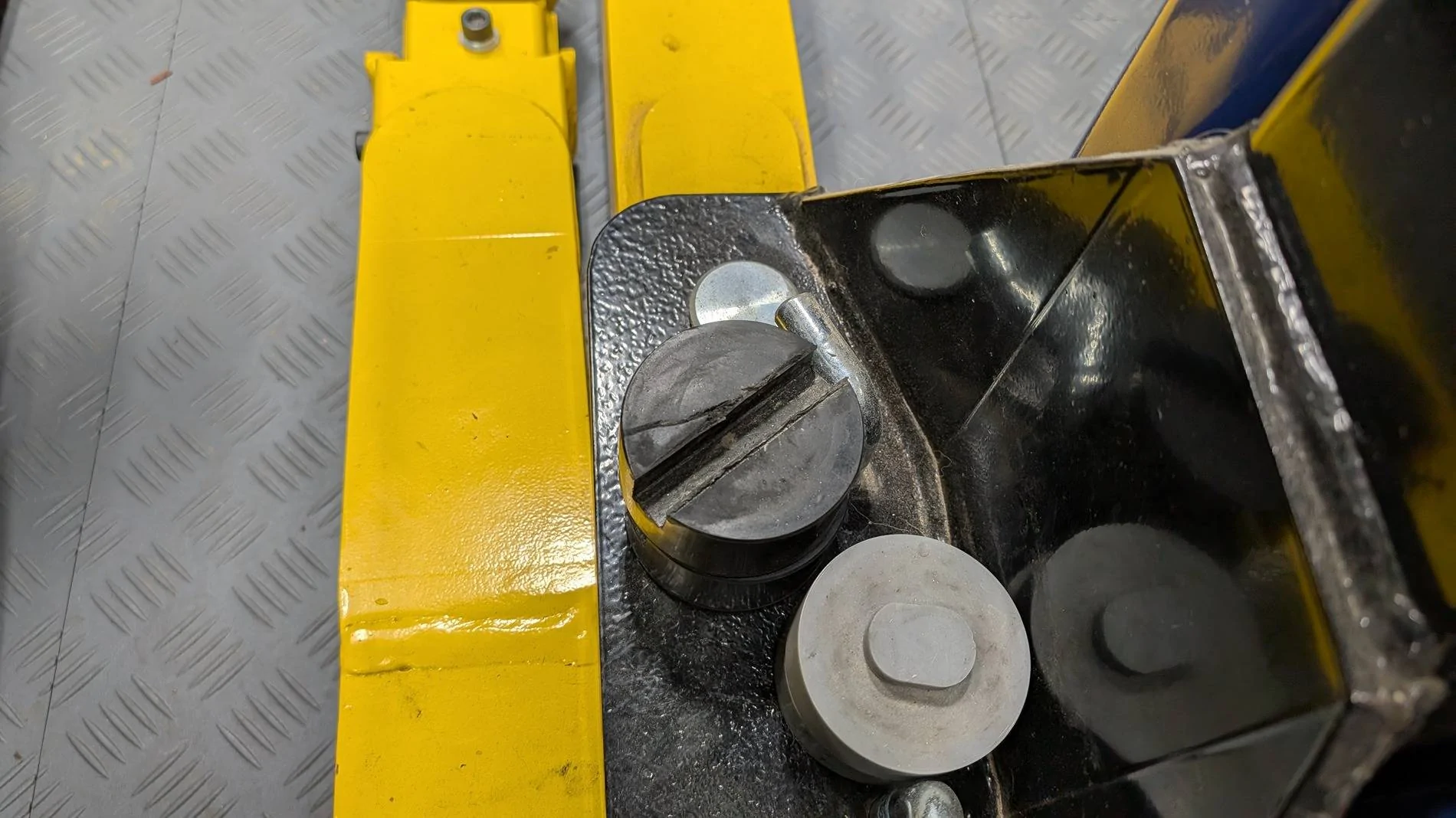

They sell jack pinch weld pads that just sit in the jack instead of this product, these are intended to be permanently installed.
jack. do you know of any. jack pads that are NOT permanently installed? I use my 2 post rotary to take care of a RSR Porsche race car also... and the pinch welds are so bad there it no longer matters!!

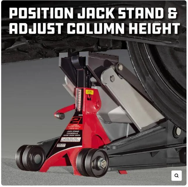

I just posted this in another thread but I will post it here too. I am trying to convince myself to not buy it as its not super hard to drive up on some pieces of wood and jack from the center point. But as I get older, the more lazy I get with this stuff lol.
Instead of buying pinch weld adapters (unknown safety) and quick jacks (expensive) the u-jack seems like the middle ground pricing wise, and also the most efficient way to get the car up in the air.
Basically you jack the car up on the factory pinch welds and then slide a jack stand into the groove. Probably half the time for setup with the QJ.

Thanks for creating a new need to have for me. I'm with in the end this is a great solution

$255 on the jungle site....I guess I know what I'm buying today.
https://a.co/d/irre67L

Cuz I already have this next time I have to put car on stands I will use these
https://www.amazon.com/dp/B00GJJZ5NI?ref_=ppx_hzsearch_conn_dt_b_fed_asin_title_3
Also have rubber pads that install permantly on it so won't scratch the pinch welds.
Do still need to drive the car on ramps though, however with 2 of these just drive car on ramps, jack each side and lock the bottle jack/jackstand combo and you are good to go.
Not to mention I also have at least 3 methods keeping the car up so the ramps will still be under the front wheels just in case and then have the jack in the mid point as well just in case.

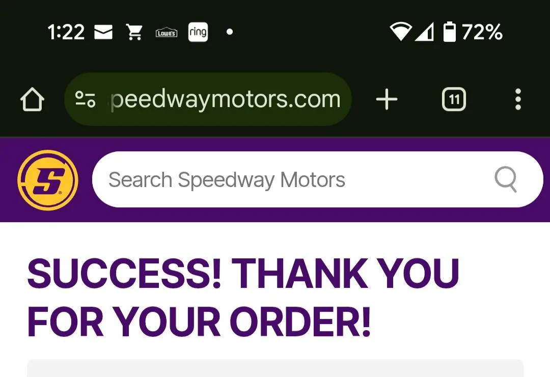

Speedway motor got this for 200 dollar but too heavy for my weak ass arm, so i returned it.

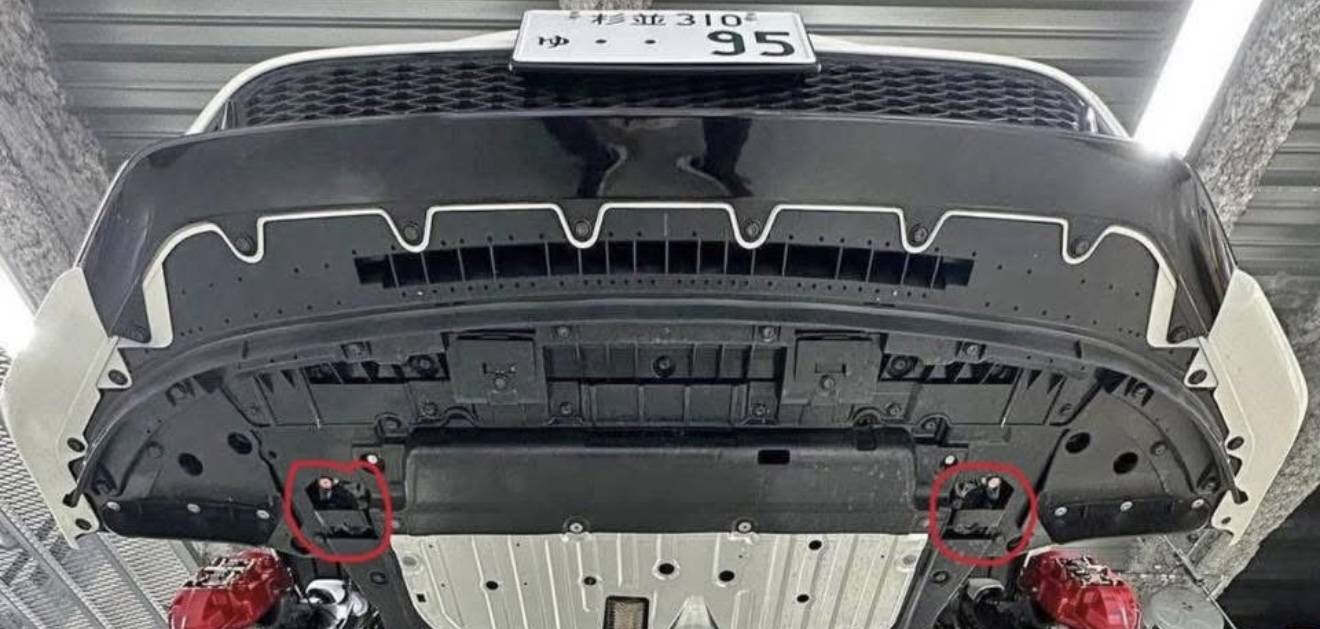

I saw a post on facebook with a person mentioning that they jack the car up on the front tow hooks, and then place the stands on the pinch welds. Anyone else do this?
Edit - found a video of an integra rmm install. Seems like an okay, unsanctioned jack point lol. Gonna try this next time instead of driving up on boards to get the center JP.
