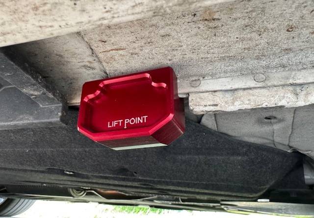

I bought the ZL1's earlier this year. I received them about a month after ordering.
Their sole purpose is to provide an alternative lift point so you can place jack stands under the folded over lift pads. Otherwise, you would have to put the jack stands on the pinch weld area. Here is a PIC for reference (I only tightened one screw to snap a PIC as I only use them when I need to put the car on jack stands):

There are no issues leaving the jack pads installed permanently, use loctite and tighten properly. I have done it on multiple vehicles with no issues.
I second that comment about secondary jack point to assist with putting the car on jack stands. Also makes it dummy proof when your car makes it into a shop for any reason. Lessens the chance someone crushes the pinch welds.
Good point to note. While we are discussing applications, the two brands mentioned in this post may have slightly different uses. The Versus pad is designed to install over the folded point on the pinch weld, based on the install video I watched. If that’s the case, Versus only provides a single use point, unlike ZL1 that allows for both jacking and jack stands at the same time.

Its not so much about damaging welds. Well the verus ones are but the ZL1 ones are not. The point of the ZL1 ones is that you can jack the car on them and put a jackstand on the extra reinforced pinch weld next to it. Reason this is sweet is so that you don't have to put the car on ramps then use the jack in the middle point to lift car, then put the jack stands. Are these needed? absolutely not but for users of jack stands they could come in handy.
Rubber pad works fine and arguably better since its soft and wont take paint off. This just makes things easier for people that want to put car on jack stands. The verus ones basically don't do that and are just there so that you don't have to dig the rubber pad, can just put the back/jackstand and go. Again none is necessary and can be argued that both are a case of people wanting to spend money on things they don't need.
As far as track goes, as I mentioned, PLEASE TAKE THESE FUCKING THNGS OFF. I don't care if you use loctite, shit rattles off and this coming from under a car into my windshield will not be a good time. I have had something fly out on me from under a car and was fucking scary, I was lucky and dodged it but could have beem a cracked windshield or as optronix mentioned kill someone.
