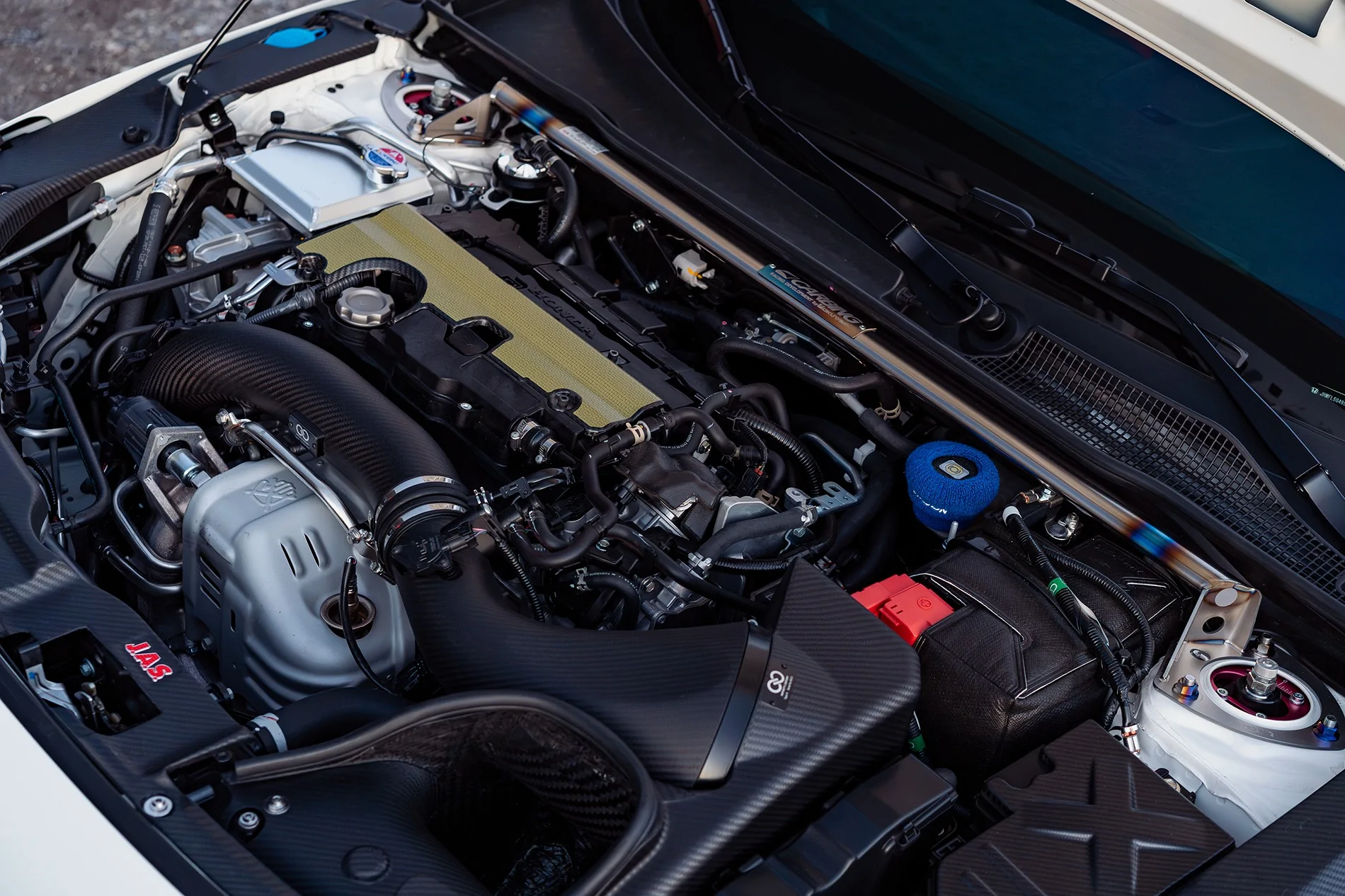

Engine bay pic for attention 😆
11th Gen Honda Civic Kazuo_WFC 2025 Civic Type R build DSC01400 (1)
11th Gen Honda Civic Kazuo_WFC 2025 Civic Type R build DSC01321

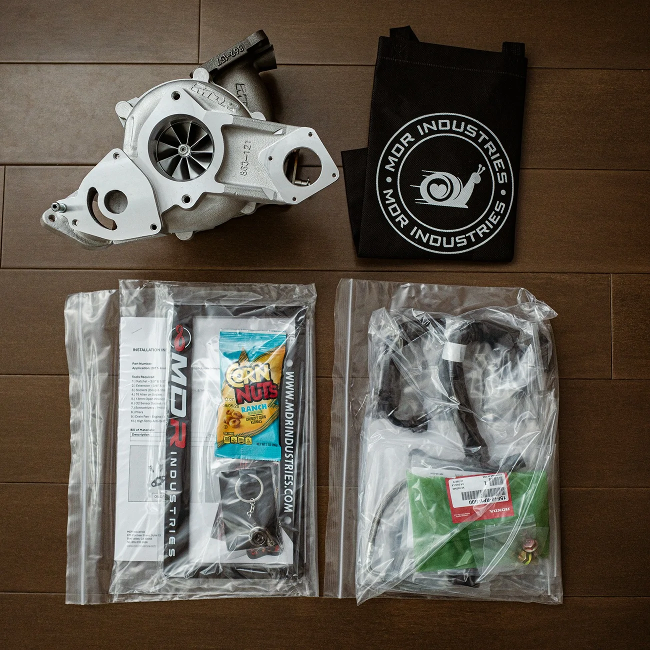

Ranch Corn Nuts are goated.

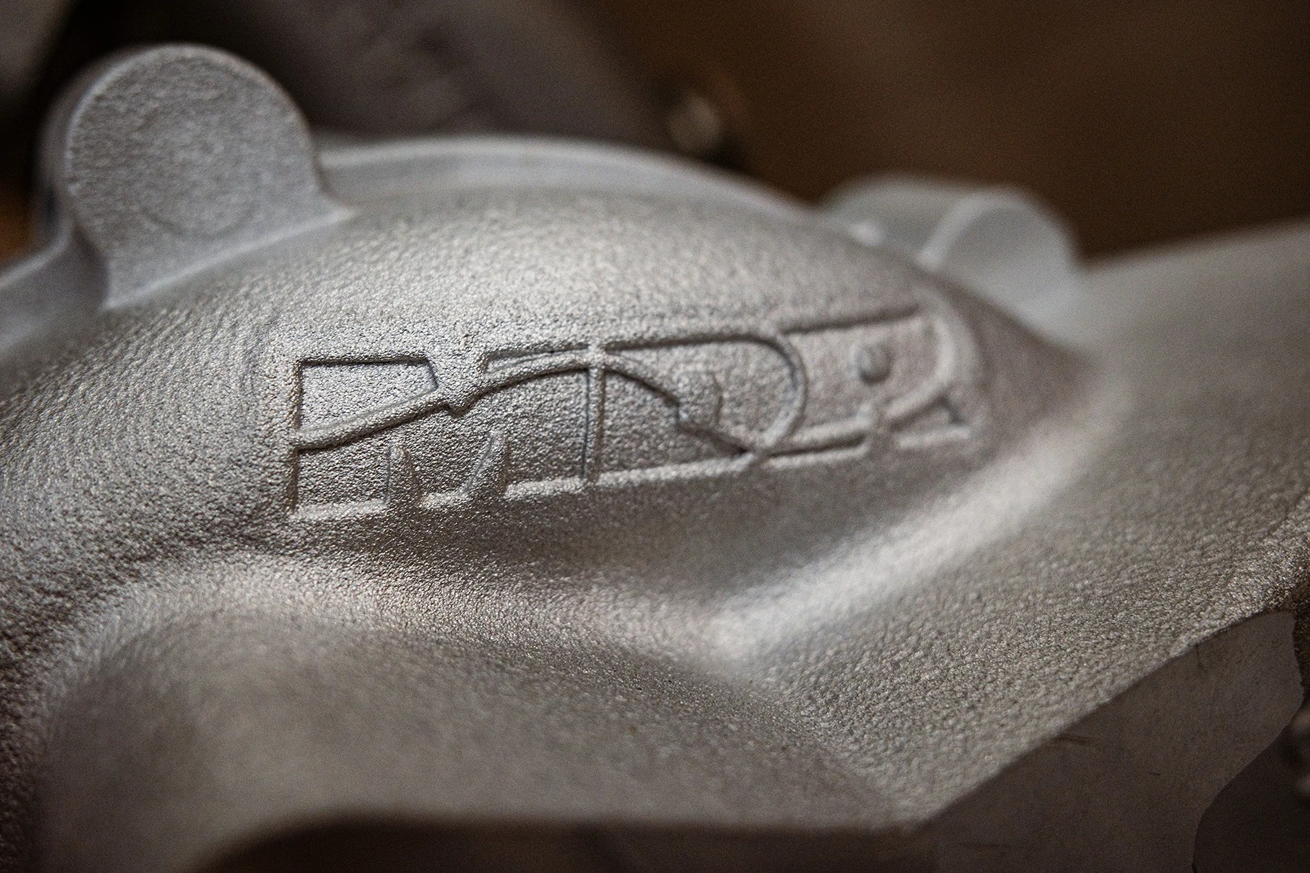

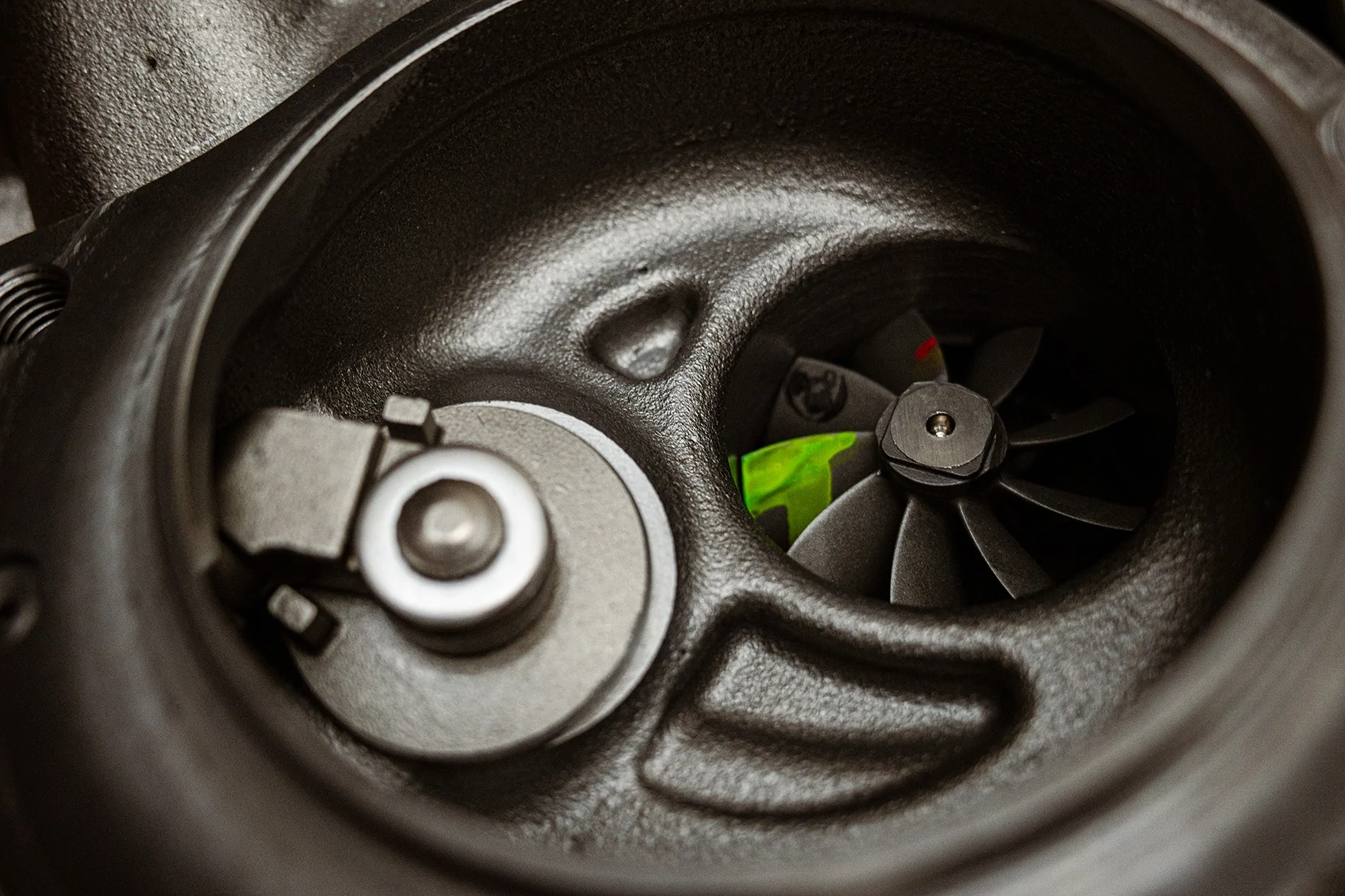

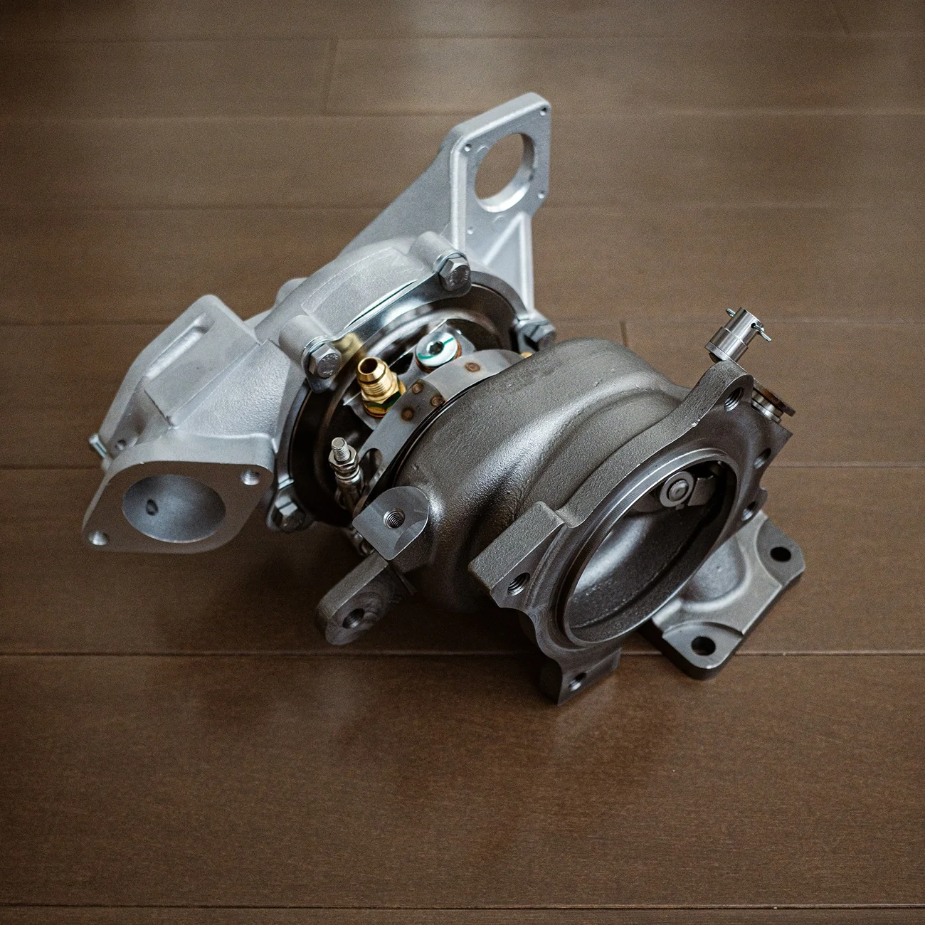

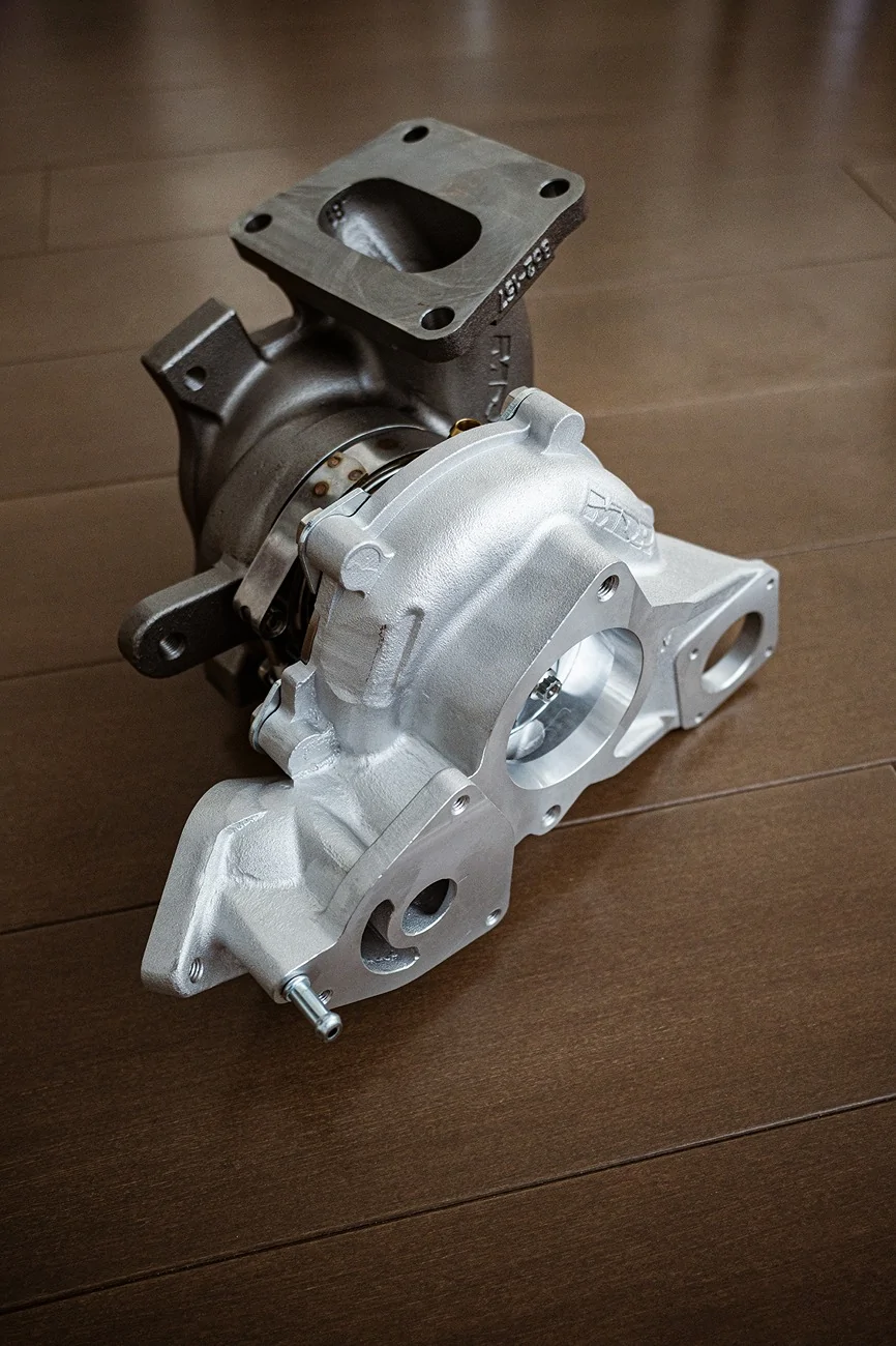

Well I went with MDR's g25 660! Not chasing peak power just want to feel the rush while cruising and SoCal winter track days. Their kit comes with all OEM replacement hardware and printed instructions. Only thing left to consider is fuel. I think.
I'm going to guess it'll be another month until I can get everything on which is good since it'll give me time to get used to the power from the otf stage 1 from Cobb. Pushing in the canyons last weekend really got me itching to do some track days but I want to go in hitting the ground hard as I already know what to expect in a 440 at the hub FK8 on e40. I don't think I want to run pure e85 and probably still opt for a blend but we'll see cause as they say: buy once....

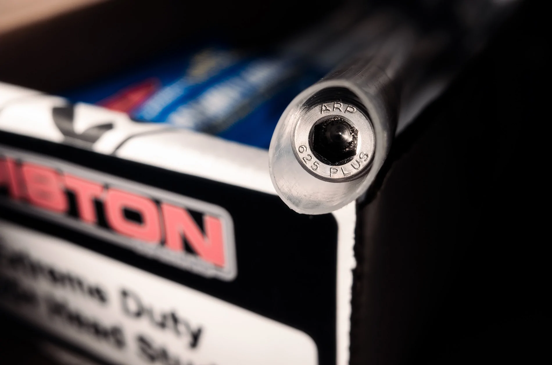

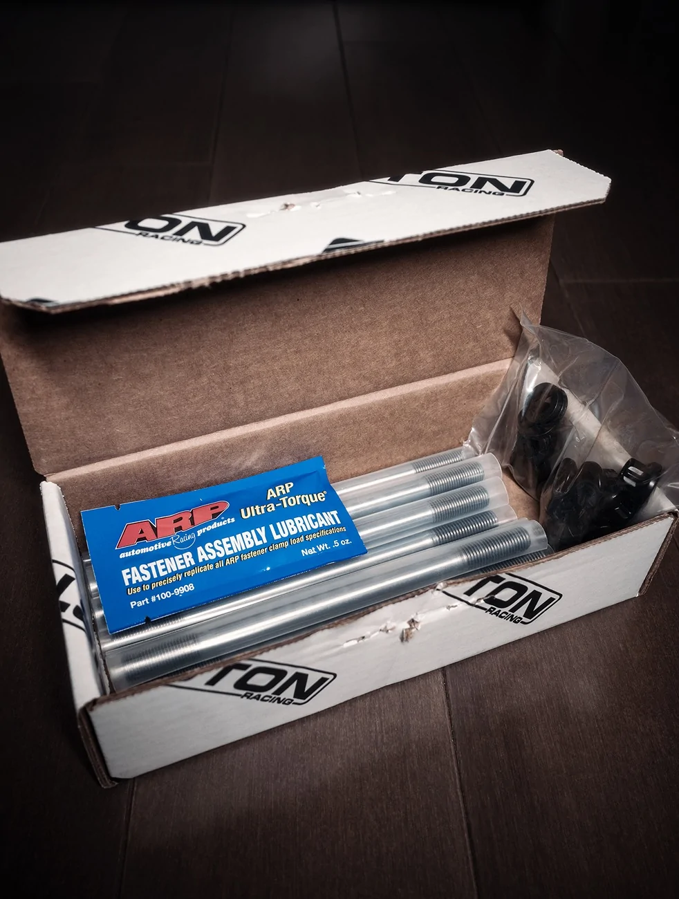

4 Piston 625+ Extreme Duty Head Studs came in. I'm skipping on doing the Ferrea valves, as that'll mean more downtime since the head would have to go out for machining. If shit goes boom later on or I lose more brain cells, brain cells lose more likely, I'll go ahead with rebuilding the motor to be bulletproof.
Rather test the waters with minimal effort in mods since plenty of people have pushed this engine to absurd number, at least ot me, compared to what people expected back in 2020 on the FK8.
11th Gen Honda Civic Kazuo_WFC 2025 Civic Type R build 1780784453000_R0000965
11th Gen Honda Civic Kazuo_WFC 2025 Civic Type R build 1780784345000_R0000964

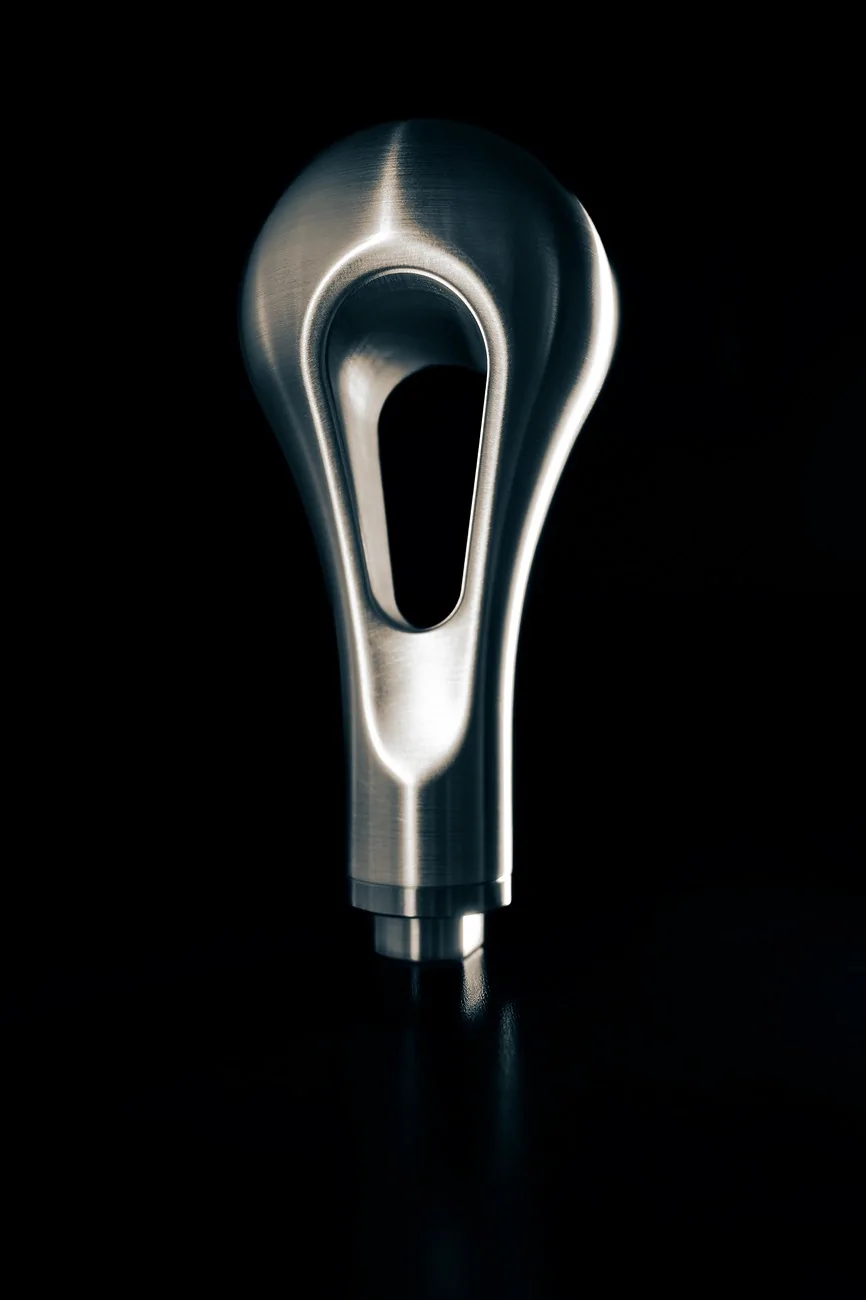

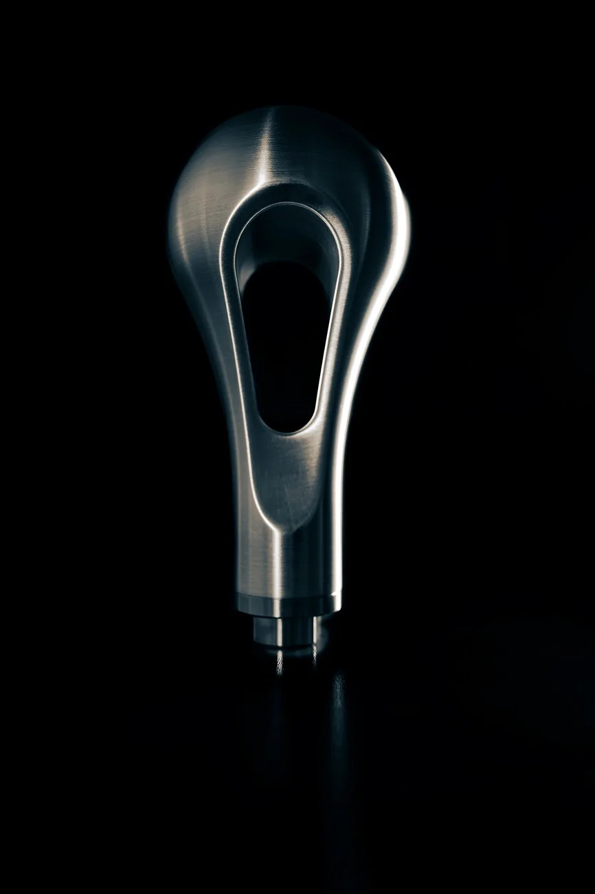

Extra LDC shift knob came in. I picked up a bare one as I'm thinking of doing something with it if my other project works out. 🤫

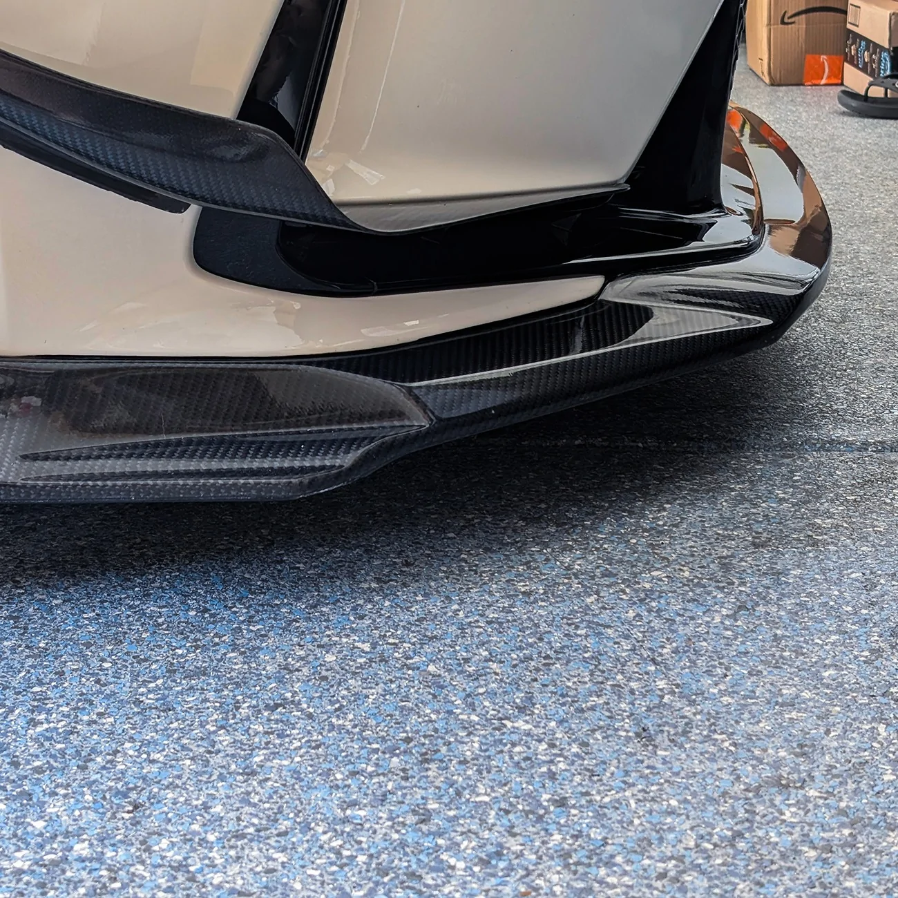

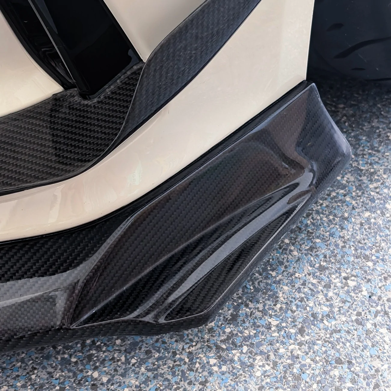

Update on the Cusco front lower brace....still didn't put it on. 😅 But I did redo the Cleib front lip. The rivnuts Cleib supplies aren't made for plastic. I can understand their thinking in putting rivnuts in the bumper instead of the lip since it'll be an easier install but they should provide slotted rivnuts so it'll crush into a cross with a larger bite area.
11th Gen Honda Civic Kazuo_WFC 2025 Civic Type R build PXL_20260609_163947952

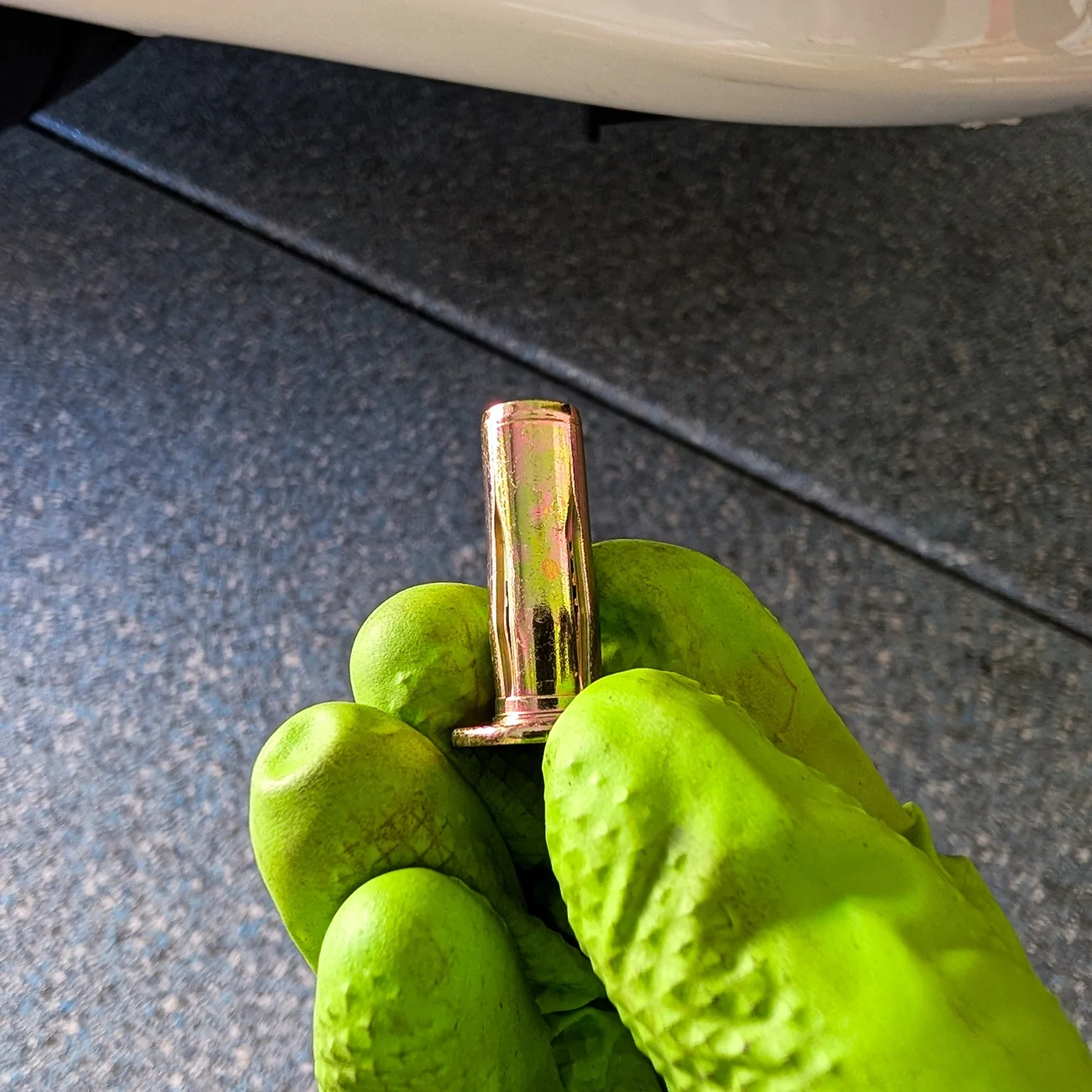

I ordered these from Amazon but if anyone wants to do this I'd suggest finding the shortest slotted ones in m6. The ones I bought are 28mm tall.
Once you get to the front of the bumper (black grill piece) there's not enough space to fit them, I had to insert them at an angle and half crush them to get enough space to fully seat them to the bumper.
11th Gen Honda Civic Kazuo_WFC 2025 Civic Type R build PXL_20260609_164210384
Lip is now secured for more thrashing. I added black silicone to fill in any gaps, it's really not bad but I still have the tube from redoing the canards so I figured why not before it completely hardens haha.

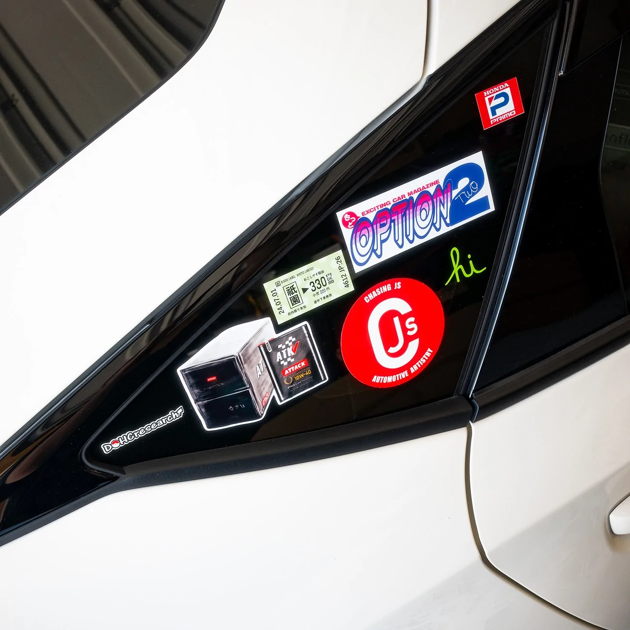

Did the responsible thing and added some much needed rice to the car. "Sticker bombed" the little window to block some sun for when my daughter is in the car. 🤡

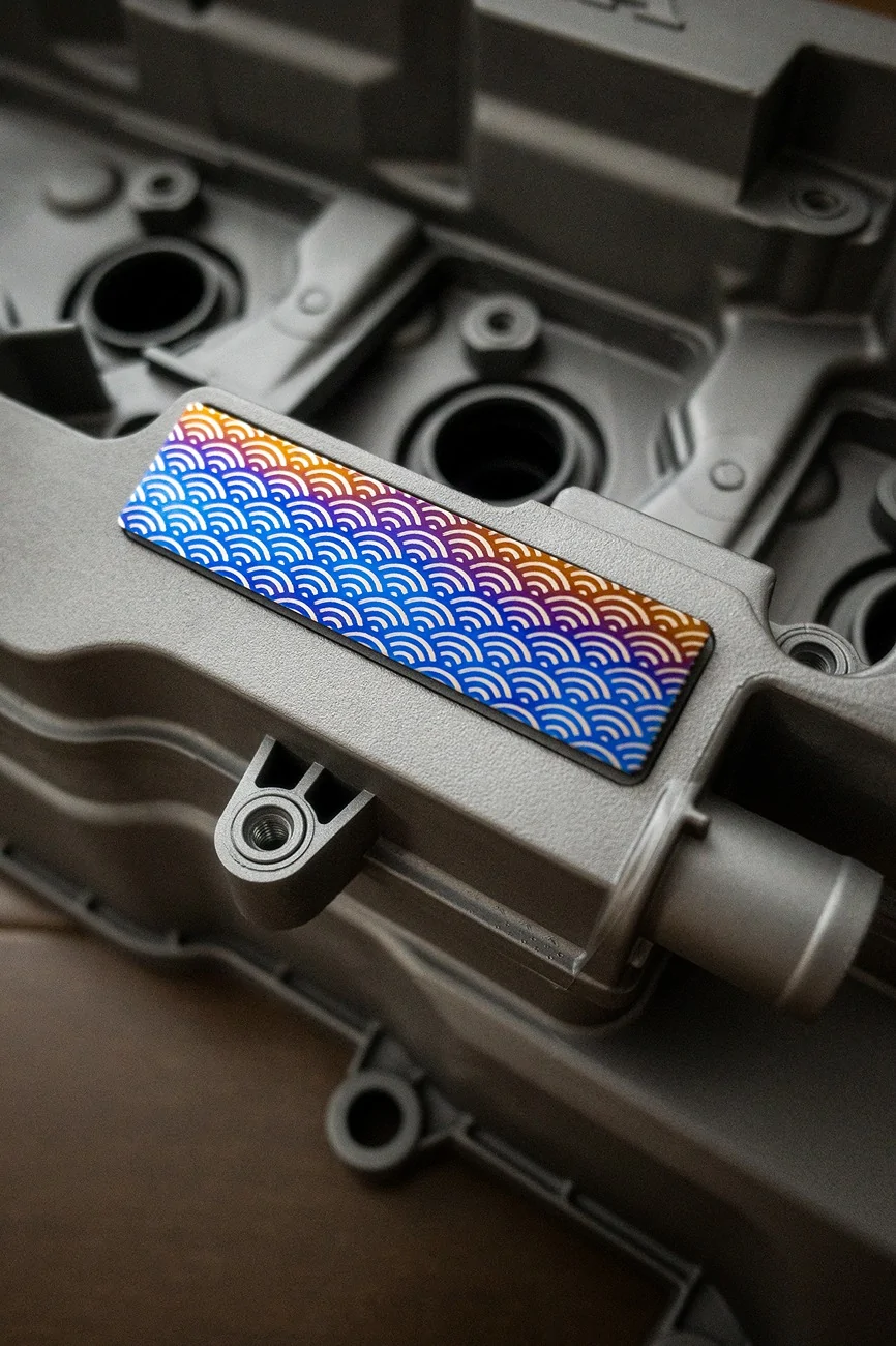

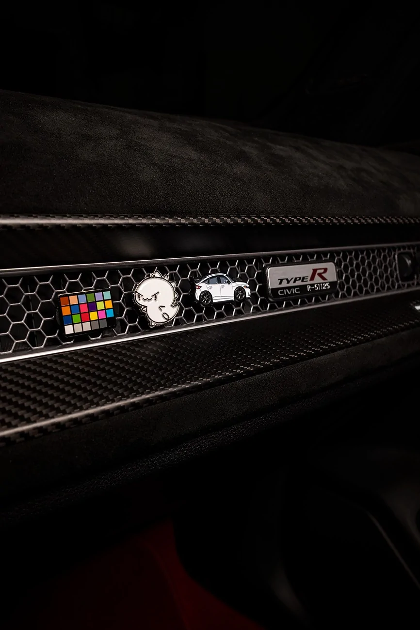

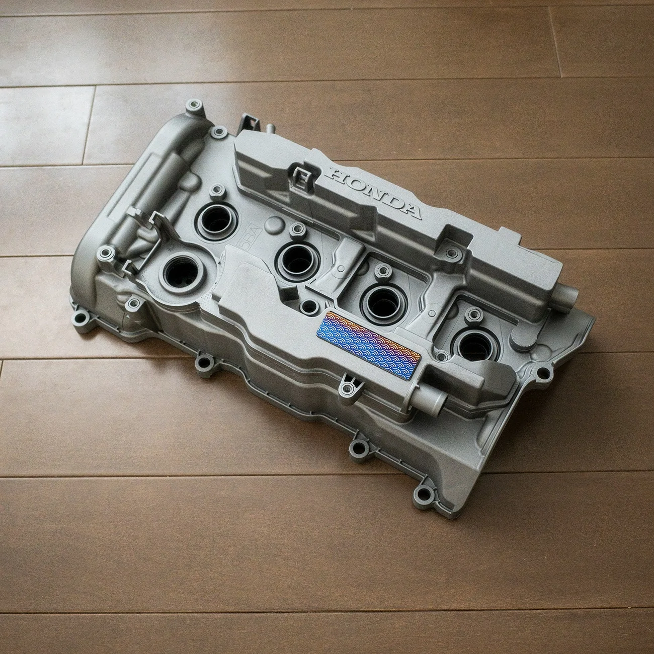

Custom titanium badge arrived from GT Autowerks. His turnaround was quick and he worked hard in getting the design I wanted perfect. I didn't want to mount the badge yet so it's not completely laying flat on the surface.
It's a traditional Japanese pattern called seigaiha. Repeating waves of the ocean.....basically to me it means this build will be an ongoing journey with ups and downs but nothing will diminish the impact of the memories made.

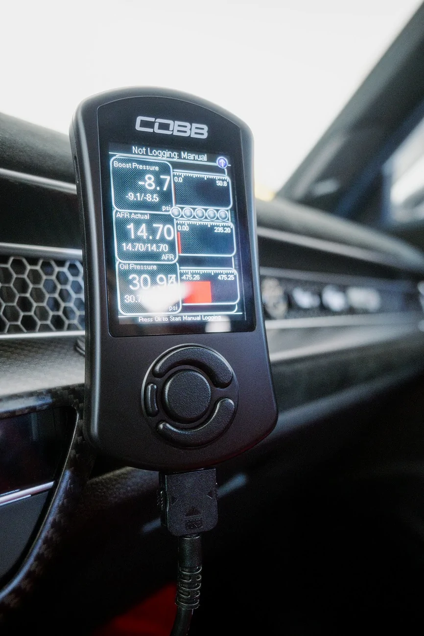

Mounted the Cobb Access Port on the car with the optional Scosche MagicMount Pro. I originally wanted to use the Offroam mount but the cf overlay piece makes it too thick to mount properly. Oh well. I'll hold onto it for now since I might change it up down the road.
I ended up purchasing an unlimited tuning package from JST Performance. Wanted to get a baseline done before all the headwork and turbo upgrade goes on this weekend. I was messaging Brian on here and what he offered and explained to me sounded like the best path with my limited time to mess with the car on a day to day basis. I love the fact I can just log 3rd gear pulls and send him the data and they can update the maps. I'll still do a dyno session once EVERYTHING is on to get a really solid map for the car but man...just the baseline tune he sent me to use to log with was amazing. Car pulls so hard to near redline (6400~) stock turbo exhausted literally.
Well here's to hoping to a smooth install weekend.

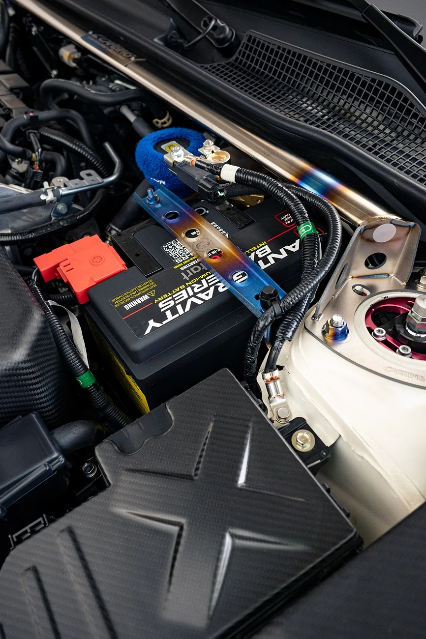

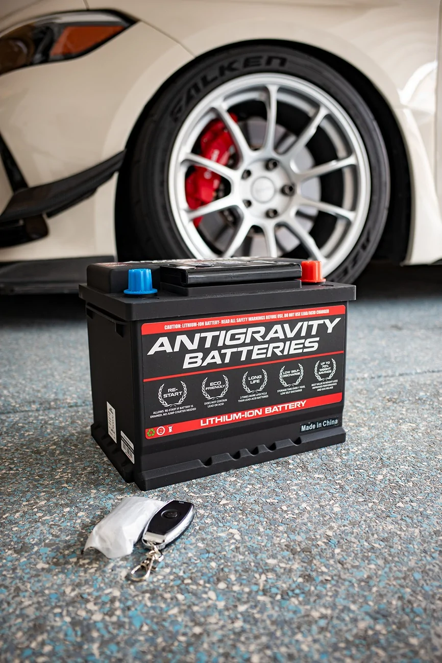

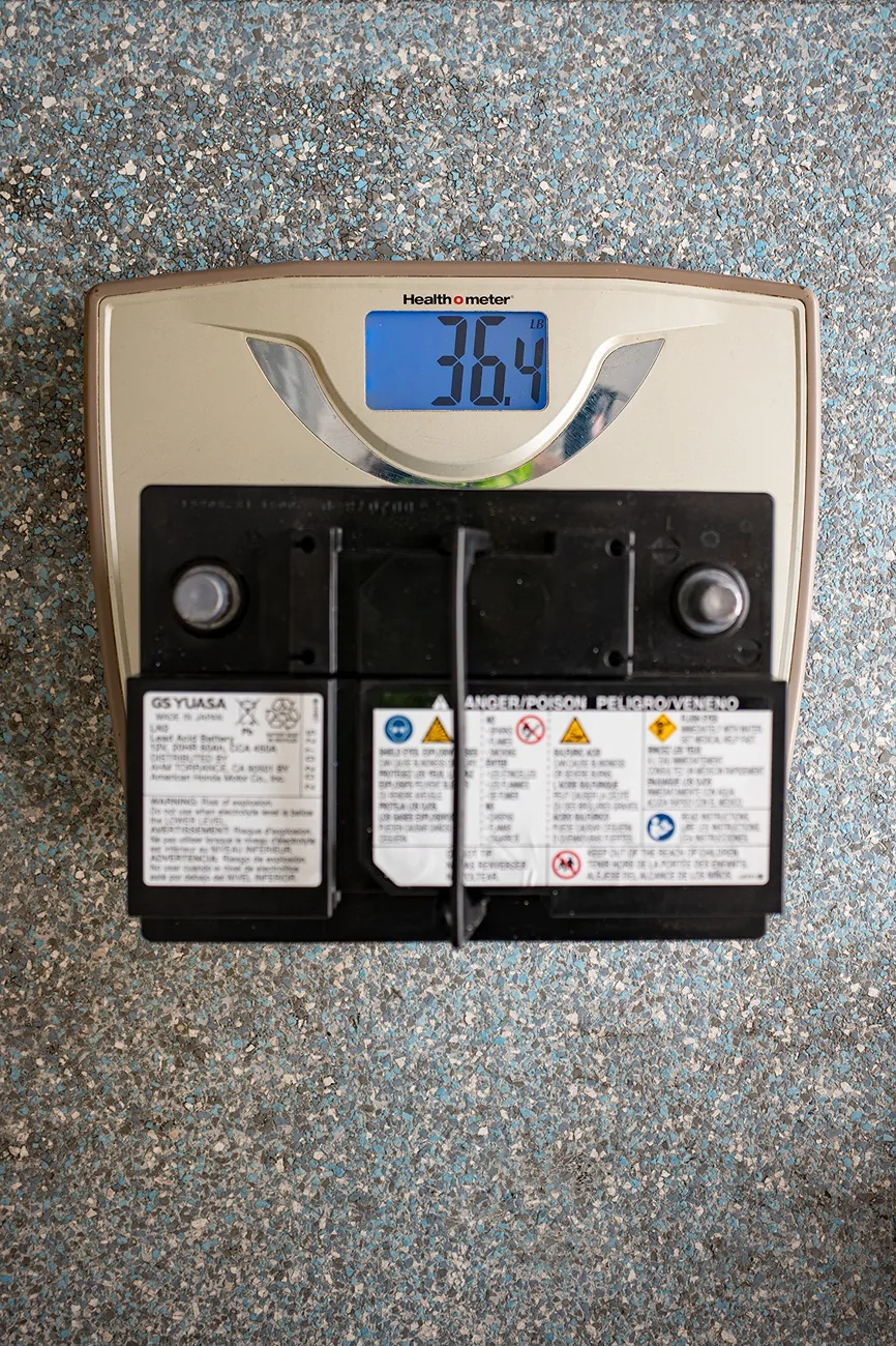

I said I'm going to do all the mods I never did on the FK8 so here we are. Lithium battery from Antigravity Batteries. Their H5/Group-47 is a direct replacement battery so easy install. Weight difference is sizeable and honestly I think it's worth it for the price point and how much longer it'll last over the traditional lead-acid type. I usually end up buying at least 1-2 batteries if I hold onto a car for 8-10 years.
11th Gen Honda Civic Kazuo_WFC 2025 Civic Type R build 1781814802000_R0001029

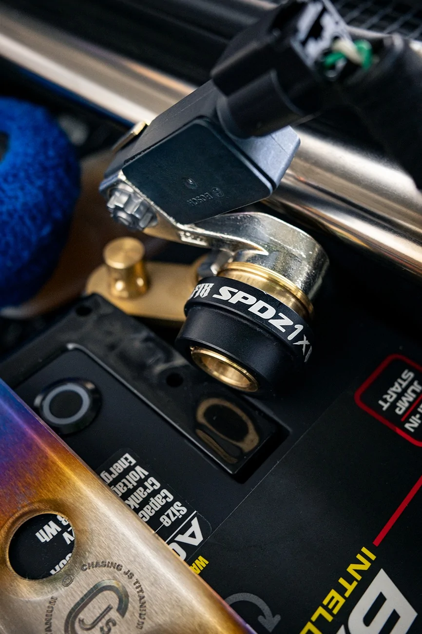

Also installed the Speedzone x Ballfix Racing Quick Release Battery Cable Disconnect (I had to copy paste that product name cause fuck remembering that) Just call it a quick release battery post or something...anyhow. Much needed for me since the strut bar would make access to the neg terminal somewhat of a pain. Now I just pull up and it pops off. Push down and snaps back in.
Oh for the Chasing J's battery tie-down kit....with the Antigravity Battery you probably need another half inch length for the hook on the side closer to the strut tower. I had to hook it onto a grounding hole which was a bit higher. Going to hit them up on getting a slightly longer one.
11th Gen Honda Civic Kazuo_WFC 2025 Civic Type R build 1781818196000_R0001043
11th Gen Honda Civic Kazuo_WFC 2025 Civic Type R build 1781818234000_R0001045

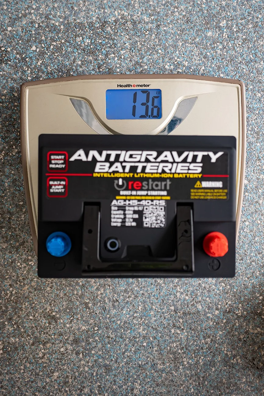

OEM Battery:
11th Gen Honda Civic Kazuo_WFC 2025 Civic Type R build 1781815692000_R0001032
Antigravity Battery:
11th Gen Honda Civic Kazuo_WFC 2025 Civic Type R build 1781815723000_R0001035
22.8 lbs difference!
K time to load up the car with parts to take it to the installer. I'll be trying to learn as much as I can with the install....I have a rough idea what needs to take place with the head work but I want to see it first hand and see if it's something I can do for friends later down the road....and blow up their motors.
