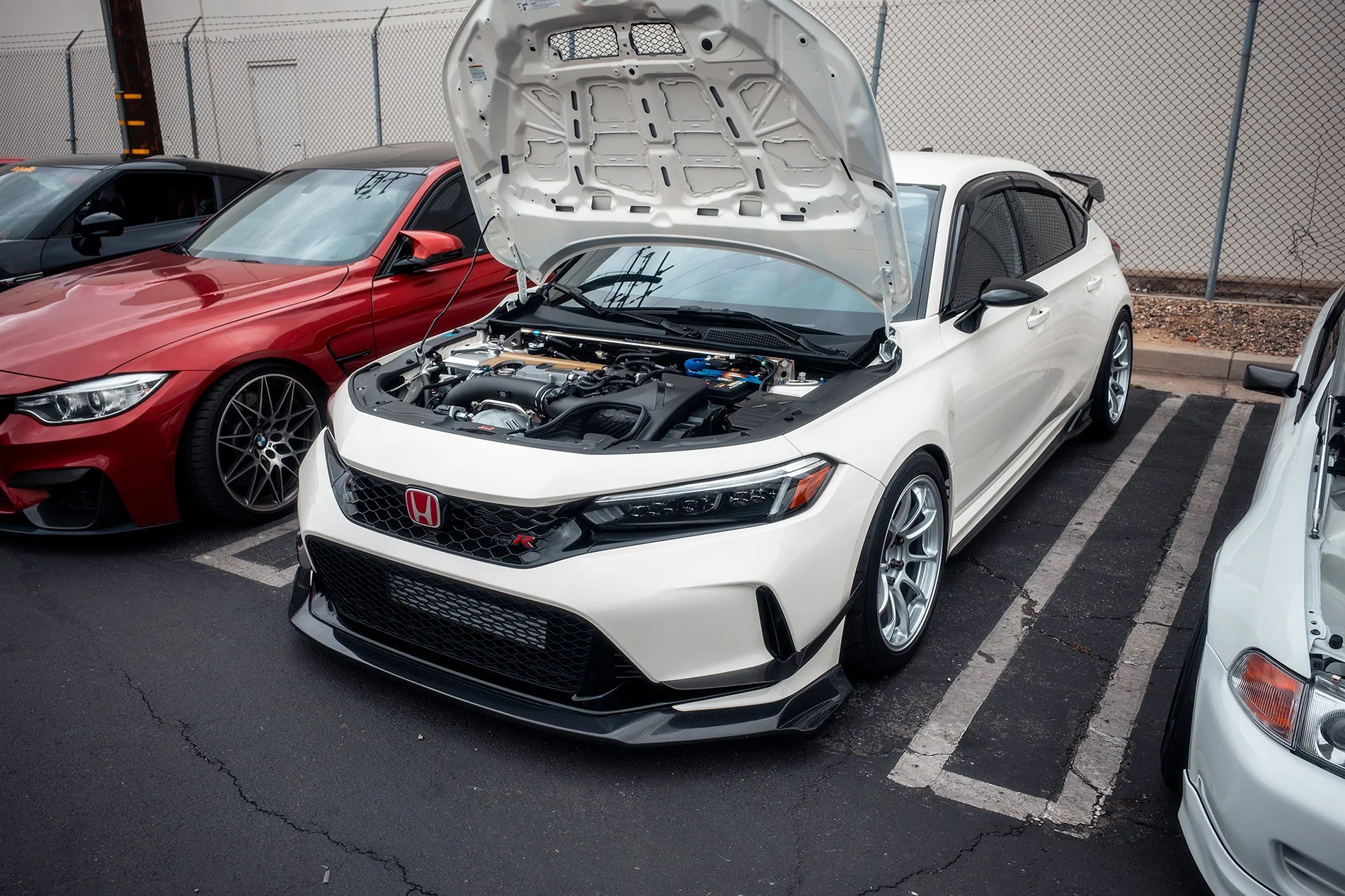

Updates on the Spoon brace bars.....so yeah my bucket seat doesn't creak anymore when I exit the car....wtf. I noticed it today when I showed up to a meet this morning. Kept the Civic's brain lid open to show all the useless bling bits that no one sees 99% of the time. As a photographer I avoid open hood shots of car unless it's got an LS swap or something really dumb like a k series in a boxster.
Hey man those K swaps in Porsches are legit. Everyone knows about the IMS bearing issues, but not everyone talks about the VICTIMS. The K swaps are a perfect solution for folks whose M96/97 engines ate shit and they don't want to go source another Porsche engine when Honda engine do trick.
I completely agree. I was just using the word dumb as in stupid dumb (cool dumb) haha.
