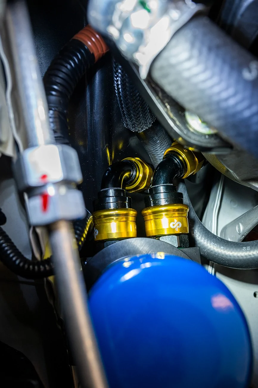

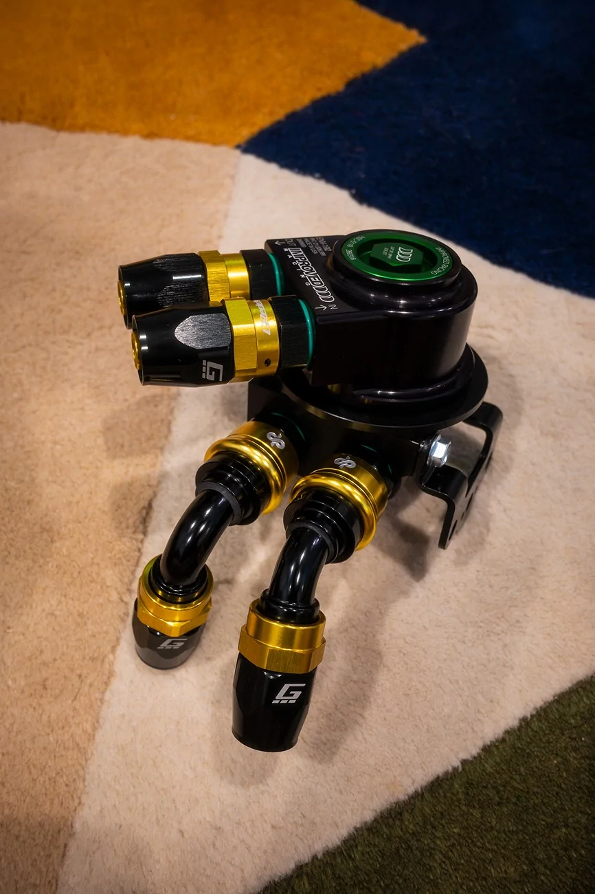

Rest of the hardware came in and I couldn't help myself to assemble something stupid. Looks like a tachikoma from Ghost in the Shell.

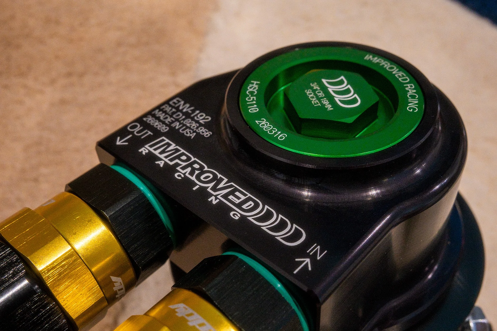

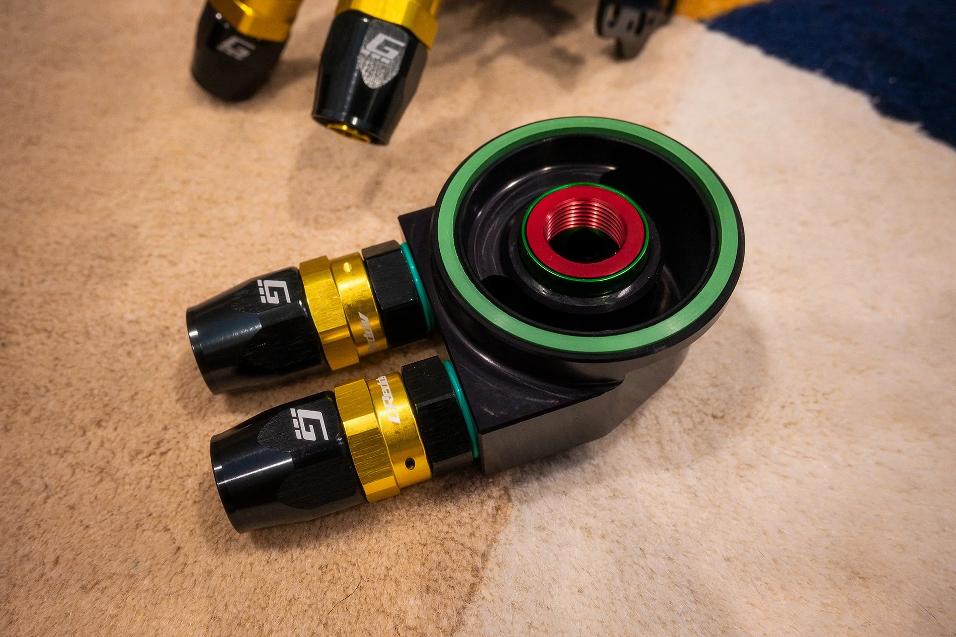

Ok so I'll just list everything I'm using to make this oil filter relocation kit/oil cooler kit (later on). This is completely custom pieced together from my stupid brain as I got the idea from looking at the empty area on the bottom left of the bay. 😅
Parts list:
Improved Racing Low Profile Remote Oil Filter Relocation Adapter (Gen 2)
Improved Racing Remote Engine & Transmission Oil Filter Mount. I plan to add a custom oil cooler later on so I went with the 4 port one. There's a 2 port which will be easier to fit in the space I went with if you decide to do this yourself as well. They also make a 4 port with built in thermostat.
Both those parts require M20x1.5 adapters which they provide when you go through their configurator.
GReddy PRO/SPEC -10 Quick-Release Swivel Hose End - Black / Gold anodized (1x 90 deg and 1x 60 deg) I'm sure there's other angles that can work but this is what I came up with based on a visual inspection.
GReddy -10 ORB male Swivel Hose End(s) - Black / Gold anodized (2x straight ORB)
Dyme PRO/SPEC ORB (Standard) Adapters (2x ORB 10 Male PS Size: 10)

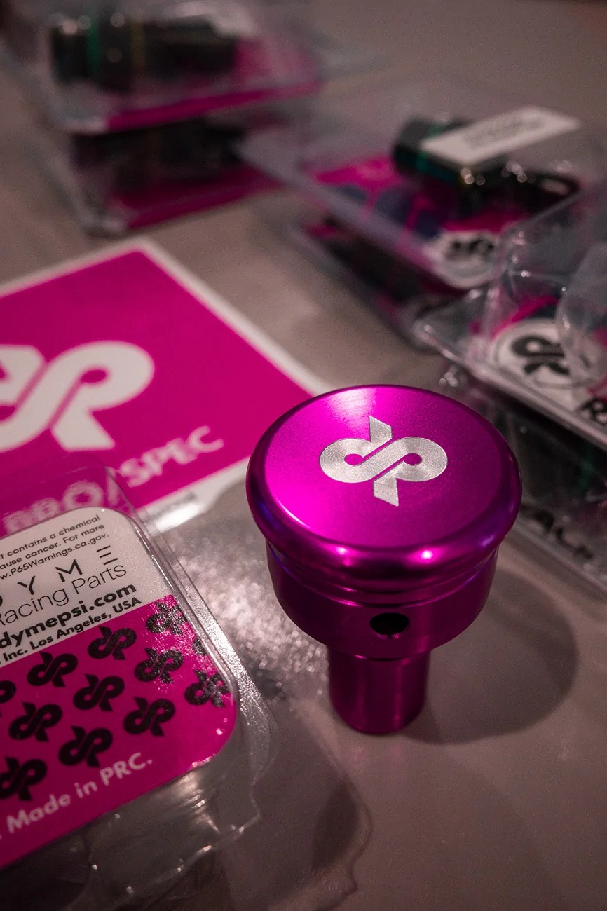

Also get some thread sealant for the 2x Dyme adapters and 2x Greddy straight ORB ends. I use LOCTITE 565. You'll also want some oil to apply on the fittings when threading them together with the hose. Whatever engine oil you have around works. Also get LOCTITE 263 (RED) for the M20x1.5 adapters.

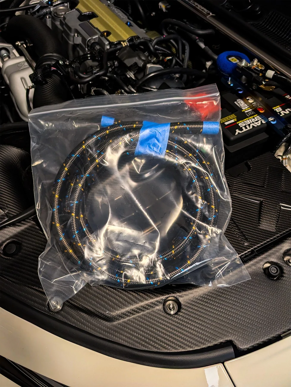

I picked up 12ft of GReddy -10 Nylon Braided Hose(per/ft) - Black / Gold / Blue. Probably don't need this much but I got some extra in case I fuck up. Also after test fitting the oil filter relocation mount I noticed the radiator reservoir tank hose looks like a -10 as well.
But yeah once you look under the car and above you'll get an idea on where the route the lines. Which is the part I'm currently on. Oh, I use an existing mounting point in the bay and just added a spacer (in the photo it's 3/4" tall but I'm going to push out the mount further away from the chassis so I got 1 1/2" and 1 1/4" coming in to test out).

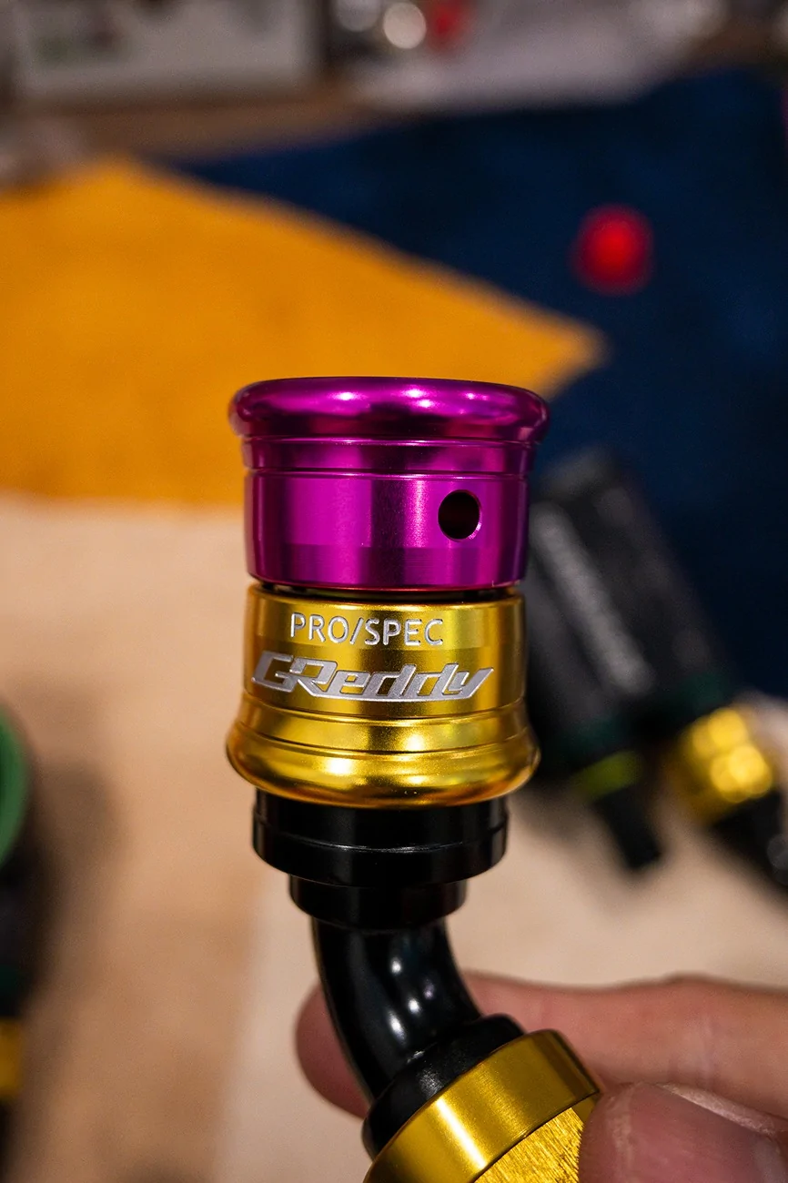

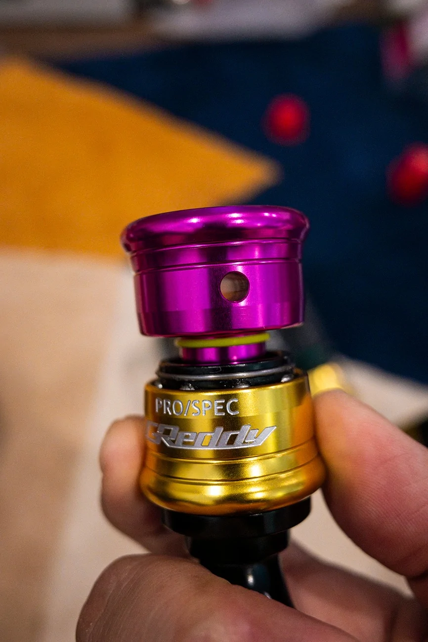

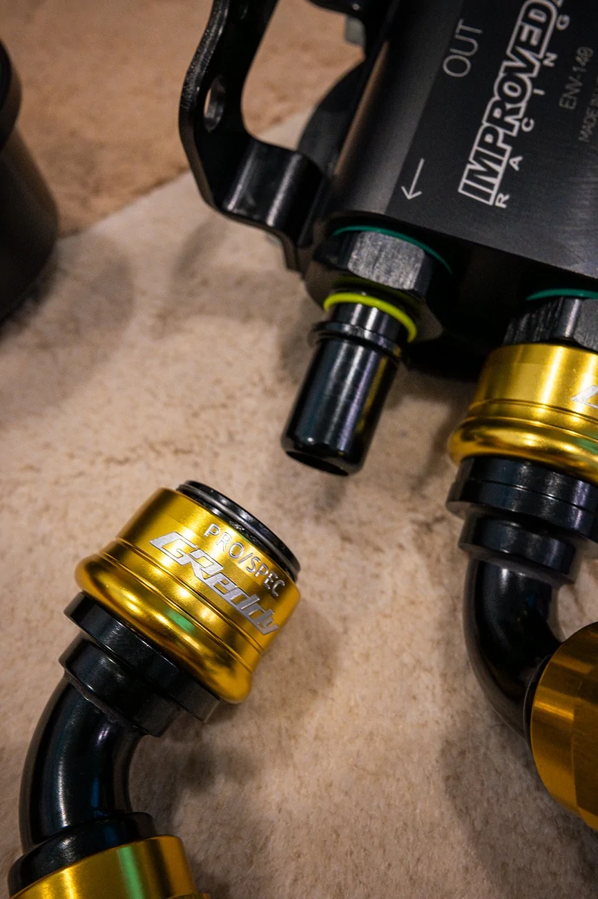

These quick fittings are overkill but they'll help with assembly and disassemble when the time comes to add an oil cooler or if I just want to take a hot oil bath without getting under the car.
11th Gen Honda Civic Kazuo_WFC 2025 Civic Type R build 1782930154000_R0001252
Plug to stop oil from getting everywhere if they're disconnected.

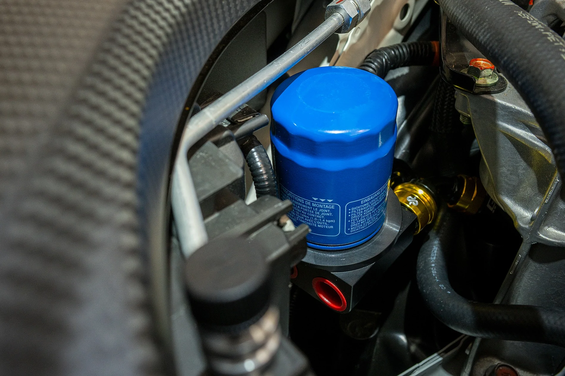

First test fit. I originally wanted to mount it in the space between the motor mount and crash beam mounting point but I didn't want to get a custom bracket made as the Improved Racing 4 port I chose only lets you mount it one way. I think the one with the thermostat gives you 3 mounting choices. Ok I went to go look at the product again and it wouldn't really help if you want to have the filter pointing up; which is one of the main reasons of doing this in the first place.
11th Gen Honda Civic Kazuo_WFC 2025 Civic Type R build 1782950087000_R0001260
Tight so that's why I ordered longer spaces to try out.
11th Gen Honda Civic Kazuo_WFC 2025 Civic Type R build 1782950172000_R0001262
Alright my daughter is asking why I'm taking so long. Peace.

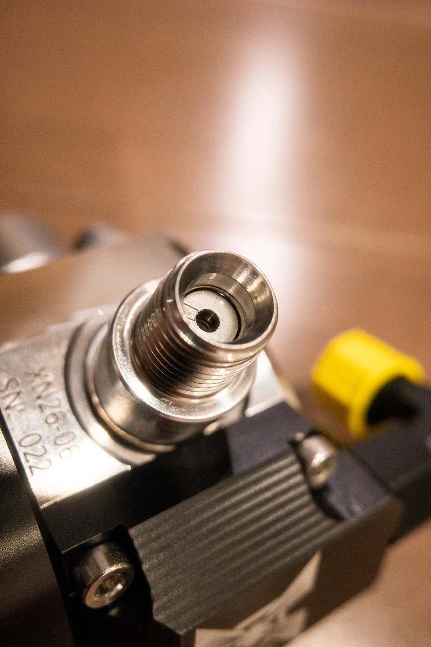

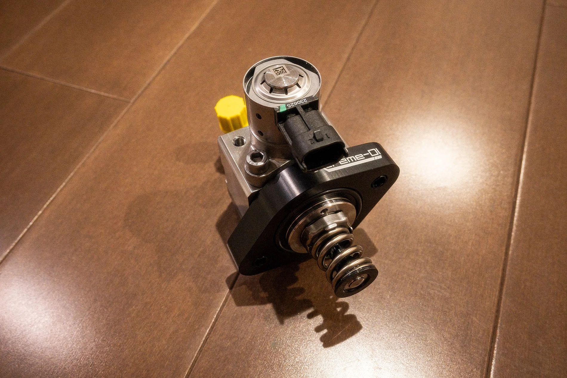

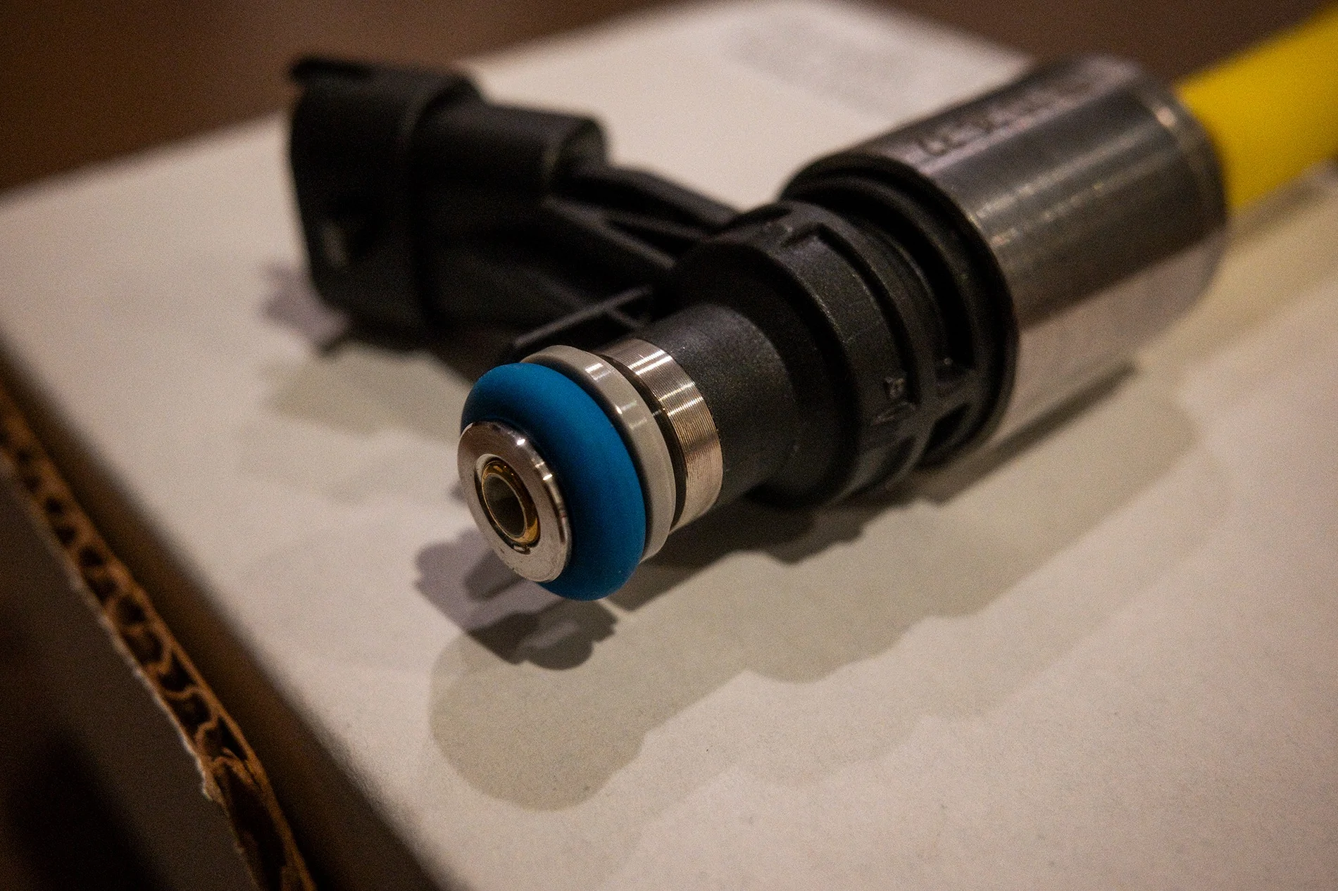

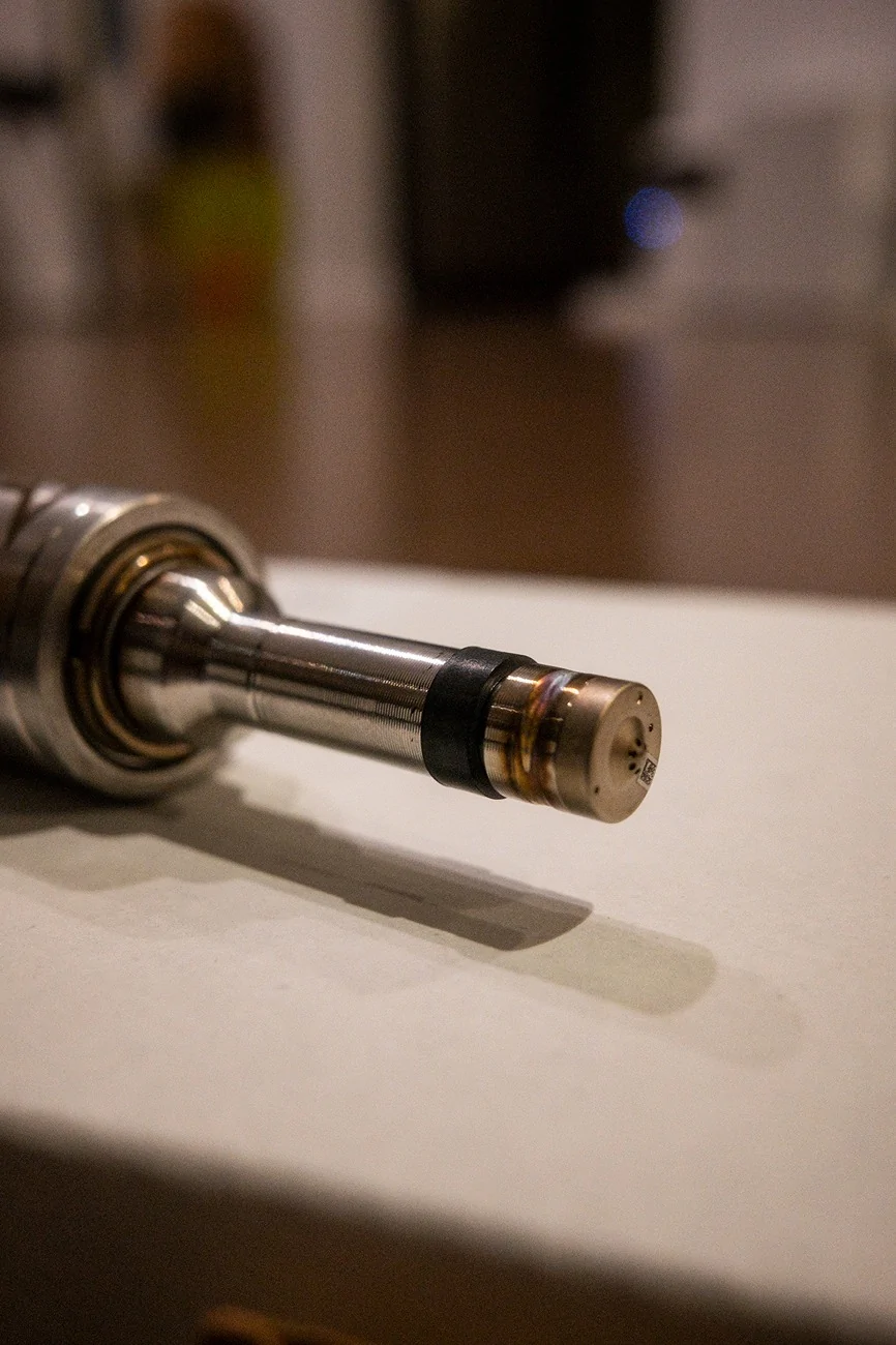

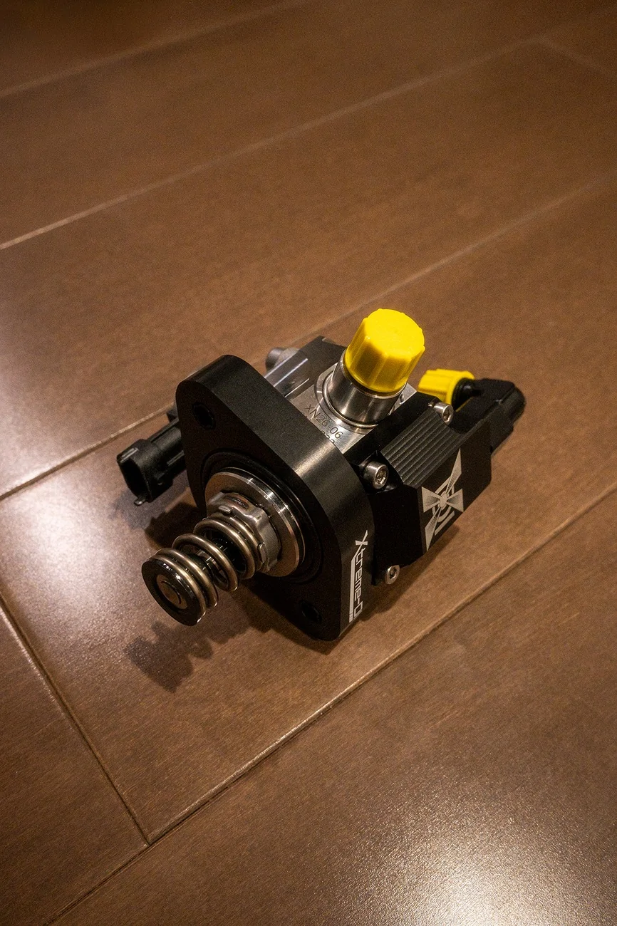

Xtreme-Di Evo + 1400cc injectors has arrived! I'm just looking to make good reliable power for daily and track use....just mid 400s on 91 and I'll be happy. Not sure what kind of torque numbers to expect with this entire setup. Oh still waiting on downpipe as well so that'll be another egg to crack.
Right now my issue is I need a base tune to make sure the pump can run. One of the downsides to using AP over Hondata is that I can't just tick off a box to active the pump and just continue on until I can get it tuned.
Well if anyone wants to see up close what this pump and one of the injectors looks like here's a quick set:
11th Gen Honda Civic Kazuo_WFC 2025 Civic Type R build 1783572786000_R0001295
11th Gen Honda Civic Kazuo_WFC 2025 Civic Type R build 1783572828000_R0001297
11th Gen Honda Civic Kazuo_WFC 2025 Civic Type R build 1783573118000_R0001304
11th Gen Honda Civic Kazuo_WFC 2025 Civic Type R build 1783573287000_R0001311
11th Gen Honda Civic Kazuo_WFC 2025 Civic Type R build 1783572987000_R0001298
11th Gen Honda Civic Kazuo_WFC 2025 Civic Type R build 1783573364000_R0001314
