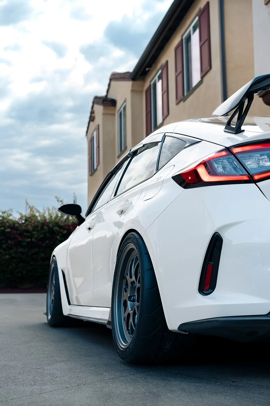

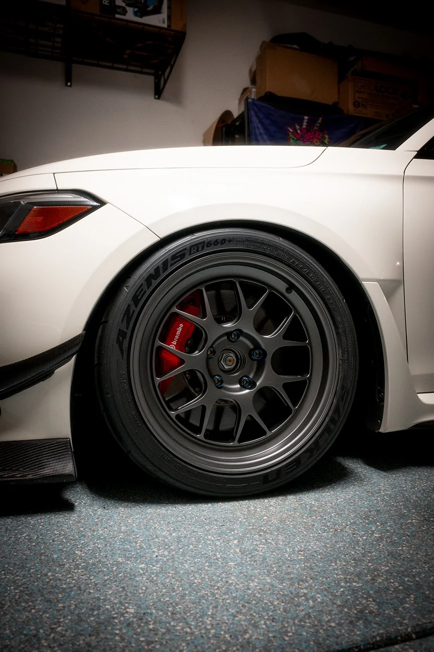

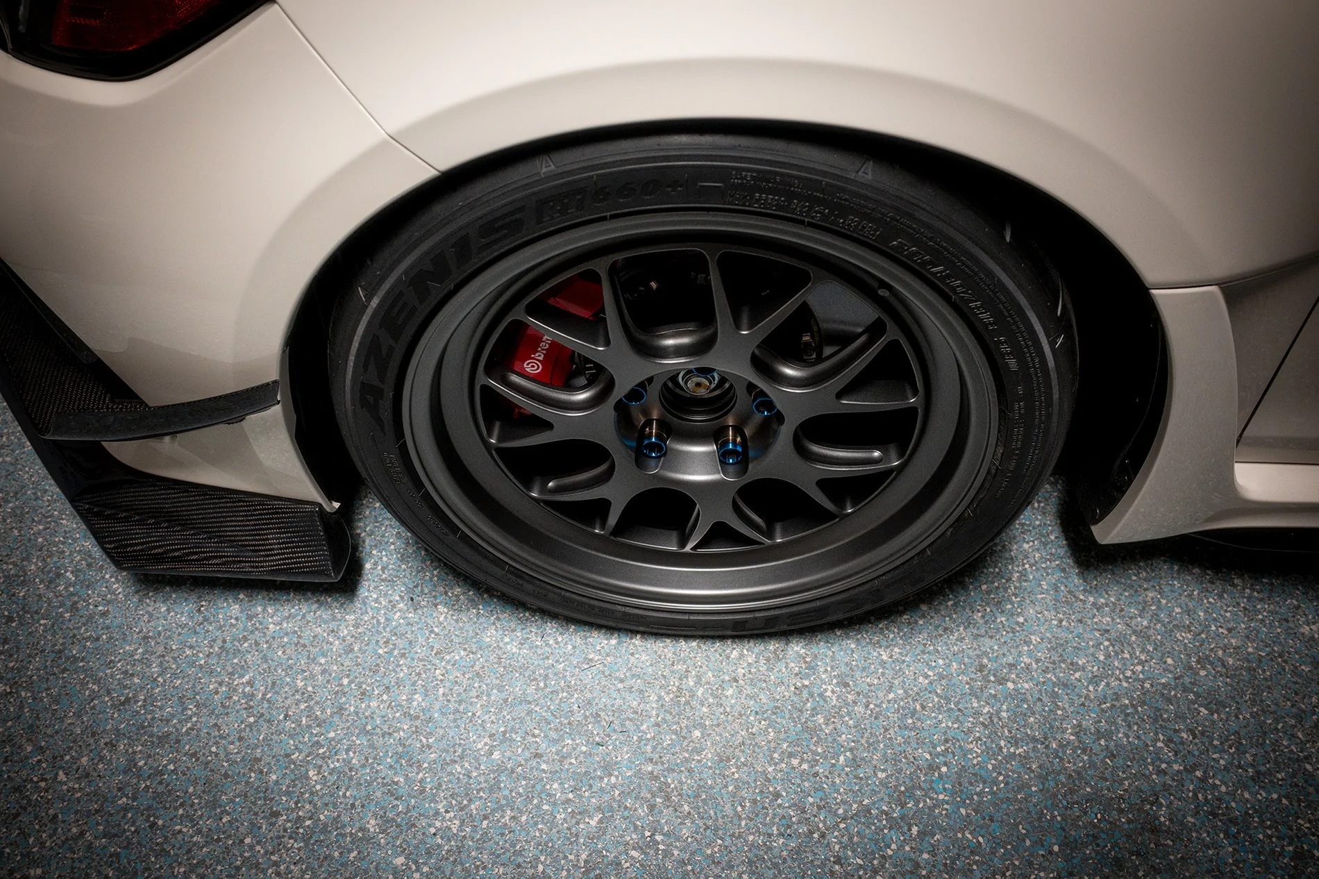

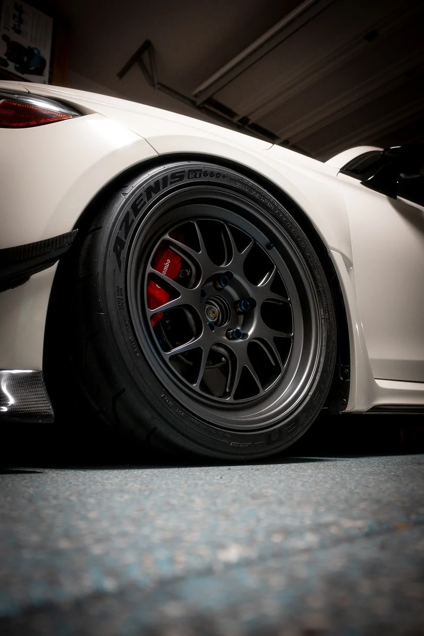

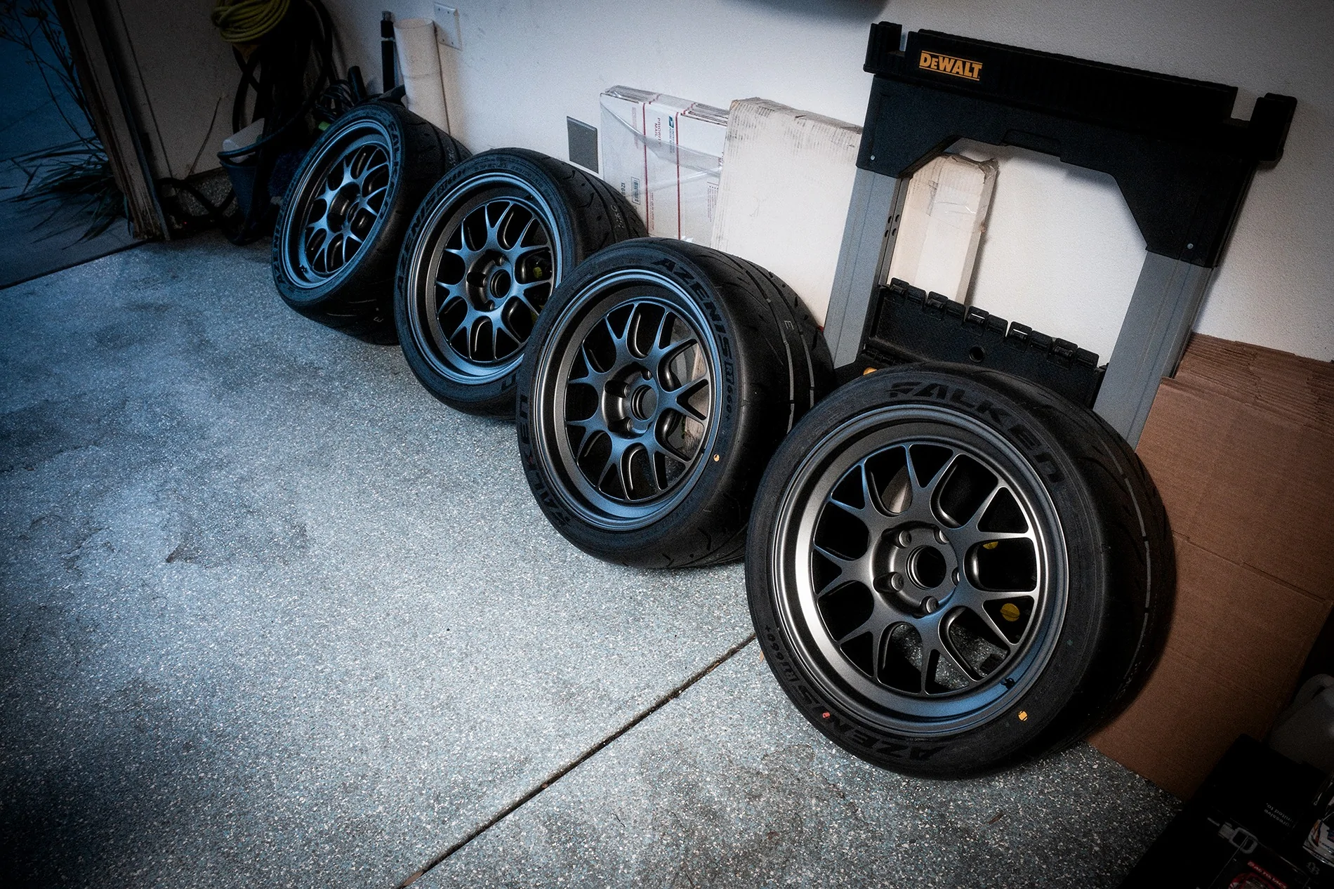

Since I finally sold my stock wheels it was time to mount some 295/30/18 RT660+ on the china forged wheels! I worked with the factory to make a bbs e07 rep but in 5 lug and 1pc forged. I love being a brand whore but when it comes to wheels I like having freedom to do whatever.
After seeing Ed Bolian build a set for his Bugatti and then stress test it...then take it to 200 mph with no issues I knew I had to go through the same factory he did (https://forzaaa.com/) Working with them was super easy as they communicated through facebook so I was able to really refine the design to be exactly what I wanted. If you didn't know bbs e07s are exclusive to centerlocks and are mainly run on Porsches. I wanted to do something fun for the FL5 and also since I don't have my GT3 anymore I figured this was a good copium item. 😵

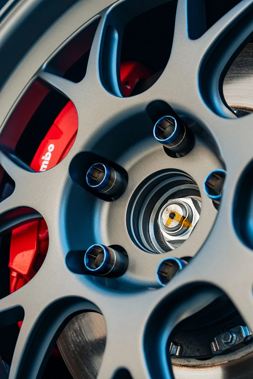

These weigh 23.4 lbs per wheel. Not terrible but not amazing. I blame the design and how much material is needed to make the wheel look good. (IMO) haha. I already got some other stupid ideas I want to try and recreate. For now this setup will be for the street and I'll track on the ze40s. Oh I also installed the Zakgear custom ti lug nuts. Went on smooth as butter and they weigh virtually nothing. Gotta offset the china forged with something ultra premium haha.

Got paint matched forged "H" center caps as well but I like the whole "motorsports" vibe of this wheel so I'll keep the hub exposed. And yeah no rear shots because I couldn't get the damn jam nut loose on the SPC rear camber arms! Guess when I got an alignment last time they really tighten the shit out of them. I was dying and just gave up. Hopefully they can fit me in tomorrow so I can add a bit more neg camber to throw the rears on and complete the look. I dare not show the drift spec setup currently haha.

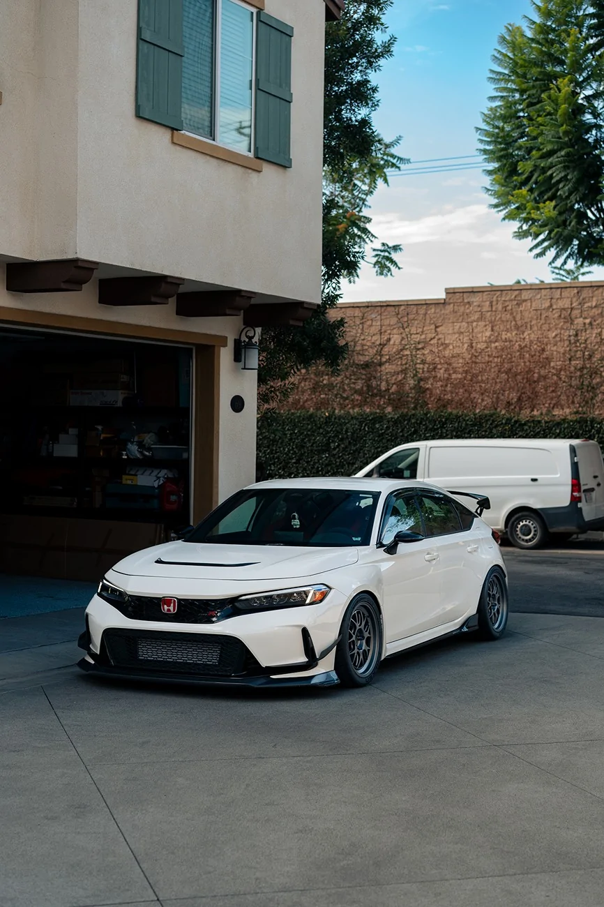

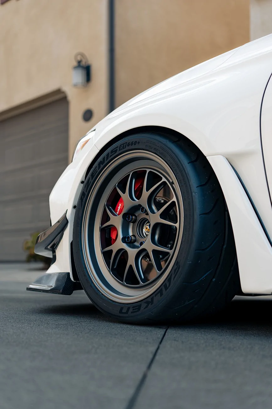

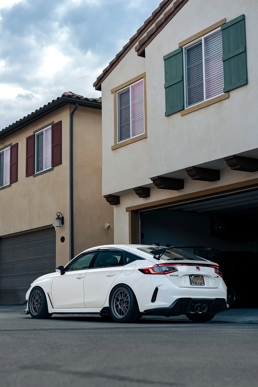

Couldn't get to sleep until 2am cause I had too much caffeine. So no waking up early to go shoot somewhere decent.
11th Gen Honda Civic Kazuo_WFC 2025 Civic Type R build DSC01749
11th Gen Honda Civic Kazuo_WFC 2025 Civic Type R build DSC01736
11th Gen Honda Civic Kazuo_WFC 2025 Civic Type R build DSC01743
11th Gen Honda Civic Kazuo_WFC 2025 Civic Type R build DSC01755
11th Gen Honda Civic Kazuo_WFC 2025 Civic Type R build DSC01758
I'm sitting a few mm lower now cause of the tire profile so that means I have to angle even more to not blow up the Cleib lip. That'll spoon change.... 🤭
Recap on the setup: China 1pc forged "BBL e07" in 18x10 +40 w/ Azenis RT660+. Sitting at -3 all around.

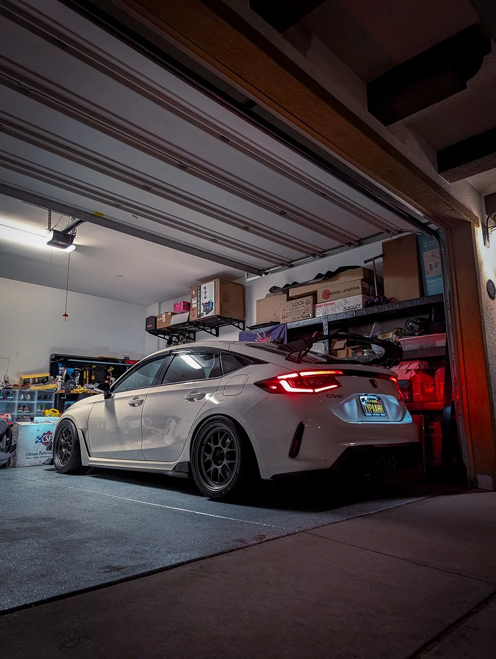

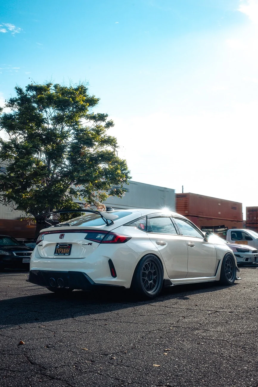

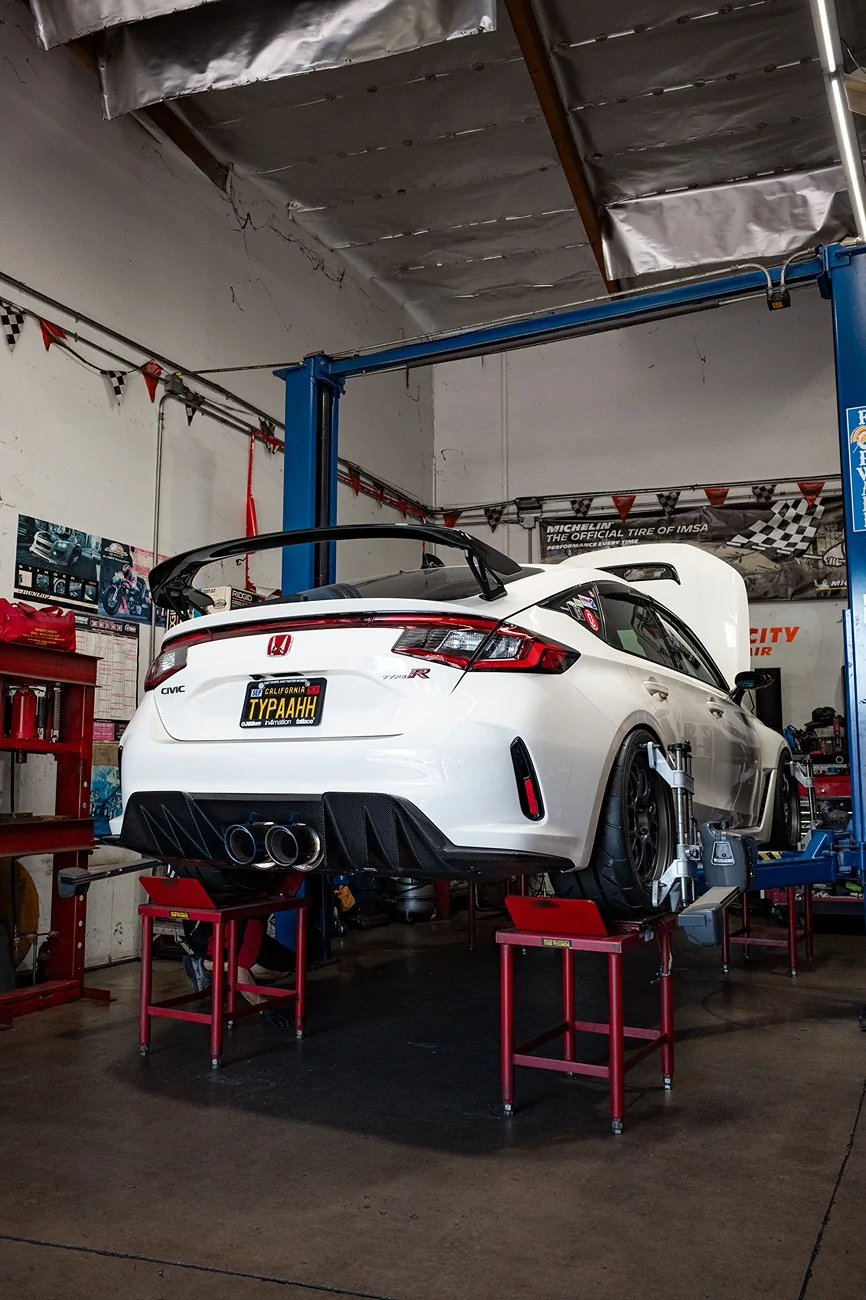

Alignment time. Final numbers are F: -2.9 R: -3.7. Zero toe up front and 2mm toe in total.
I like the stance but I still want to either even out the camber or run less in the rear but I don't have much room to play with....probably could do -3.5 in the rear but it was late in the afternoon and was hot af. This isn't a track setup anyhow so I'm not concerned too much. It's just visuals for me and my ocd wanting it a certain way. One rule I've been trying to stick to is run square setups instead of the usual reverse staggered that I prefer. Guess the idea of rotating tires to add value is me coping for all the money I dumped into this thing in 8 months.

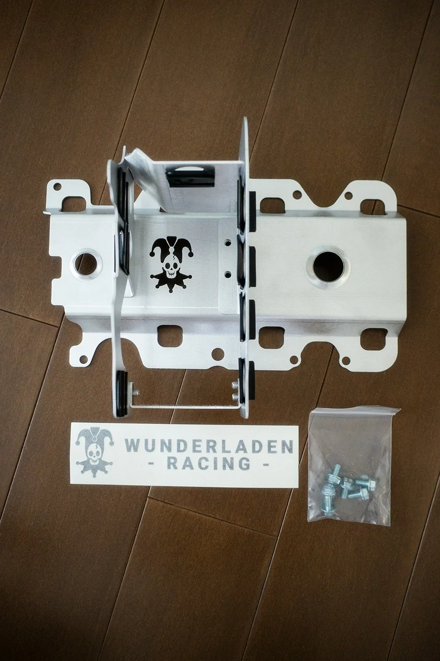

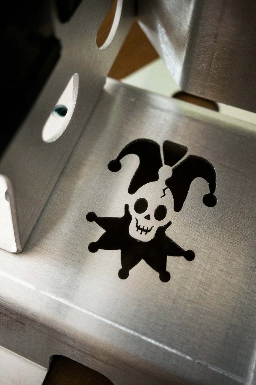

Wunderladen oil pan baffle for that extra insurance when the G-forces hit. Especially since I'll be running the oil filter relocation kit I'm working on and eventually add on an oil cooler. Between this, 4p and the Unit2Fab one I decided on this because of the data they published on it and they seem to really put their products through a long testing phase. Also knowing their dope logo will be forever hiding in the pan is metal af.
I'm still waiting on them to drop the pre-orders for the PMM and clutch dampener delete. 😫

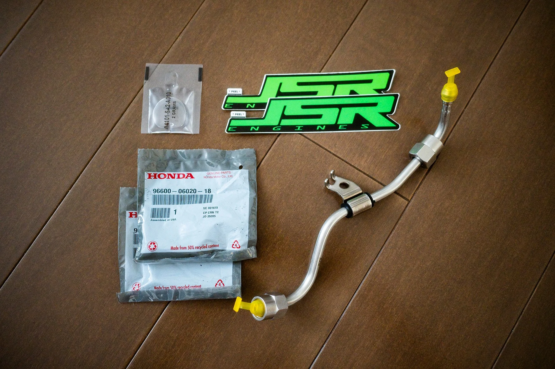

Got the base map from @JST Performance for the XDI Evo pump and 1400cc injectors. This was a last minute purchase to just complete the fuel system. JSR V4 New OEM FL5 High Pressure Fuel Line. They claim 8.5% increase in fuel flow on the stock system. Thirst trap K20C1.
