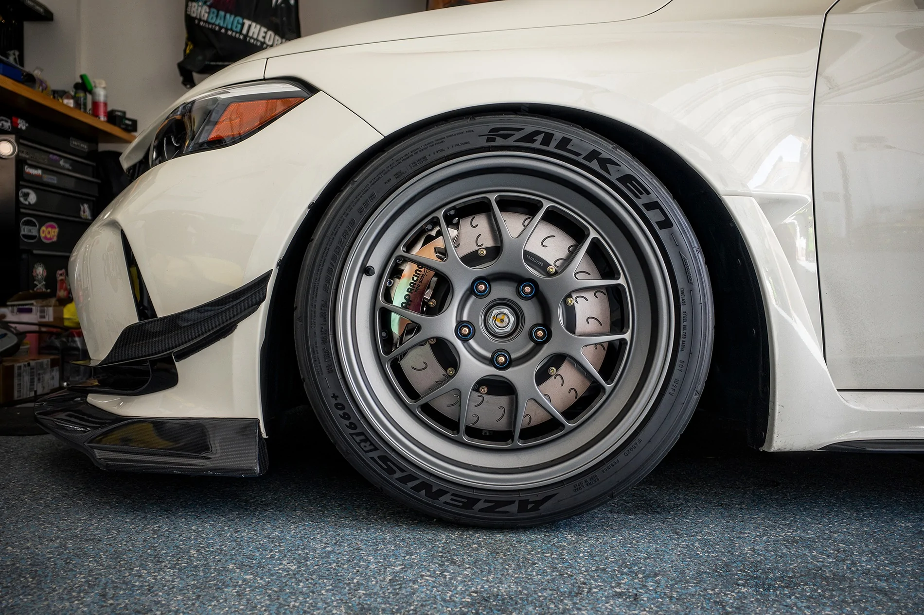

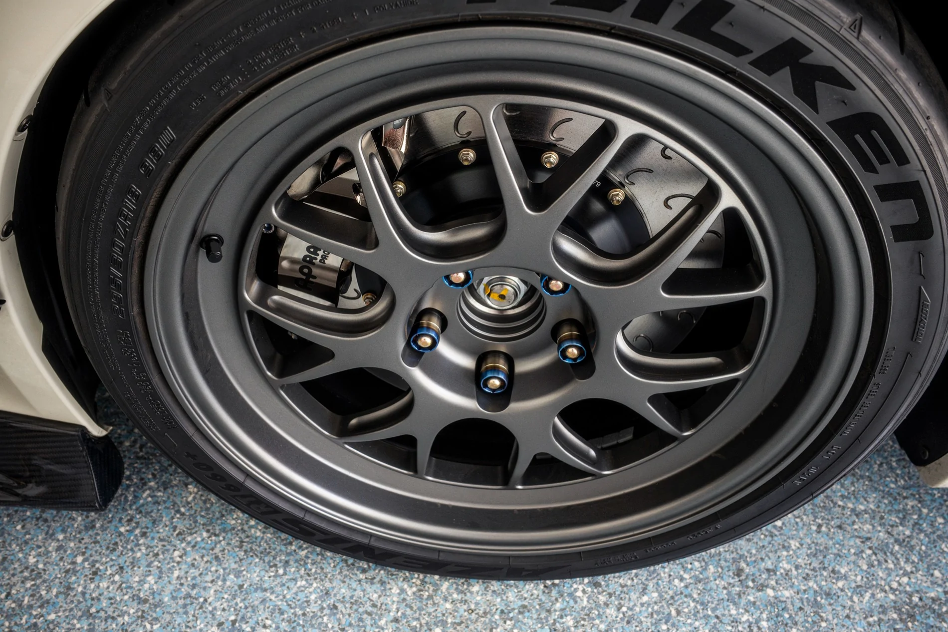

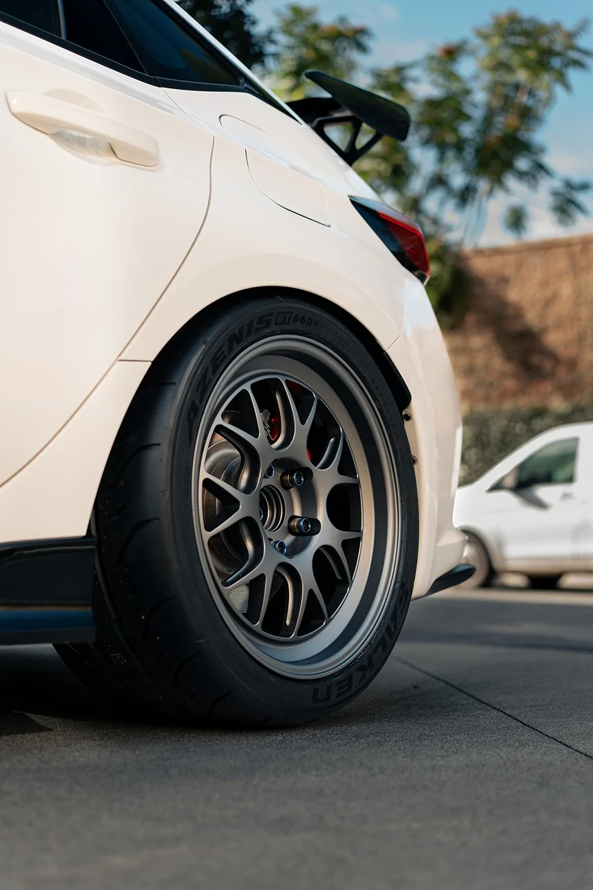

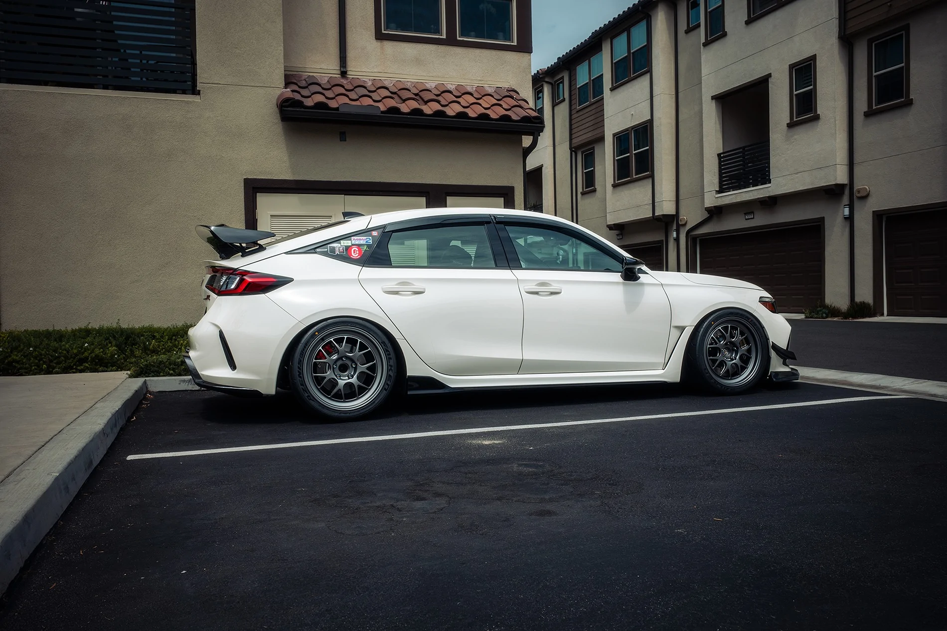

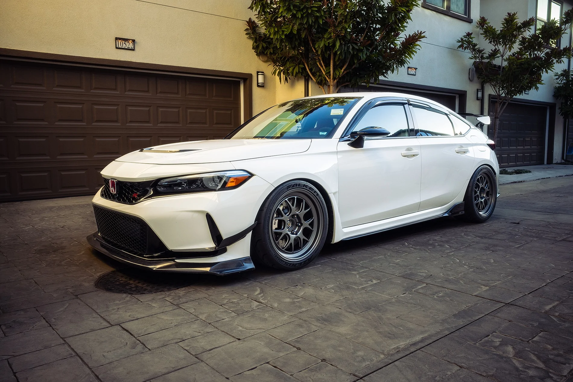

Few more edits I wanted to share. Car feels great with the 295/30s. I'm locked in with this spacing on fitment. I feel comfortable playing around with the offset range and tire sizing to keep camber around here for now.
When I do another set of wheels it'll really depend if I can get more lip and/or a more concave face, which is what usually pushes me to ruin the car even further. Haha. I won't give away what's rolling around in my head but if I can fit 315/30/18 on an 18x11 +37 with -5.6~ on my FK8......🤔

Man I love the current stance. Really want to throw 295s on the ze40s now. I feel like that'll trump this current setup for me.

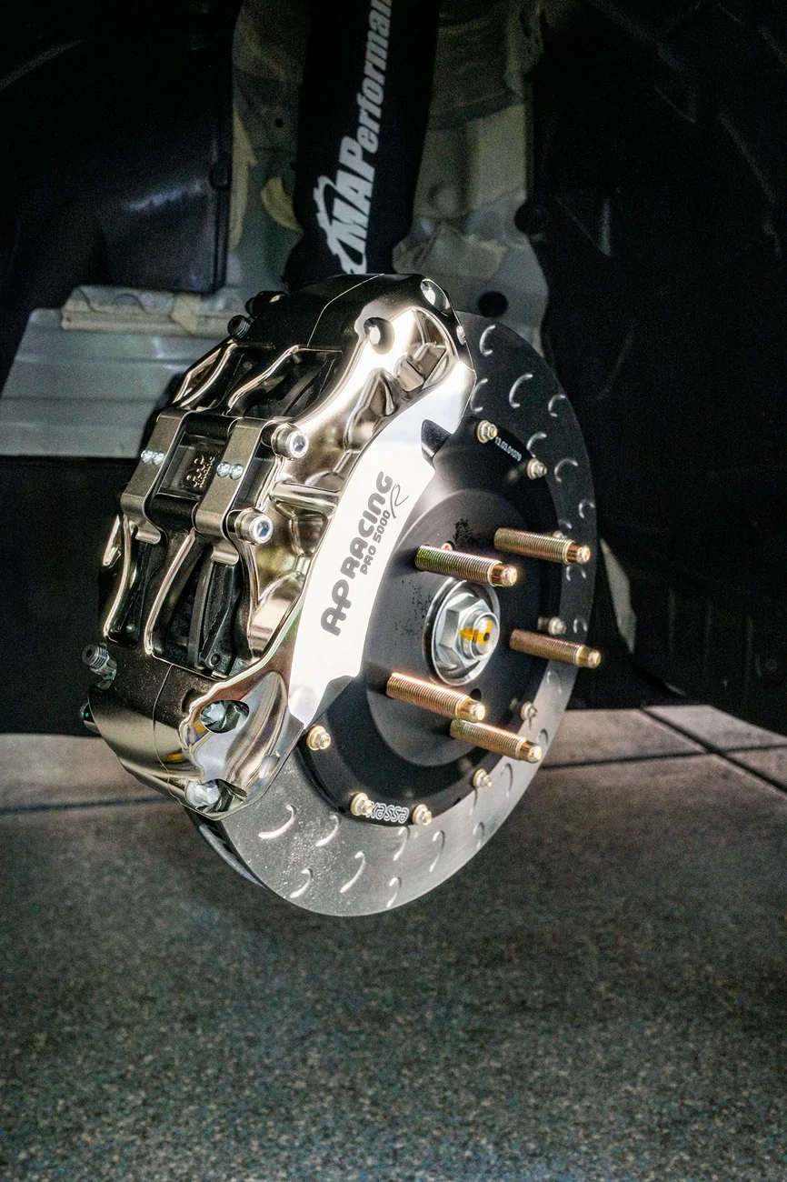

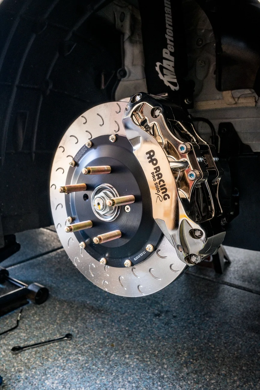

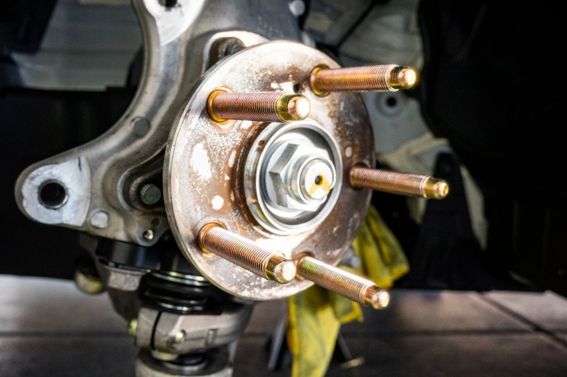

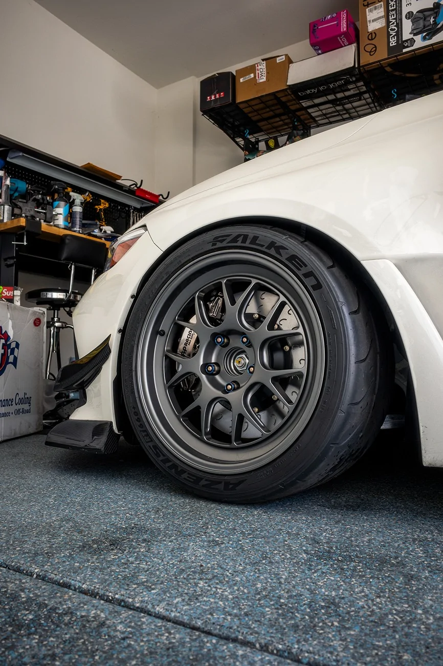

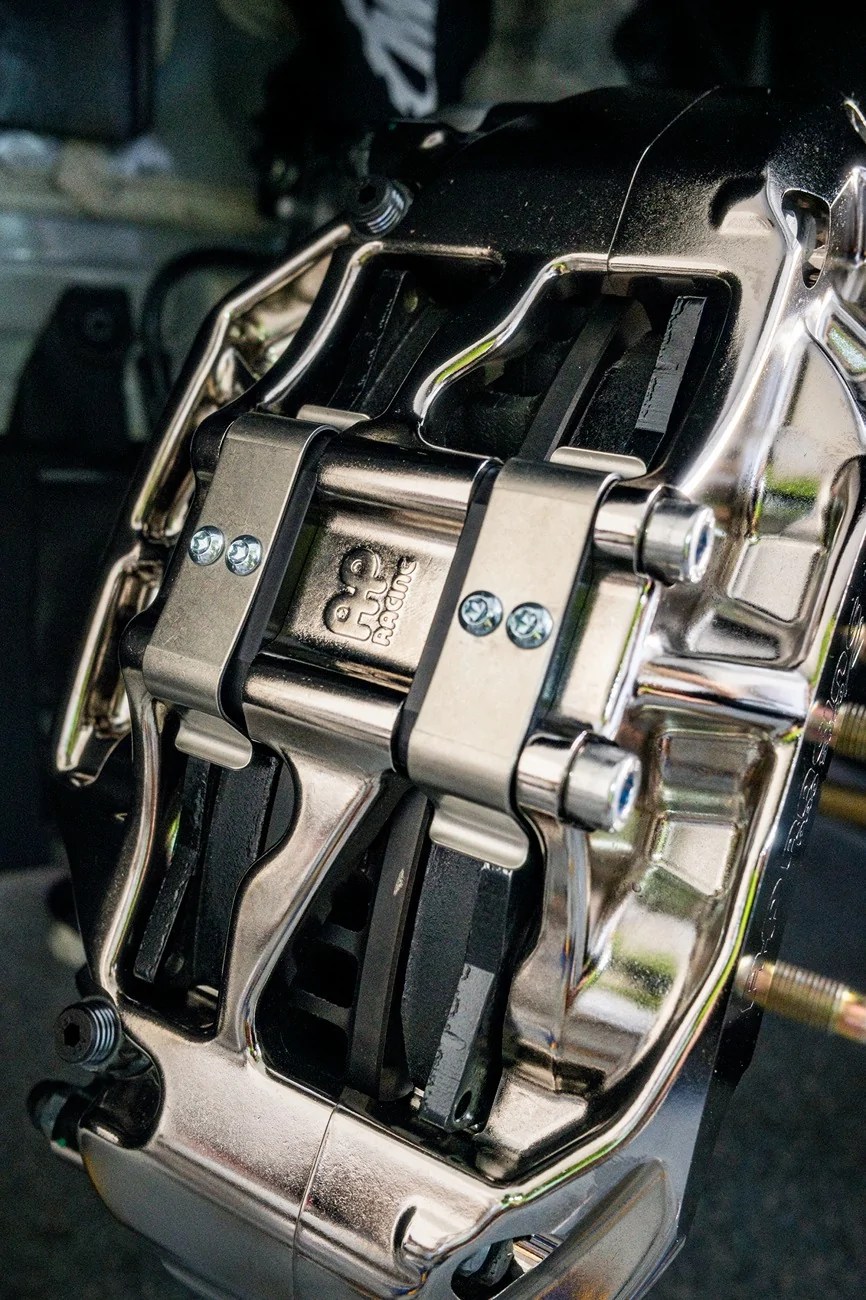

Installed extended studs and the AP Racing kit today.....
11th Gen Honda Civic Kazuo_WFC 2025 Civic Type R build 1784846038000_R0001413

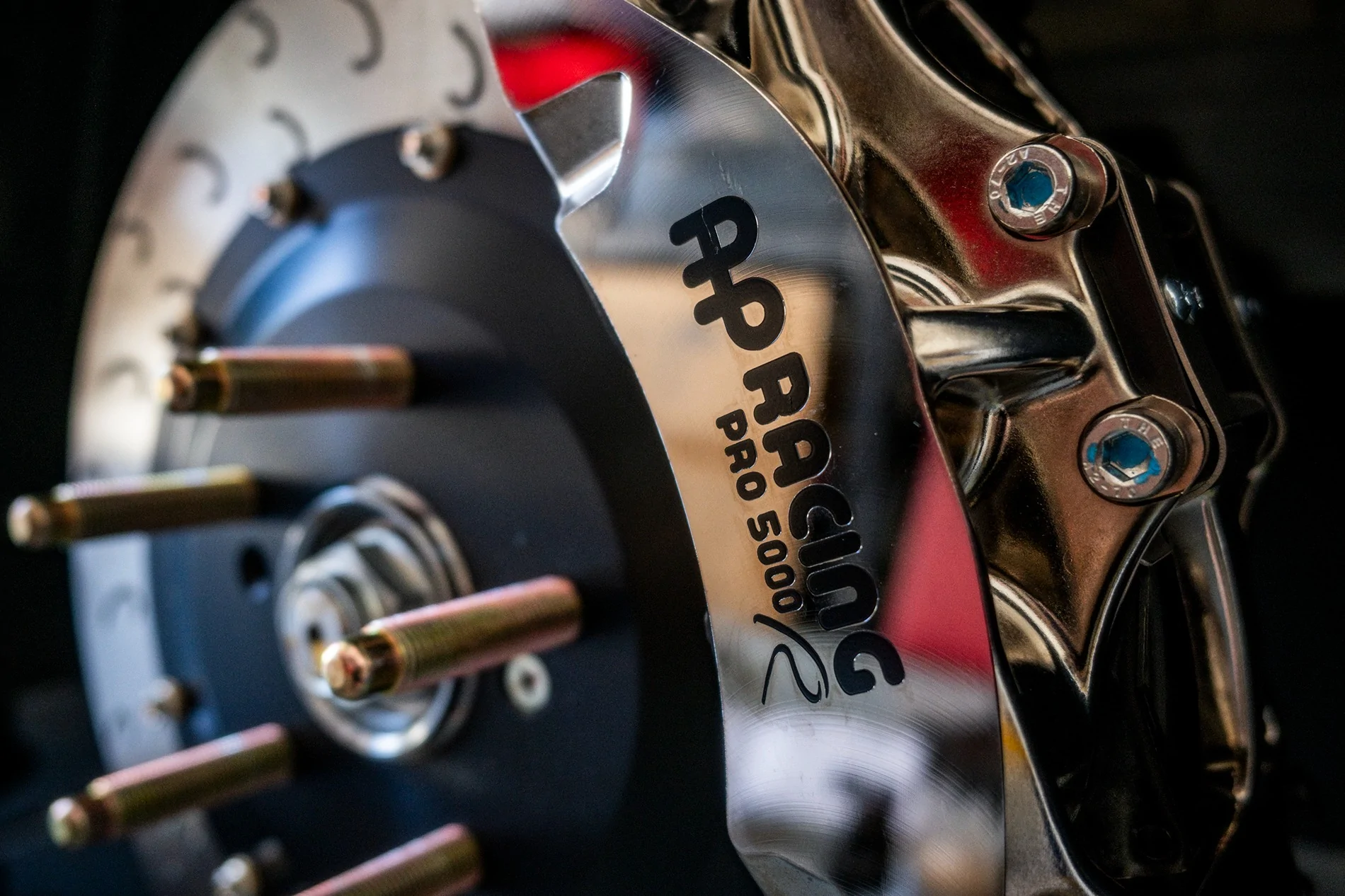

1320 Performance extended studs. ARPs were still out of stock everywhere when I was looking a few months back but yeah. I found these as they had good reviews from people running into the same supply issues since covid.
11th Gen Honda Civic Kazuo_WFC 2025 Civic Type R build 1784825741000_R0001396
AP Racing CP9660/355mm BBK. Electroless nickel plating is looking sharp af. Pads....Hawk ceramics bwahaha. Super easy to swap pads so the trade off on performance to less cleaning is high value.
11th Gen Honda Civic Kazuo_WFC 2025 Civic Type R build 1784830820000_R0001399
Pad tension kit to reduce rattling
11th Gen Honda Civic Kazuo_WFC 2025 Civic Type R build 1784830838000_R0001400
11th Gen Honda Civic Kazuo_WFC 2025 Civic Type R build 1784836735000_R0001402
11th Gen Honda Civic Kazuo_WFC 2025 Civic Type R build 1784836751000_R0001403
11th Gen Honda Civic Kazuo_WFC 2025 Civic Type R build 1784846132000_R0001423
Reason for going with the 355mm vs 372mm.....all in the name of fitment. I only intend to run 18s for the life of the car so gotta make sure I give myself the most range of wheel types to fit with the bbk. Man....I'm seriously building this car like my gt3. I think I'm trying to make up for the lose haha. Shit is stupid but necessary. I need therapy.
11th Gen Honda Civic Kazuo_WFC 2025 Civic Type R build 1784846110000_R0001420
Install was smooth. I made sure to start early in the morning before the heat set in. By the time I was done the garage was roasting me alive...was like 99 ranch degrees fahrenheit. 🤪 Bled the brakes with a pump kit. Oh the cap that goes on the reservoir was stuck on super tight to where I had to bust out my big clamp to twist it off.
Oh I didn't do the studs on the rear because I cross threaded one of them. Ordered a single one for $17 shipped. 🙃

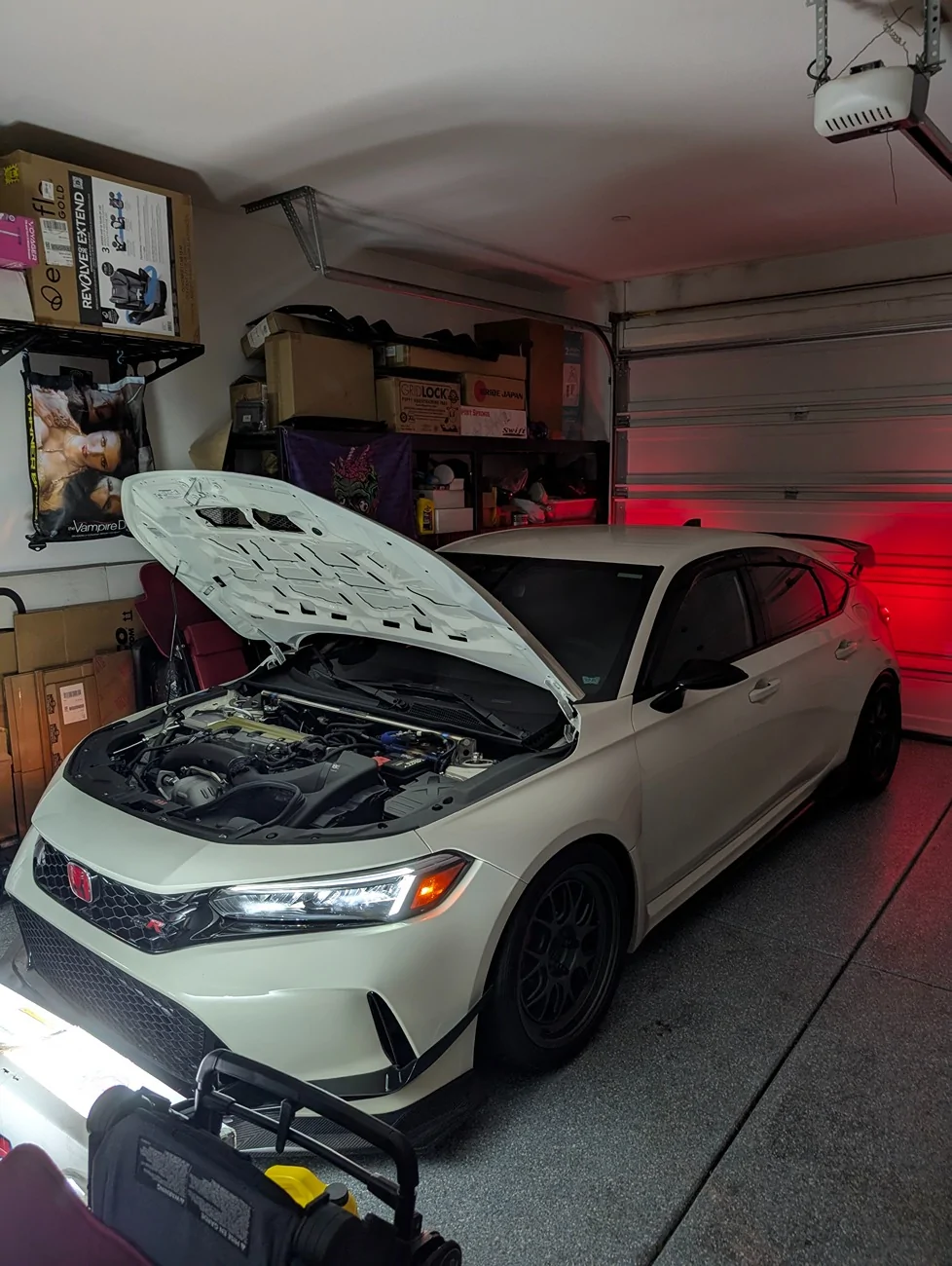

Here's some in the wild photos of the car just doing nothing. Had a lunch, pool and dinner day with friend's and our kids. Honda knew their target audience when it came to making the new Type R a 4dr hatchback.
11th Gen Honda Civic Kazuo_WFC 2025 Civic Type R build 1785118643000_R0001437
I really need to design and cut a front windshield banner already. Don't have a solid direction on what to make honestly. I have rolls of colors picked out already just need to turn on the lights in the graphic department of my head.
Oh really good news....no more P0011 and P0014 on the latest @JST Performance tune. I'm going to drive it a bit more and push the car around to see if anything goes off but so far I've put about 50~ miles with city/hwy driving and all has been good. Most likely ready to finally install the fuel upgrades and couple of other things.
PS @COBB Tuning Any word on figuring out what's up with my tune? I'm ready to install the fuel upgrades and a downpipe is coming in a few weeks as well....I'll be finished with the motor and then throw it on an actual dyno to see what @JST Performance can really squeeze out of all the mods.
Dassa nice wide load, she rub under max compression? Curious to see if you're going 315 on the x11 and how the badges will look /popcorn ready
Very minor rubbing on the front where the bumper and fender meet up. I'm waiting on caster adjustment hardware to come back in stock so I can pull it back a bit but I need to see how it'll affect handling. Rears touch the felt fabric.
