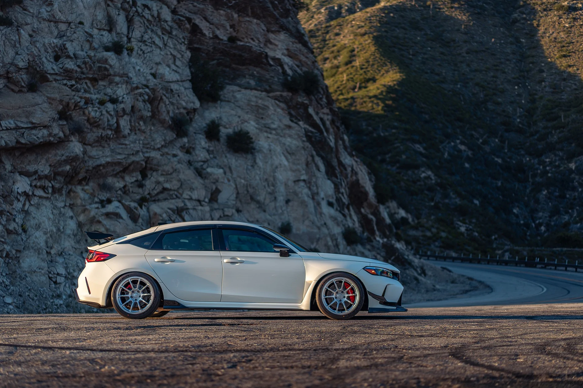

Went up to ACH with a friend to take some photos near/at sunset yesterday. I got some crispy edits lined up to share of the next week. Enjoy the clean vibes. :cool: PS still need to install the front Cusco brace under the Mugen damper. I promise I'll get to it this week haha. I held off because of this drive on ACH as I did some spirited driving testing out the refreshed driving modes with the SDI module.
I'm still collecting my thoughts on how it felt as I've never driven on an active dampening system before. I really want to take this thing out to Streets of Willow or Chuckwalla now. 6 months of ownership and I'm folding like a shitty canard blowing in the wind.

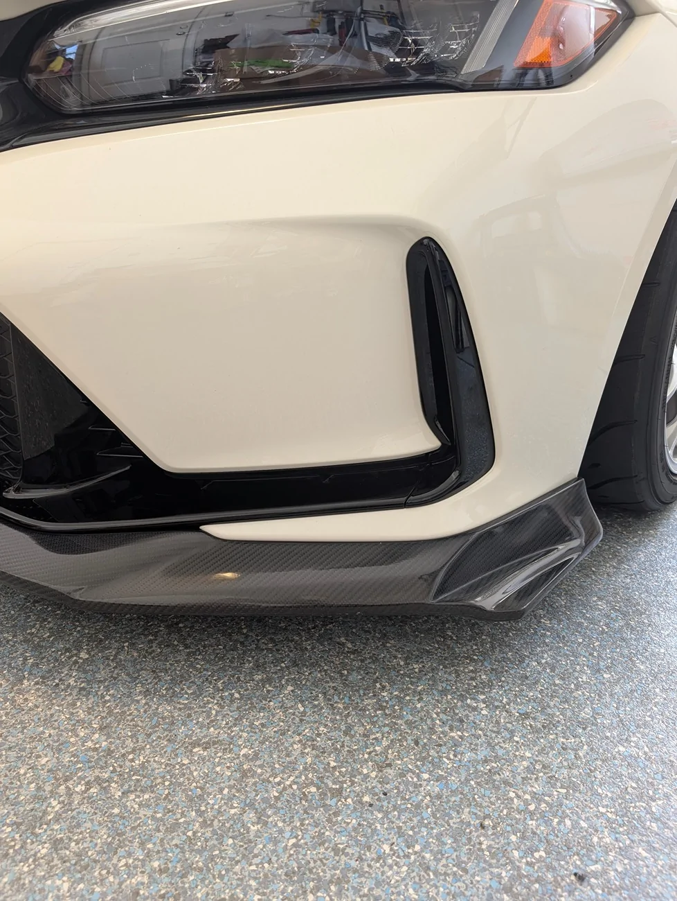

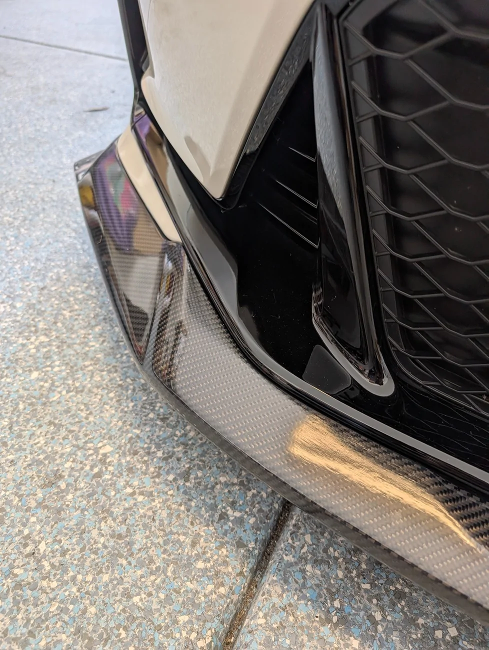

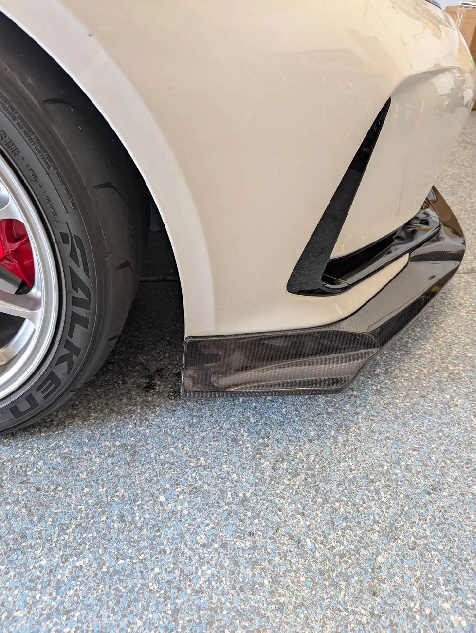

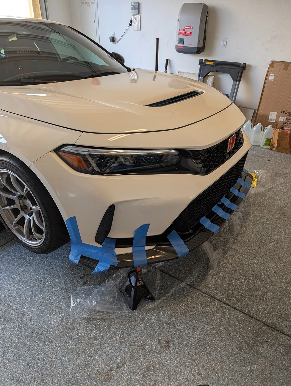

Nice build! Does the CLEiB lip use factory push clips/mount locations or do you have to drill into the bottom of the bumper cover? Any install info/pictures would be awesome.

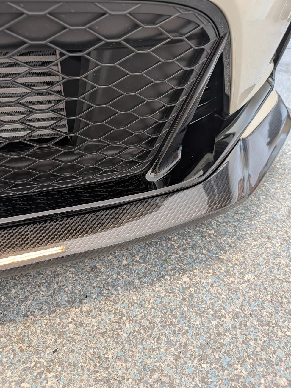

It has you drill and install rivnuts into the bumper. Terrible idea since the bumper is pliable and squeezing a rivnut just causes the material to squish and possibly making the rivnut just fall out haha.
I can see why they opted to do it this way since you don't have to remove the bumper but if I had to do it all over again I'd rivnut the lip instead.... what's stupid of me is that I did that before on my m3 and was so proud of myself for thinking to use rivnuts instead of the self tapping screws it came with. 😂😅
Sorry small rant there. But yeah quality of the actual lip is great. Fitment is pretty much perfect. They make a track version that goes further under the bumper for better aero but at that point for cost I'd rather do a Spoon bumper.

If I scrape the lip it's always at the ends since they hang so low. But I just love how aggressive it is for a daily haha.
