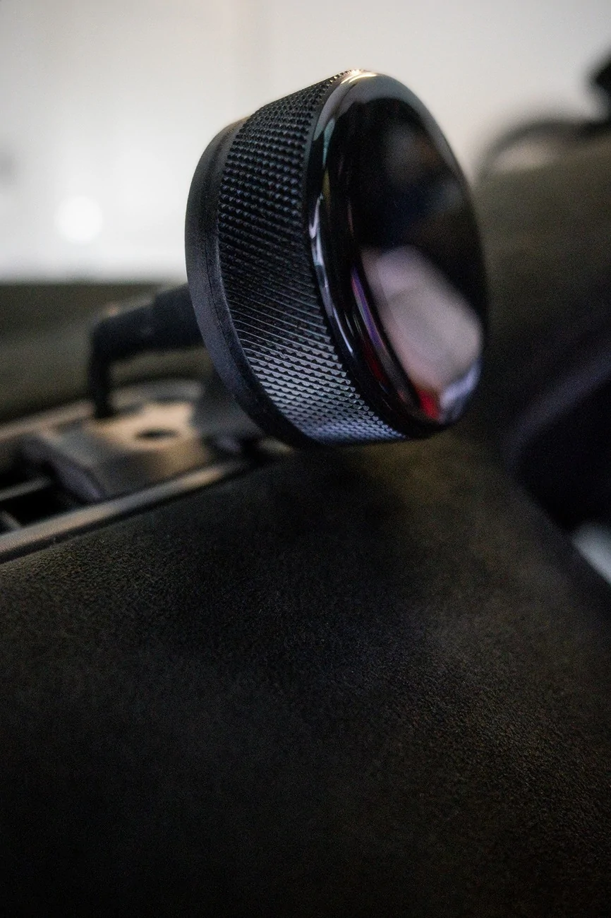

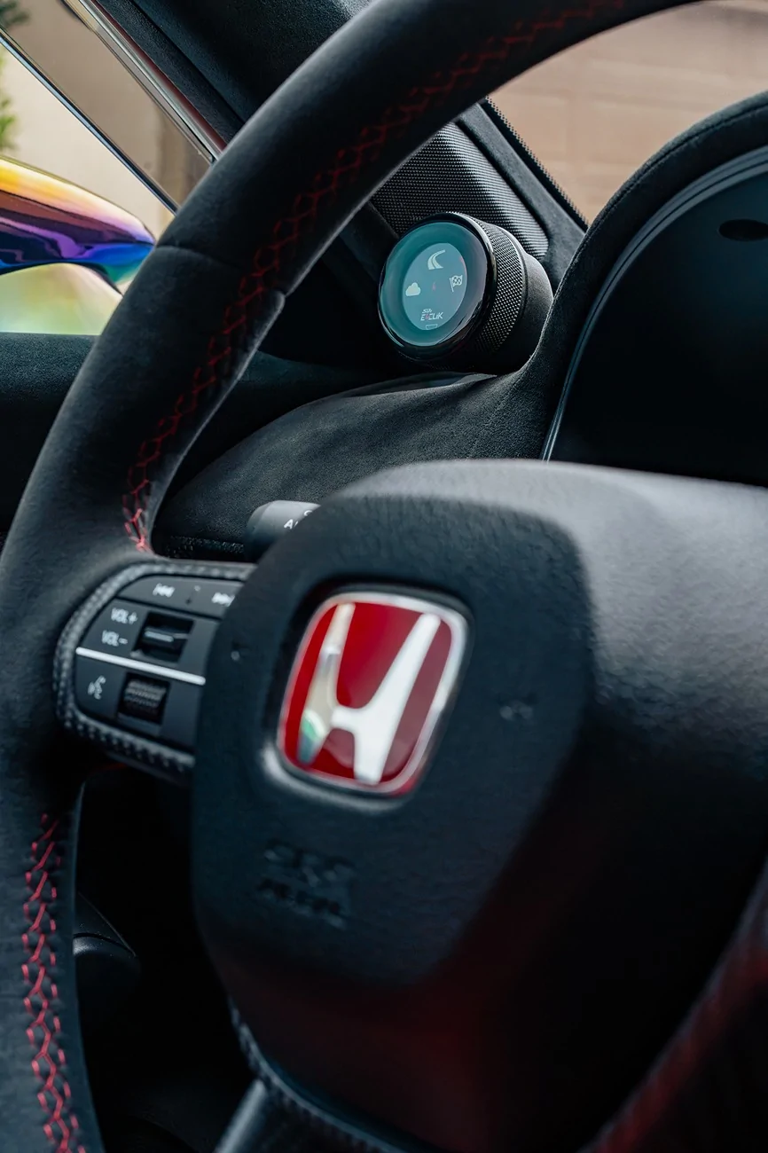

That shift knob is beautiful. Does it get really hot like the OEM one on a hot day? Also which adapter for the threading did you get? I have no idea what thread size we need.. Also which finish is that?
Nah doesn't get hot for me but I have ceramic tint all around and use a sun shade if the car is going to be outside for awhile. Hondas are 10x1.5mm. The finish is anodized black.

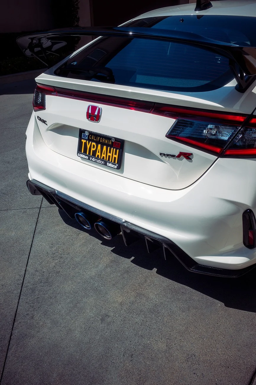

Looking at your license plate, I’m wondering if you grew up in Boston?🤣
Hahaha I can totally hear it now but I actually made it based on an Asian accent as I'm Japanese/Korean haha.

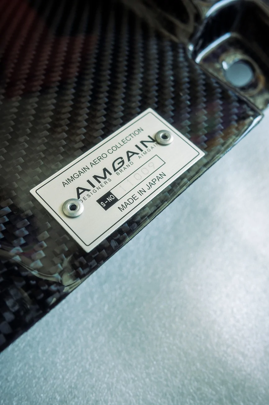

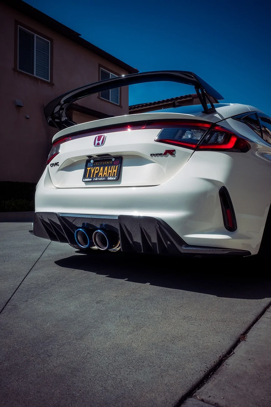

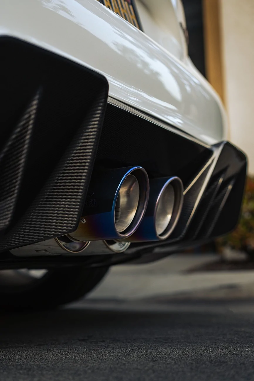

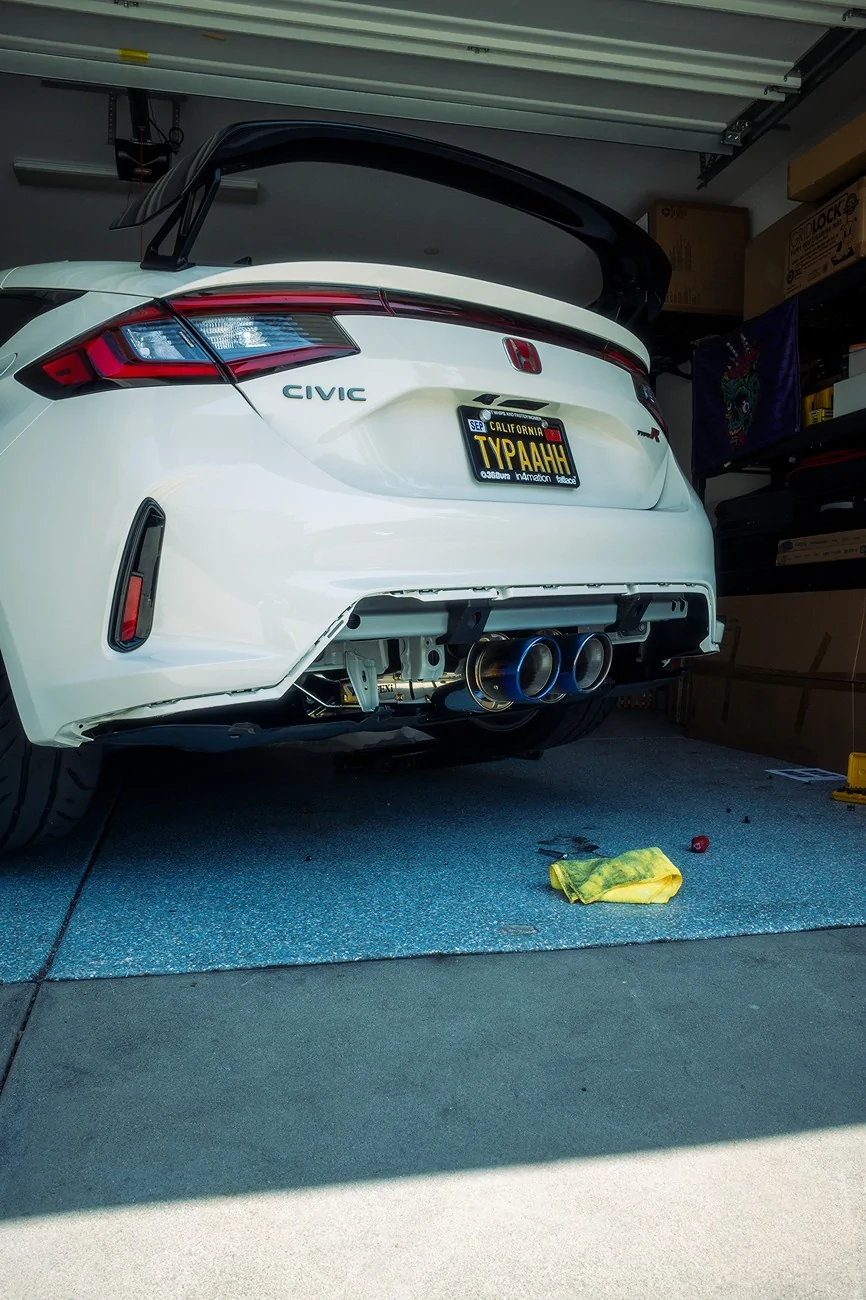

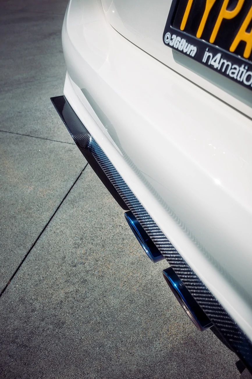

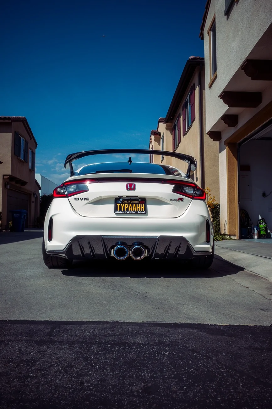

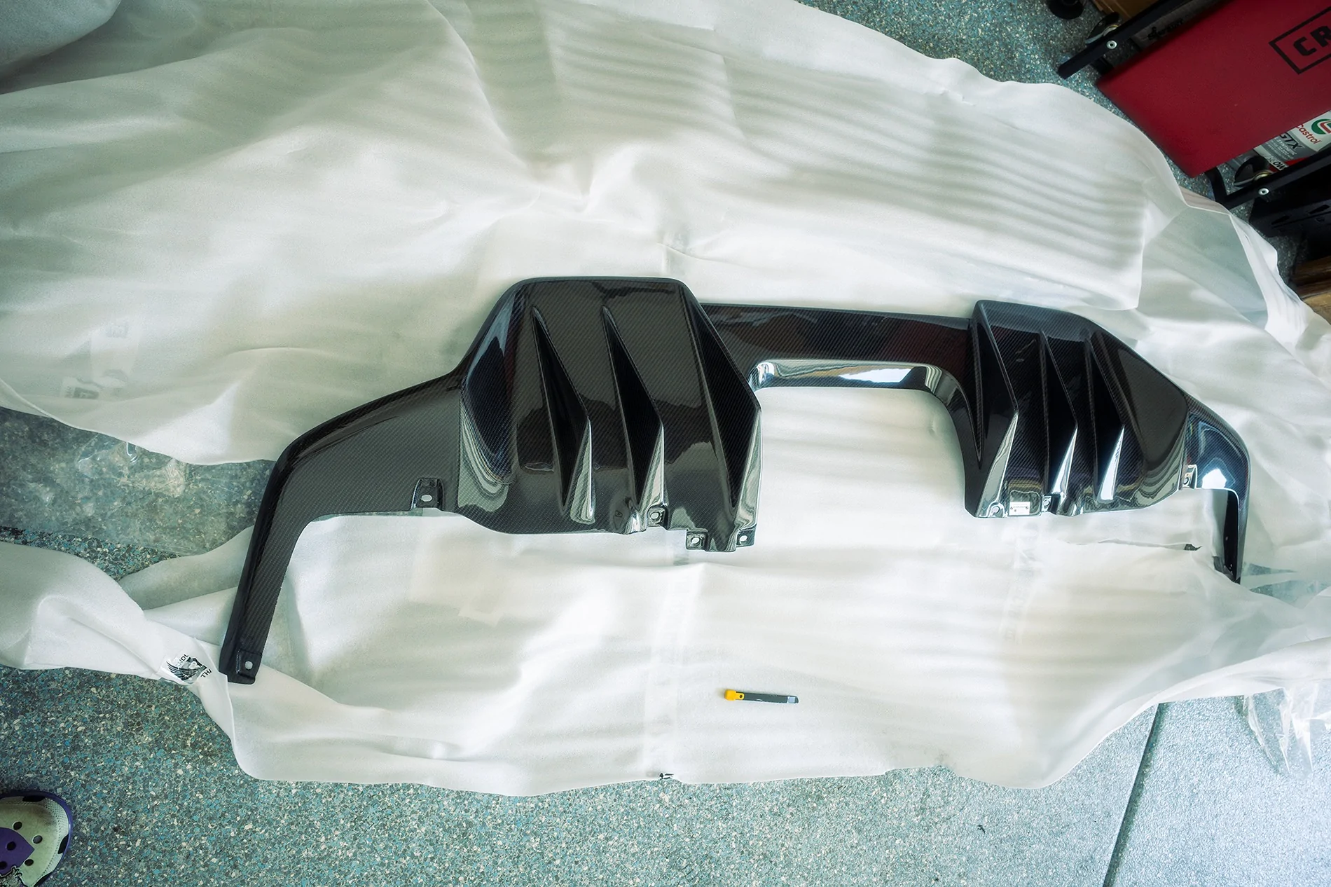

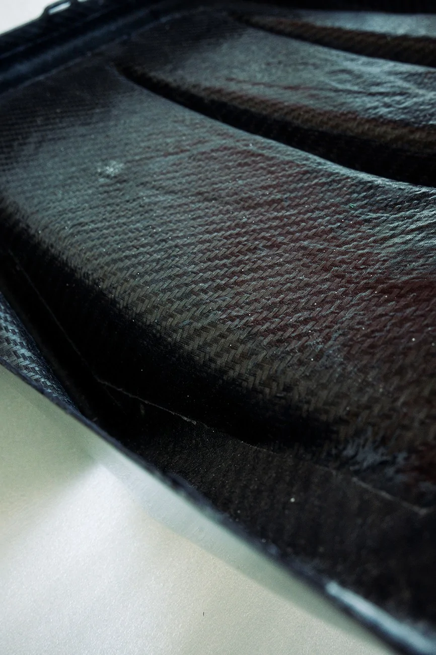

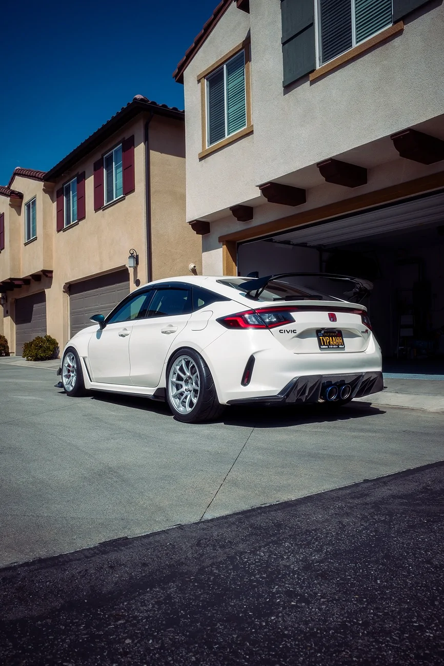

4 months later and the Aimgain rear diffuser in cf arrived from Mastermind NA! Excellent quality and 99% spot on fitment (one clip hole was a tad off but nothing a little elbow grease wouldn't fix). You reuse all the oem hardware and the instructions tell you take off the whole bumper but I thought I'd try not to....and as you can see I failed that exercise.
11th Gen Honda Civic Kazuo_WFC 2025 Civic Type R build 1777666535000_R0000751
Pure carbon fiber...the good staffu.

I think it mixes well with the CLEiB lip and EVS canards. It's subtlety aggressive. Now I need to readjust how far I have to move the car in to close the garage as it now sticks out like 2" more haha.

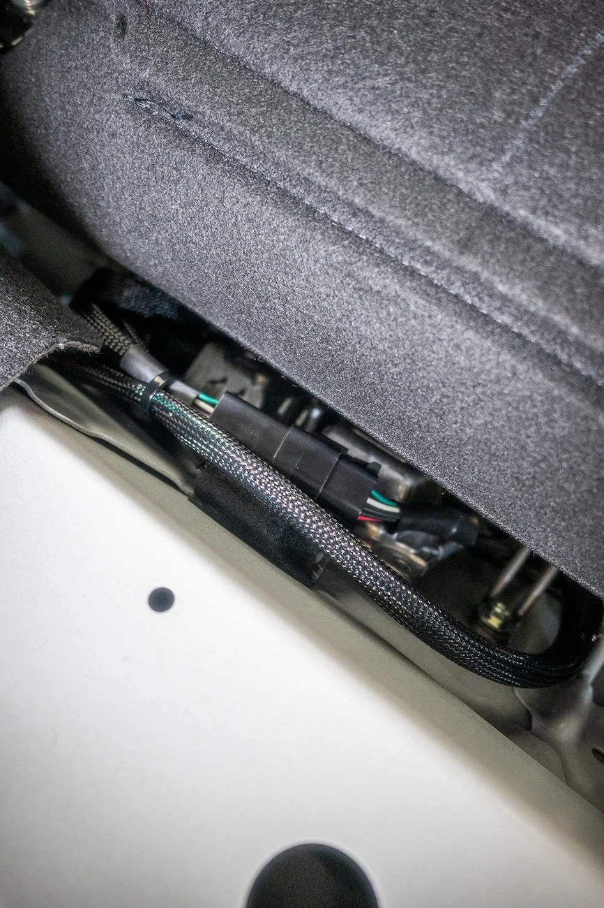

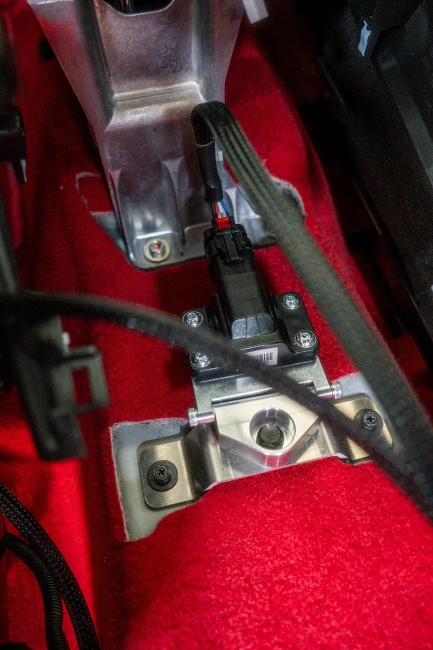

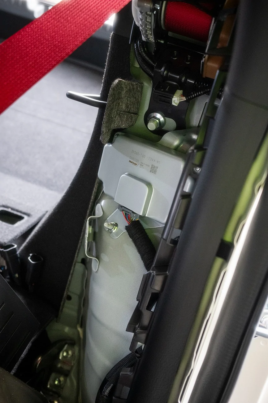

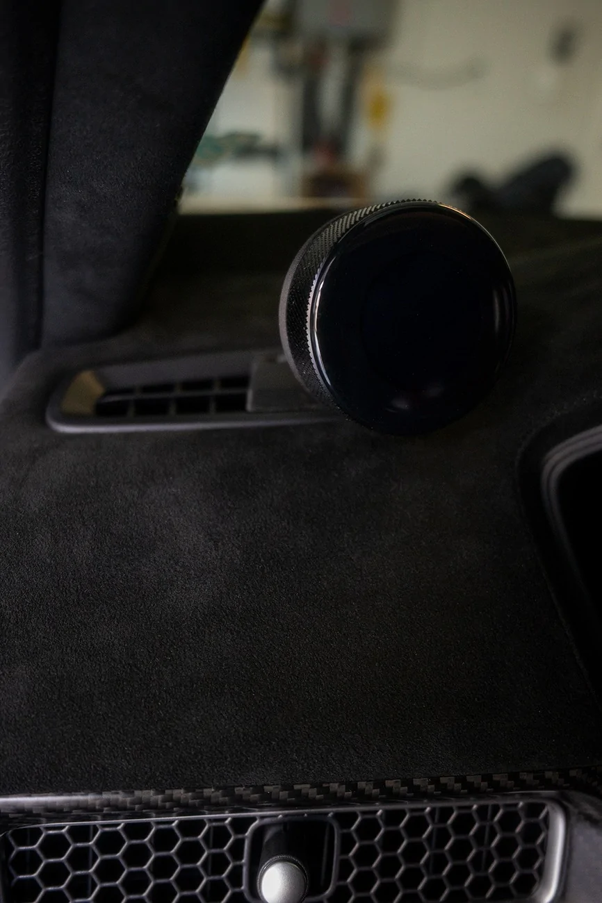

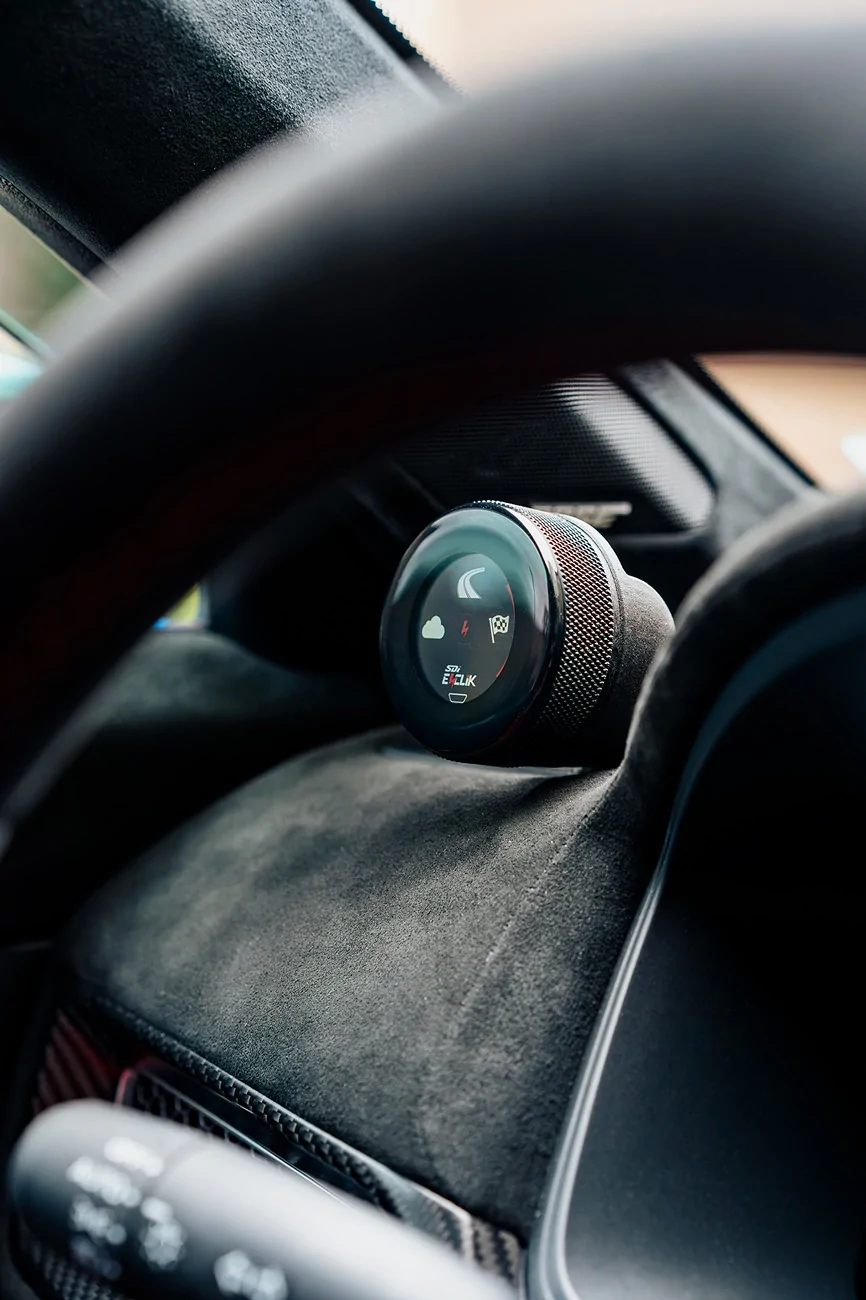

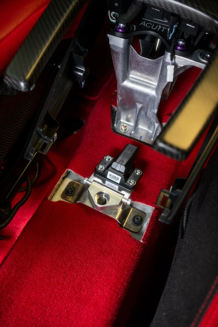

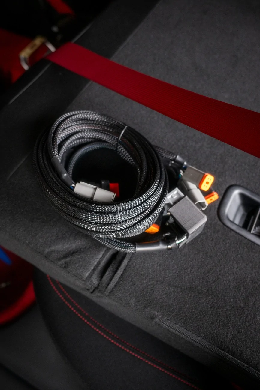

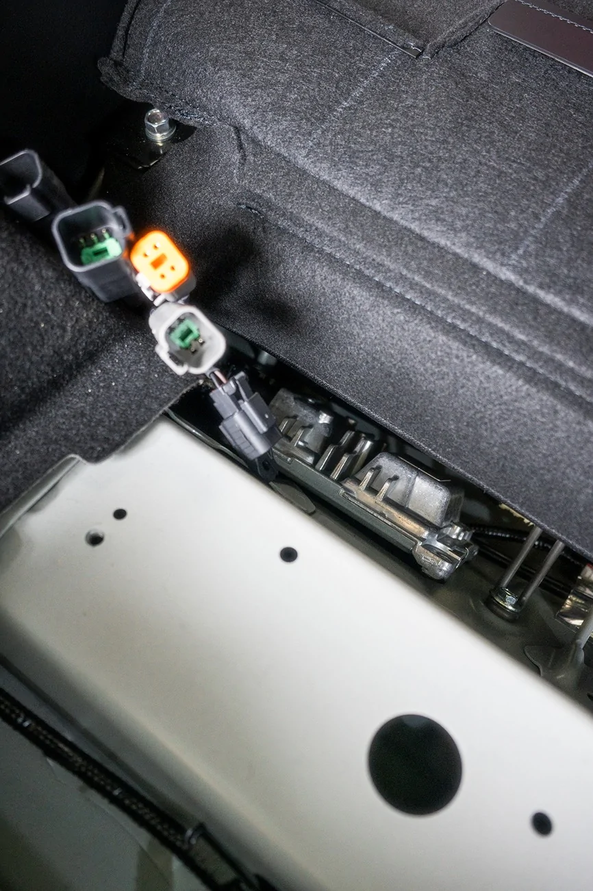

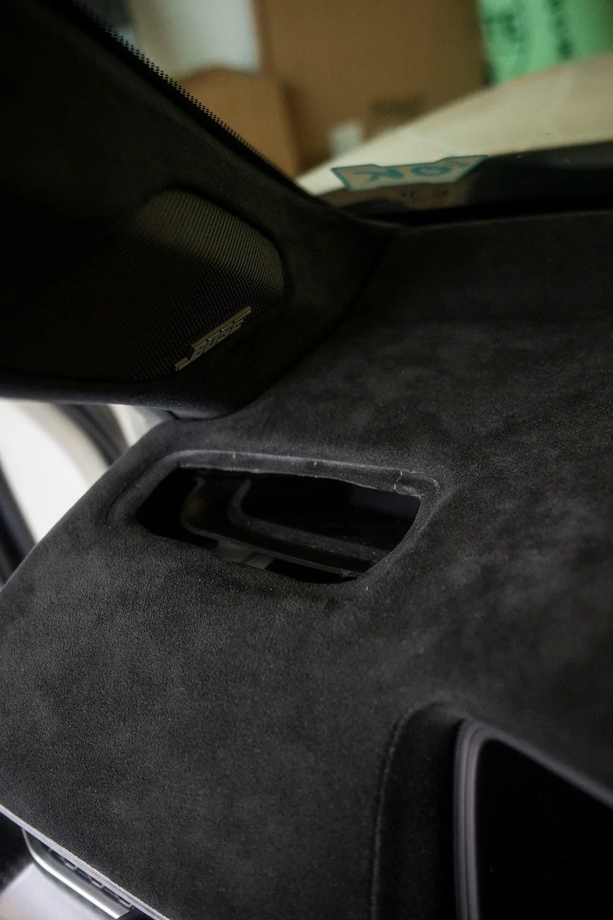

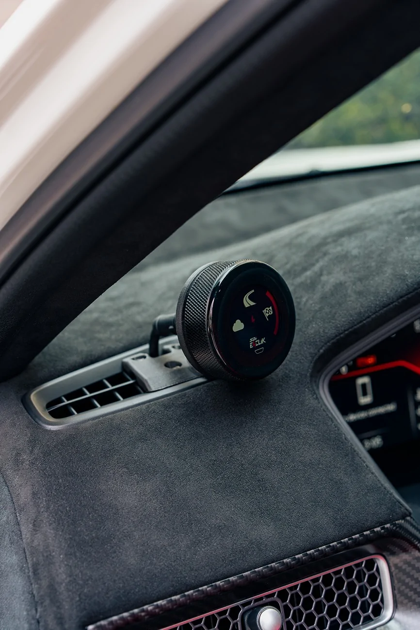

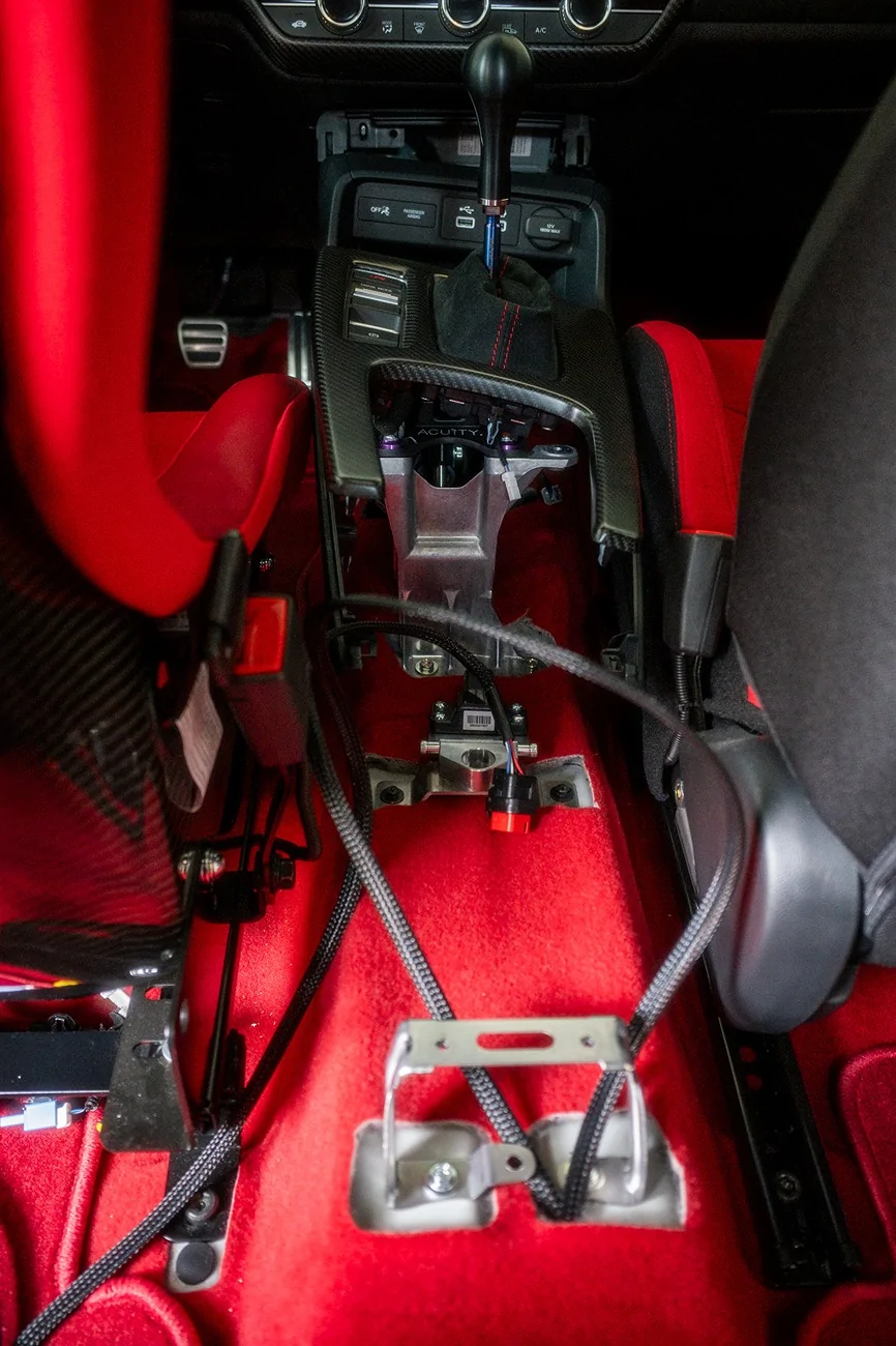

SDI E-CLIK kit arrived! I ordered mine from Unity Performance as they had the best pricing and free shipping.
The way I arrived to doing this mod is that the RSR active coilovers only adjust within a range to what sport is set at so if you set the dampeners to the middle number it'll just go softer or harder on an unknown linear scale. Wanted to take full advantage of the oem system working with these coilover so I found SDI makes a kit that replaces the oem module and also has you install an IMU sensor so it can adjust the shocks in real-time. Pretty wild when I think we have an aftermarket solution like this to unlock more customization for a car.
The whole install process took me about 2 hours. My 3 year old daughter was my helper so yeah...haha. If anyone does this install I'd suggest getting some felt tape to wrap on parts that may make contact with the chassis.
The quality of this kit is really well done. They include a new vent with a 3d printed mount for the touch screen. Mine was installed upside down when I powered it up for the first time. 🙃 Everything is plug and play and the instructions are clear enough to get you through it all.
Wanted to take it out to the canyons but it'll have to wait as it might rain soon.

Nice knurling

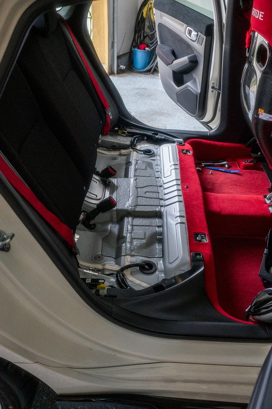

IMU (Inertial Measurement Unit) Sensor. They have you adjust the angle that it sits at then tighten it down. Doing back to front is easy but left to right is sorta hard as the mount doesn't give you any play to tilt it at that angle. I ended up getting lucky by just playing around with it and tightening it down.

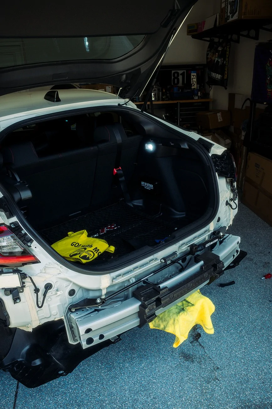

Was waiting for a delivery and the driver texted me saying he left it at the gate entrance to our community so I hopped in the car and was about to go and then saw someone pull up to my house. Thanks for doing your job correctly, delivery person. Guess I'll just shoot it since I moved it out haha.
