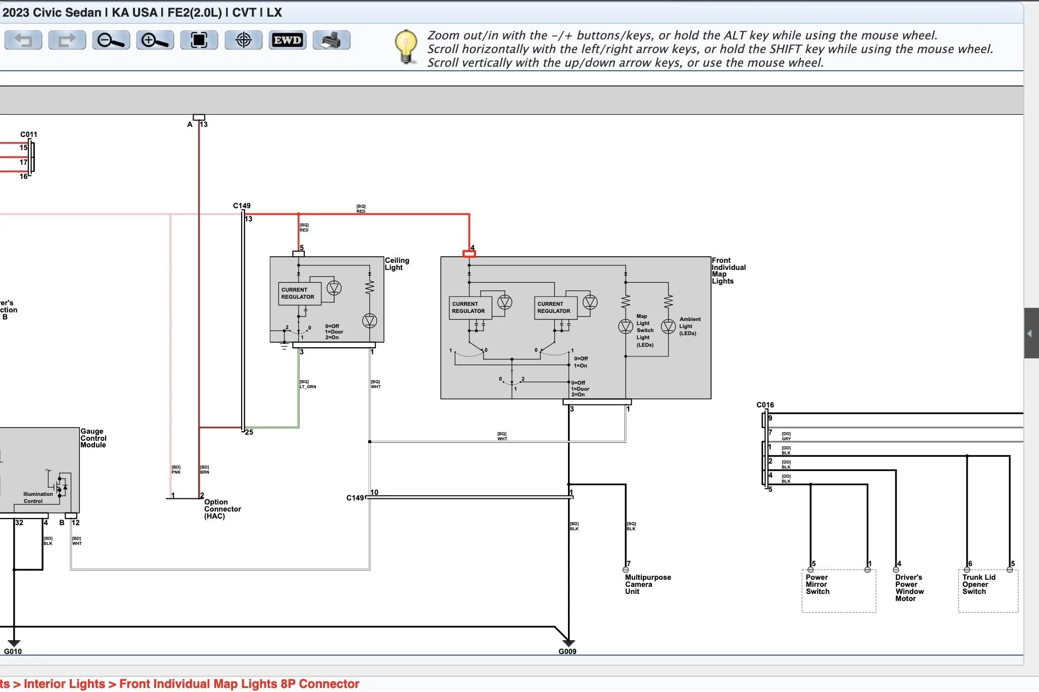

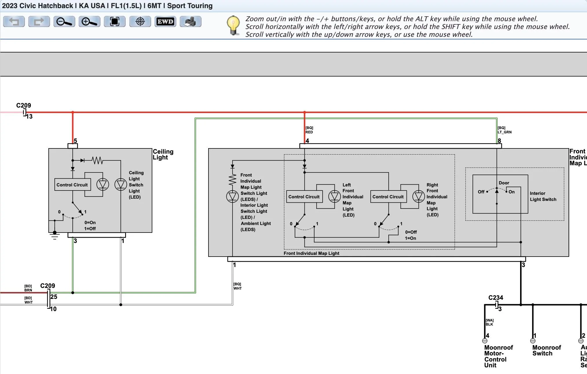

Xerocide, any chance you have access to the wiring schematic showing the ceiling light and map lights specifically on a Civic LX hatchback? It would be good to see that schematic and compare to the others since that is the car I have and can run tests on.
Xerocide
Feb 28, 2023
North Carolina
Sonic Gray 2022 Civic Si
Looks like the LX is also lacking the wiring for the door switch functionality. Hope this helps!

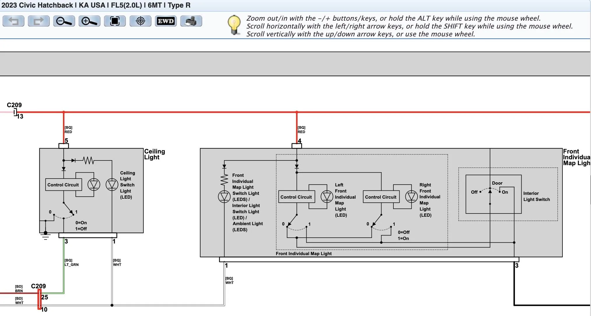

There is actually a wiring difference between a model with the door light switch and Type R's for some reason...
Looks like one wire needs to be tapped/ extended to get the door connected.

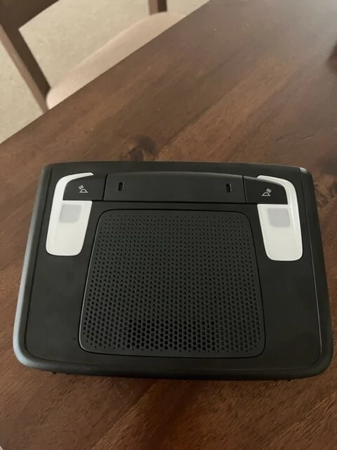

One weird omission I noticed with the FL5 was the switch for the front map lights to come on with the doors. (Parts are the same price too ?‍♂)
Even the very base model Civics and the Si has it. But we only have the switch on the rear dome light.
Fortunately, it's an easy plug and play swap.
P/N for light assembly with door switch: 34400-T20-A31 ~$40 shipped
This is just the FL5 light assembly taken out, will update soon

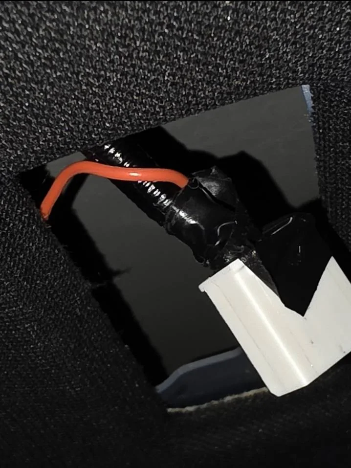

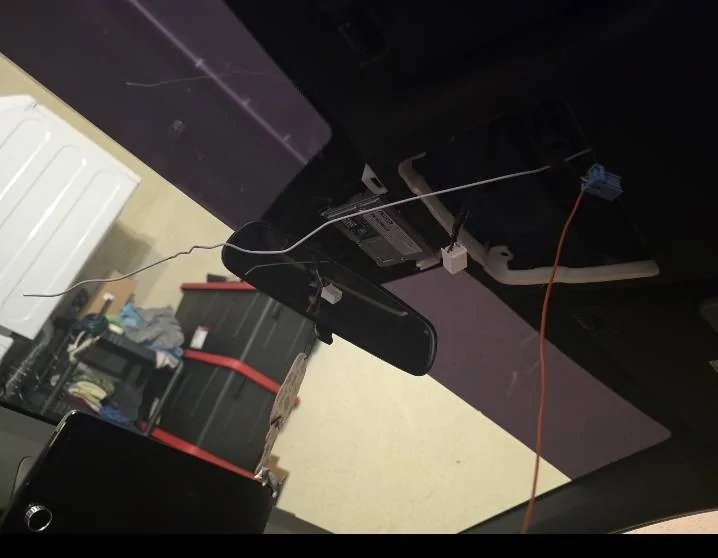

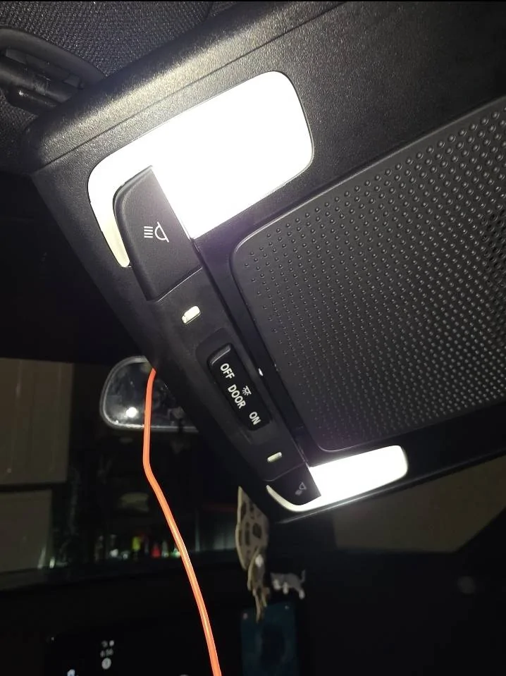

I found an extremely simple solution.
Buy a used map light on eBay with the door switch on it, got mine for $40 shipped.
First, remove the dome light and map light assembly.

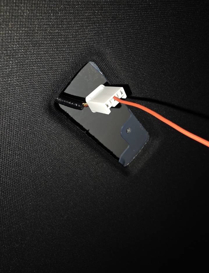

Fish a single tap wire through the headliner with a wire hanger, with the tap wire taped to one end, start on the map light opening side, and fish to the dome light opening, it's easier, more space for your fingers.

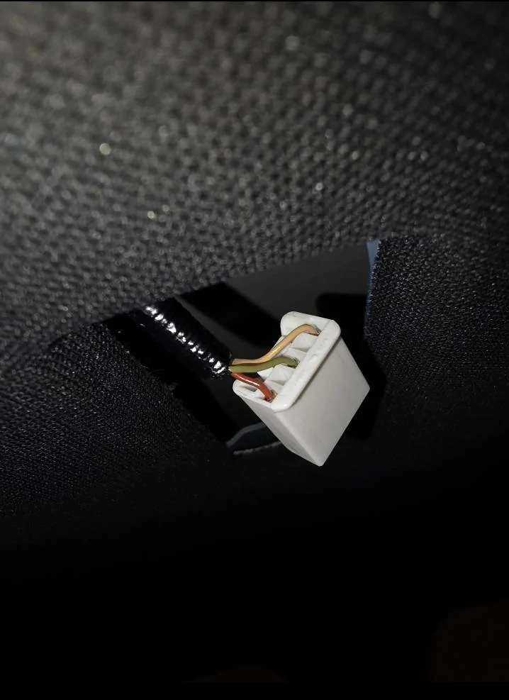

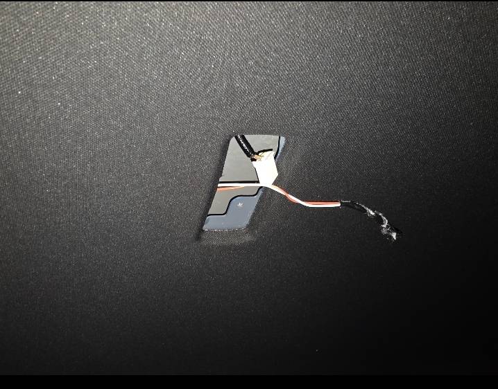

Tap a wire into the Dome light Door Switch wire, in the type R it's the center green wire, matches the layout of the switch. All I did was stuff the exposed wire I'm using for tapping into the back of the correct connector socket, the middle green wire.
I then taped the wire to the wire bundle to limit movement, again, this was the cheap, fast, and easy way.
Reconnected the dome light.

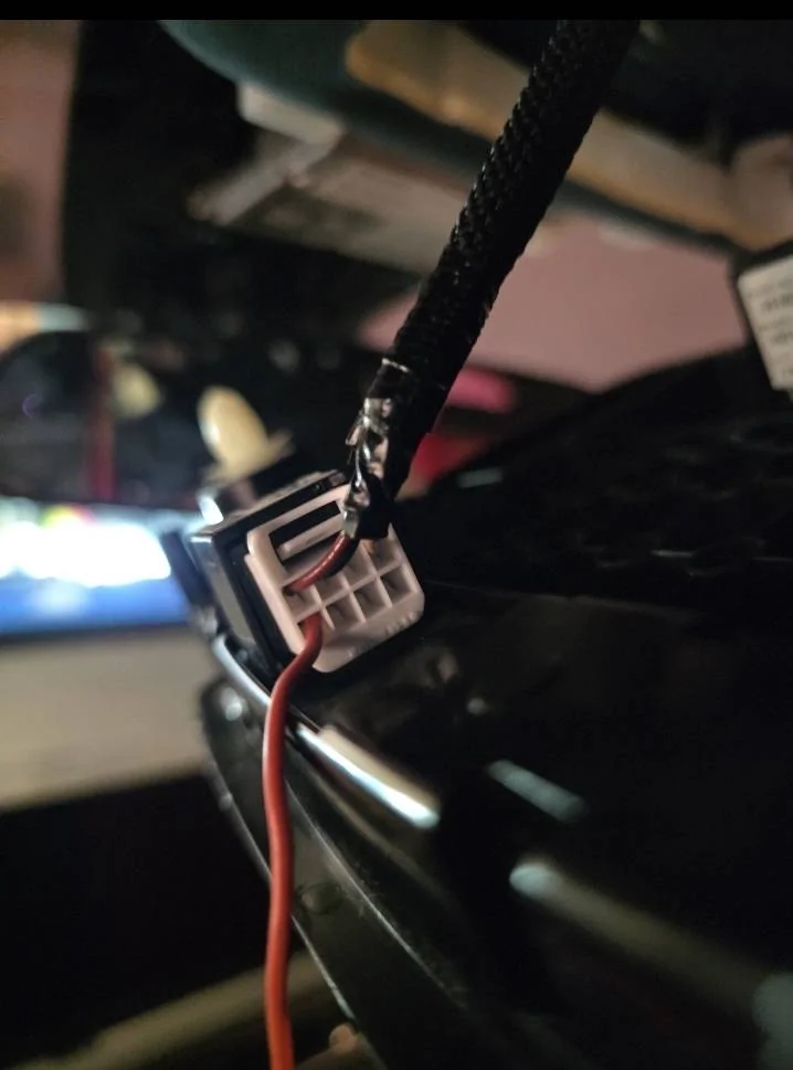

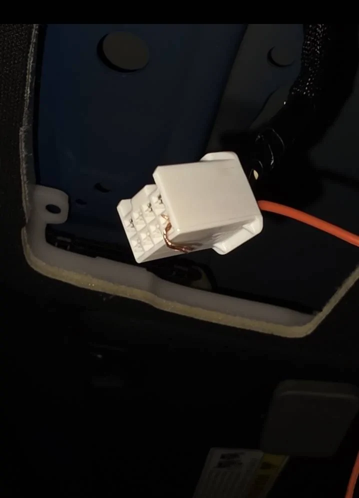

Now tapping the wire into the correct map light connector socket, or pin out.
Looking at the map light connector from behind it, the door switch connector or pin out is the lower left pin out, the whole bottom row is empty.
Strip your tapping wire exposing the copper wire, long enough to go completely through the connector from the back of it, with the extra wire sticking out of the connector from the front of the connector.
Bend the extra wire down and underneath the connector.
Connect the connector to the map light switch and voila, it now works as a stock wired setup.
Secure the added tapped wire to the map light wire bundle to limit movement after everything is reconnected.
This was my cheap fast and easy method as I was testing a solution, it took me 30 mins, I've ran this for 1 week and nothing has come a loose. So I'll probably keep it this way.

Thanks for this! Just did this today and now have map lights when I open the door.

Followed the directions above and got this done today. I had to do a very similar mod on my FK8 to get the same functionality. In that case, no additional switch was needed, only the wire. It's nice to have the switch. I wish I knew why Honda has now left this basic functionality out of two generations of this car. It's not like it takes a ton of parts to get it working properly.
